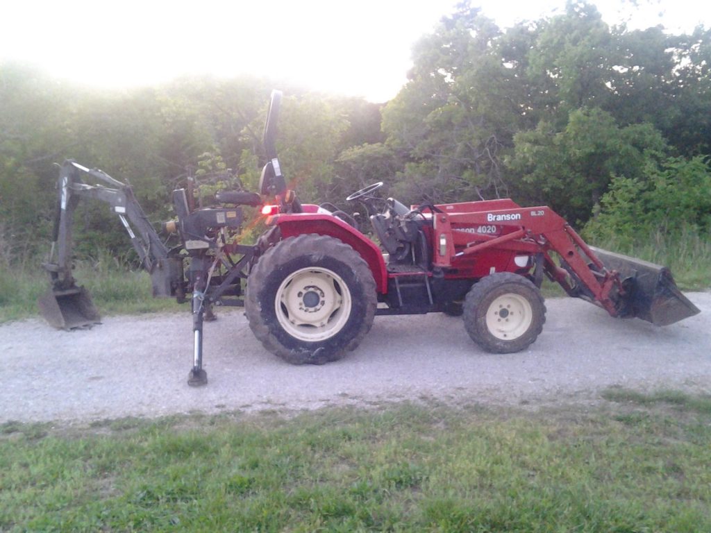

I have 40 acres at 5,100 feet in Montana. Sage brush and lots of big rocks in the ground. No trees. About 1.5 acres have been cleared of sage brush for my building and I have put some gravel down but have a lot more to do.
I'm looking at a 2002 Branson 4020 with 650 hours. The seller is a dealer and says it's in good shape except for being sun faded and having a couple tears in the seat. I think I can get it for 10k or 10.5k with the loader, box blade, scraper blade and clamp on forks. The backhoe would be an additional 3k.
Also looking at a Yanmar 3110D with a Kokyer 140 loader. It appears to be in good shape and shows 1,925 hour on the meter. I can buy it for 6k with no implements other than the loader.
I really don't wan't to spend 10k but will do it if it's a much better deal.
The Branson is 40hp and weights close to 1,000lbs more than the Yanmar. The Yanmar is 30.6hp. Branson has shuttle tranny and Yanmar is power shift.
Thanks in advance for any advice.

40 acres is quite a bit... I think I would like having the bigger tractor sooner than later in my humble opinion. That would push me to consider the Branson more heavily and rationalize cost with about a grand worth of implements, (assuming they are in good shape), and then the remaining $3,500 differential as buying you more HP, more weight, and almost 1,300 less hours. (+/- $2.69/hr)
With all the big rocks, you should confirm loader capacities as well in case you ever want to move stones around. I think Branson's loaders are stout, but the Yanmar may be as well...
Not sure if that helps, but it is where my head goes initially. The pictures do seem to indicate that the Yanmar has been well kept. Do you know what kind of work each had been doing in its prior life? Maybe one was used to pull a parade trailer or hay trailer around smooth yard, and the other worked in a rough rock quarry. Might change the hour weighting a bit in my mind...
Good luck!
