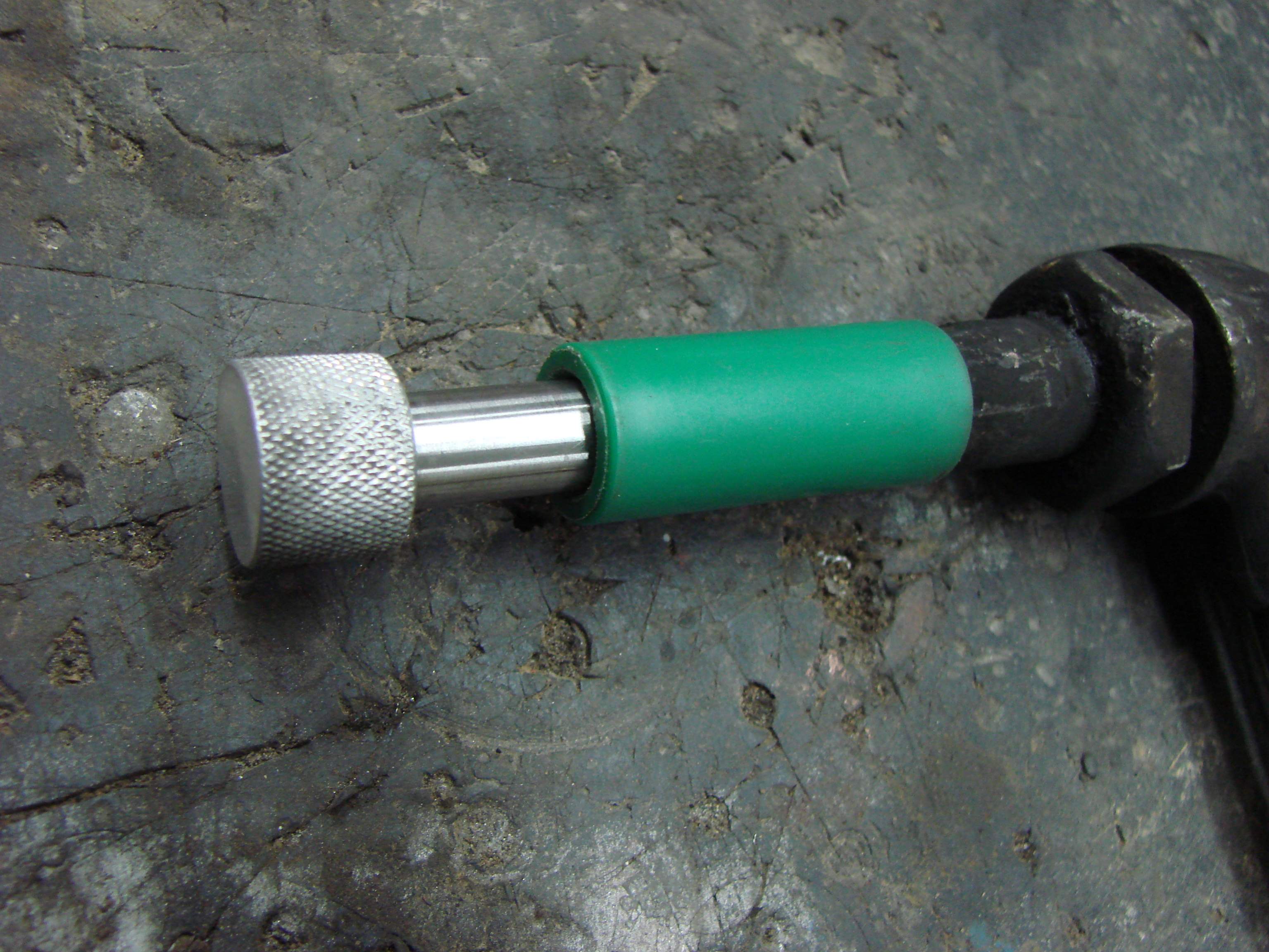

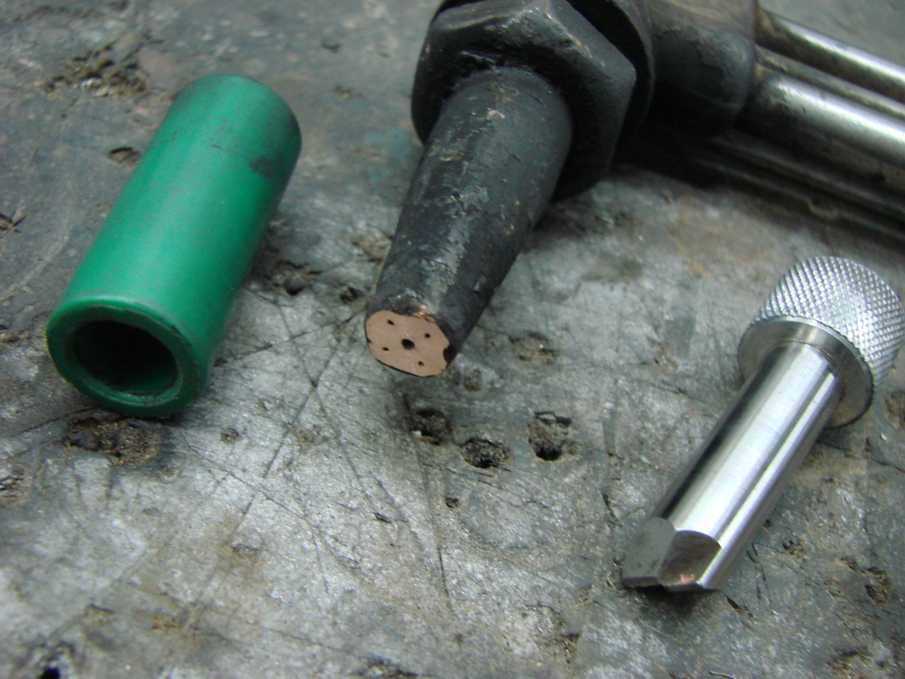

OK guys. Lets have a little fun. Here's a little tool that's welding related and I'm curious to see how many or you have seen it before. For those who haven't I'm sure you'll be looking for one when you realize what it is and what it does.

looks to be some sort of deburing tool. but i don't really know as i'm not that much of a welder

Hey big that was a pretty good guess for someone who say's he's not much of a welder. I'm bett'in your better than your lett'in on :) You didn't win the prize but you got high points :thumbsup:

Used to clean the face of a cutting torch tip. Stick the tip in the hollow tube and use the cutter to dress the end. Then clean out the holes.
Then again I could be wrong.

BINGO !

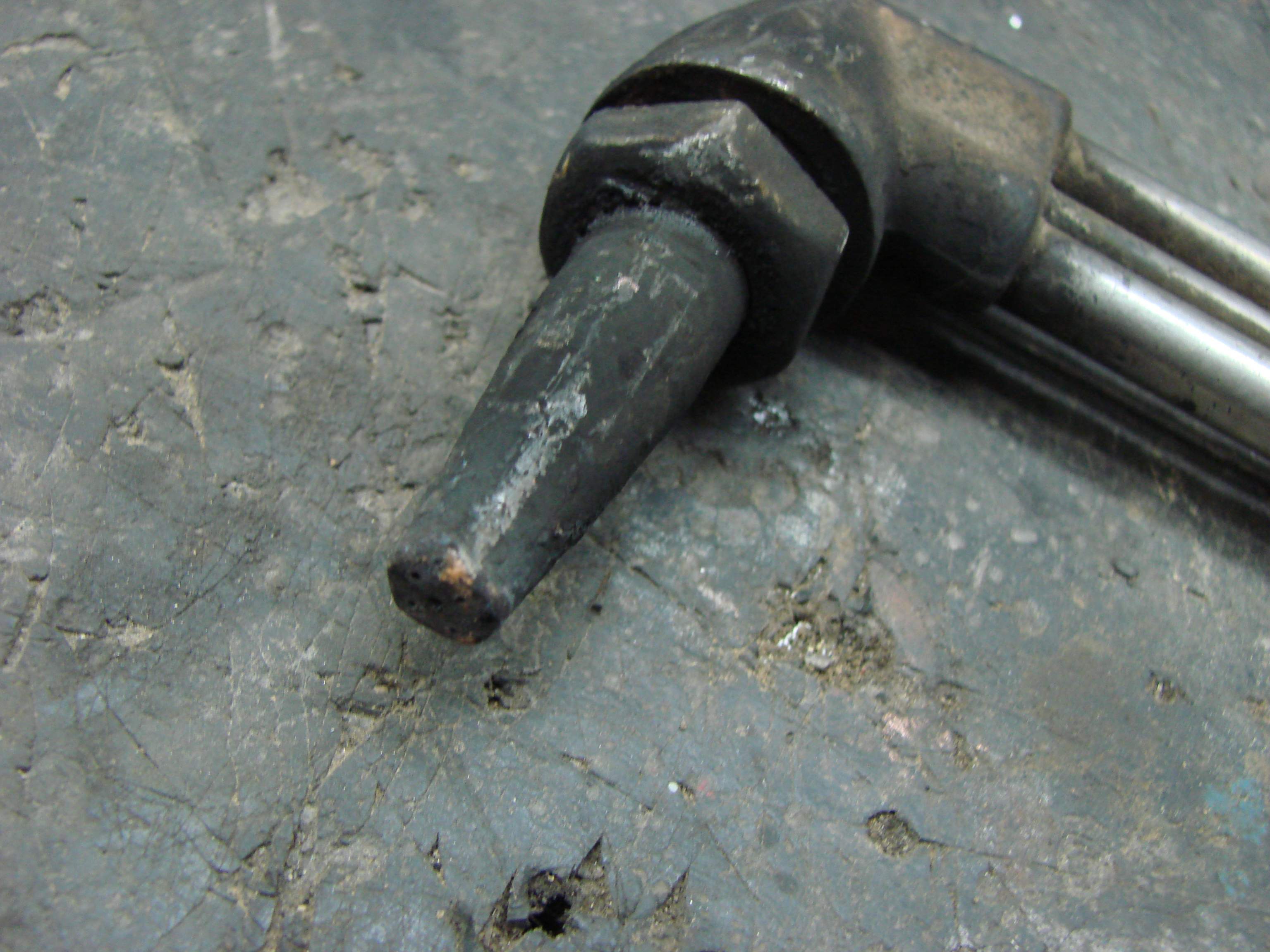

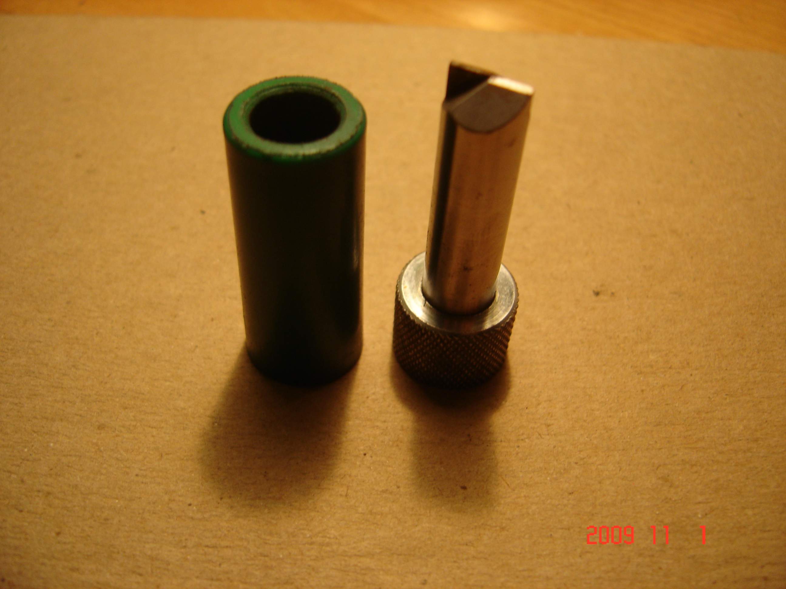

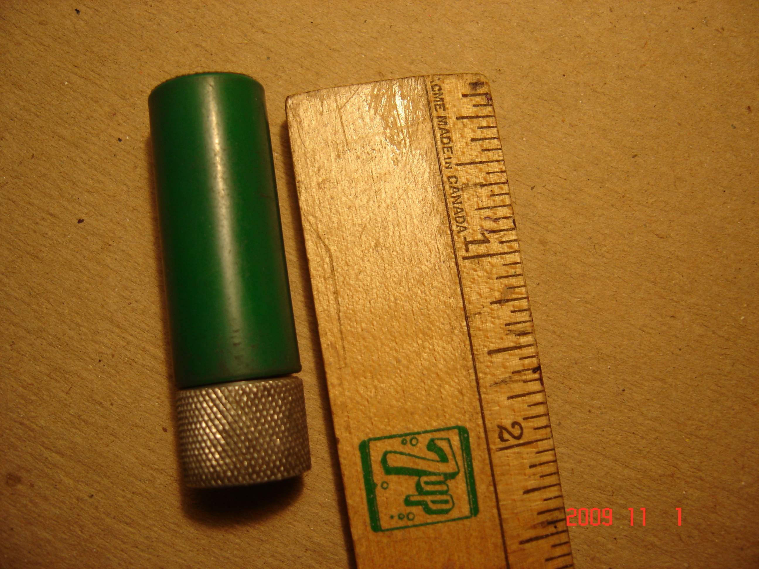

You got it! How many have seen one before?

I saw a picture of one in an old welding book. I have never seen or used one my self.

We, ( that sell Gas apparatus ) would rather sell you a Beautiful new Cutting Tip instead of you cleaning your own..;)..nice tool that was fairly common in the 70's..You could only use it a couple times before the tip started to act up. It actually removed the copper material.. Saved the owner $$$..
