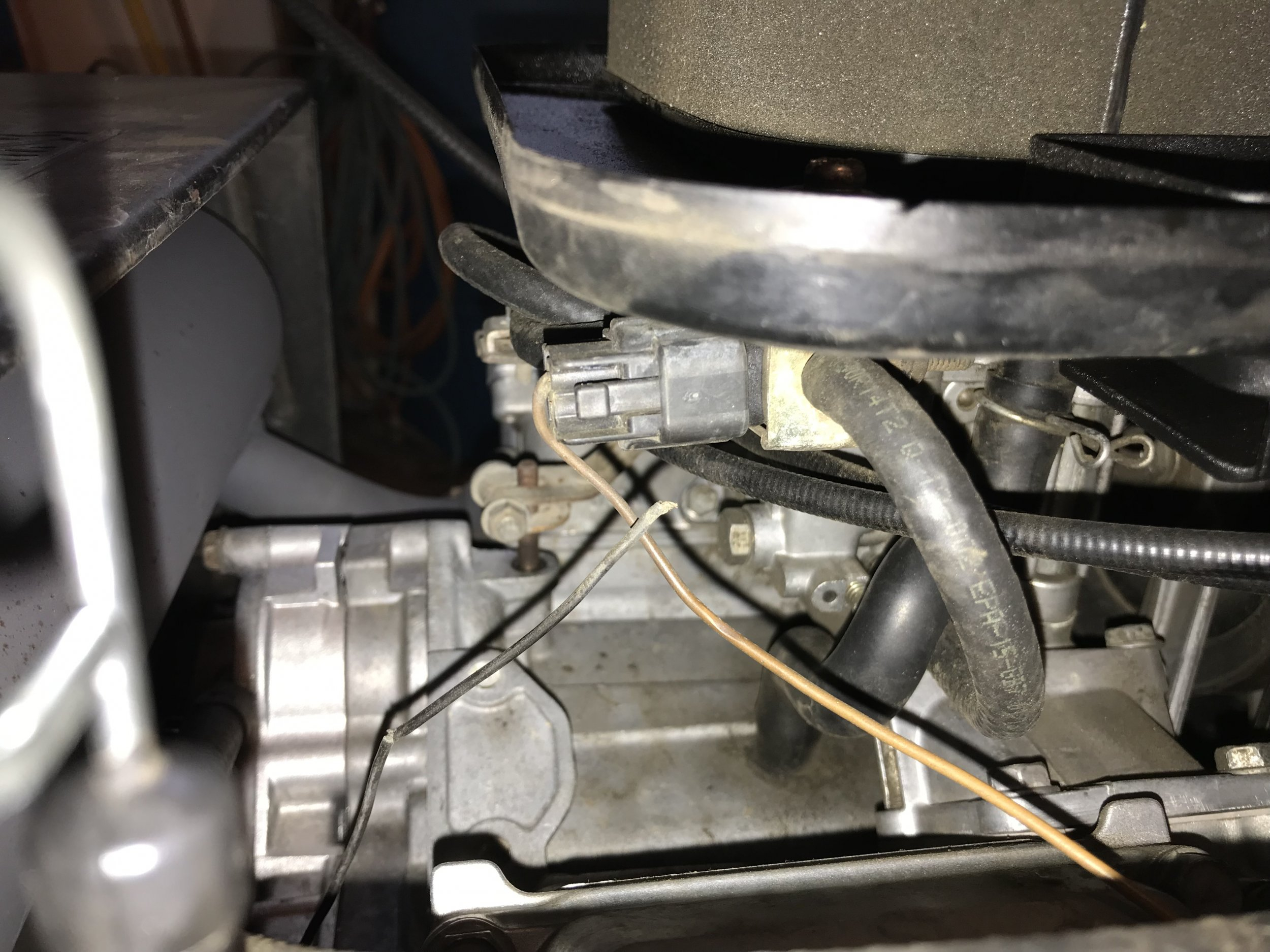

Thanks beenthere, Everything was going great until this morning, I bottomed out in a shallow ditch compressing the mower deck upward and after getting the 425 out the symptoms started again....DANG ! I'm going to have to look at how that module could have gotten hit, the wire connections kinked or something, all the symptoms are back ! I'm thinking the mounting area is not the greatest but wondering if I could mount somewhere else and lengthen the wires, or, would that hinder the electrical signals. I believe this module is sensitive to heat, I never have this issue in the winter so why have it that close to the engine, just thinking..........

Sorry to hear that your again having issues with you machine. Not knowing anything about this tractor, your post made me ask this about the igniter:
Where is it located ? Can you post some photos of it's location?

Post a pic of what the kinked connections look like. Not understanding how the ignitor can be hit by the deck.

Richard, go to the John Deere Parts Catalog under the 425 and look up PN: "AM105574", they have them in the GreenPartStore. The PIC they show is the mounted side you can see. Pull off your Left engine cover, the ignitor is mounted on the frame below the engine. I'm going to respond to beenthere, seems I have a new set of symptoms but that ignitor fixed the last set of symptoms, ran great !
Probably not the best post, it was conjecture that I "thought" it might have been hit or wires kinked. I agree with you, not way that occured, I wasn';t familiar with the structural set-up. It appears my symptoms are not the same, I let the tractor cool before sending this response, now I am besieged with a surging engine so I'm going to go through the usual candidates, air filter, gas cap, old fuel lines kinking at the connection to the gas tank and lastly carburetor. By the time I'm done with this all the connecting parts will have been changed. I found it really odd though, the ditch and immediately started this...... will be investigating. I was tempted to order another ignitor, but the surging is certainly different, I don't hear any missing cylinders whereas before the Ignitor change, that was certainly happening.

I would start with the carburetor. Maybe the hit to the ditch upset the float or broke some debrie in the float bowl loose.

Back to the 425 surging issue today......... Just went through checking the fuel line to the Gas Tank, no cracks. Pulled the fuel pump, small connecting hose solid no cracks + cleaned the electrical connections to the fuel pump. I don't have a pressure gauge to check the Fuel Pump Pressure, what other check can be made to ensure the fuel pump is working properly. I noticed the fuel filter with it transparent shell is not full when the tractor is running, just 1/2, is that normal, I would have thought it would be totally full. The Carburetor is beyond my skill set, I see rebuild kits out there.
