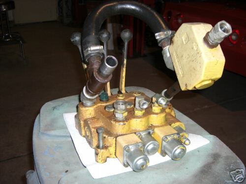

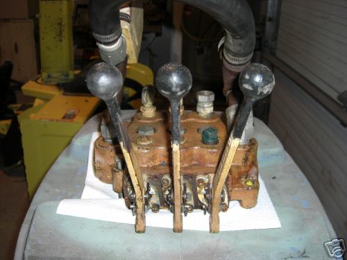

can anyone tell me what i just bought and using it on an old L185?
Thx, Ron

You bought a 3-spool valve...as far as using it you will first have to determine whether it is OPEN or CLOSED center. Not sure what the other thing is by the pictures though...
   / mystery hydraulics #3
The other thing might be a flow control but it would need one more line.

That 3 spool looks to have float detents on the first and third spool. I also think the other item appears to be a flow control vlave.
I will assume the detents are a good thing-what would be the purpose of the flow control valve? Sorry, totally ignorant of hydraulics-just impulse buying
