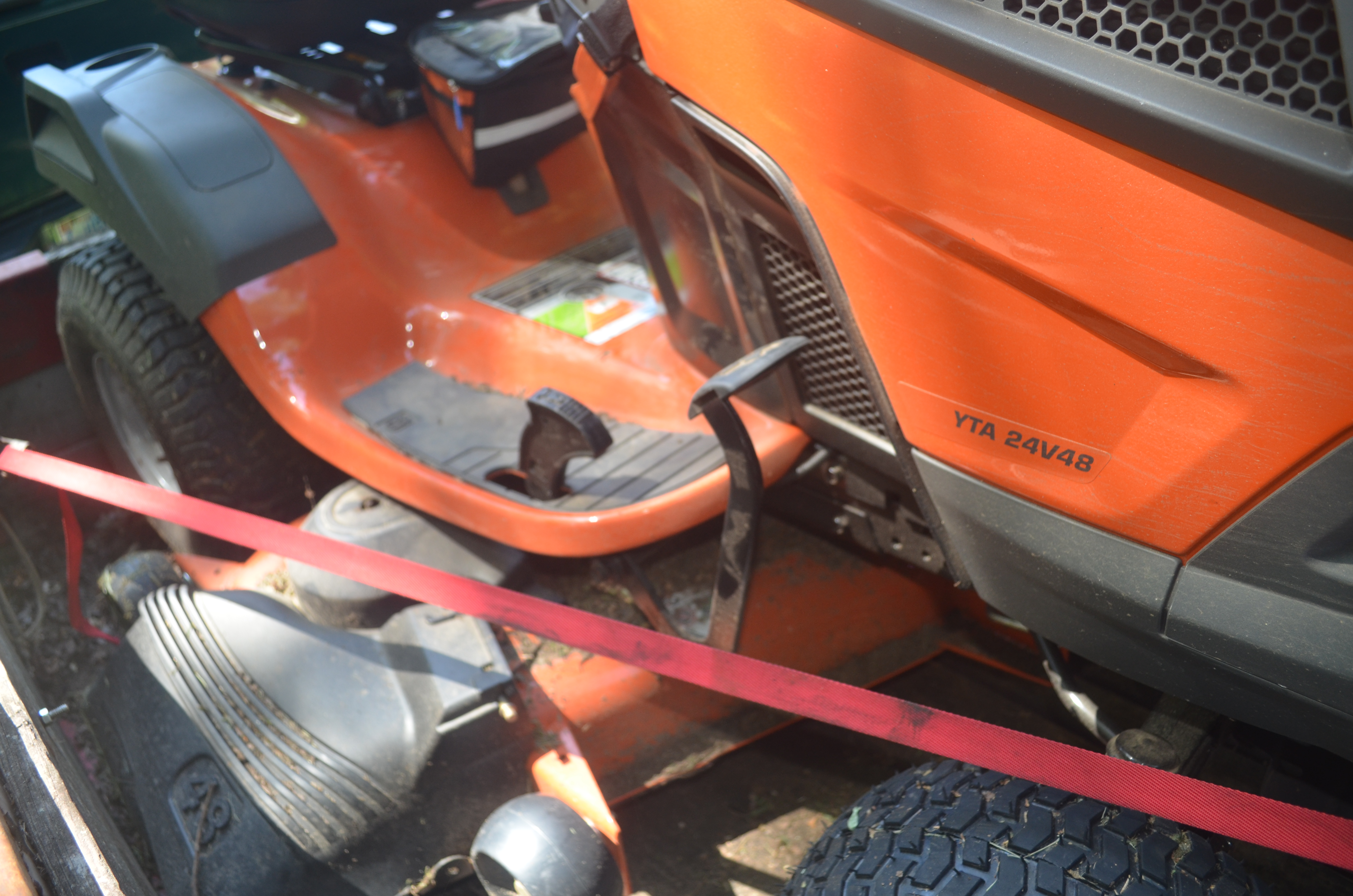

We took delivery of our new Husqvarna YTA24V48 riding mower this morning. It took Lowes a couple days to get it together to deliver. I did a lot of research before I settled on this brand and model. I also had to up our budget more than I intended originally, but that was because our last new garden tractor was bought back in 1991 and boy o boy was I in for some sticker shock when I first began looking. This one is not the hoss our old one was, but I got a Ford 861D tractor that can handle any of the heavy stuff I need to do now. This is mainly just a yard mower and occasionally pull the little dump cart.
This one has the fairly new (for Husqvarna) Automatic transmission with the foot peddles, that I read some pretty good stuff about. I hope it will prove to be dependable to haul my big butt around mowing.

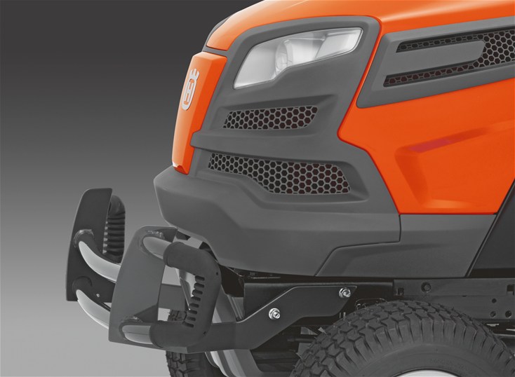

I have ordered a Husqvarna front brush guard/bumper to add to this as, all my other mowers and tractors that I have owned have had some kind of either homemade or factory bumper in front to protect the sheet metal and my superior driving skills facade. We are also thinking about buying/adding the bagger attachment. It sure is nice in the Fall, to mow up the leaves instead of raking them by hand.

MichelleB, glad you bought the bumper. I have the same bumper. It's stout - I usually just hook my cherry picker to it to lift it up when want to do something underneath. And yeah, it already has some battle scars; I'm not that good of a driver.

I also plan to hook my cherry picker to the bumper to raise it up enough to change/sharpen the blades when the time comes. Web site says it is not to be used to pull the mower if it gets stuck, but it seems pretty stout to me.

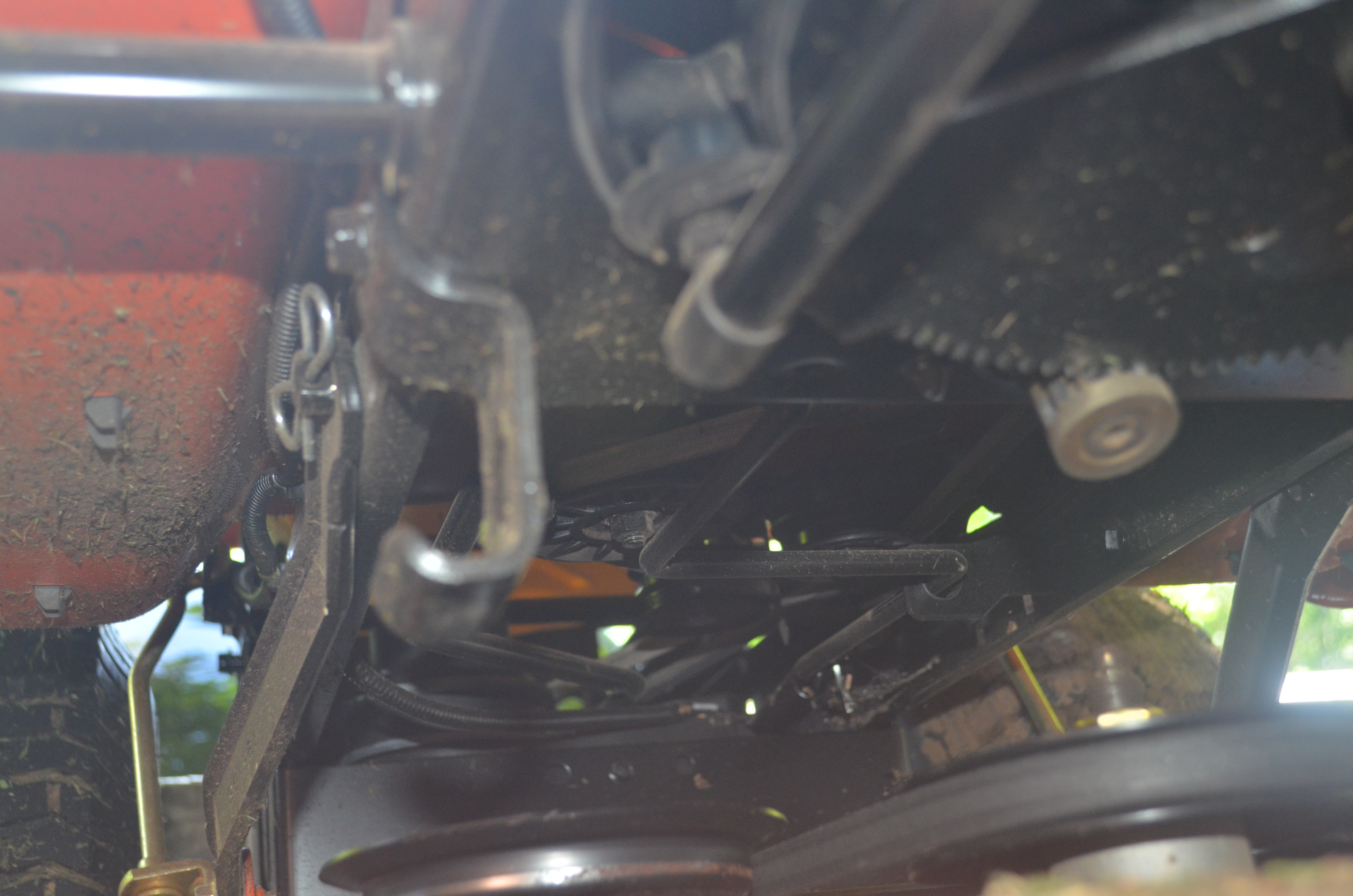

Well (I hope) good news and (definitely) some bad news. The hopefully good news is we bought the 3 year extended warranty from Lowes just under the deadline in time. The really bad news is the third time I began mowing with the new Husqvarna something in the GO peddle broke and now it just flops around. The mower will not go forward or reverse. Naturally, this happened at the furthest distance from my home at the bottom of a hill on the back side of our lot after making a single pass mowing, so pushing it back to the house was not an option for me. I ended up going around the block with my old truck and trailer, sweating in the sun loading it up to bring it back around to my little barn/shop area.
I figure the linkage is screwed up or disconnected, but it seems to lie inside the frame and even with a mirror, I could not see with my one good eye the linkage or where it was messed up at. Looks like the deck will need to come off and the mower raised up in the air to get under it.
Then I got the idea to try to take a picture with my camera from under the mower as best I could, but that was not any help either.

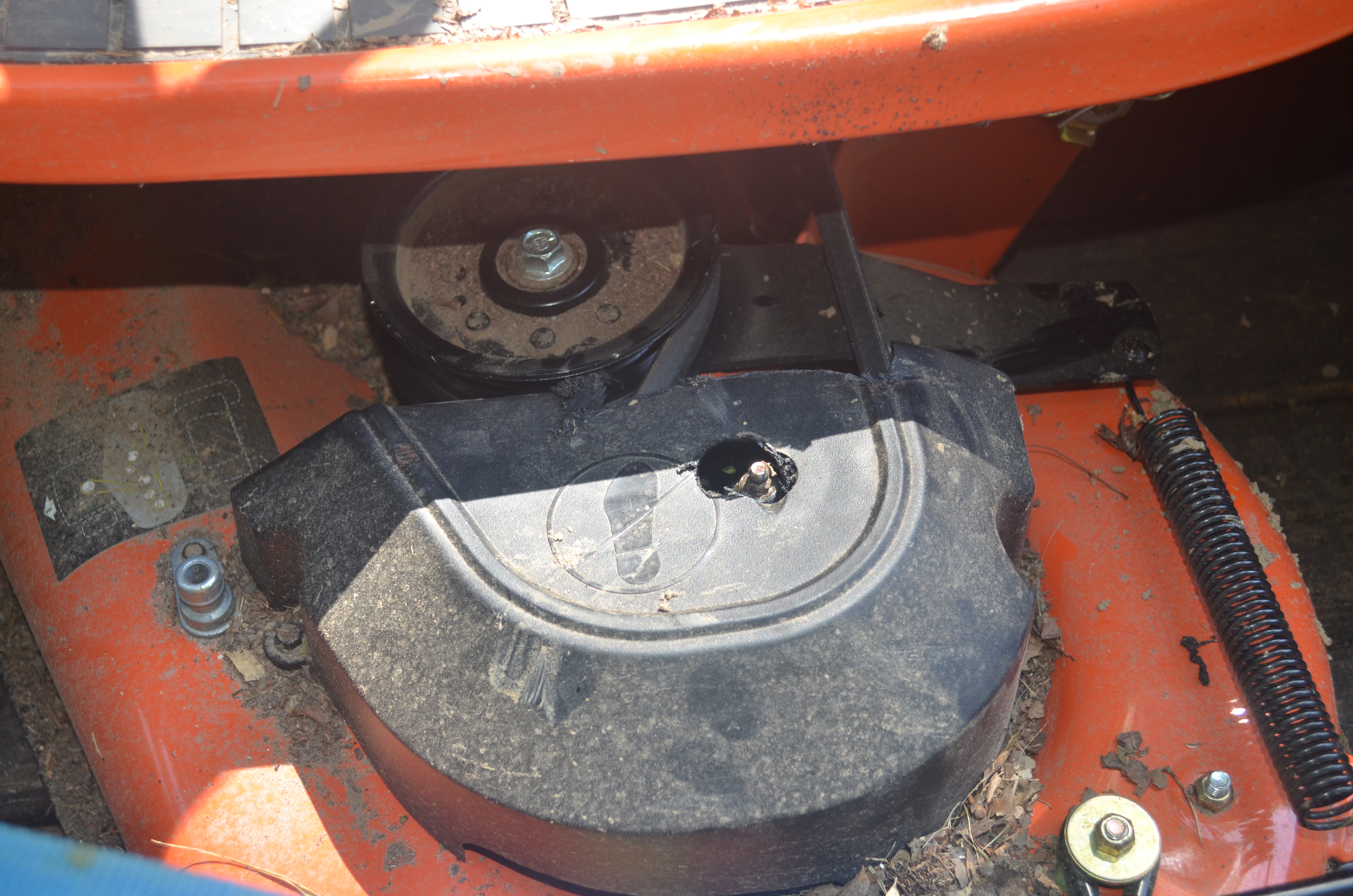

But during the course of all this, I noticed the plastic cover over the L/S mowing deck spindle has some melted areas where something has been rubbing against it that did not look right. Like maybe the spindle was wobbling and the belt pulley rubbing the plastic.

Had a similar problem and t may be the same as yours, about three weeks ago I went into reverse and nothing, forward nothing, peddle just flops around. My first problem in 400 hours :( I found the linkage rod from the peddle to the transmission has a clean brake on the 90 degree bend at the transmission. its held on both ends by a washers and cotter pins. Easy to take off and put on. Dealership did not have the part on hand and I had to wait a week but I have a MIG welder and welded it back together. Its been good ever since-sounds like you have the same issue.
