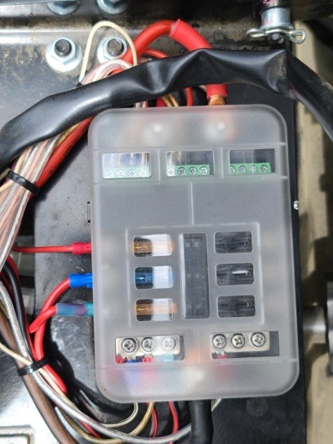

From the electrical standpoint, my planned improvements would overwhelm the 10-amp OEM auxiliary circuit under the seat. So I planned on including relay(s), to manage the current draw.

First, we mounted a relay-controlled fuse block under the seat. We ran 8-gauge cable from the battery to the fuse block. The OEM auxiliary circuit is controlled by the ignition switch, so this triggers the fuse block.

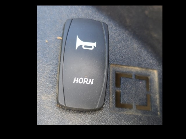

The horn is mounted beneath the factory grill guard. The switch is mounted in the factory cut-out in the fender below the PTO selector. The horn is powered through the fuse block with a 5-amp fuse.

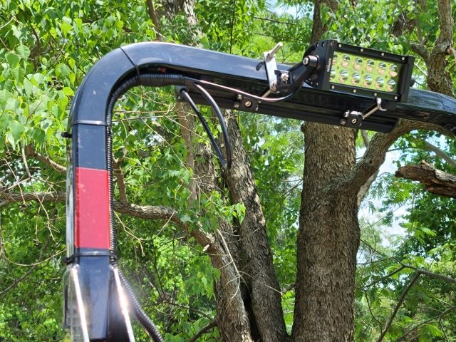

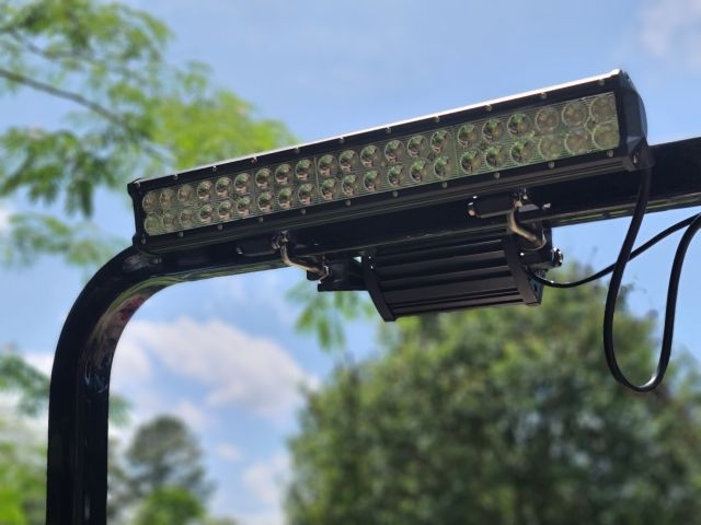

The light bars are mounted to the ROPS with stainless steel u-bolts. The lights are wired to the fuse block with 12-gauge wire. The switches are mounted in the switch box.

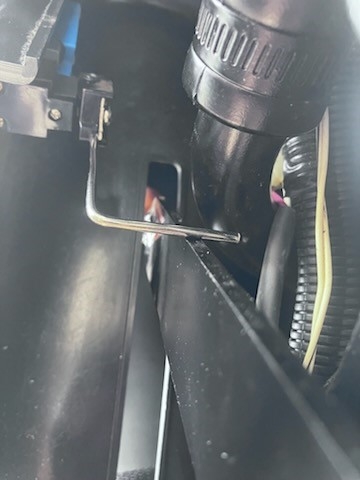

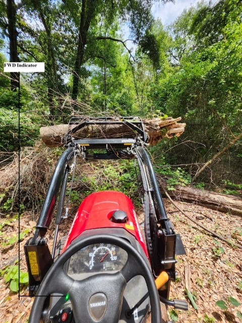

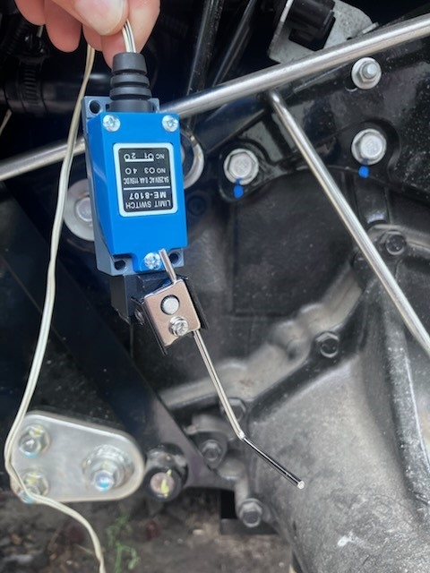

The most challenging part of the project, was the FWD indicator. The LED is mounted in the dash above the headlight control. The arm of the limit switch is bent at a 90 degree angle. The switch is wired in a normally closed configuration. The switch is mounted so the arm is displaced against the FWD control lever. When the control lever is moved down to the FWD position, the arm descends to the closed position, powering on the LED. The LED is very visible even in the southern Alabama sunshine.
