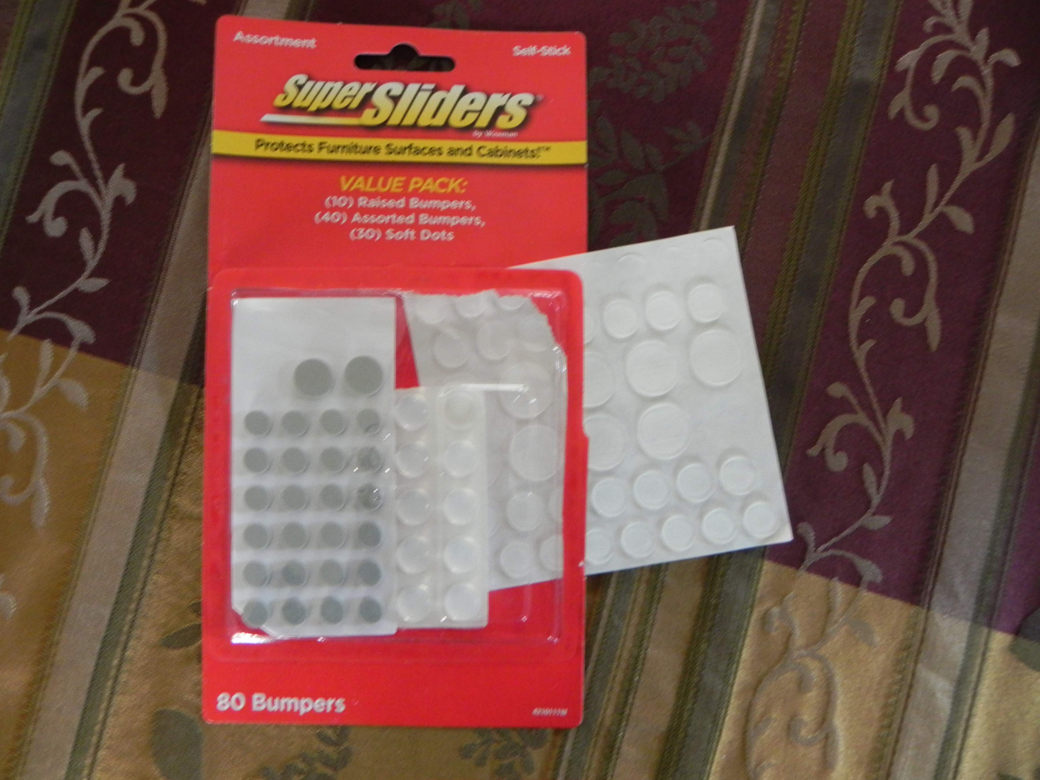

I guess that's a good thing. I have a 09 L5240 and I've had a couple of situations when I needed her help while I was trying to attach and implement or load something in the back of the truck. She hops up on it, presses the pedal and it dies. I've tried moving the seat all the way forward and it still dies. She only weighs 105 lbs so I guessing its the safety switch on the seat? Has anyone else ran it to this problem? Its not worth her gaining weight just so she can move the tractor around for me.

I had this exact same problem, though would only cut out if moving around some. If it's because of the same reason I had, and suspect yours is, she just doesn't have quite enough weight to fully depress the seat down and activate the seat switch. You can verify by adding just a bit of weight by pressing on the seat back with your hand while she's sitting there.
Here's what I did. My wife uses these little bumper things all the time on the bottom of vases and other stuff to protect furniture.
I tried a thicker one first, but then it kept the switch pressed all the time and I didn't want that. I ended up using the very thinnest one (about 1/16 inch thick) and it worked great. If the seat is unoccupied the seat safety switch still works as it should. But now it no longer cuts out. I stuck it on the seat bottom right where the switch will hit the seat bottom (when the seat presses down from sitting on the seat.)
The seat is lifted up vertically here. You can see the little bumper thing stuck on the seat where the switch hits.

Thanks everyone for your suggestions. I will try the spring adjustment first and if that doesn't work I'll give the bumper thing a try.
