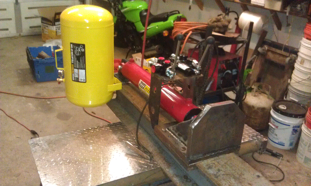

Well i have been using this website for many of the ideas i have implemented in the logsplitter i am currently building. I wanted to post some pictures and info so hopefully i can help others with their builds. I also will probably need help along the way. I am doing this build in my single car garage with other projects going on at the same time so progress will vary. I am fairly new to metal fabrication and many things i do will be a first with this project. I am using mostly scrap steel i have been able to gather from the trash or picked up from friends. So far i have had to buy the Ibeam for 100$ and a 4ft by 11 inch plate of 1inch steel for 50$. I have bought a 16gpm pump, 4inch by 24 inch cylinder, wedge, anchor block and a few other items from northern tool. I am just learning how to stick weld and it is my fist box of 7018 rod. It is also my first time layering welds (as i did in the wedge weld). Any pointers or critiques are appreciated. I got the axle from a jetski trailer. I cut the axle a foot shorter and that brings it to about 5 feet wide. It was very difficult to build the trailer frame out of round steel but it was all i had. The lift table was built out of an old section of iron fence. The hydraulic cylinder was from a lawnmower that was marked for garbage. Right now i am waiting for the 1 inch hole to be drilled on the piece that my main cylinder attaches to that is on the push plate. Once i get that piece back i can weld my push plate together. I have been using a combination of my circular saw and plasma cutter to cut the steel. Any other suggestions for getting through this one inch plate?

I also wanted to ask someone who has more experience then me if they think one pass with the 7018 @ 180 amps was enough to hold that anchor block? (there are pictures of it above)

AS far as the weld I would say yes but in time 1 pass may crack out on you, I would have ran 3 at least on the front.
As far as the hydraulics, at least match the suction line to the size of your pump inlet. Pressure from pump to valve I would go 3/4", 1/2" will work but I prefer 3/4". Valve to tank, at least 3/4" and put your return BELOW the fluid level. 1/2" work lines from valve to cyl is fine with the least amount of 90's possible. Sweep 90's are good if you have go that way. Use low pressure malable fittings on the intake and return. CJ

Thanks for the hydraulic info it will come in very handy. Well i got my push plate all welded up today. I also made the mount for the controls and cut some aluminum diamond plate for the sides. I clamped the tank in position and plan on putting the motor on the diamond plate next to it. I need to weld the feed line fitting to the tank still and a fitting for the vent. Here are the pics from today

Looking good. Very heavy building. Only one nit pick. That wedge does not look sturdy enough to me. The first model of my homebuilt was similar to the way it was attached. It got broke right off at the weld almost the first use. Subsequent models (7 in all) had it cut into the armature (we were using square tubing) welded at the bottom of the tube, the top of the tube and "wings" added about 1/3 way back from the point.

yea i was wondering how well the welds will hold. It is the first time i have welded things and really put them to the test so we will see what happens.
I ordered the hoses and fittings i need and they should be in by the middle of this week. I ordered premade hoses from northern tool and the fittings from discounthydraulics.com. Thanks again CJONE for your help. It gave me a guidline of what size hoses and fittings to get.
I mounted the hydraulic pump to the motor today and hooked up the few hoses that i had. Hands were too covered in grease and kerosene from the hoses and cleaning them to take pics. I will try to get some tomorrow.
Does anyone think it is necessary to box in the Ibeam at the ends for strength? I have seen it done on other builds but am not sure if it is something i have to worry about

I would. They help with torsional strength quite a bit. They can also make hanging a log table easier if you are so inclined to have one.
