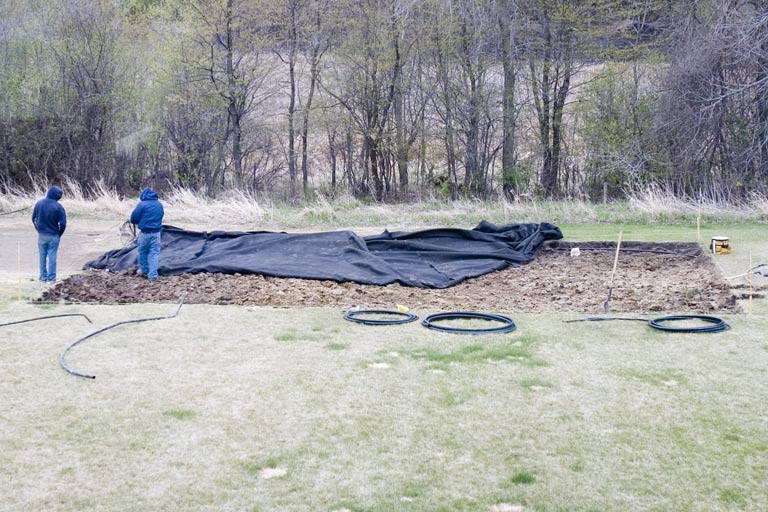

I wanted to put up a play set for my two small boys. I had a tractor with a loader, so I figured it would be easy to build a giant sandbox (40'x25') for a nice level soft spot.
Around the middle of April I had the hole dug. Note that the guys in this picture are the sprinkler guys repairing the sprinkler main I tore out. Oops.

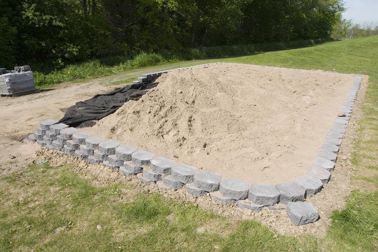

After waiting the entire month of May for it to stop raining, this is after 4/5 or so of the retaining wall was built and about 40 tons of sand moved in.

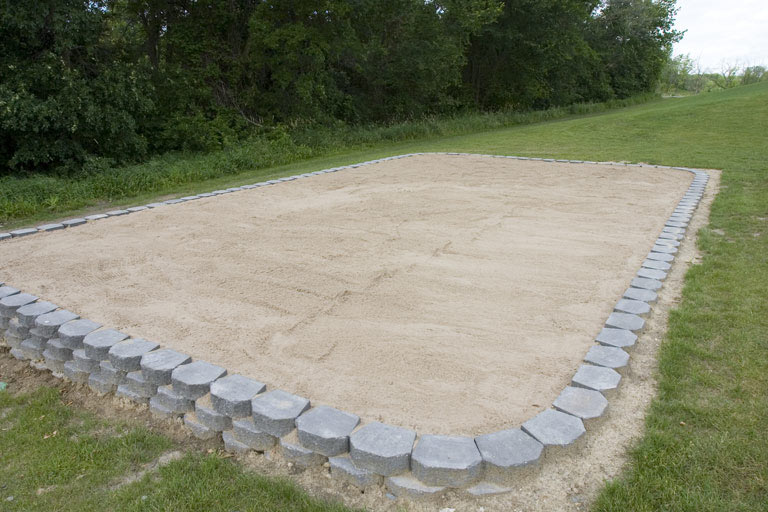

This is the final sandbox area after the retaining wall was completed and the final 10 tons of sand was moved and leveled.

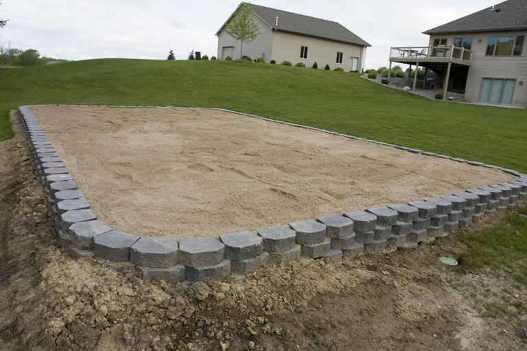

   / my very first tractor project
another view

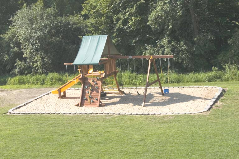

The final product
