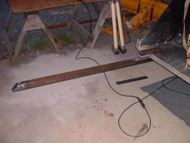

my version of removable bucket forks
   / my version of removable bucket forks #1
JohnnyDark
Bronze Member
Oct 3, 2004
79
Chatham Co. NC
Farmtrac 535
just got them welded up today, haven't even shot the paint on them. /forums/images/graemlins/grin.gif

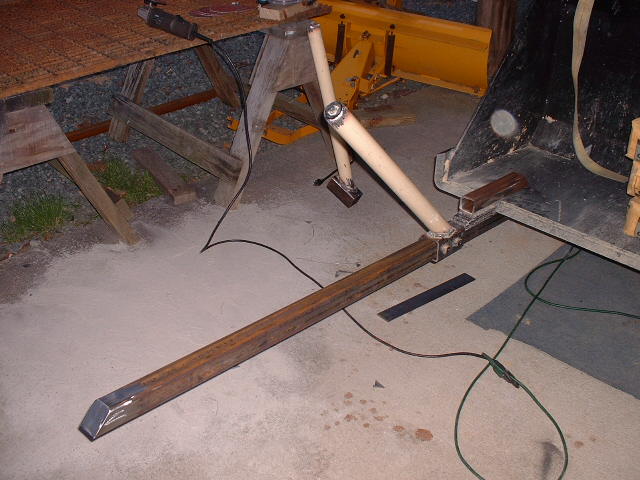

a pic of the removable brush attachment

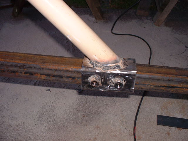

attachment method. 1/2-13 nut welded on, the tapped thru the 1/4 wall tubing.

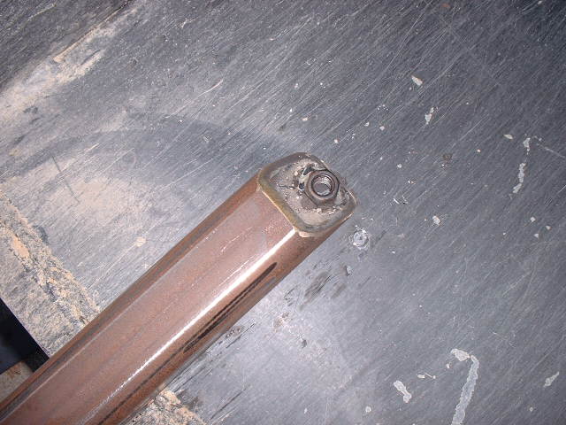

another view of the brush forks
