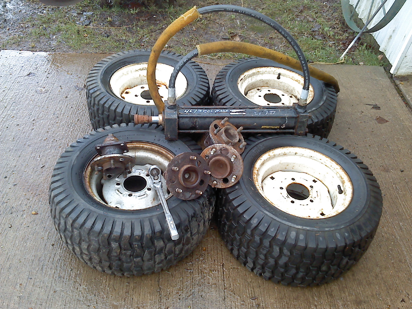

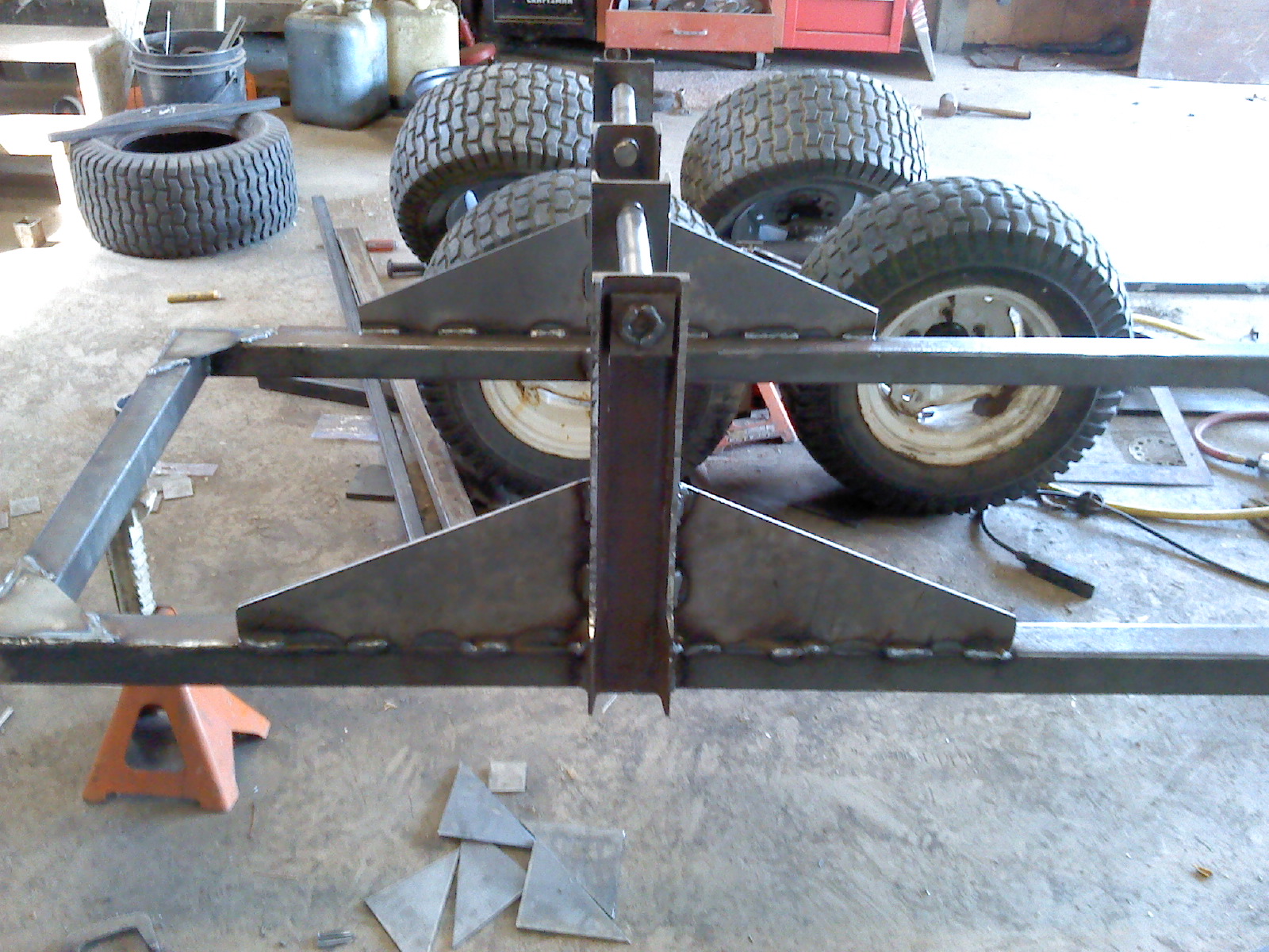

Well here goes, After rereadding Iplayfarmers thread last week (all 250 some posts) on his hydraulic dump trailer. I started my dump trailer Thursday. It will be a copy of the King Kutter XB 1.5, but a little bigger 48x60x18.
The first pic is what I came home with for $70 dollars!!!! (minus the 1/2 ratchet!) The hubs are from rear axles from two front drive mid sized GM cars, I removed them cost $20. The wheels and tires I got from a local lawnmower repair man, 23x10.5x12 $20, while I was loading I spied the hydraulic cylinder and asked how much? $30 with the hoses!
the next pic is half of what I got done Thursday and Friday, one of the walking beam axle with the hubs bolted up. Next is what I have done on Saturday, the axles are done and mocked up together at 48" wide which is what the trailer will be.
I used my HF horizontal bandsaw to cut everything except one of the spacers for the hubs for that I did a test and was racing the bandsaw with my Chicago electric abrasive cut off saw 3.5 x 1/4 wall pipe the bandsaw won hands down 3 to not even one!!
For sale one abrasive cut off saw first $50 takes it :laughing:

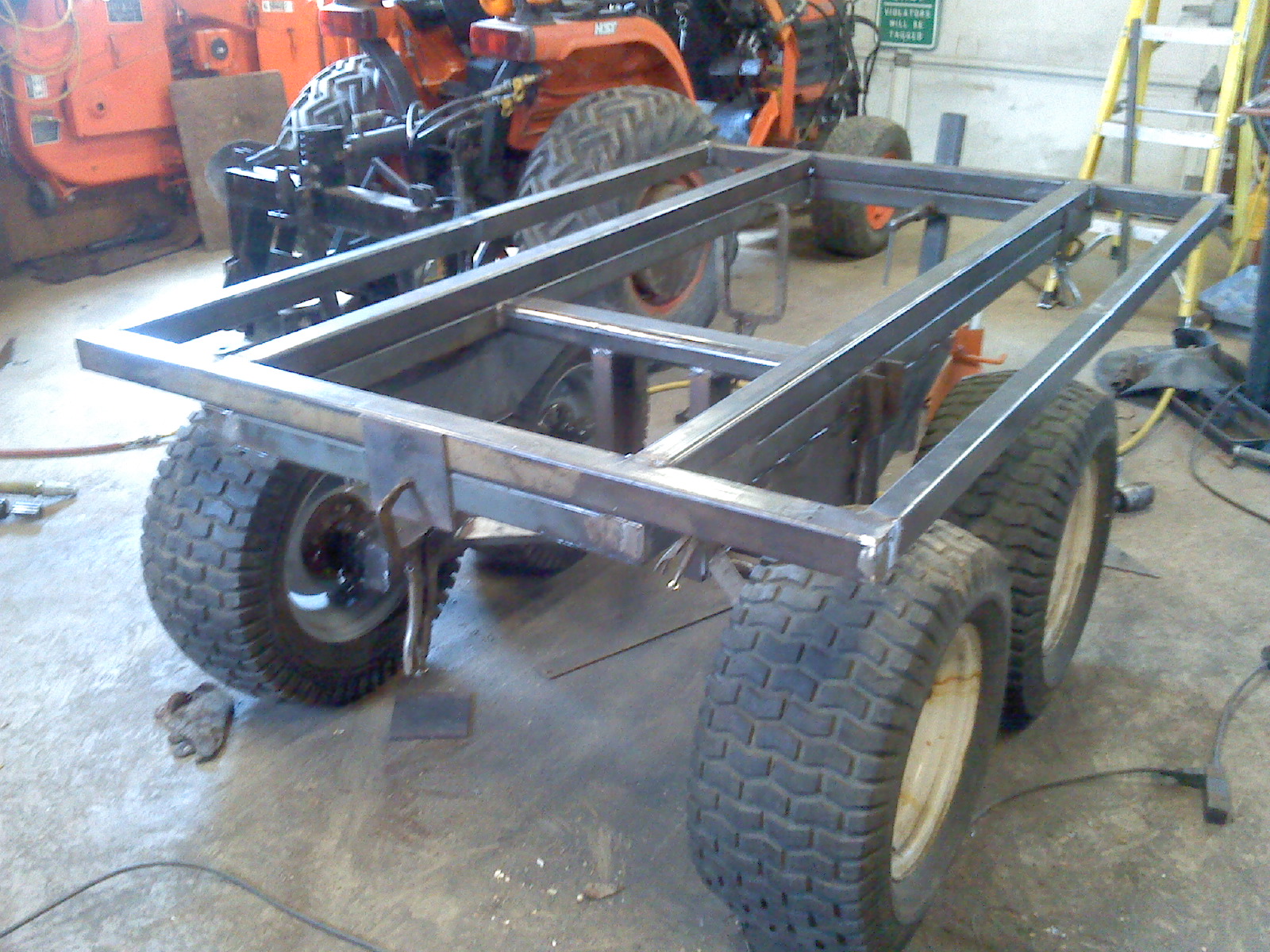

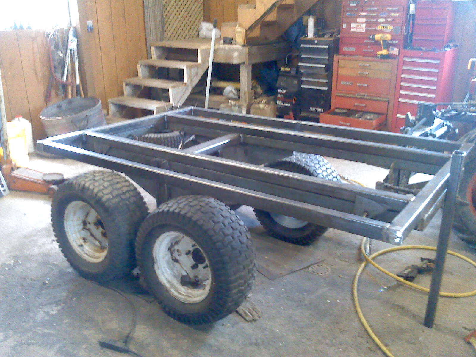

Sorry it has taken almost a week to get back on here and up date this build.
First to answer David Devuono, it is a 14" saw with an 1/8 Sait wheel on it. I love my HF band saw and amost never use the abrasive saw. I've had the Bandsaw for about 15 or 20 years and had to replace the motor on it but it has been a great saw for the money, I think I paid $129.99 on sale back then.

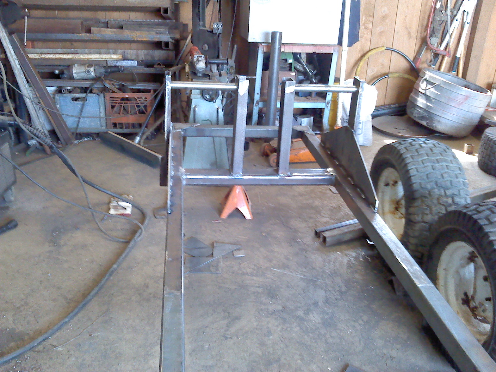

Ok now back to the dump. I have been working on it most days this week except for Friday and Sunday. I got the base done Saturday and found that I didn't leave enough clearance on the tires so I had to add a 1/2" spacer at the hub mount, I used 3" pipe with 1/4" wall same as I used to begin with I should have made that spacer 1 1/2" like I was going to but oh well it is fixed now and only added 1" overall to the width. That being said I think it looks good. Have I told you that I am doing a fly-by the seat of my pants build with no prints!! :confused2: just what I can remember the KK XB looks like. Our local TSC had 2 of them about 2 years ago and I looked at them very closely.
The first pic is the base or frame upside down. I wasn't sure how tall to make it and I think I have it too high, I will address that later. The axle pins are made from stock I had in my shop and had to have it turned down to fit inside the axle pipe. They will be held on with a lynch pin so I can take them off if I ever need to.
Pic No.2 is just another shot you can see the gusset I put on each side to brace the axle support. It is one pc. 3/16 steel 28" long and 9" high at the tallest point.
Pic no. 3 is a side view of the gusset.
The frame is 2"x2"x1/8" square tubeand the cross member is 2"x3"x3/8" rectange tube, the uprights are 3" C with a 3/16" web and the axles are 1 1/16 round barwith a shoulder turned in the end for the washer that was welded on. I am using a Miller Matic 250 amp mig with .035 wire and ultra mix gas. most of the stock I have had laying arround the shop but have bought some stuff, but not much........yet!

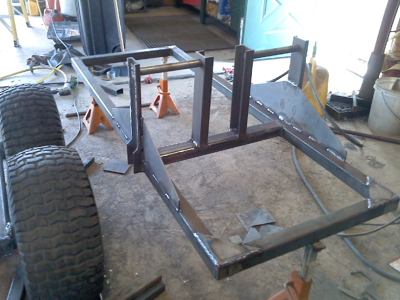

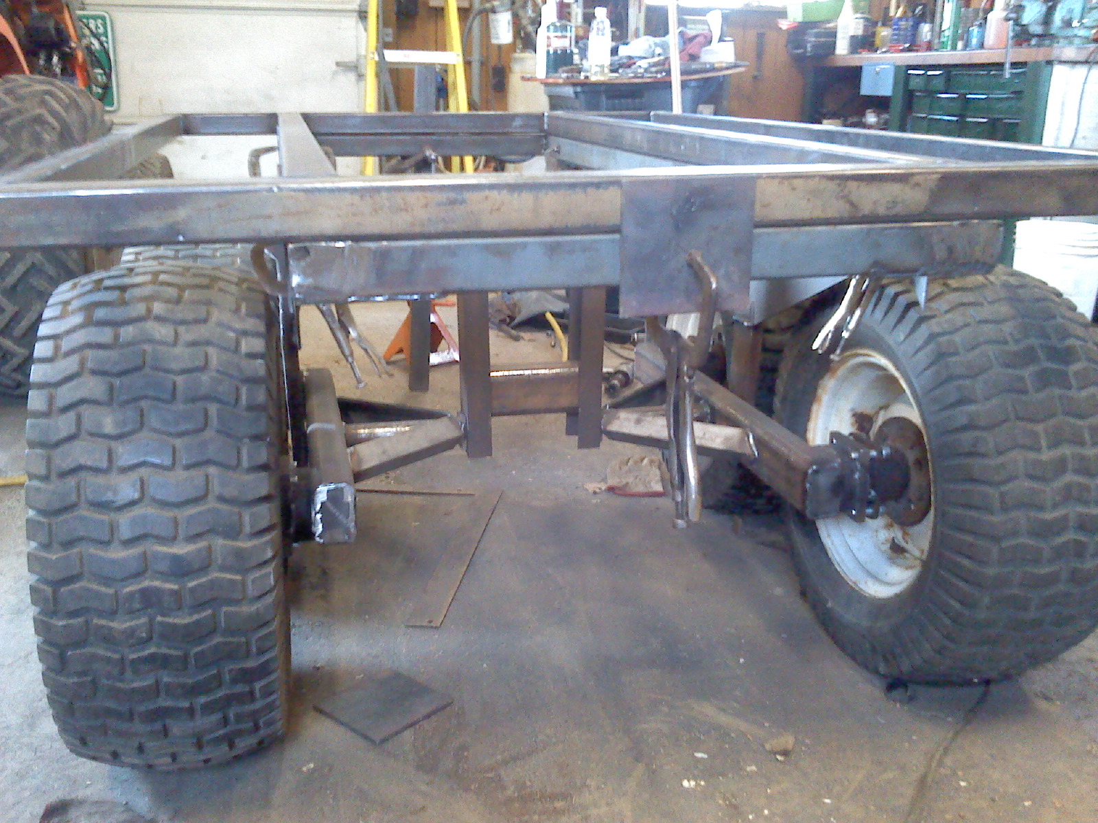

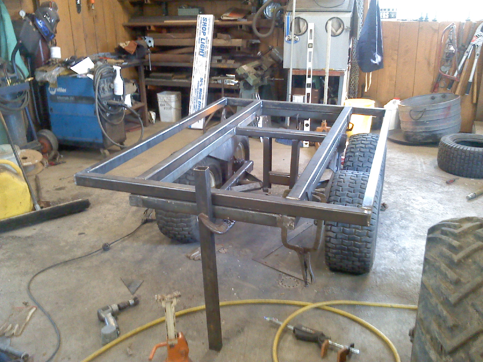

Got the pins! well here are a few pics from yesterdays progress. I got most of the deck frame done just need to put in a few cross members and gusset the corners.
Pic no. 1 is just a front view the bed is just sitting there for now.
Pic no. 2 is the right side view and really shows the trailer is comming together nicely.
Pic no. 3 is the rear. I have it sitting there with the bed flush with the back of the bottom frame but I will move it back about 1 1/8 inch to mount the hinges. The KK has the hinges mounted about 14" towards the front but when it dumps the back of the box comes within about 8" or 10" from the ground kind of a teeter totter effect, I feel that would inhibit the material from dumping out and wanted to get more ground clearance so thats why I moved the hinges back.
Pic no. 4 another shot from the rear at a lower angle. You can really see the walking beam axles from here, I think they will work nicely. That piece of 2"x3" tube between the axle suports is loose at the moment and will end up being the rear mount for the lift cylnder. I haven't figured where to possition it yet.
The front and rear cross members and the 2 middle tubes in the bed frame are 2"x2"x1/8" and the outer 2 tubes are 1 1/2"x2"x1/8" only because thats what I had on hand. I feel The 2 inside tubes will do the brunt of the lifting so thats why I put the bigger tubes in there. The front mount for the cylnder will be made from the same 2"x3"x3/8" tube that the axle beams and the lower frame cross member are made from. Hopefuly I will get the hinges done tommorow and will be able to get some pics of the bed tilted! :dance1:
