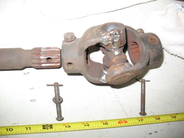

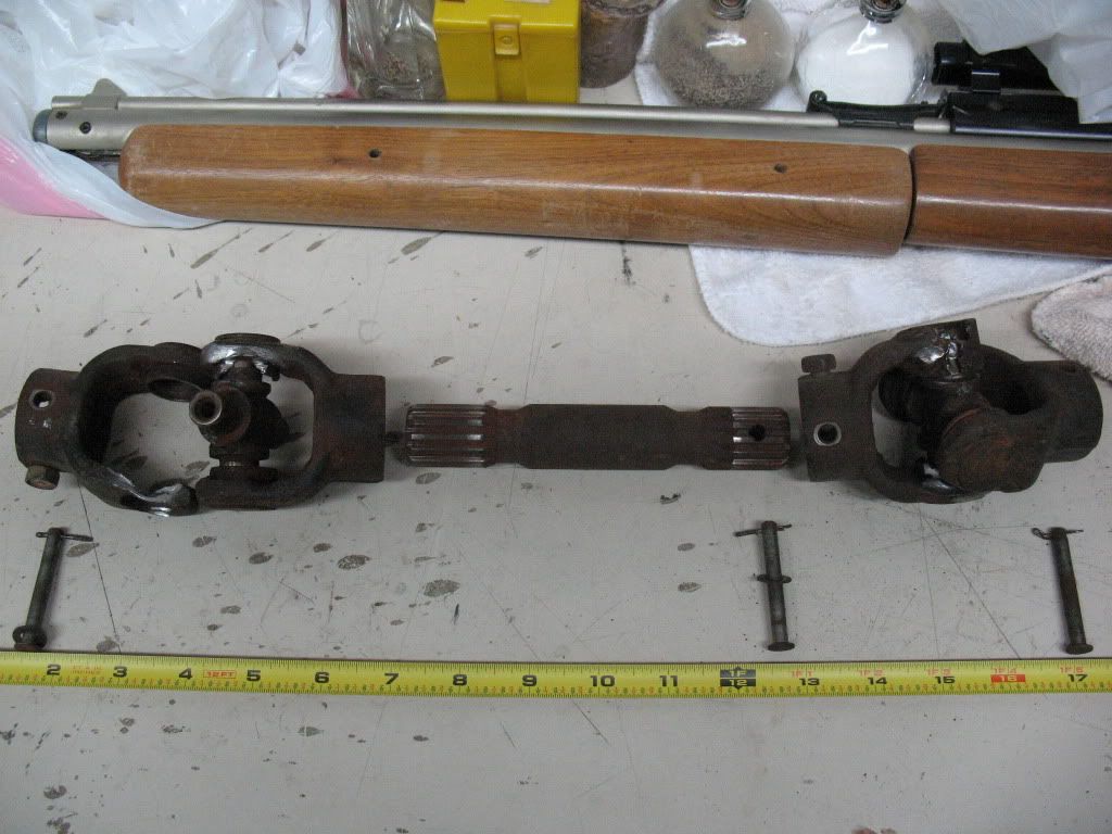

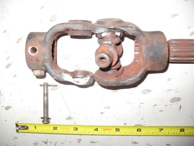

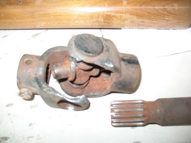

Here's a pic of my driveshaft.
Since most parts are'nt available we're going to try and build one like SVCGUY did.
My friend has a lathe, mill, press, etc.
Here's the link to his rebuild.
http://www.tractorbynet.com/forums/iseki/130859-iseki-tu205f-universal-joints.html
Hope svcguy chimes in with an update on how his is working and some part #'s if he can.
We have'nt started yet. Just in the collecting parts stage. Will post pic's as soon as we get started. If anybody has suggestions, we're open to them.
Thanks
Mike

That's a nice Sheridan. I always wanted the silver one!
Are both ends of the U-joints that 13 spline Japanese specific part, like svcguy's? Is there any chance you might get lucky, and they are some more common part than his were?
Otherwise, it seems like he did it about as I would try it if no parts are available. Good luck!
