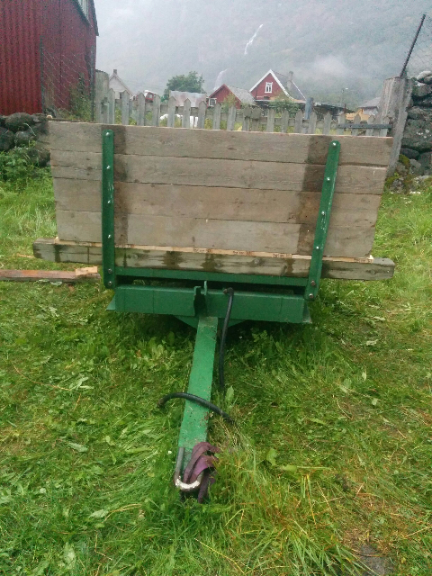

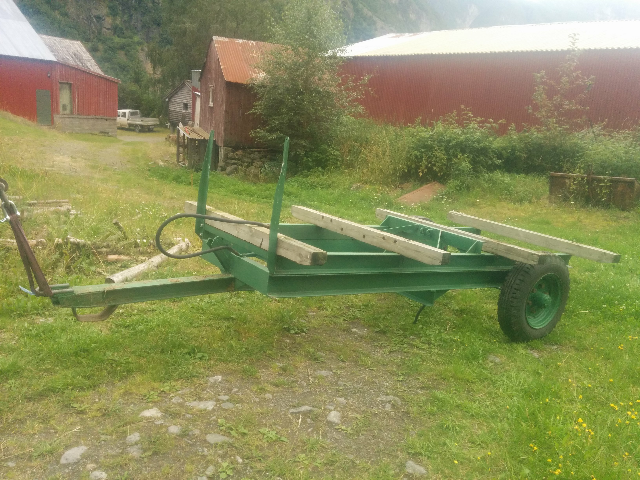

Got some remains of a tractor trailer and hopefully it's restoration.

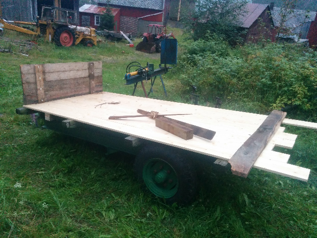

My slow and nice rebuild plan dident last long, my woman needed it fast so she joined me for a quick adhoc build....

Nice job, but I guess you realize that most of the weight you put on this trailer will be transferred to the towing vehicle? In other words, it's gonna have a LOT of tongue weight, but I'm guessing you planned for that.
   / My trailer project
Yes, this is the point of the design, you want as much weight of the trailer as you can get on the tractor so you have traction.

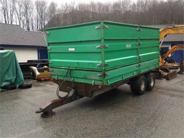

A newer design:
