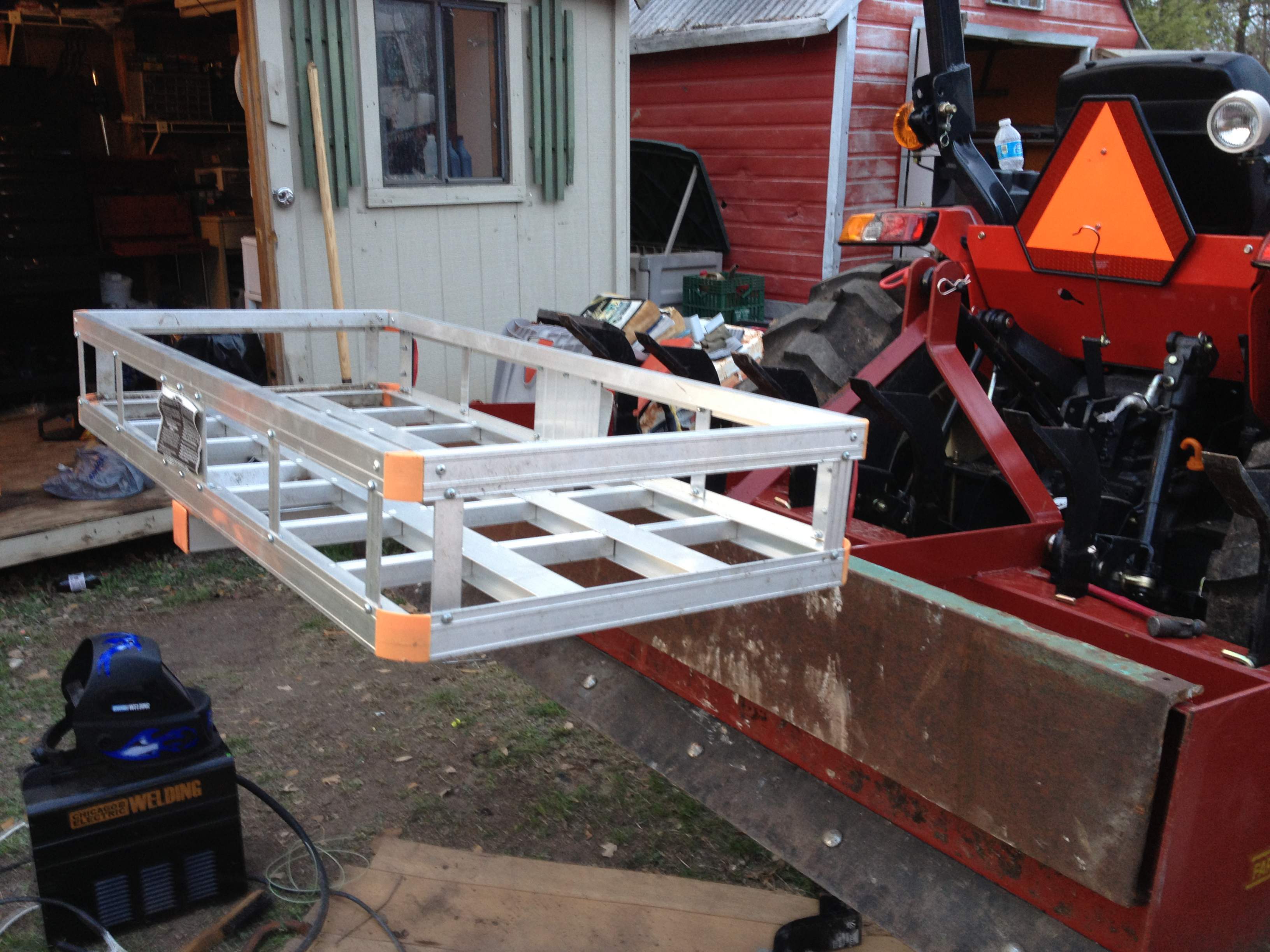

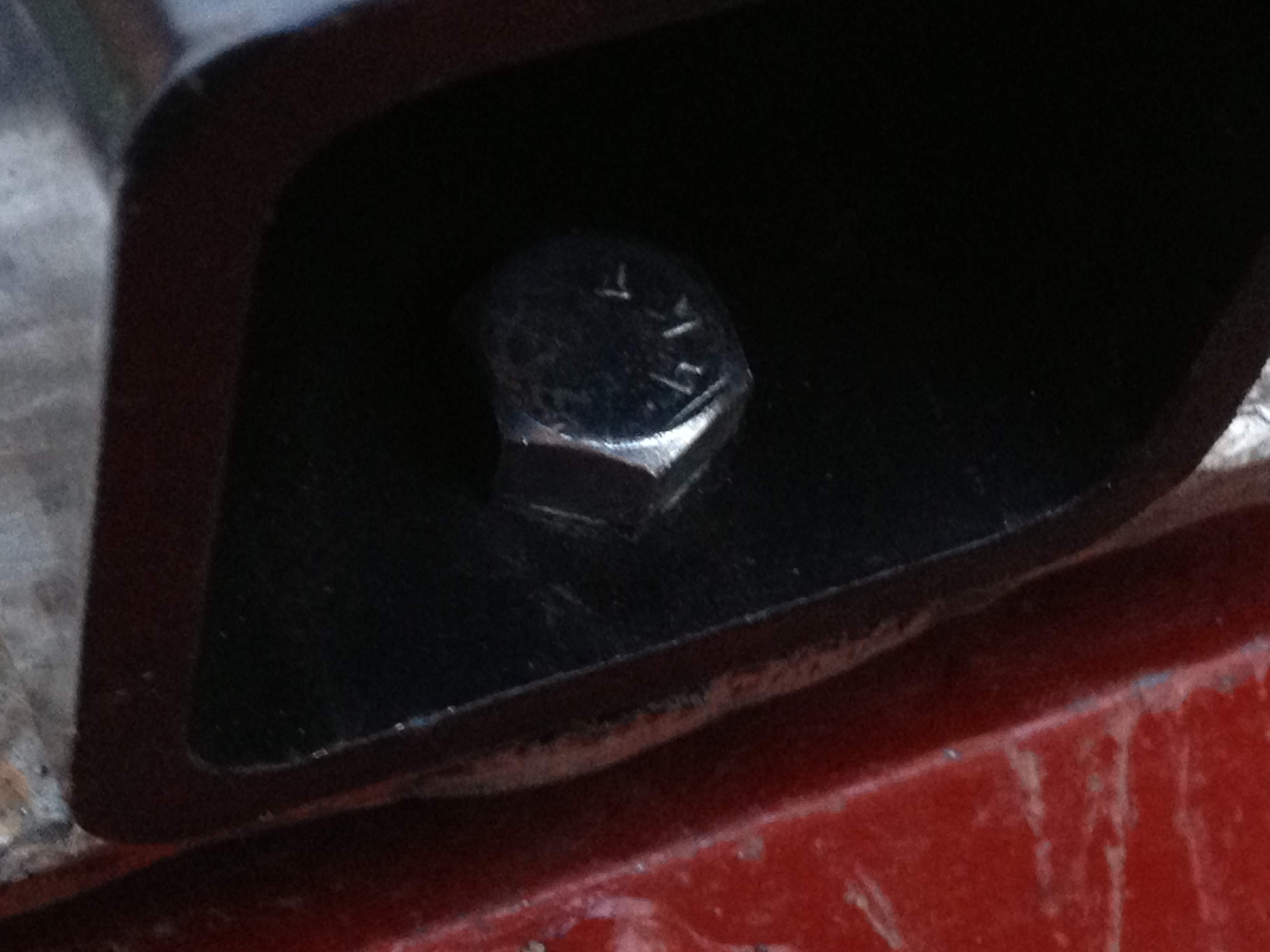

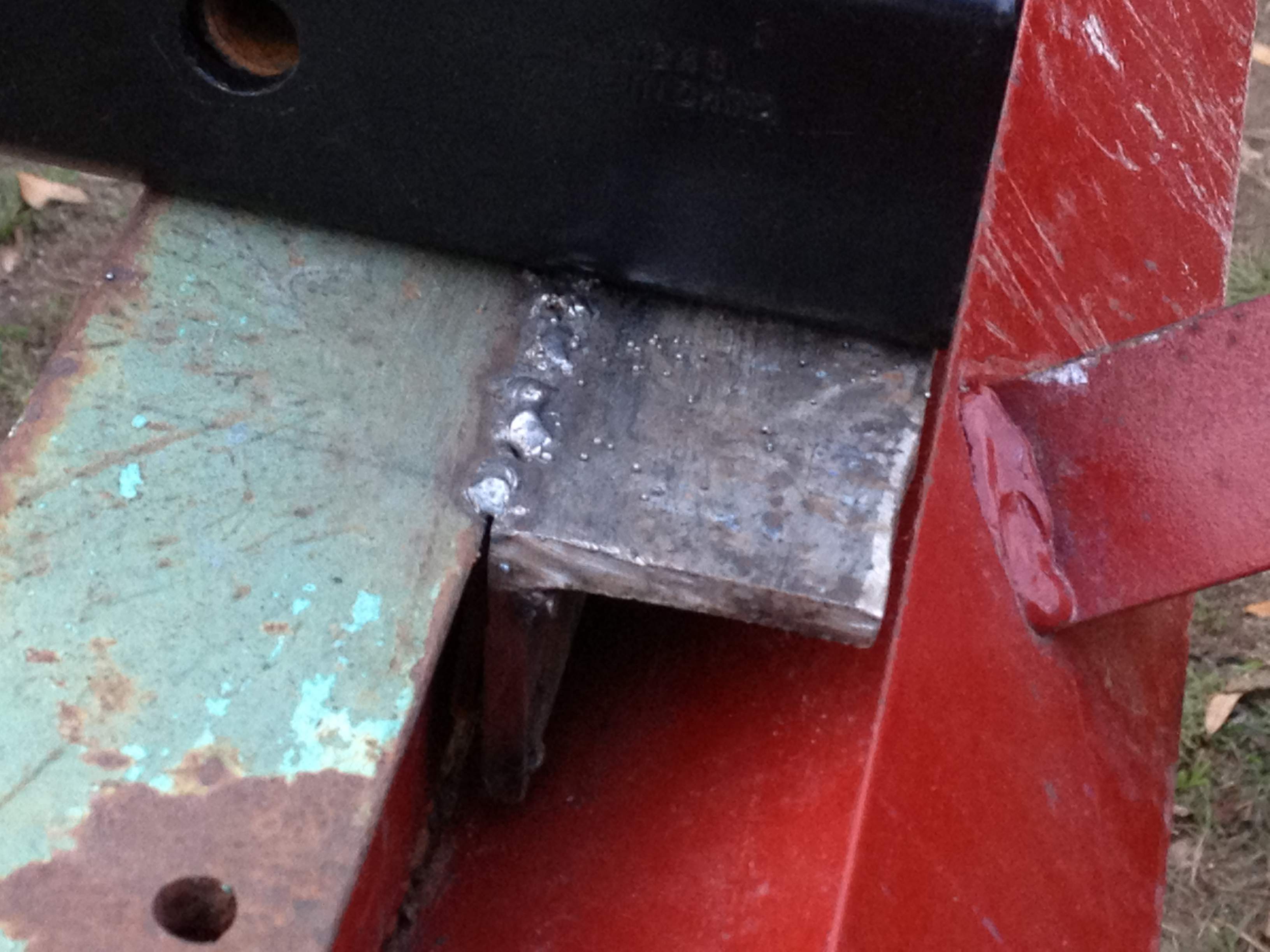

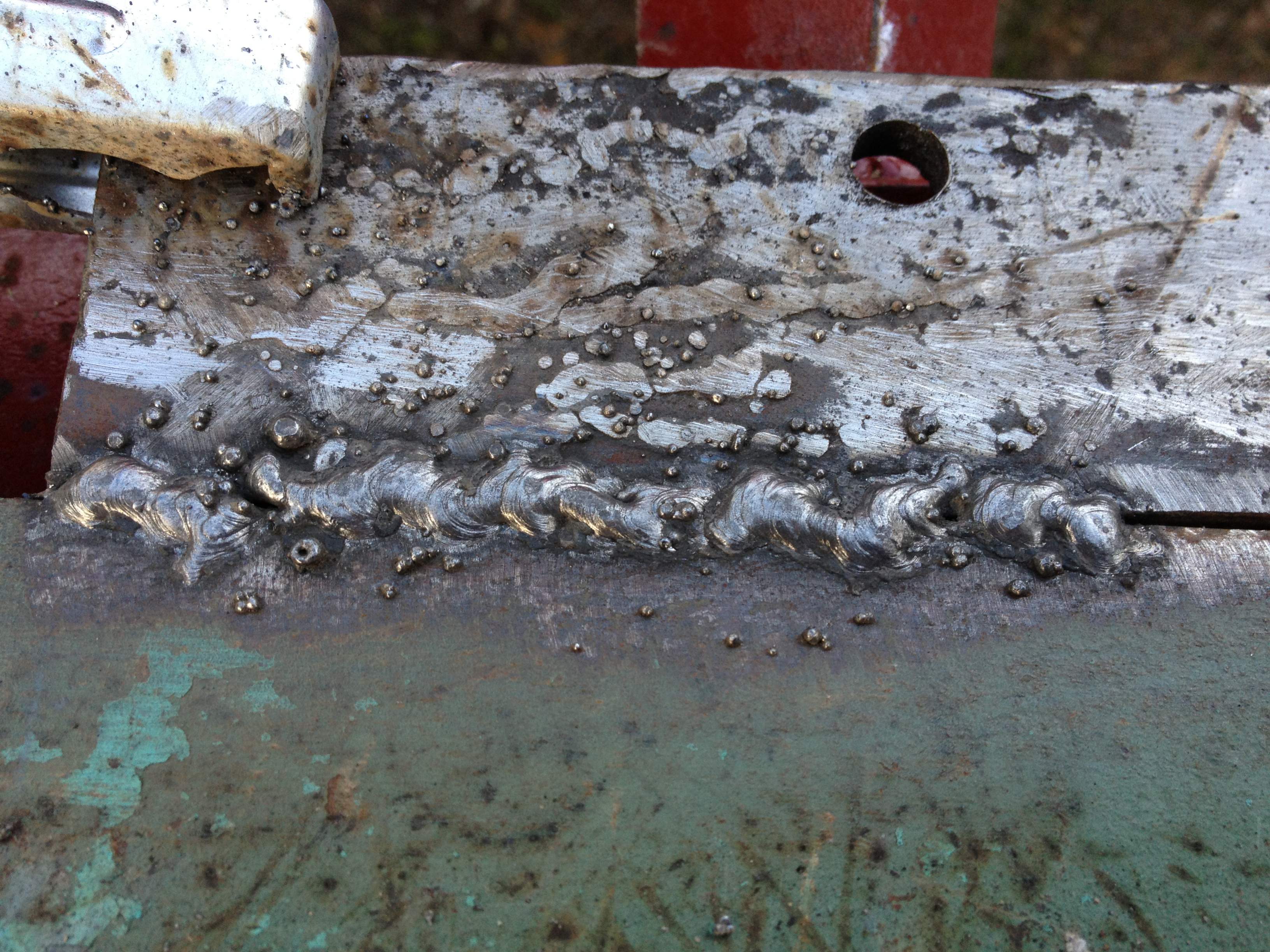

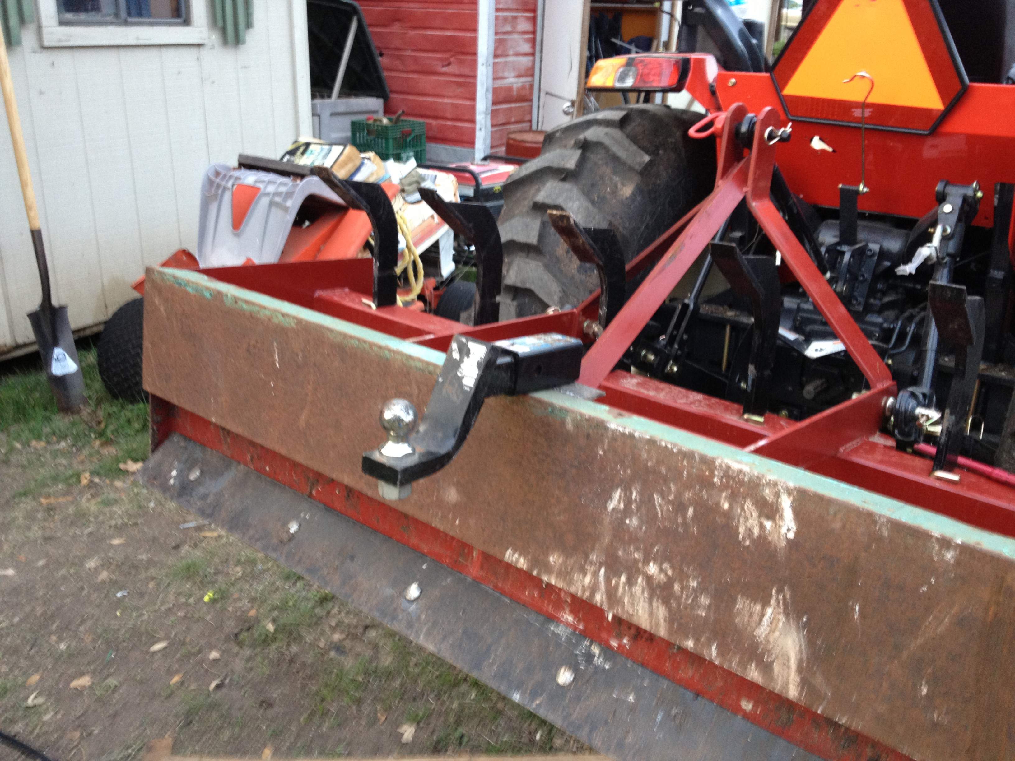

Been reading posts about how to attach a trailer hitch to the box blade. This is what I came up with. I added a large old steel ramp I had laying around to give the BB more weight. (about 100 pounds) Not very pretty, but will paint when I get it all done. I wanted it to be removable so I welded three pieces of angle iron to the back, so it just hangs on the box blade. Worked pretty good, except when backing up, it would lift up and fall off if I pushed a large rock. Gonna use small screw type binders to hold it down on the bottom. I welded another piece of angle iron in the middle opposite of the first one, to give me more area of weld for the reciever tube. Then drilled a hole for a bolt for added security. I had a hitch carrier that I bought a couple years back at HF, that we were going to use on our camper, but sold the camper before using it. Gonna be a great way to haul my tools and chain saws in to the woods.

You need a little more heat in them welds .
