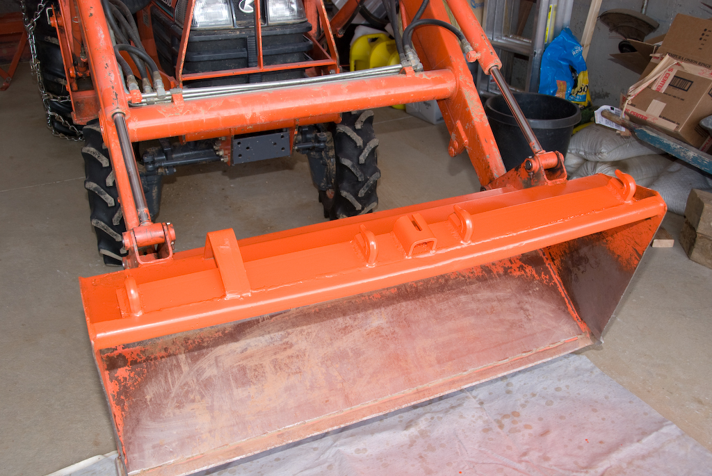

The first modification was the addition of bucket hooks. Since I don't have the equipment or skills for welding I had a friend of a friend that lives close by do the welding and he did an excellent job. We used a 2" X 3" X 1/4" piece of angle to provide support and welded the hooks to this. The picture below is just after I finished painting.

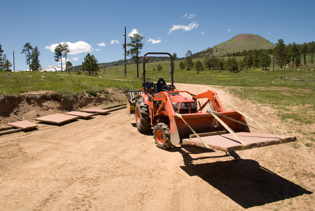

It seems like a lot of hooks but they have all come in handy for pulling fence posts and general lifting. One of my summer projects was to rebuild my walkway from the house to the garage that is made up of 3" thick flagstone blocks. I had to move them all out of the way, prepare the area and then move them back. The following picture shows how the bucket hooks were used to do this.

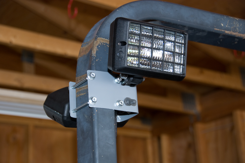

My next modification was to add extra lights for night work. The following picture shows the bracket I made and how it was mounted on the ROPS. The electrical connection was easy since the tractor has provisions for adding a work light and I just used that wiring.

the lights look great. I did something similiar to mine, use them all the time now. Mostly moving snow. Is the the receiver bar on the FEL for a hitch and ball? enjoy.

Your flagstone shot looks like you are near the "Peak to Peak" highway between Nederland and Estes Park. Pretty area.

dnafziger: Thanks for the comments. The thing in the middle is just another type of chain hook that allows me to pull straight from the center.
mjncad: Good eye. I live in the Sugarloaf area. Closer to Nederland than Estes Park.
