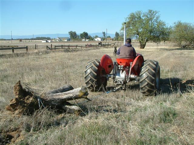

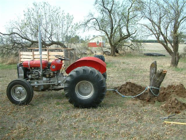

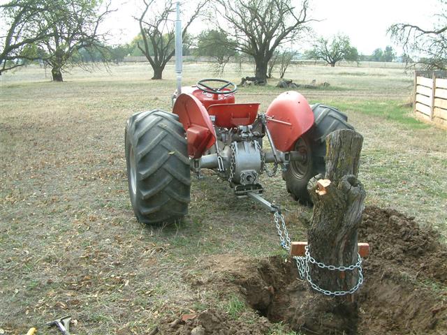

Don't know what your tractor budget is, but almost any CUT can be rigged to safely mow on slopes like yours. For example, here's my 1964 Massey Ferguson 135 diesel that I bought in 2006 for $3600. It's a field tractor that's been modified by the previous owner for work in his olive orchard. He replaced the 28" dia rear rims that you usually find on a field tractor with 16" dia rims carrying B.F. Goodrich 18.4-16A tires and used shorter spindles on the front axles to keep the tractor level. You can get these rims and tires from Les Schwab Tires here on the West Coast.
DSCF0021 (Small).JPGDSCF0023 (Small).JPGDSCF0016 (Small).JPGDSCF0017 (Small).JPG
Something like this would handle your mowing chores safely and without putting a big dent in your wallet.
