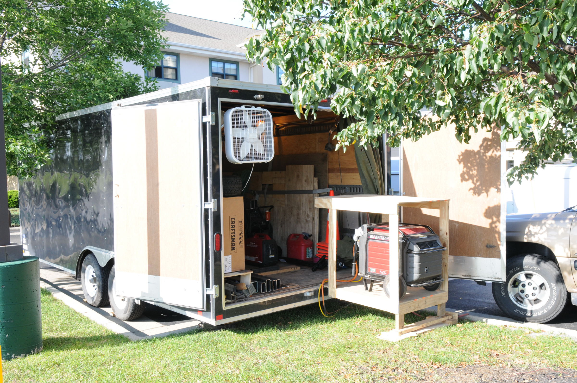

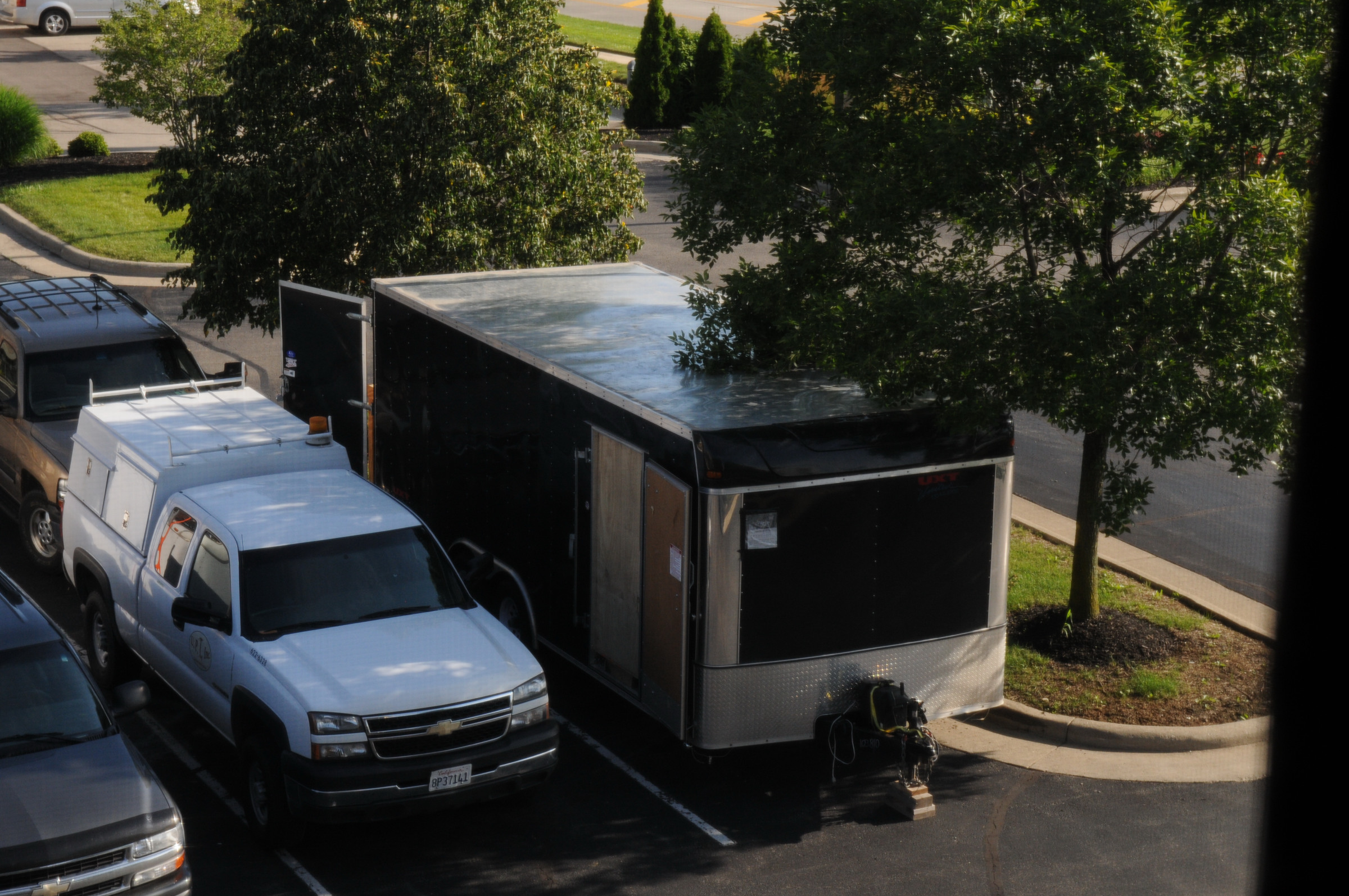

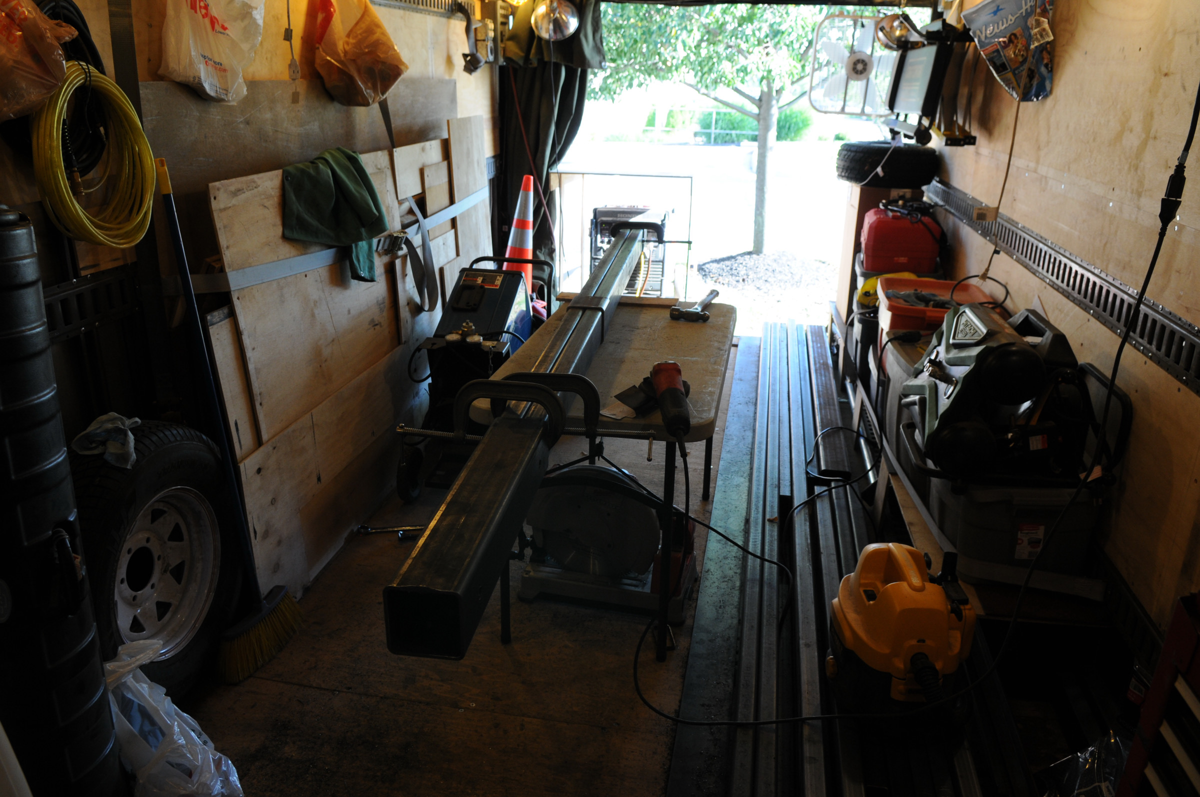

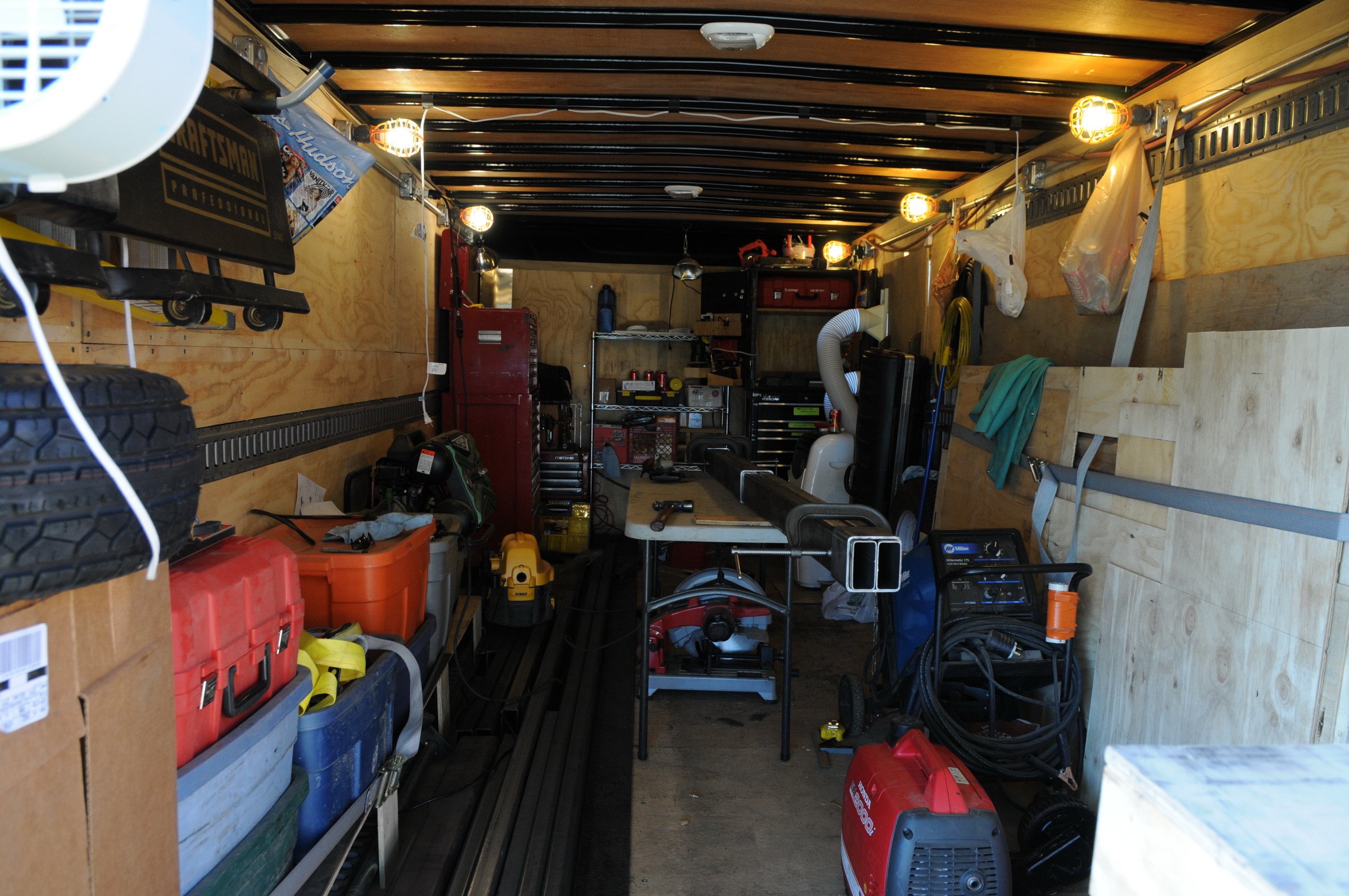

Oops, forgot to explain the picks. The black trailer is usually my Kubota's home, but right now it is my workshop. The piece on the table is will be the tongue. Two pieces of box tube that will be welded together to make the tongue.
