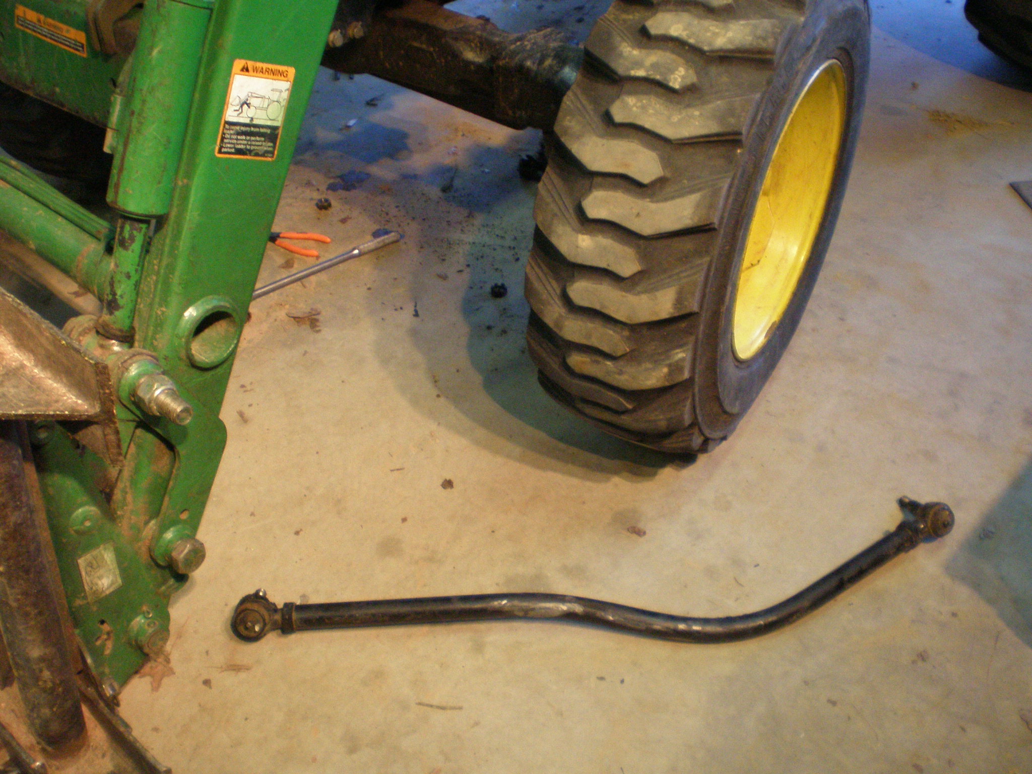

Bent mine on Saturday last and my neighbor straightened it for me (I helped!).
called deere for a new one - $450 - yes $450 OMG! This was my 1st major FU after 400 hours on the 4610 - my 1st tractor so I've been fretting every since - get robbed for a new one - build one out of DOM - just keep driving.
So now that I've read this and I've already got the angle iron the choice is made ... got to love this forum!
THANKS ANDY!
Before the 20ton press etc.. pic

Interlaux,
Although yours is fixed it would not take too much effort to make a new one from Chromoly tubing, some thread adapters and reuse the tie-rod ends. Any place that sells race car supplies could help could provide the necessary parts. $450 is crazy!!!
Jeg's is a good source for thread adapters if they can not be purchased locally. They make ones with a hex, but I couldn't find it. Here's a link for smooth ones. QA1 Smooth Tube Adapters - JEGS
   / My Strenghtened Tie Rod #9
yep.. i would prefer a new fab that a repair as the repair may bend again easier unless reinforced or really reworked.
since this posting I've probably made 2-3 more sets of draglinks for tractors I refurbed.. easy to do with stock ends and heavy wall tube and some thread and or clamping hardware..
