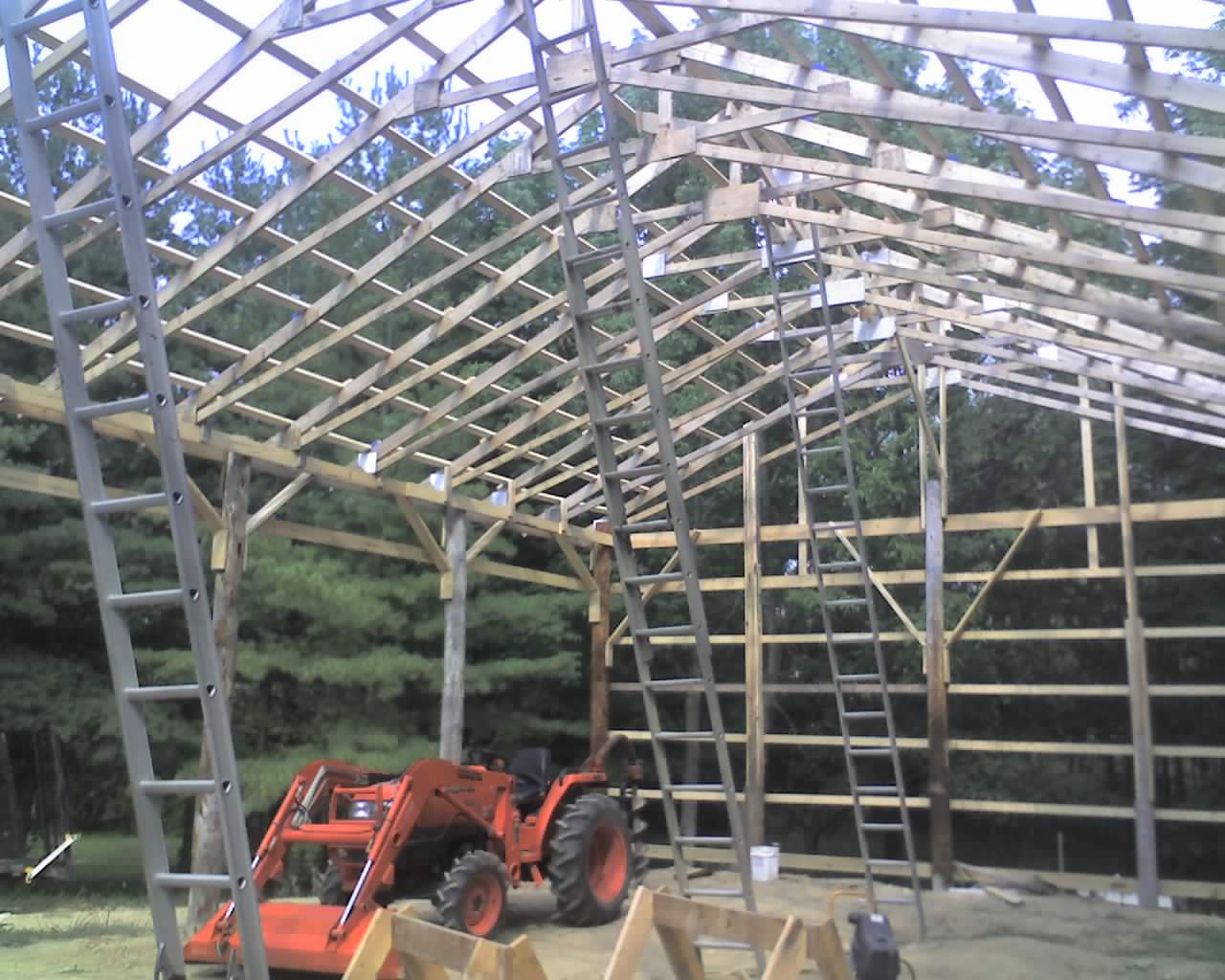

A link to some pictures of my sons new shop, 1800 square feet with 12 foot sidewalls. Two of the pics are video of the rafters going up using my 5040 Kubota and my homebuilt tractor. The homebuilt has a cage on the back we only use every couple years but it certainly works nice. If you watch the videos do the second one first then the first one as they are out of order. Once we got a system going they went pretty nice.Flickr: Alan Gage's Photostream

Nothing to compare it with. But am very pleased with the tractor. Bought with 675 hours on it, now nearing 1000. Son says it is the coolest thing I ever bought.
He used both it and the home-built to good effect during his build. For the few materials and time it took to build the 4x6 ft. cage on the back of the home-built it has saved us time over and over again. Every time we do something seems it is just the right height. Nice to have the railing to hand onto or lean against. Takes very little time to put on or take off.

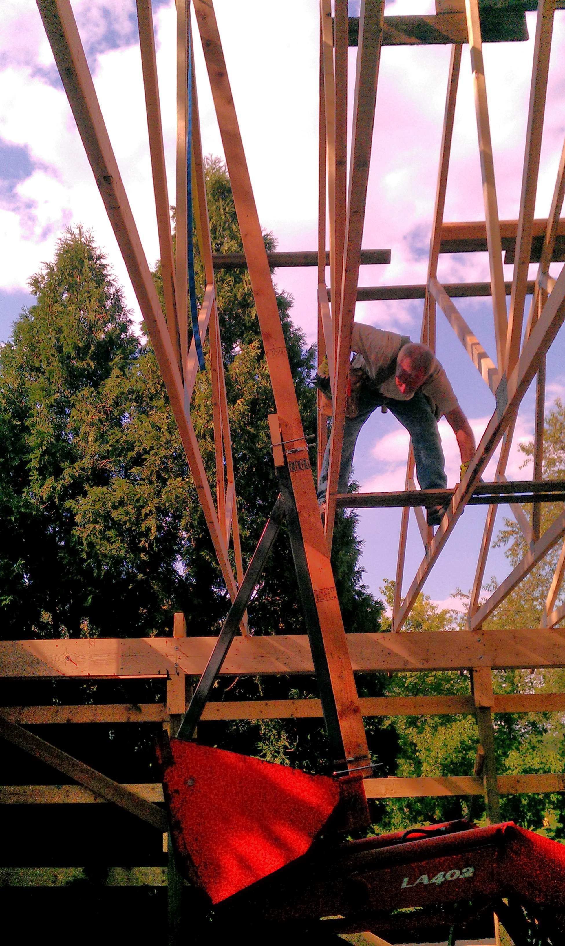

My trusses were 30' scissor trusses with a 1' overhang. Most of them were done from inside the building. Once we got to the point that you could no longer spin them to clear the walls, we could reach from the outside gable end easily.
I have no doubt your tractor would have handled it. We did them with my 3400.
We attached the boom with a 10000# rated ratchet strap. IT was the 3-leg TV tower type. put one of the flats, flat against the bottom of the bucket. Ran the strap under the tower, over the bucket, under the tower in the back, back over the bucket.
The tower itself I doubted would be strong enough to support the truss. So from the top lip of the bucket, we attached another strap out to the end of the boom. Kinda like you see support cables coming from toe top of a crane and attaching down by the counter weight.
Tractor had no trouble handling the weight and height. I would guess the trusses were ~150# and there were 6/12 pitch setting on 13.5' walls.
No pics of the boom setup, but here are the trusses. Those are 20' sections of a 40' extension ladder. So it was a ways up there.

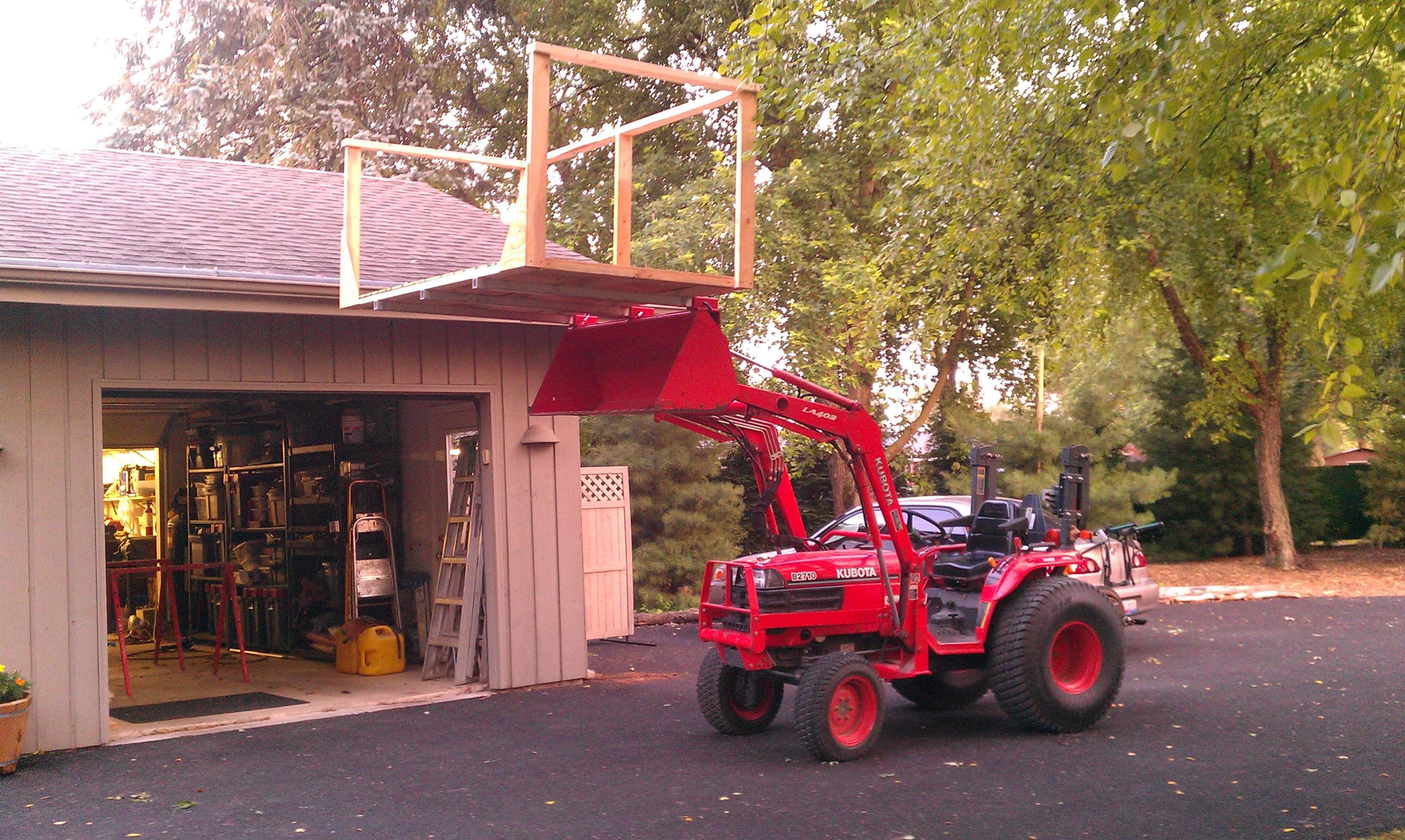

I made a boom that fit on my bucket, I have 2" receivers welded on so I can attach different hooks. I made the framework for a steel boom out of 2" receiver tube, then u-bolted a 4x4 that was about 15' long to it. Did it all from inside the building, by wiggling the tractor around, I could get the boom in between the 2' truss spacing. My trusses were 32' long with 2' overhangs. Tied ropes on each end of the truss, helpers used those to guide truss into building and over one wall, then over the other. I also included picture of the scaffold I put on the bucket using the receivers, used that to do almost everything on the building.Carrying truss.jpgSetting Truss.jpgTractor boom.jpgIMAG0397.jpg
