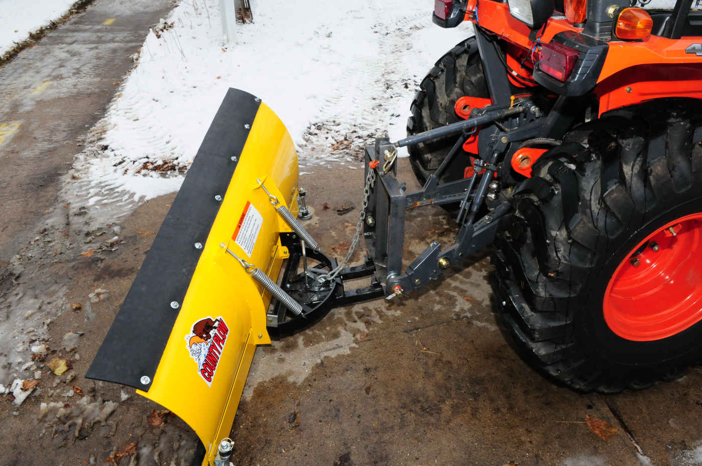

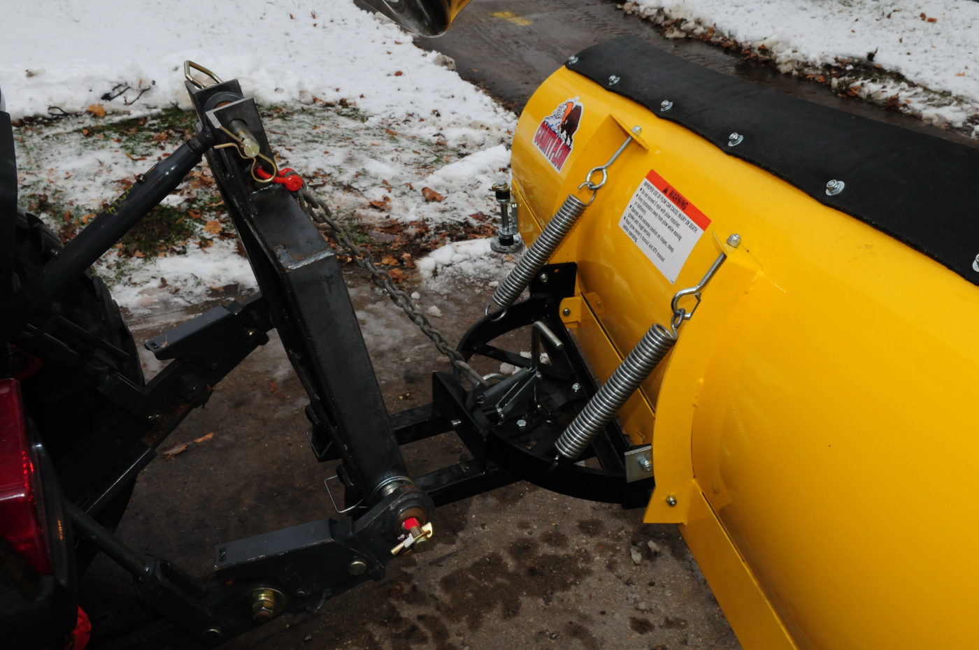

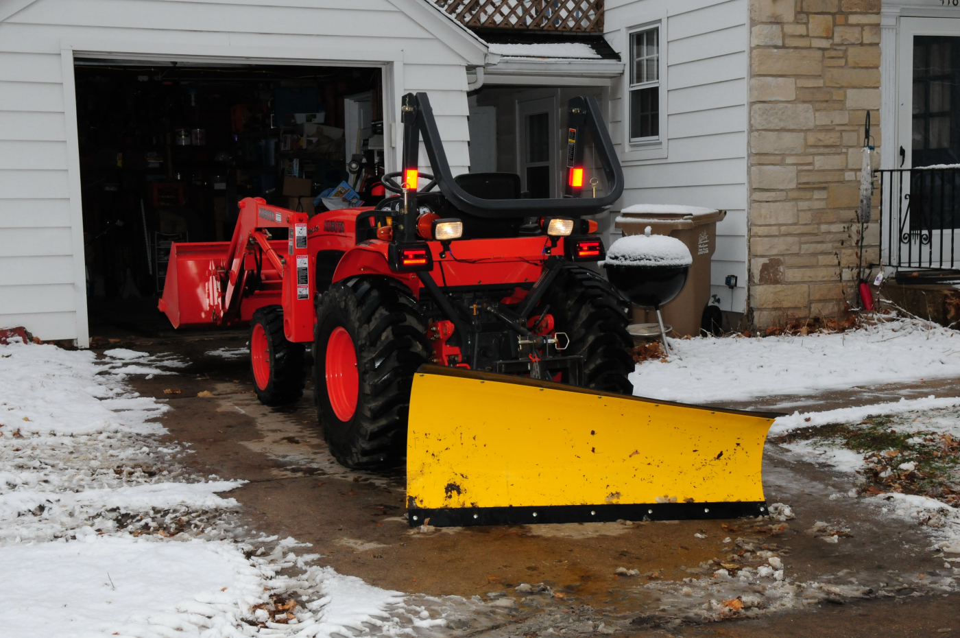

I bought a 60" plow blade for an ATV. Got the blade mount really cheap (it was a leftover from a '90s model). I modified the mount and built an adapter for the 3pt. Total of about $400.00 and 6hrs fab and setup time.
I have concrete drives and sidewalks. They have a lot of cracks and bumps. I still need my FEL ready for other uses. So I needed a rear mounted snow removal solution. Blower are too big, expensive, and I don't have a cab to block the blow back. A standard rear blade doesn't have any give. I didn't want to break anything if it got caught.

Thats a nice looking set up and it looked pretty simple also. Good job!
   / My solution to the back blade for snow issue on my B2630. #4
Looks good. My rear blade catches stuff all the time. Wish it had trip springs on it:(.
   / My solution to the back blade for snow issue on my B2630. #5
Looks nice bw wis:) Be careful though. I bent the turnbuckles on my tractor when using my back blade too aggresively for ploughing snow backwards.
   / My solution to the back blade for snow issue on my B2630. #6
I would think that your turnbuckles would be safe with those trip springs. It would be risky without them. Your neck will feel the strain. Been there!
   / My solution to the back blade for snow issue on my B2630. #7
Nice looking setup.
