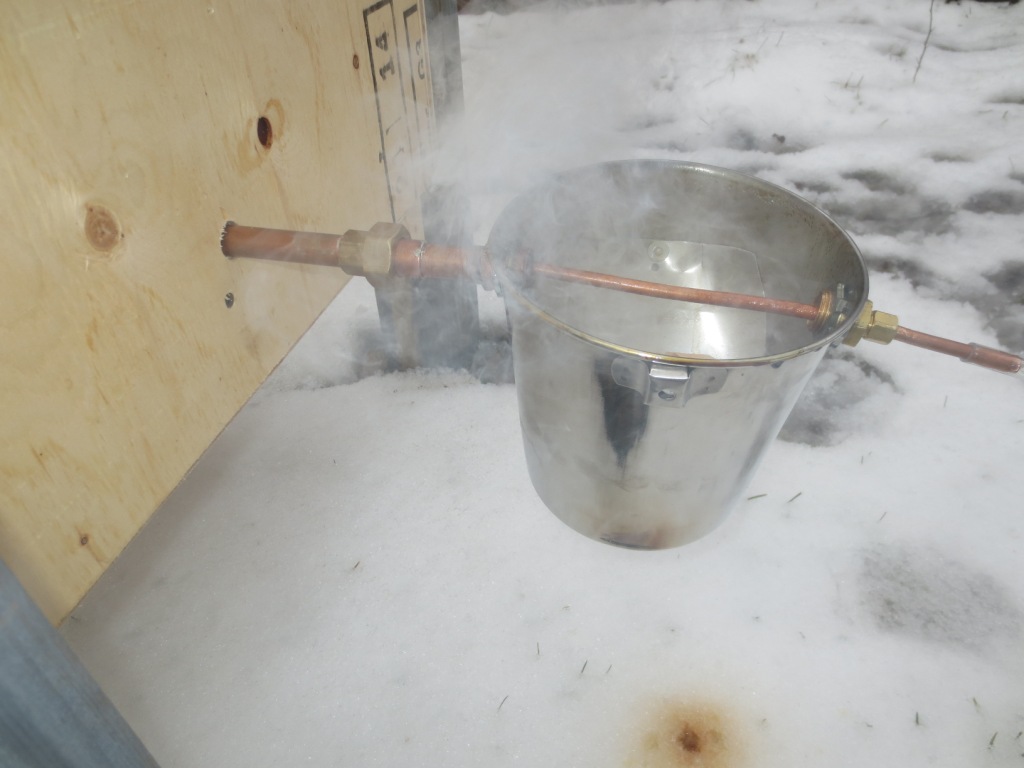

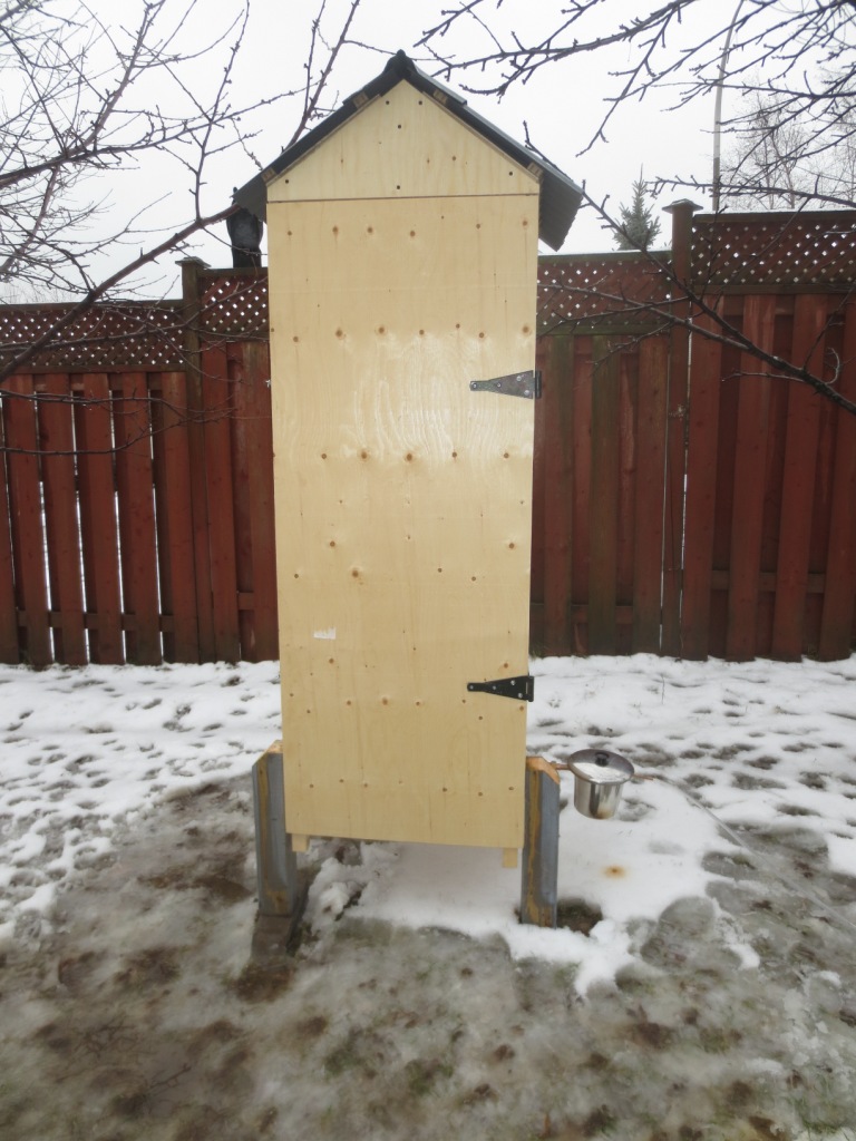

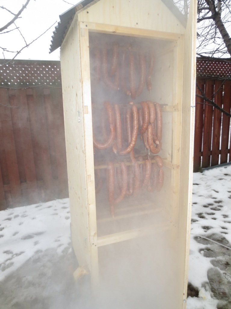

A friend of us smoked all the sausages and hams for us last year, but this year after we saw how much meat we have, I decided that is too much work for him to do it, so I built a smoker myself. Here is the result; quite happy to see that is working and hope my neighbors will not complain.
It's a cold smoker style with a smoke generator outside the box. I connect the venturi tube to my compresor and with one load, the smoker runs for around 1.5 hours.:cool2:

Can you tell us more about the smoke source, and how the compressor figures in? Looks pretty cool!!

Here is a good video with some graphics to see how a smoke generator using Venturi effect works. Instead of aquarium pump I hook up my compressor with pressure adjusted to minimum. I used 1/2" copper pipe for outlet and 1/4" tube for air inlet.
https://www.youtube.com/watch?v=nDcfAWf_6rM
There are all kind of styles for a smoke generator, just make a search on you tube.

Very cool! I've been looking at smokers alot lately. Not sure if I'll build or buy yet. Are you worried about the glues and chemicals from the plywood getting into the food? Might not be a factor with cold smoke. Is it lined with tinfoil or anything? If I build that style I'll probably do tongue and groove pine boards with SS screws. Maybe being over cautious. Dunno.
