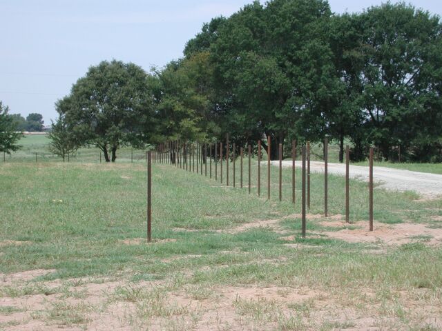

I finally got the time to start setting some posts this week on my fence project. Let me start out by saying that perhaps the end of July/beginning of August is not the best time to start a large scale outdoor project in Texas. It has been hovering around 98 degrees for the last two weeks, and it has been pretty slow going. I am setting the posts about 3' in the ground and putting 2 - 80# bags of sacrete per hole. I am mixing the cement in a wheelbarrow, then dumping the cement in each hole. Next I line up the post and level it. So far I have gotten all of the corner posts set, and have set about 80 more posts. I figure that I have about 300 left to go now.
Did I mention that it has been hot here?
I have attached a picture showing some of the posts I have gotten set so far. They still have not been cut for height.

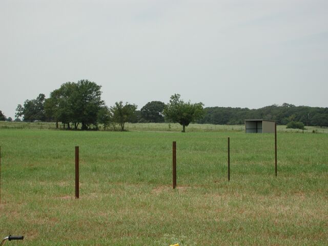

Here is a picture of a set of gate posts. These are 4 7/8" OD pipe, and man are they heavy. I set the gate posts about 4' in the ground, and used 3 - 80# bags of cement per hole for these. These gates are not too heavy (about 80 lbs per gate), so I think that this should be fine for these gates. For the front entry gate which is pretty heavy (about 200 lbs), I think I will have to try to set them close to 8' deep.

You can solve part of your problem by running cable (wire rope) from the top of the gate post to the bottom of the adjacent post and putting in a turnbuckle that will allow you to tighten the cable as the weight of the gate causes the post to begin to lean. A solid horizontal bar between the two posts will also increase the strength, but the real advantage comes from the triangle affect of the cable pulling the top of the gate post toward the bottom of the adjacent post. The turnbuckle also provides for adjustments a year or so down the road, to keep the gate level and swinging properly. A second cable and turnbuckle from the gate post to the bottom of the far end of the gate will keep the gate from sagging, also. I hate sagging gates /w3tcompact/icons/clever.gif/w3tcompact/icons/tongue.gif.

For a sturdy gate make the hinge post about twice as tall as the gate and use the bracing method previously described. Also Make the hinge gate post taller and run bracing from the top of it to the top of the free end of the gate. This all depends on wide the gate is.

I had a question for ya, if you don't mind? I know you like to join your top rail only over a post, but my thought was to use short pieces of slightly smaller pipe (maybe 2' or so) which would fit pretty close inside the other pipe, and tack them half way inside one piece, and make a sort of a connector to hold the two pieces in position while welding the two together. Any thoughts?
Thanks everybody for the advise on hanging the gates. I am somewhat familiar with the diagonal bracing methods, but would like to have as little cable as possible around, as the ends which always seem to fray, can be a little rough on horses, kids, etc.
