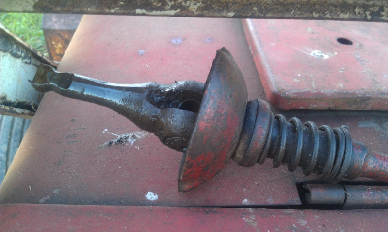

I did take the shifter out, I will try to post a pic of it. It doesn't look too bad compared to some. I removed the bolts from the top of the transmission case and realized that there are hydraulic hose that are in the way. I guess I have to remove those? :(

All good stuff here! The reason that this happened is as he said that the shift lever is worn on the end and when it is apart it is the perfect time to do a replacement or adjustment with welding a grinding.
What has happened is just wear, it's not unusual! For some it happens quicker then others.
The original shift pattern is a modified H pattern which is very common for standard transmissions. Whats happened is the ball on the bottom of the shifter has worn so that it has slipped out of one of the shift rail slots. All things in a perfect world we would not have tried to slide shift it and always made a perfect H shift. To just line it back up and install the shifter again still leaves the chance for it to do it again! It normally happens with an unfamilar operator first!

Here is a pic of my shifter, what do you guys think?
