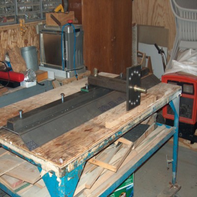

Well after doing some shopping I've desided to make my own rear grader blade.
Now I need to find the material to make it. It took me about 4 weeks to get everything I needed to start doing some sub assembly. So far I.ve cut the lift saports for the 3 point hitch, And made a jig to help a line all the parts.
The attacment shows the lift frame before welding. /forums/images/graemlins/smirk.gif

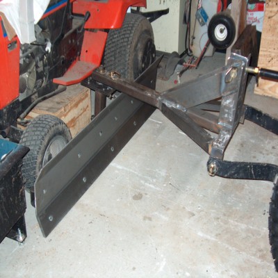

Now that I have the Lift ready for welding and the blade ready to be installed.
So after about a hour of welding and a few more minutes to grinding. I'm ready to do a trial fit. And here is what that looks like.

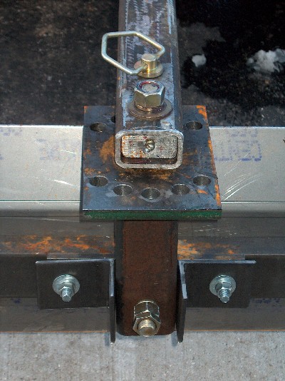

Neat project Bob_K. Looks like a great job to me. It would be interesting to see a close up of the blade pivot.

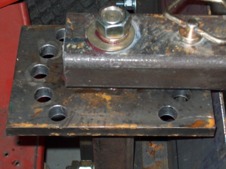

Per your request Whiterock. Here is a picture of the pivot points.
As for the Cost not to bad Most of the items where drop off material or scrap item laying around.
I do think after I add the Paint total cost around $50 to $60
Did the primer tonight and I will post a finail piture after I get done with the Paint job. In a day or Two... /forums/images/graemlins/smirk.gif

   / My next project Rear grader blade
#9
SIde view of the pivot point
