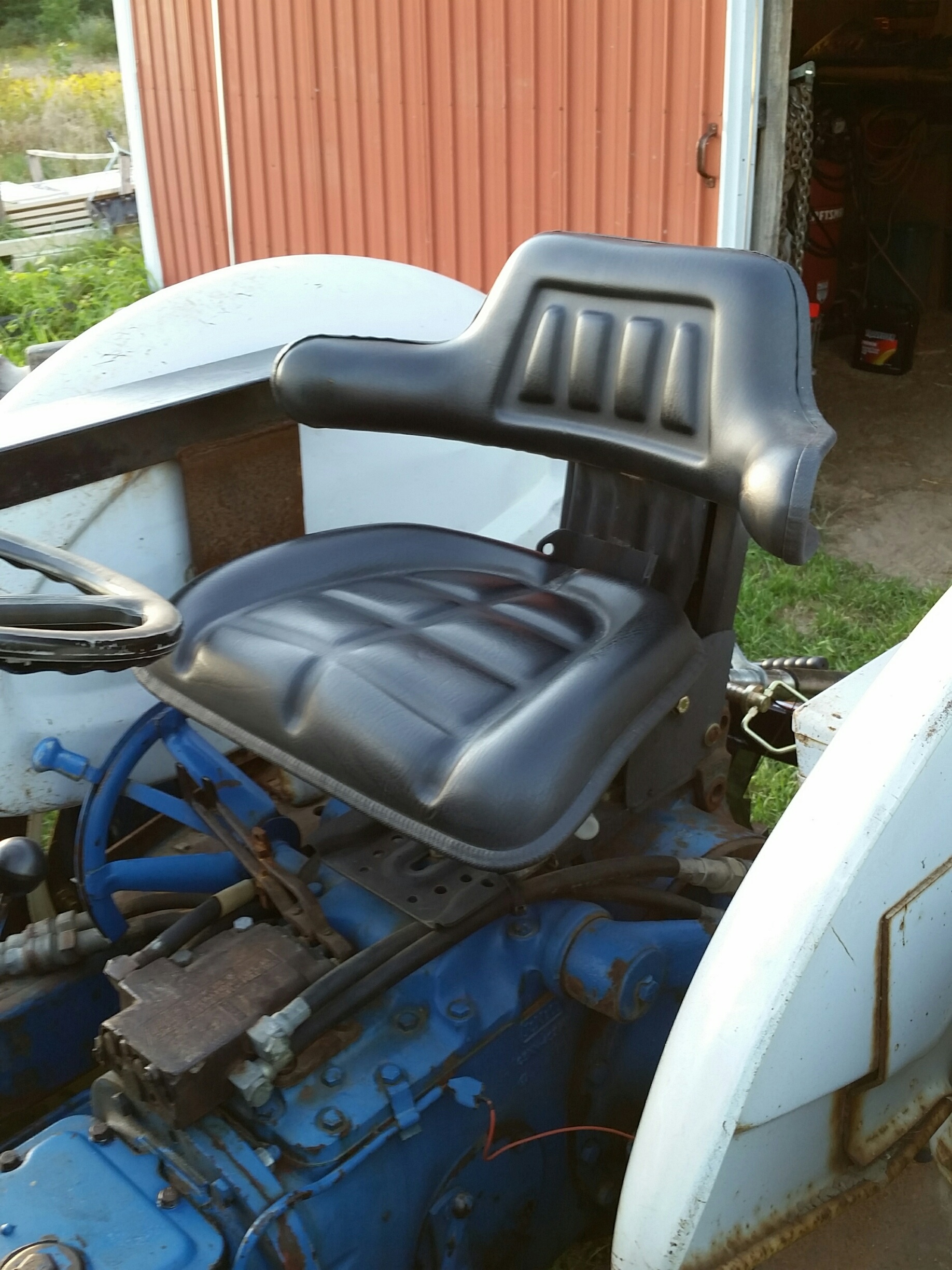

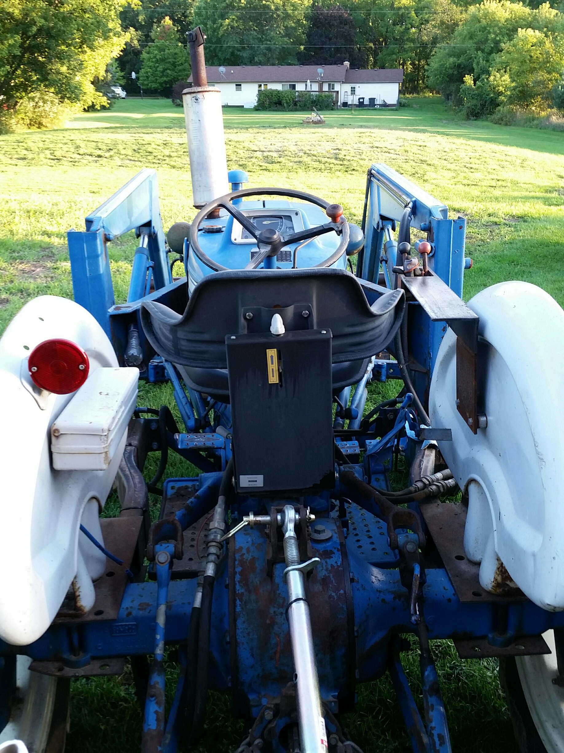

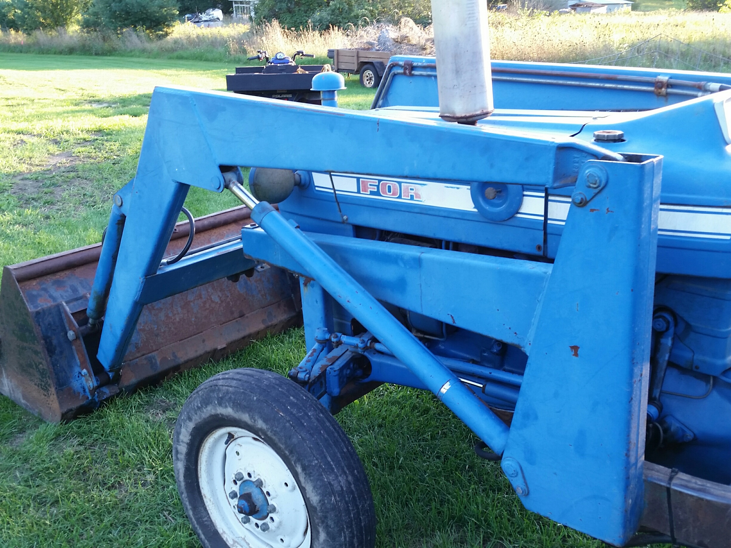

I was given this tractor from my uncle who inherited it from his father. my Uncle already has a kubota and a skid steer. He said the last thing he needed was another tractor. Anyway i'm not to sure what exactly I have.
I know it is a 1969 37hp gasser with a FEL added to it. Im not sure what brand FEL it is or what the hydraulics system is. I know i would like to do a crank driven hydraulic pump and run a joystick to control the loader. Unsure what exactly i need right now to do that but i have been researching. Thanks for any help you can give me on the FEL.

Nice looking machine. It looks a lot like a factory Ford loader and I agree that a crank driven pump would greatly improve the speed of the lift and then you will have extra ports on you spool valve. There should be lots of used brackets and pumps out there for the retrofit.
   / My new to me Ford 3000 with FEL. What do i have? #4
What you have is a headache in the making. The front end components will not hold up when you start doing loader work, radius rods will bend or break, spindles will break and bushing will wear out. Don't be conservative on greasing the front end zerks, if grease is running out then there is plenty in it. The pivot pin will take on alot of wear and the bushing will also wear down to where it is into the axle support. The front end on the 3000 is the same that is on my 3910 and everything I mentioned above has happened to mine and while I've handled some heavy loads I haven't abused it.
The crank driven pump will provide alot of hydraulic power, there is one made that will mount under the fuel tank to the rear of the engine between your clutch pedal and power steering pump. There is a trapezoid looking plate on the block that comes off and that is where it mounts, not sure of the internal plumbing that needs to go on where your current spool block is as I bought my tractor used and it came already plumbed with the pump.

I'd be more concerned about blowing those front tires overloading the FEL than adding a ballast box. Load the rear tires and keep the weight off the axles. That tractor is pretty heavy as it is. I agree that a dedicated pump would improve speed over the factory 5GPM but that may require a dedicated fluid system too. The 6 gallon tractor system is pretty small and could overheat quickly. The rule of thumb is one gallon of tank to one gallon of flow (GPM).

I can't say it is not a factory loader - but it is not a 730 or 735 and the mount design for the cylinders looks more like an Allied loader my buddies Case tractor has.
Not sure who built it.

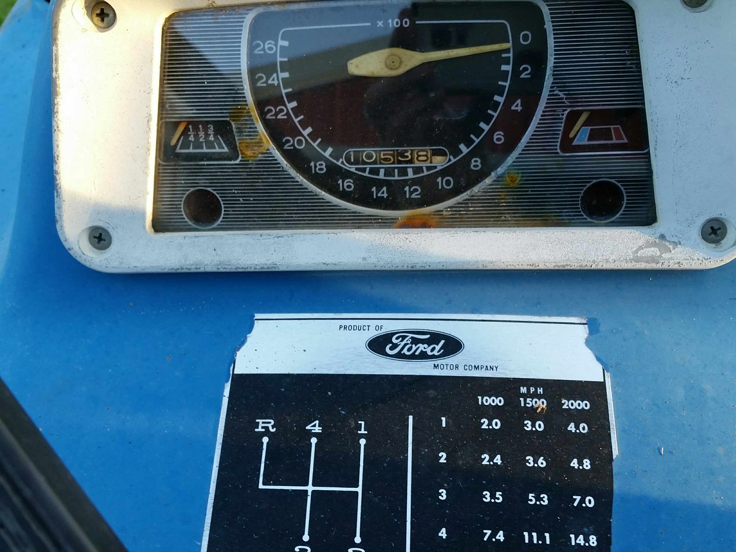

Thanks for the replies. I have been reading on the weak front ends on the 3000. Is there any upgrades or ways to strengthen the front axle? My main purpose will be yard work around my 9 acres. hauling tons of firewood until i'm caught up with the dead standing and on the ground stuff. I would like to get a back hoe to dig some ditches and a small pond. it wont be doing anything super serious, just outside enjoying the fresh air and the property. With just over 1000hrs on it i can tell it has been babied. My uncle said the tractor was like a car that was driven by a little old lady to and from church on Sunday.
