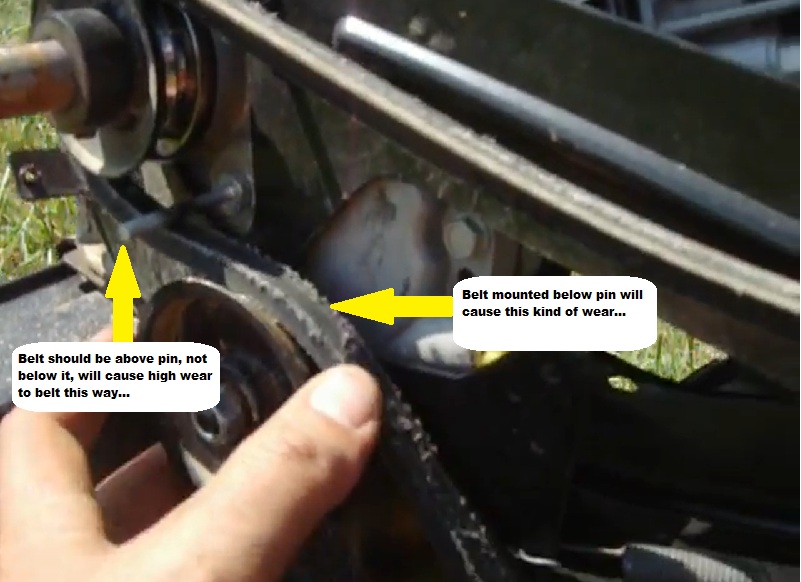

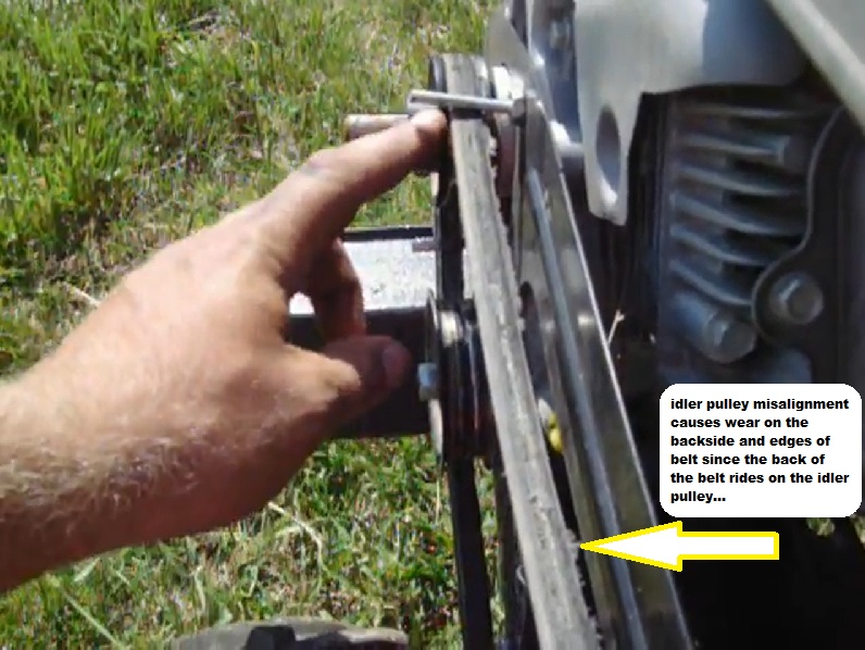

Made my first complaint to the BBB today. I bought a new Husqvarna garden tiller. The handle broke first day. In shop for 3 days only to be told its on back order. Had them weld it on. They welded it crooked. Started using it again, the belt was sticking behind the cover. Took it back to the shop. They said they put a shim in. They lied. They bent it and it misaligned with the other belts. I didn't know this until it shredded the belt. I asked for a refund, I'm done with this tiller. They said no. I called Husqvarna, they said no refund, want me to take it to another dealer 50 miles away. DO NOT BUY DRT900E garden tiller, Total Junk.

I would put most of the blame on the dealer, and I hate say this but just because you got one that has problems does not mean all of them do. It looks like you have a unit that should not have passed quality control.
Whoever put it together and worked on it does not know what they are doing.
One of the wheels is backwards, the belt is mounted wrong causing undue wear... see pics below. (proper belt placement shown in manual)
It is under warranty, take it to another dealer and have it fixed properly. After all issues are attended to, it should work as advertised.
