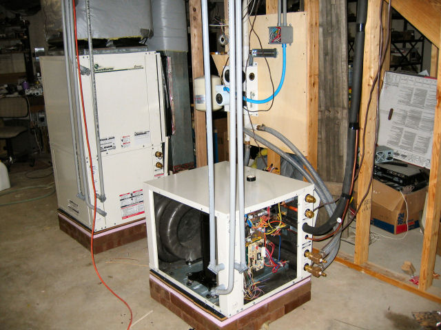

As for the geo system, I finished my installation in early November. I put a lot of time into it, and as usual things did not go as planned. I did the ground work in mid September, planning for it to be cooler out, but we had a hot stretch in the 90's That was a challange. Then I did my swap out of my seconf floor unit in November, so it would not be hot when I was in the attic. Sure enough another hot spell in the mid 80's The attic easily reached the high 90's as I worked on my hands and knees. Again I suffered. My new air handler for the attic was the same model as the original, but 19 years newer. Sure enough all the dimensions had changed, so a lot of duct adapters had to be fabbed.
In the end the system is running very well. Register temps are around 95 degrees, so if feels a lot better. Also on the 15 degree nights, instead of the all night non-stop runs of the old air heat pumps, I now get 20 minute runs.
Best of all is the fact that the performance stays up there even when it is 10 degrees out. My amprobe reads about 7 amps per unit, or about 1700 watts. About the same as a window A/C unit.
It was somewhat costly and a lot of time and effort, but well worth it.
