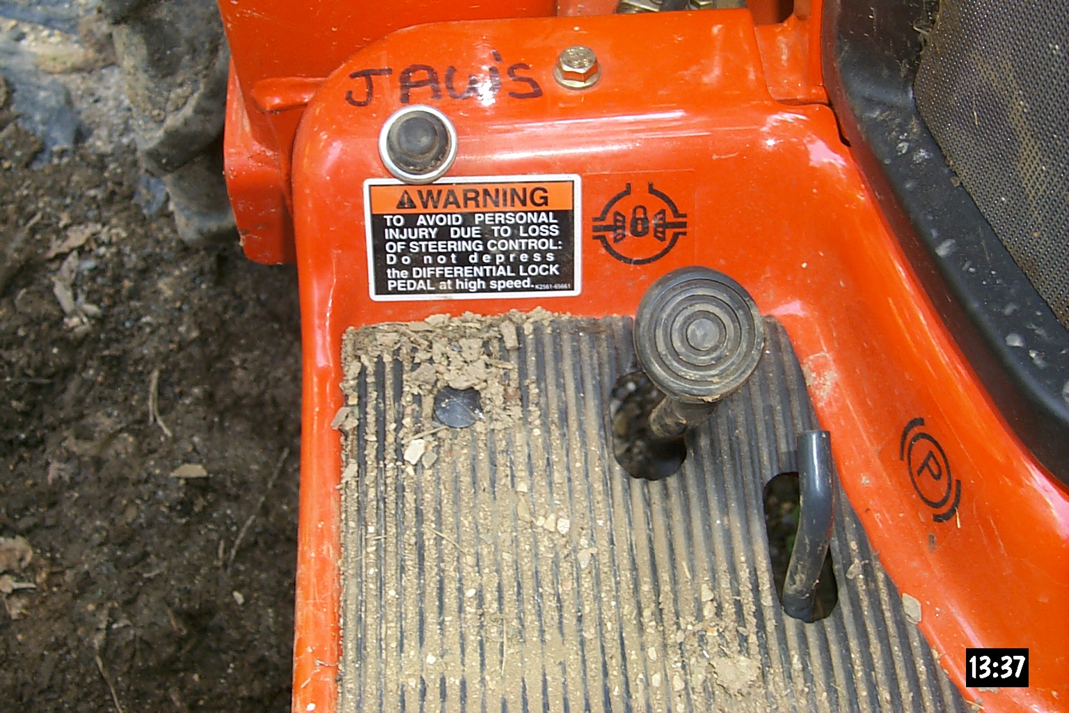

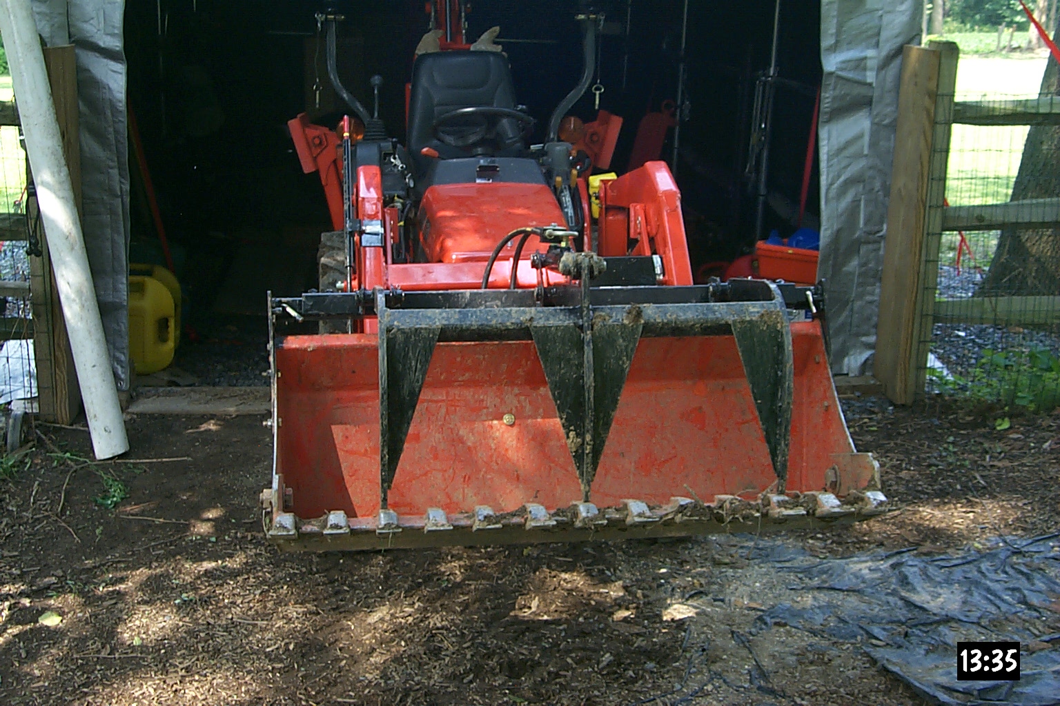

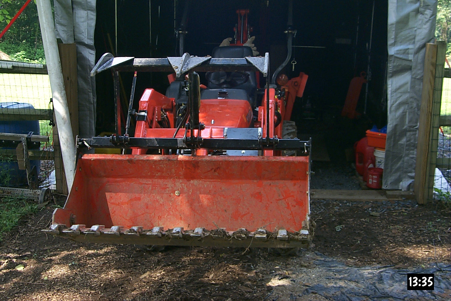

Hi All,
I am somewhat of a new guy here and this is my first post so I hope it is in the correct section of TBN. I have a BX23 with Fel and Back Hoe and many other assorted attachments.

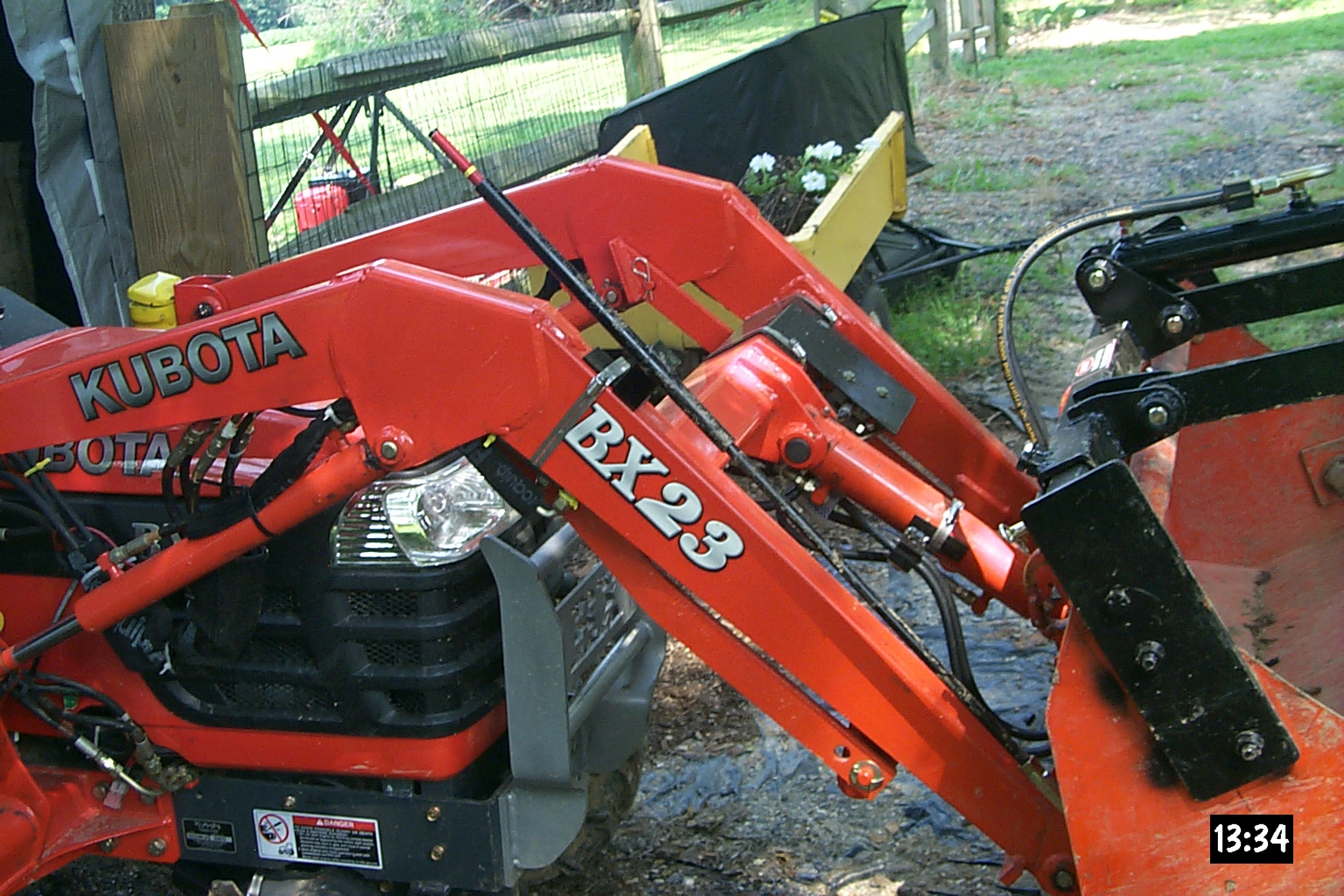

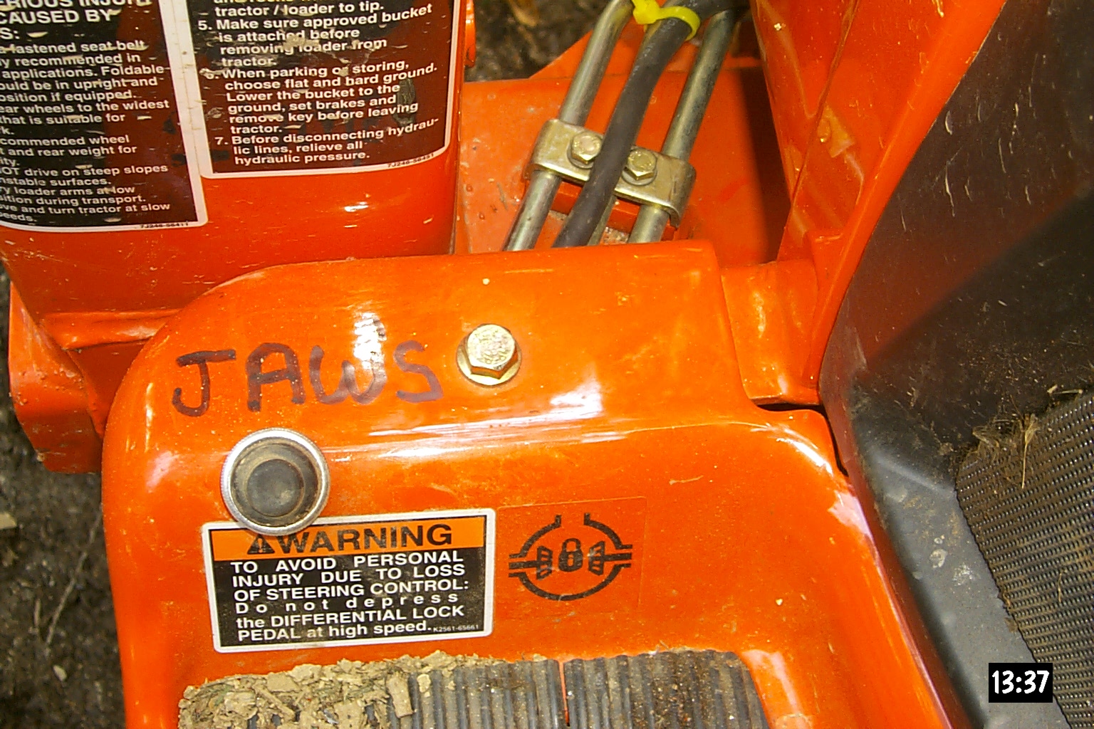

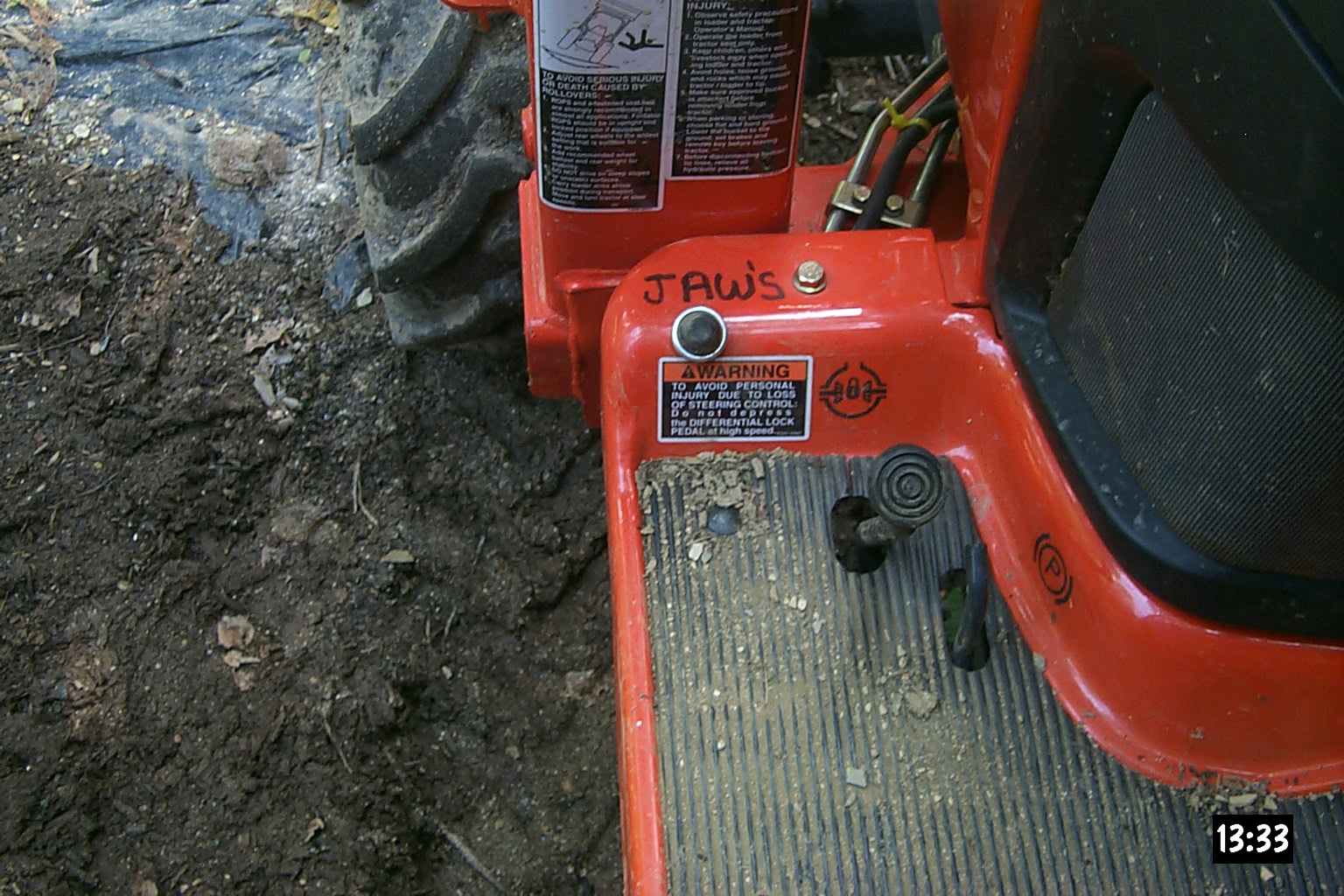

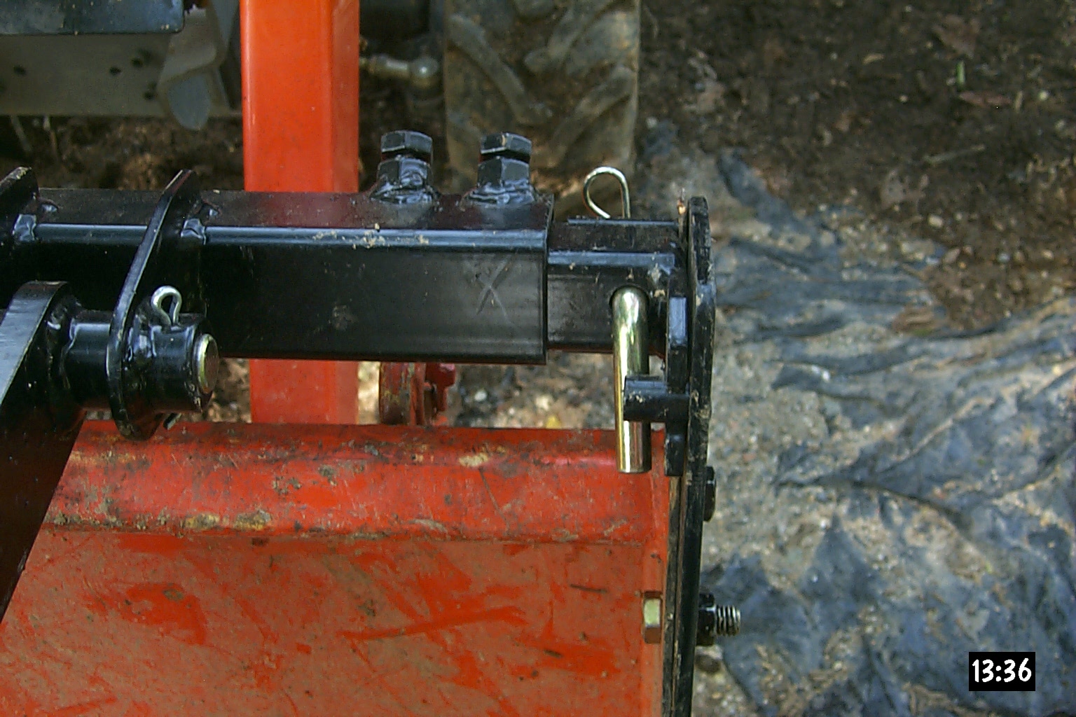

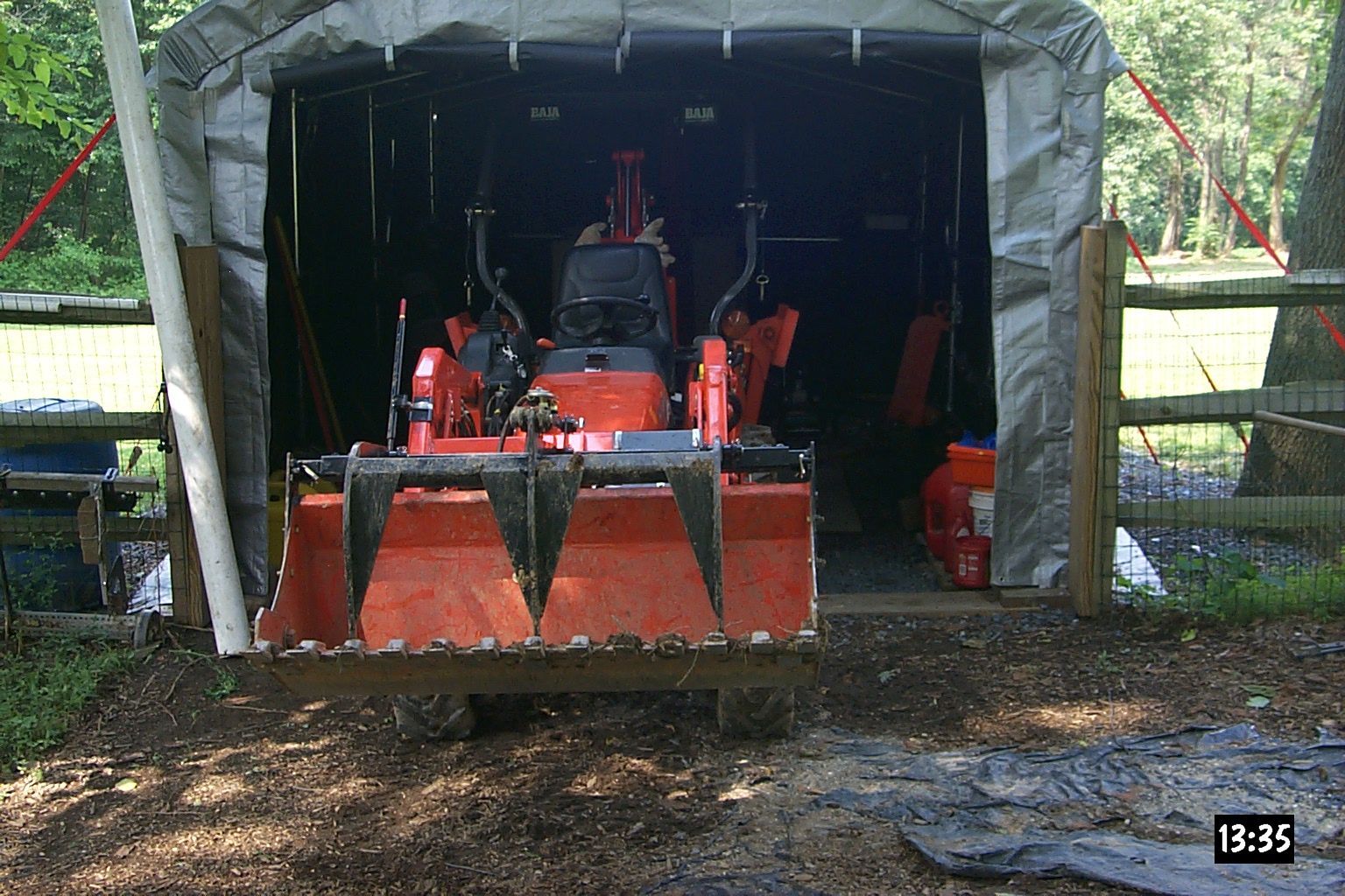

I have just bought and installed a very nice Grapple made by American Solutions. I was going to build my own but no time and then I read Berniep's good write up, http://www.tractorbynet.com/forums/showthread.php?t=69176&page=3 ,about it so I got one. It is a very nice unit and installed in 2 hours or so with no problems. I tested it on a huge pile of brush and trees and it worked super well and saved so much time. Before I had to slide the piles around but now it is just load up grab it and off to the burn pile it goes. The one I received is a newer model and has adjustable mounting brackets for different bucket widths otherwise I think it is the same as Bernie's and mounted the same way. The hardest part was finding a mounting location for the switch. I was going to do the joy stick mount but decided to do my idea first. I mounted a NAPA Heavy Duty Pushbutton switch on the left floor board on the roll part. There is a hole in the back of the battery box that I could get the wire threw to the battery hook up. My left foot was getting bored so now it has a job also and it works out well. I still may go with the joy stick mount but I was in a rush to try it out.

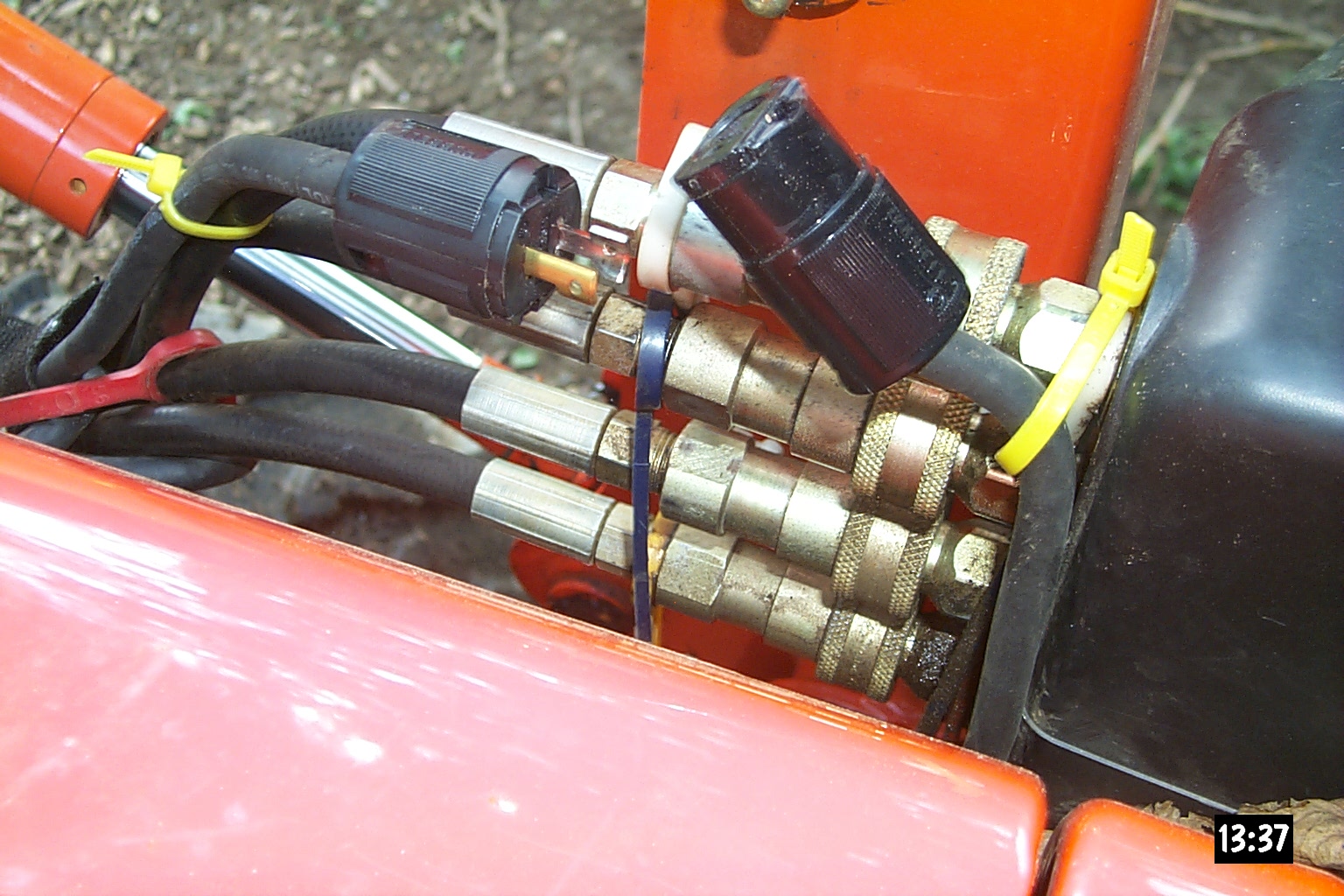

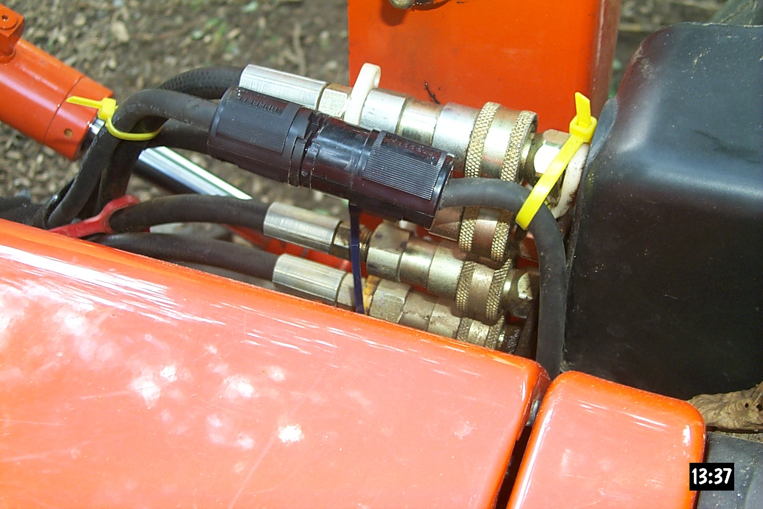

I also put a Hubble two prong Twist Lock Plug at the FEL hydralic disconnect ports to make it easy to unplug the solenoid wires.
I am very pleased with the Grapple and Jeff at American Solutions was very nice to work with. I also got his Loader Level which is so much nicer then Kubota's bracket idea. It also went on with no problem. I Know you guys always want pics so this will be my first try at that also.
Glenn
P.S. I hope I did this right !!!!!!!!!!

Ok, I give up. I see a one way switch & a 2 way grapple. What's the trick to opening & closing?
   / MY New Grapple
Hi Dubba,
There are two hydralic solenoids up on the cross support peice of the fel which the normaly open switch turns on and off. After some hose switching the valves change the flow from the curl cylinder to the Grapple cylinder. The curl cylinder is the normal flow and the Grapple is in out of circuit until I hit the button then curl is off and Grapple is on. It makes for a nice clean setup and easy.
To All I will get some more Pics this weekend while I am using it.
Glenn
   / MY New Grapple #9
Are you saying that the switch is a push-on push-off latch switch?
   / MY New Grapple
Hi,
No it is a normaly open momentary switch. You just hold it in when you want the grapple then release. It energizes the two valves up front to divert flow from curl cylinder to Grapple cylinder.
Glenn
