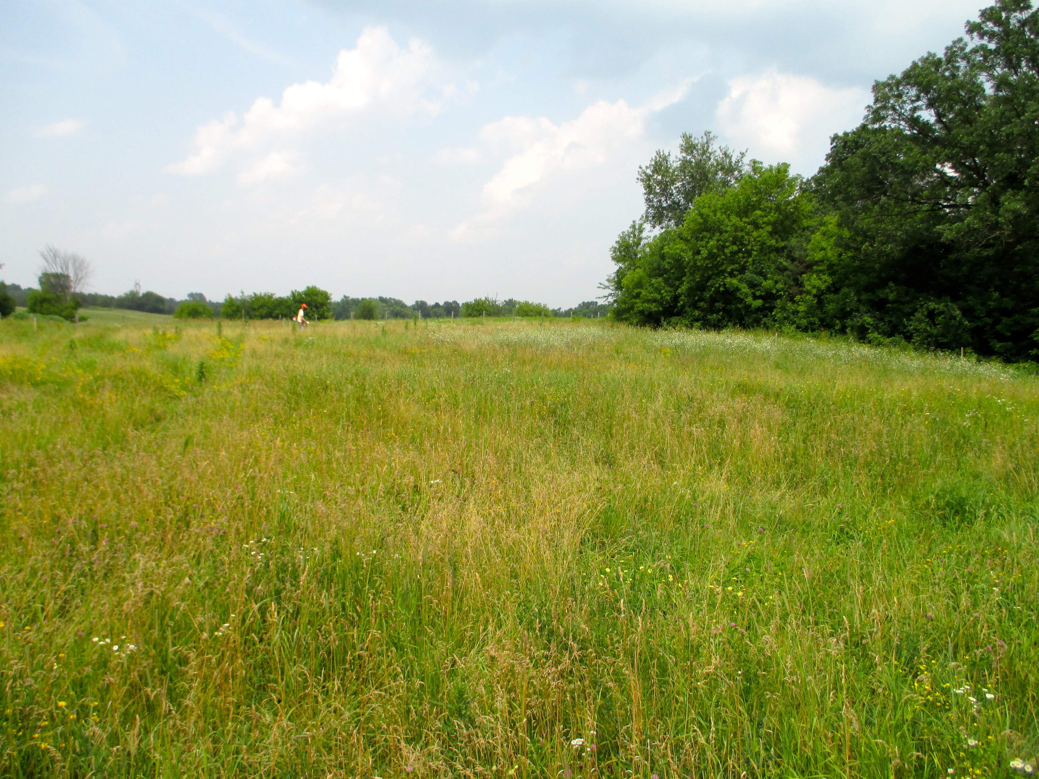

I have seen a few new home project threads on here so I thought I would add mine. My wife and I purchased 6.5 acres last December and after a lengthy delay we finally began our home project. First I had to create a swale to direct the "100 year frozen ground flood" around my house so I could lower the LBO to make my lot a walkout. Coordinating with the county, surveyor, and getting my neighbor to allow the swale through her yard and getting that easement recorded and finally digging the swale took quite some time. After all that I went through the permit process and we began construction last week. First part was making the 1000ft driveway. I will add pictures and update this thread as things progress.
Thanks for looking.
First a few pics of the bare land.

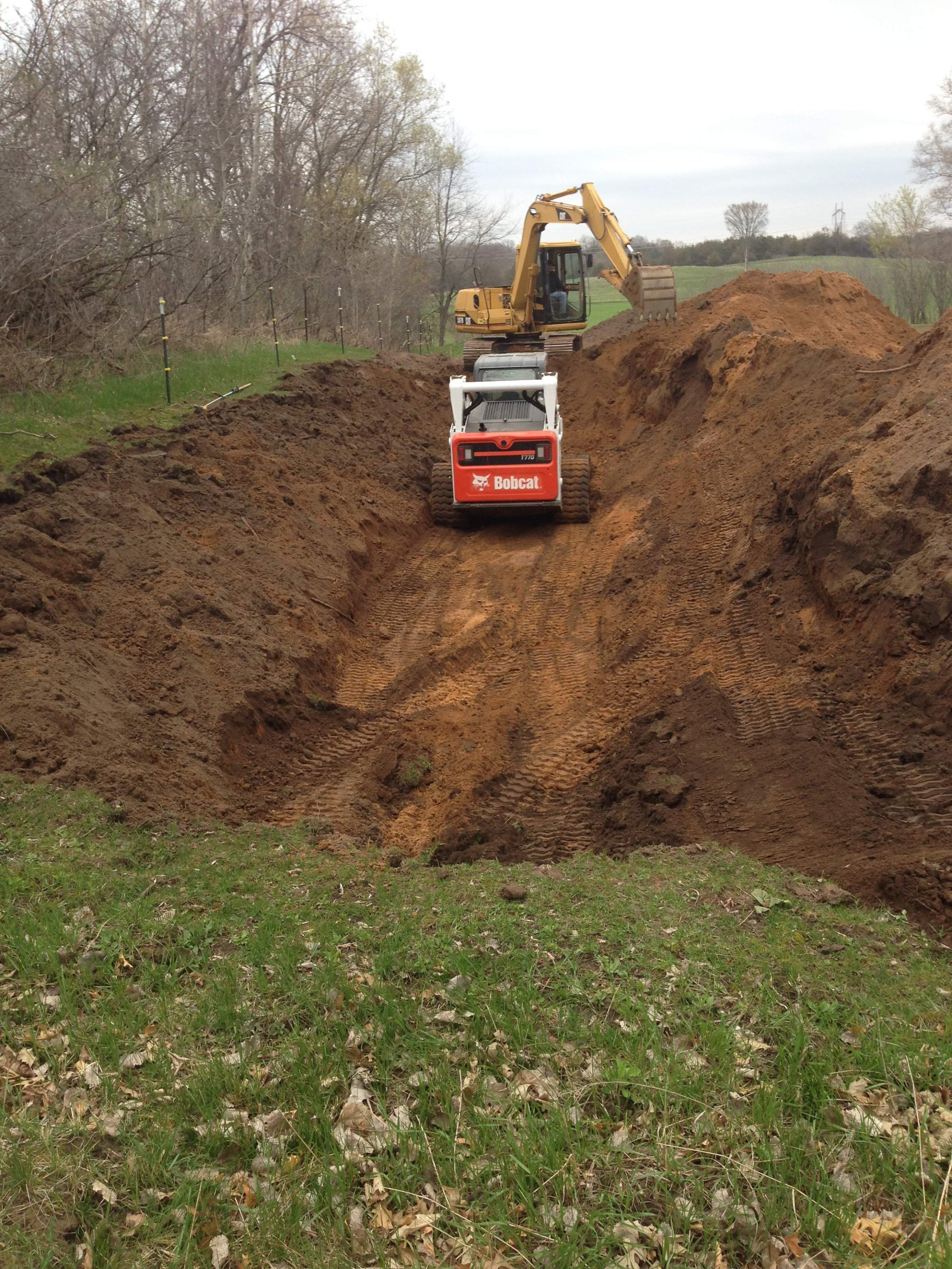

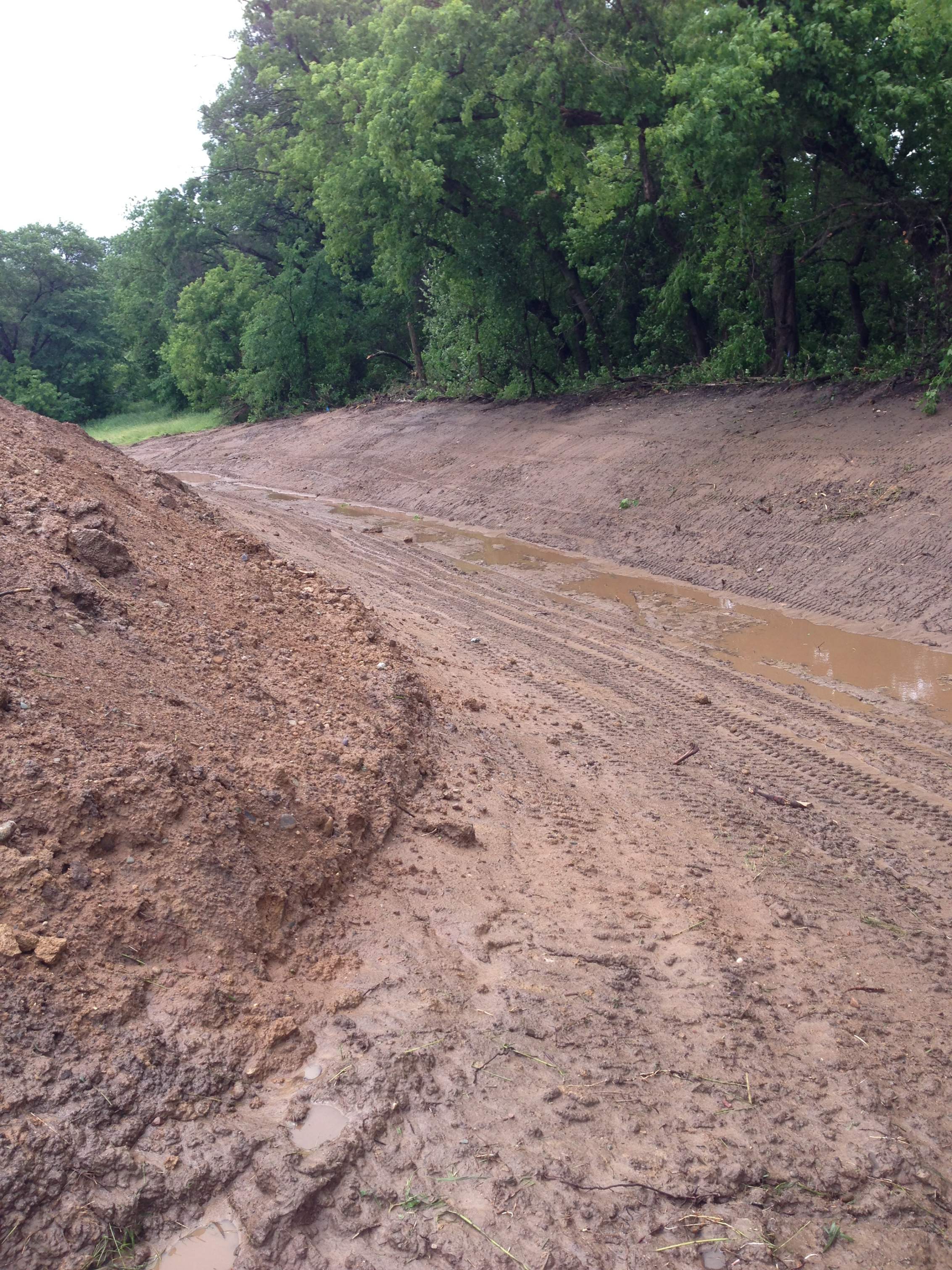

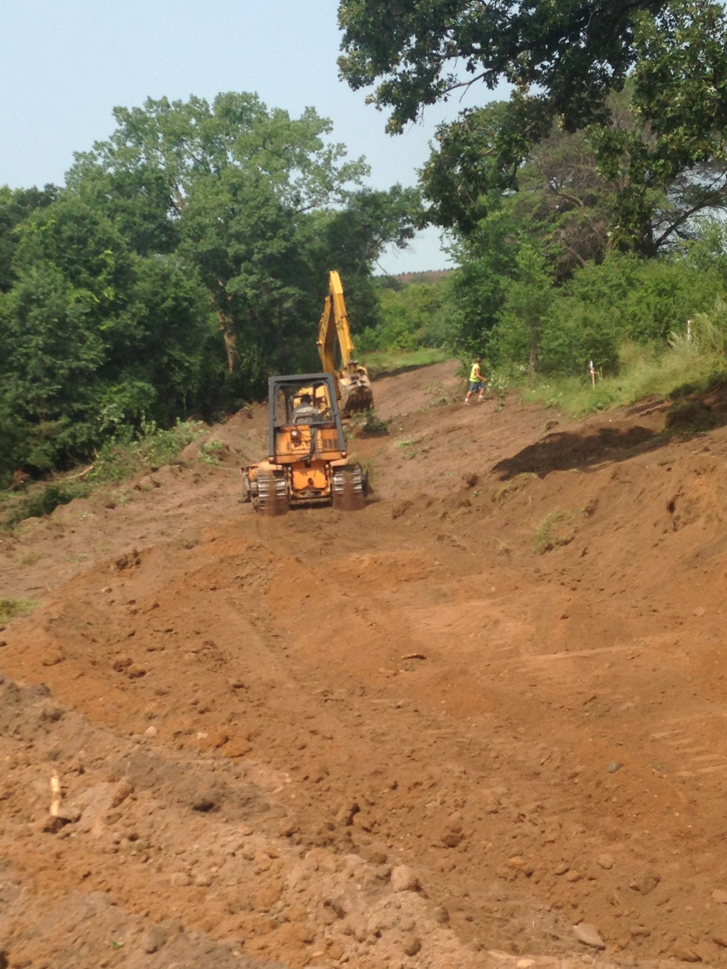

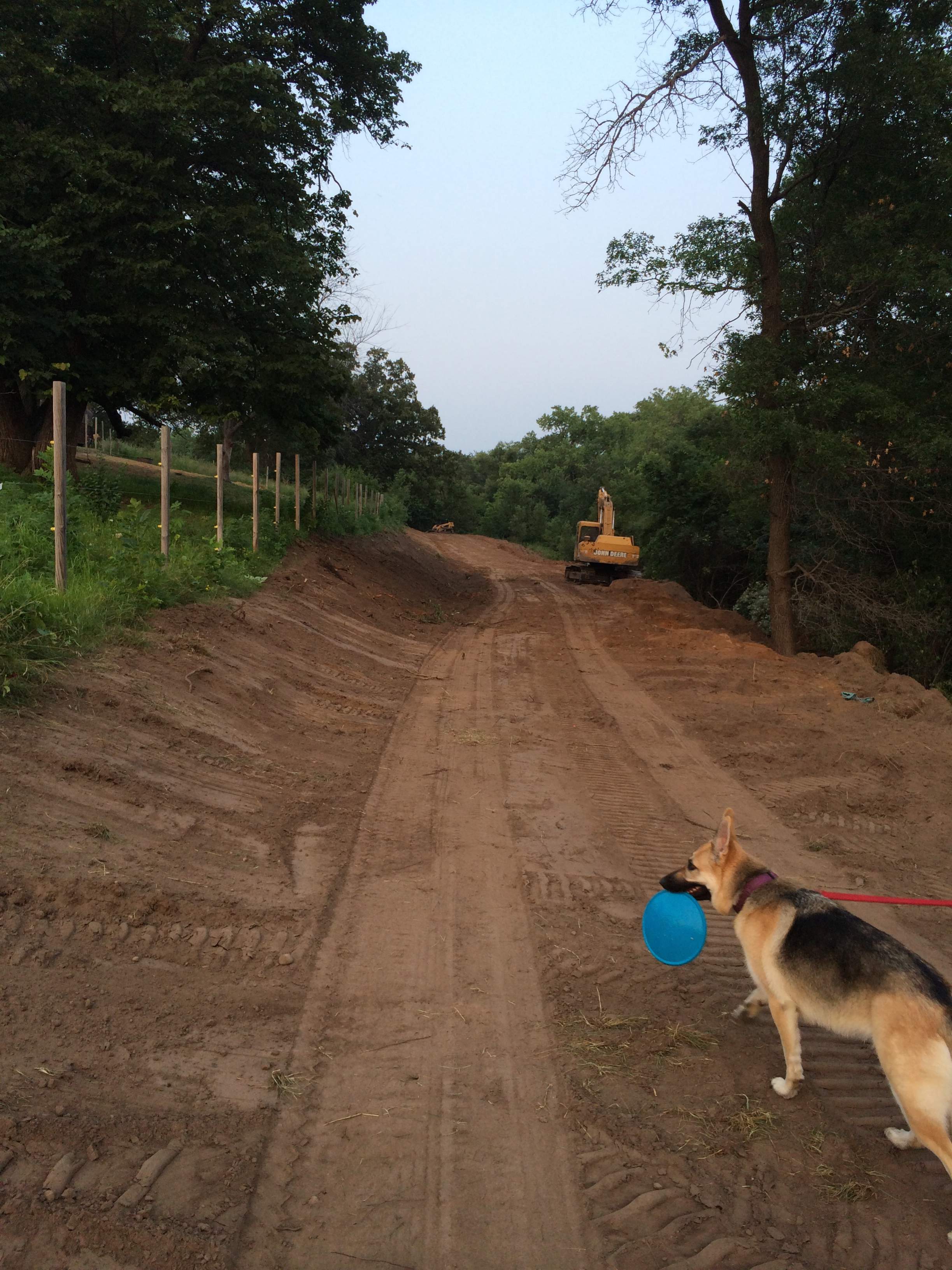

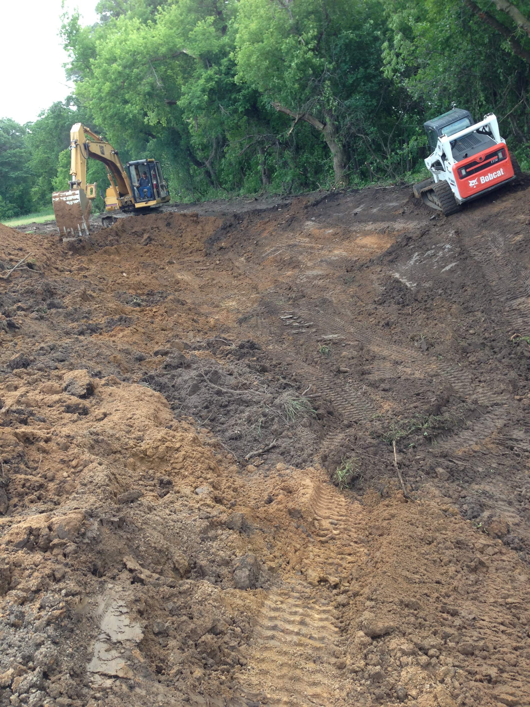

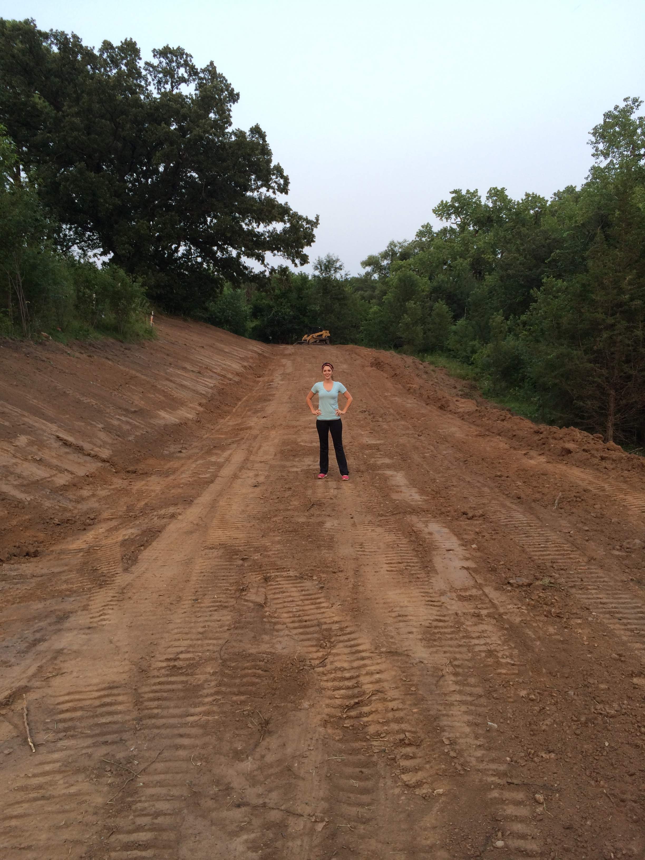

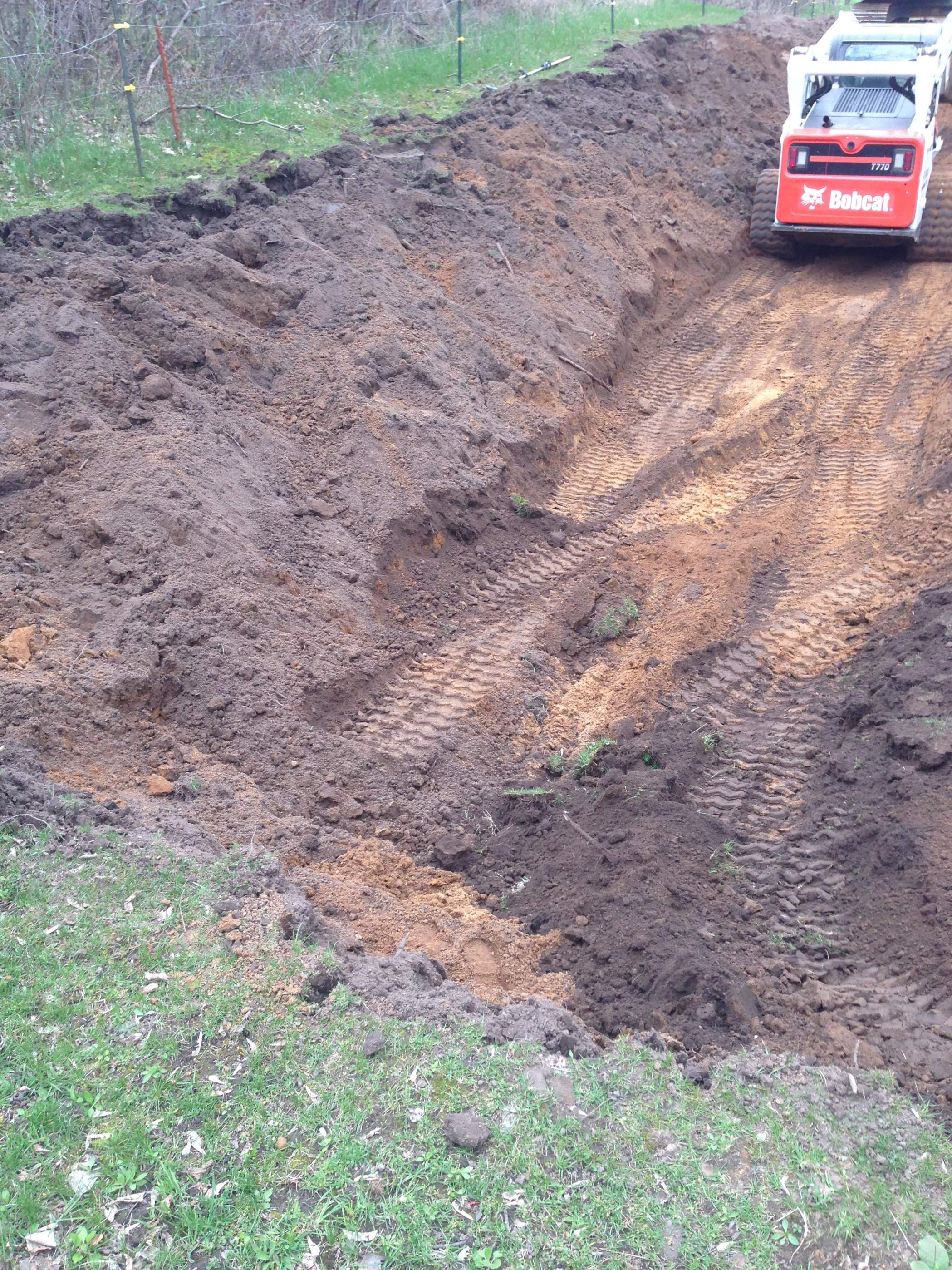

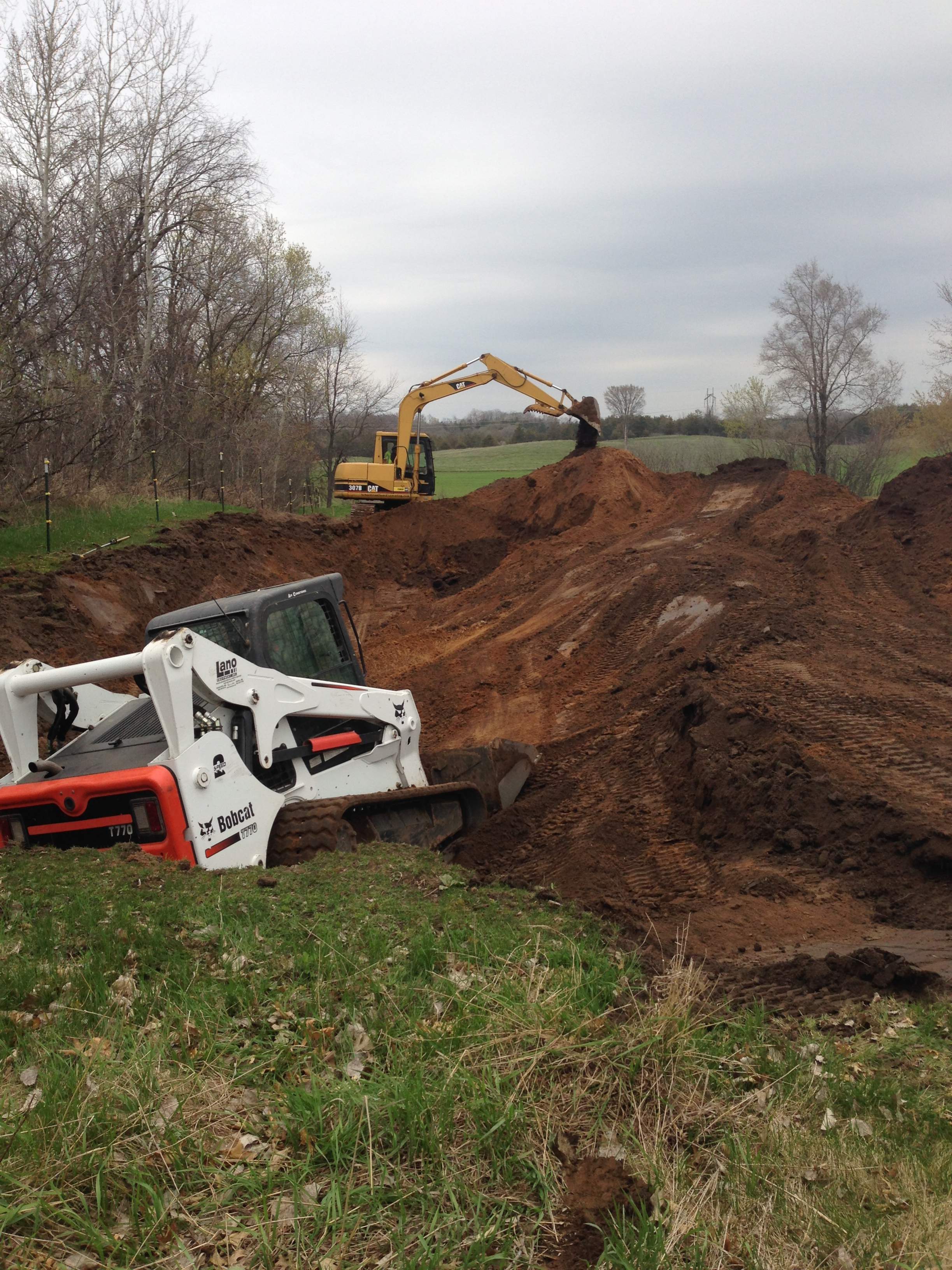

Digging the swale. It is funny because the county is so concerned with this swale but after the winter we had and all the recent rain there was no water to be had. It is all a paperwork issue. Might turn this non useable area into a garden now or something.
This is only part of it, it is about 500 feet long. It rained a lot after we dug it and was a tad wet in that last picture. Grass is finally growing in it to help that.

Is that a swale or a canal? :laughing:

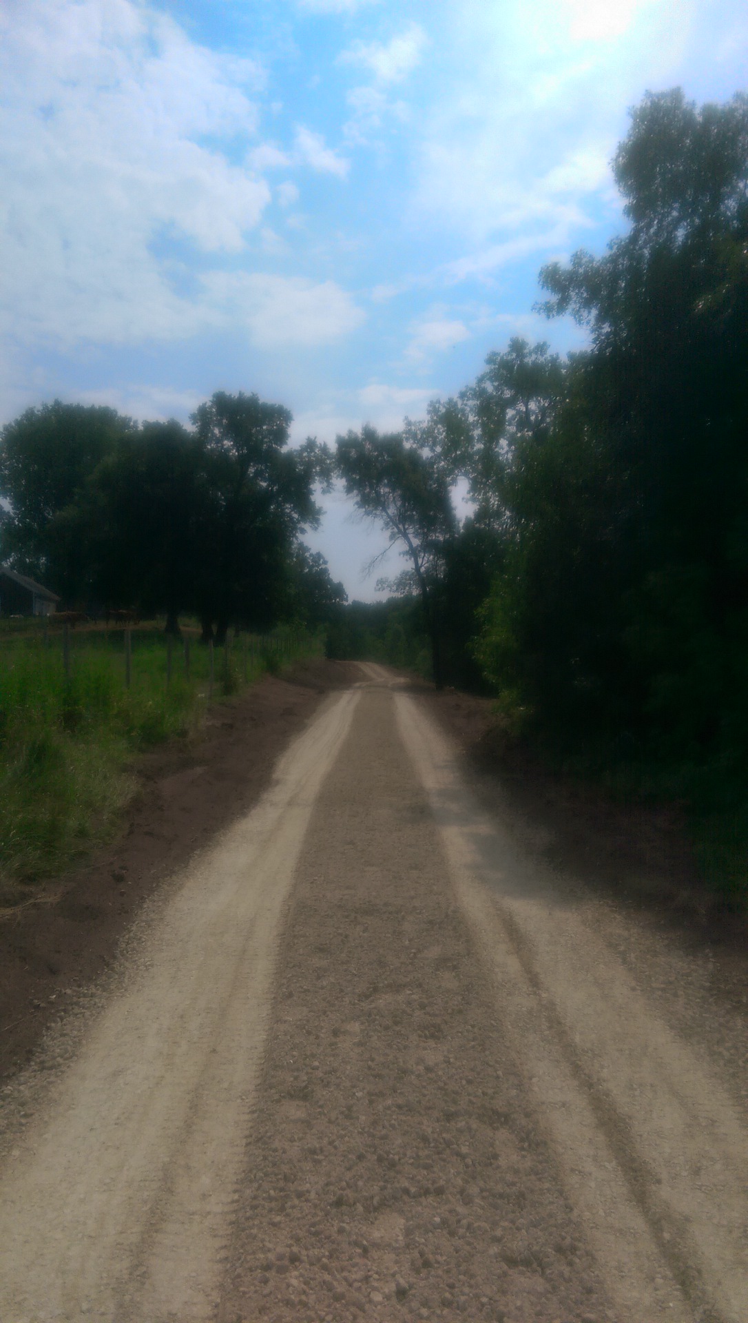

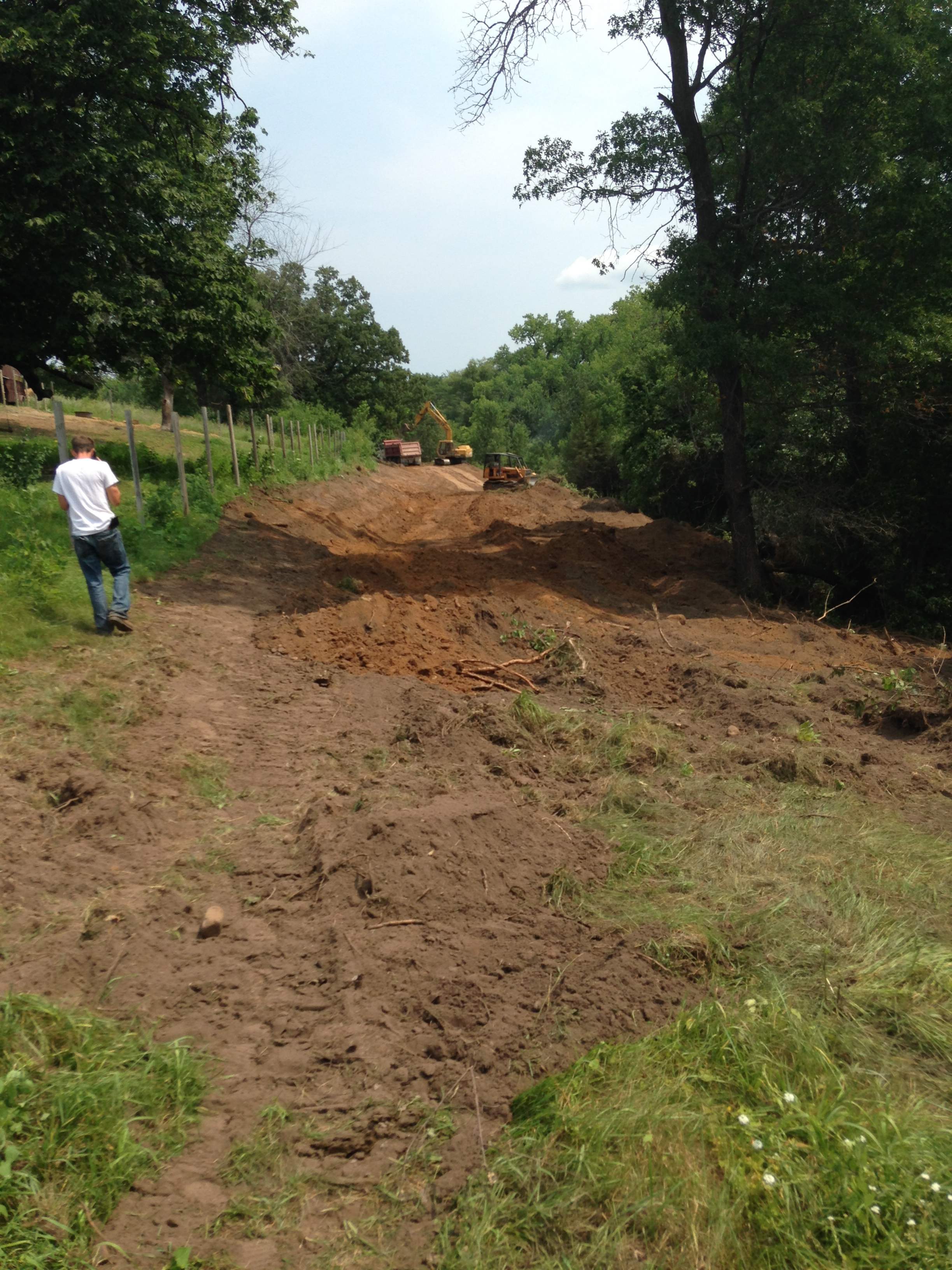

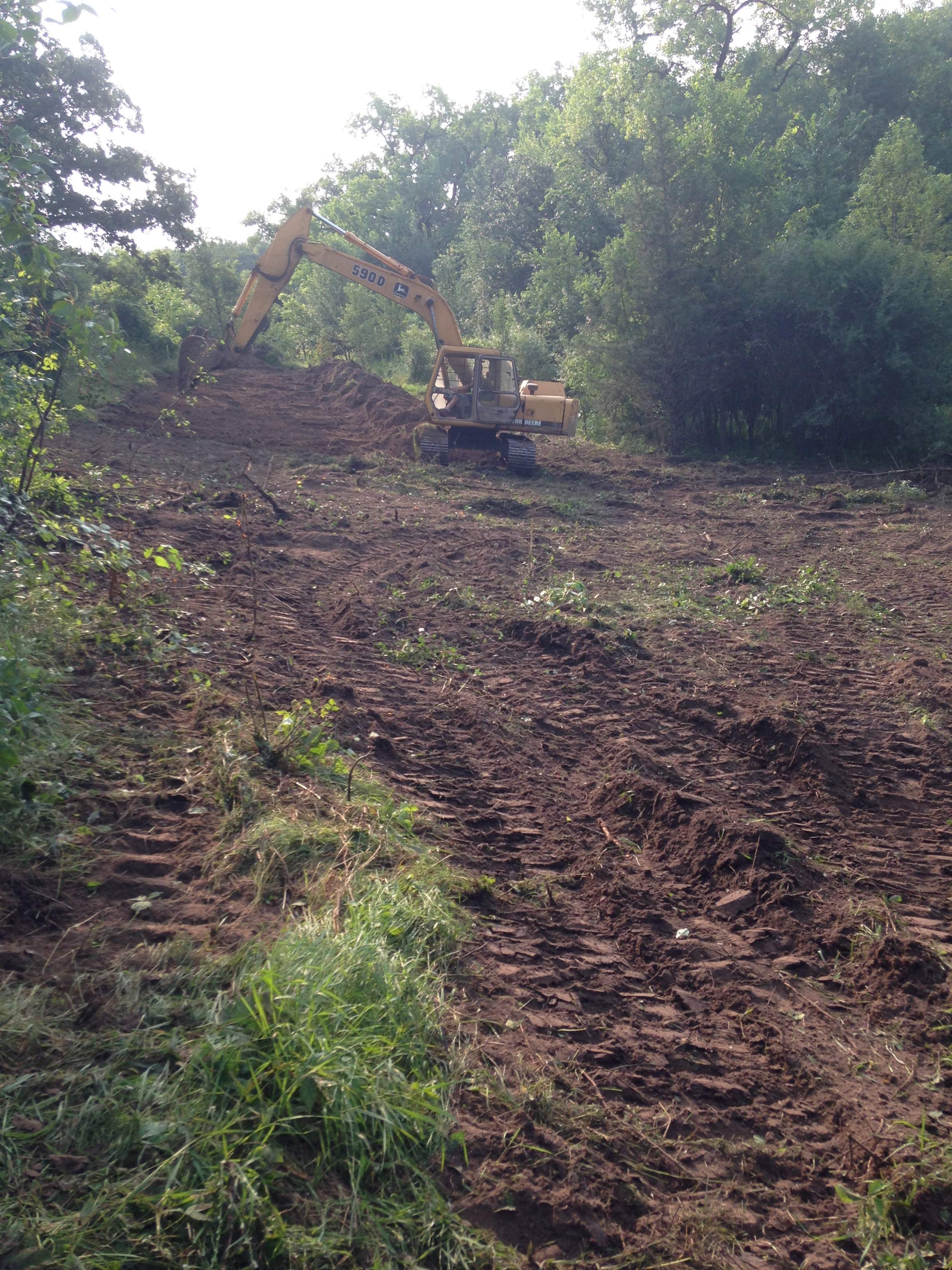

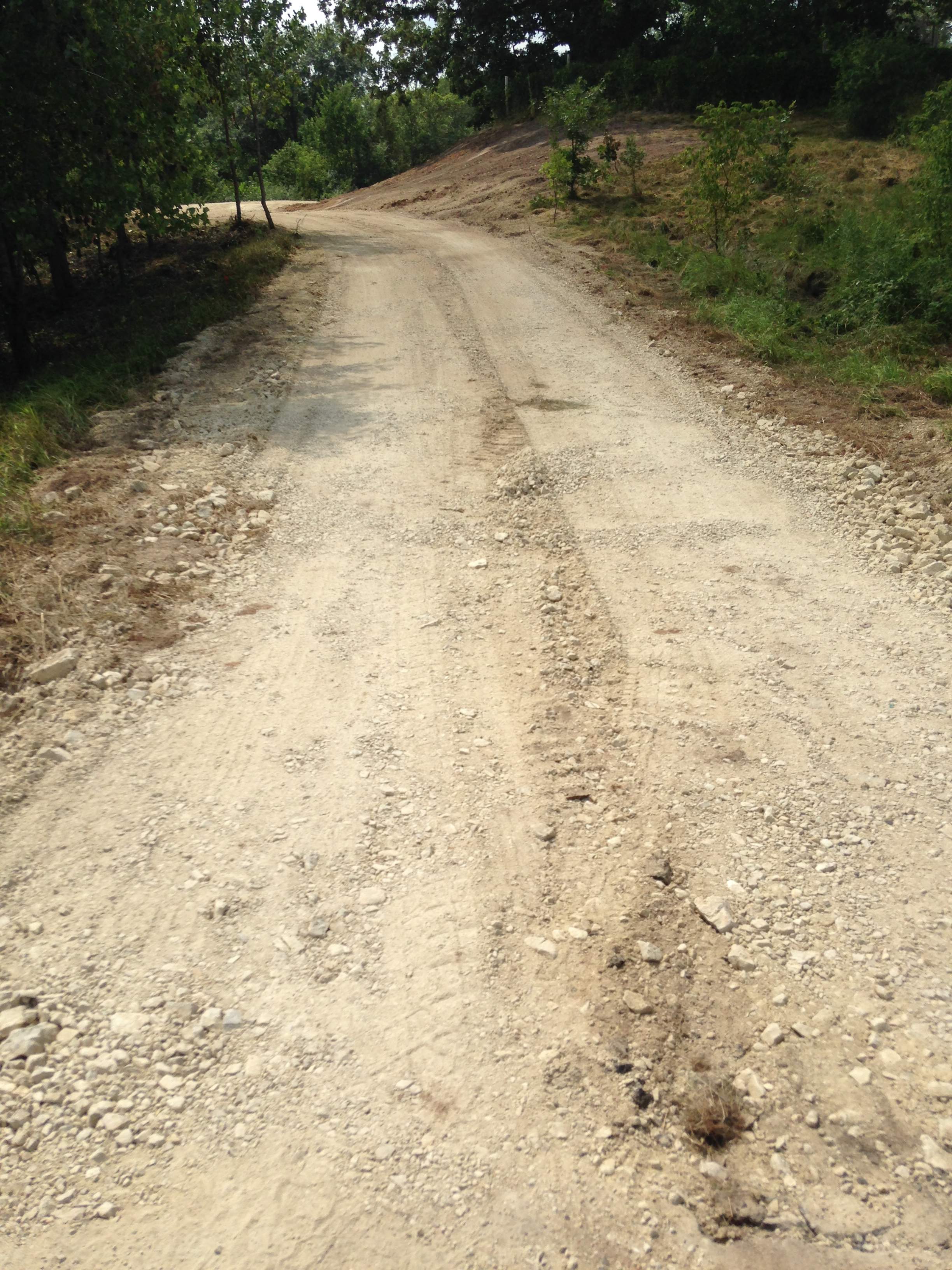

Here comes the driveway. Finally, it was a pain walking back all the way with equipment to putz around brush clearing. Gonna be time consuming to plow!

It is basically a canal haha. Some spots were 6-7 feet deep. Had to have a minimum bottom width of 5 feet and side slopes of 2.5:1. It was quite the project just to do that.
LBO is lowest buildable opening.

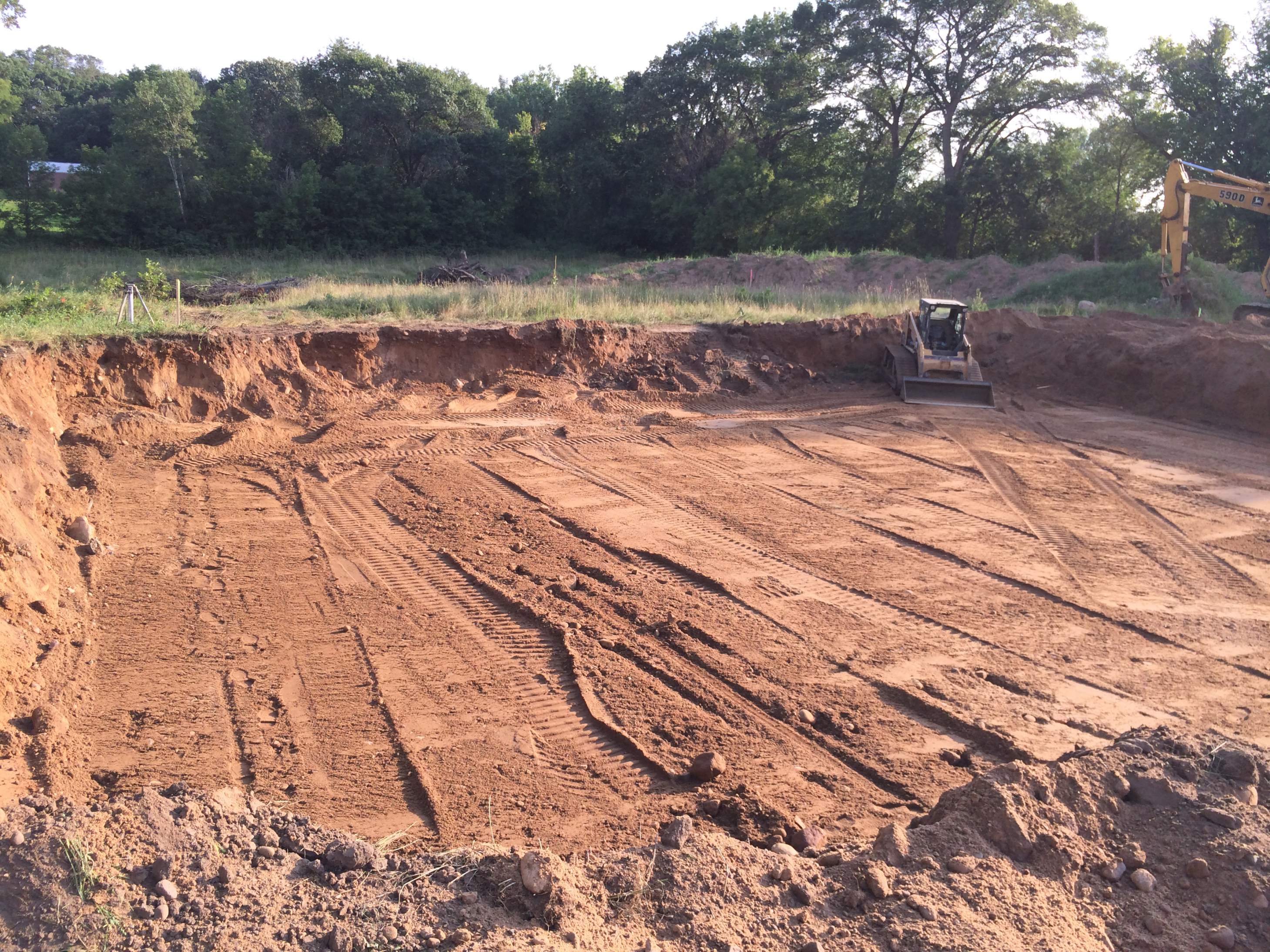

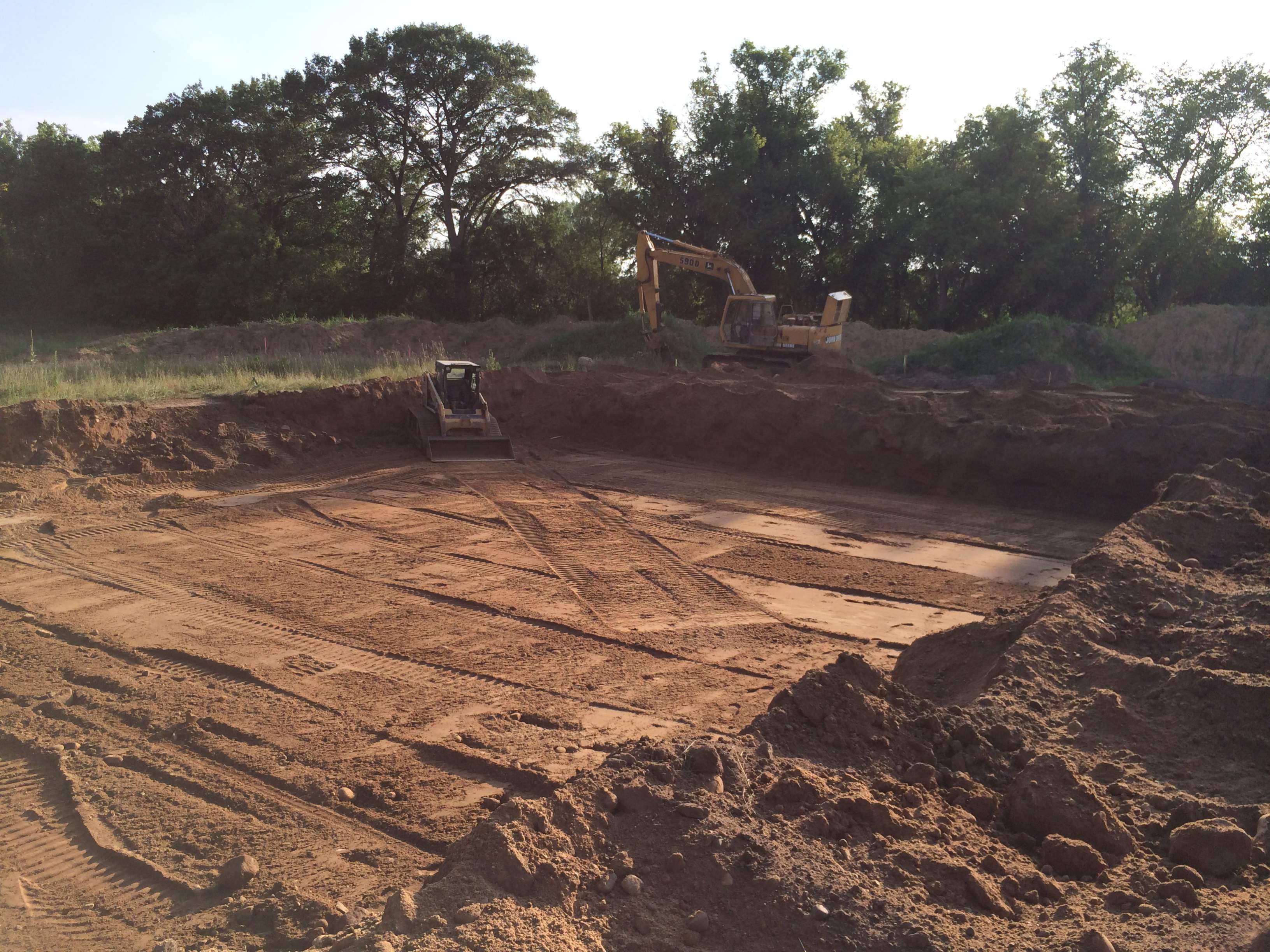

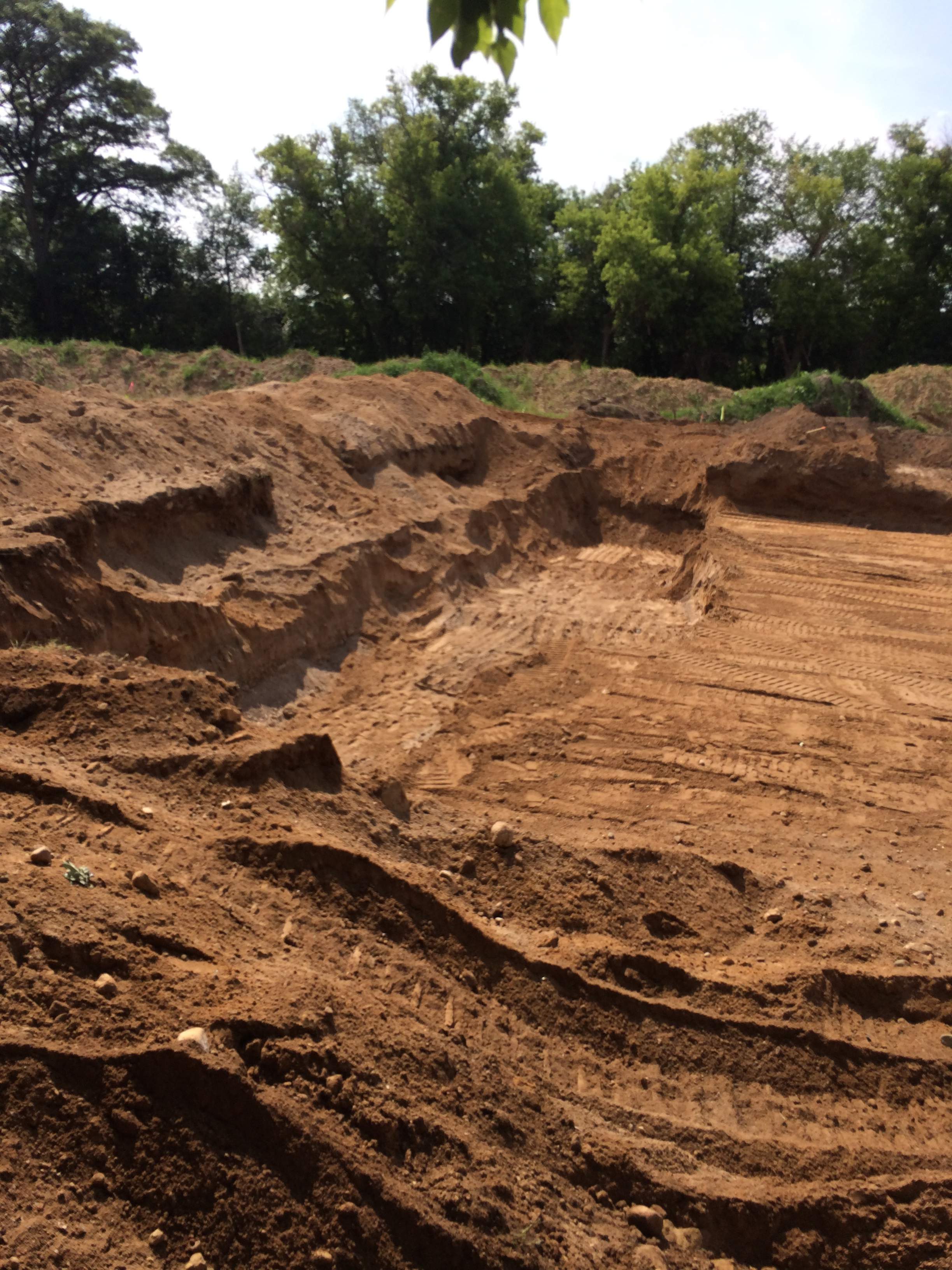

Digging for the foundation.

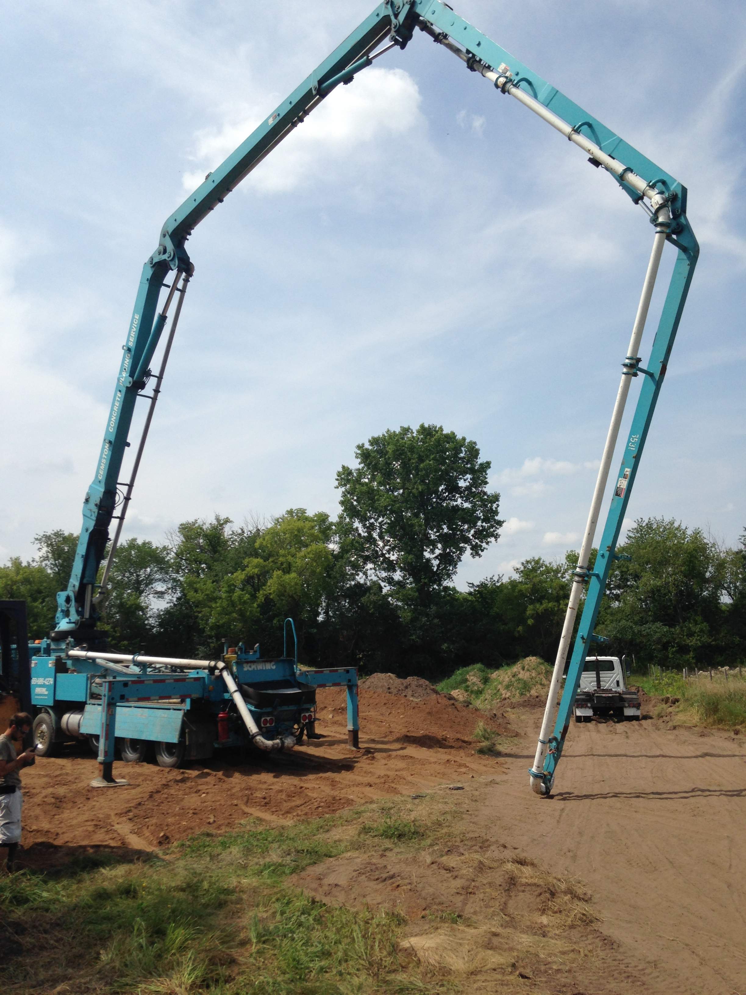

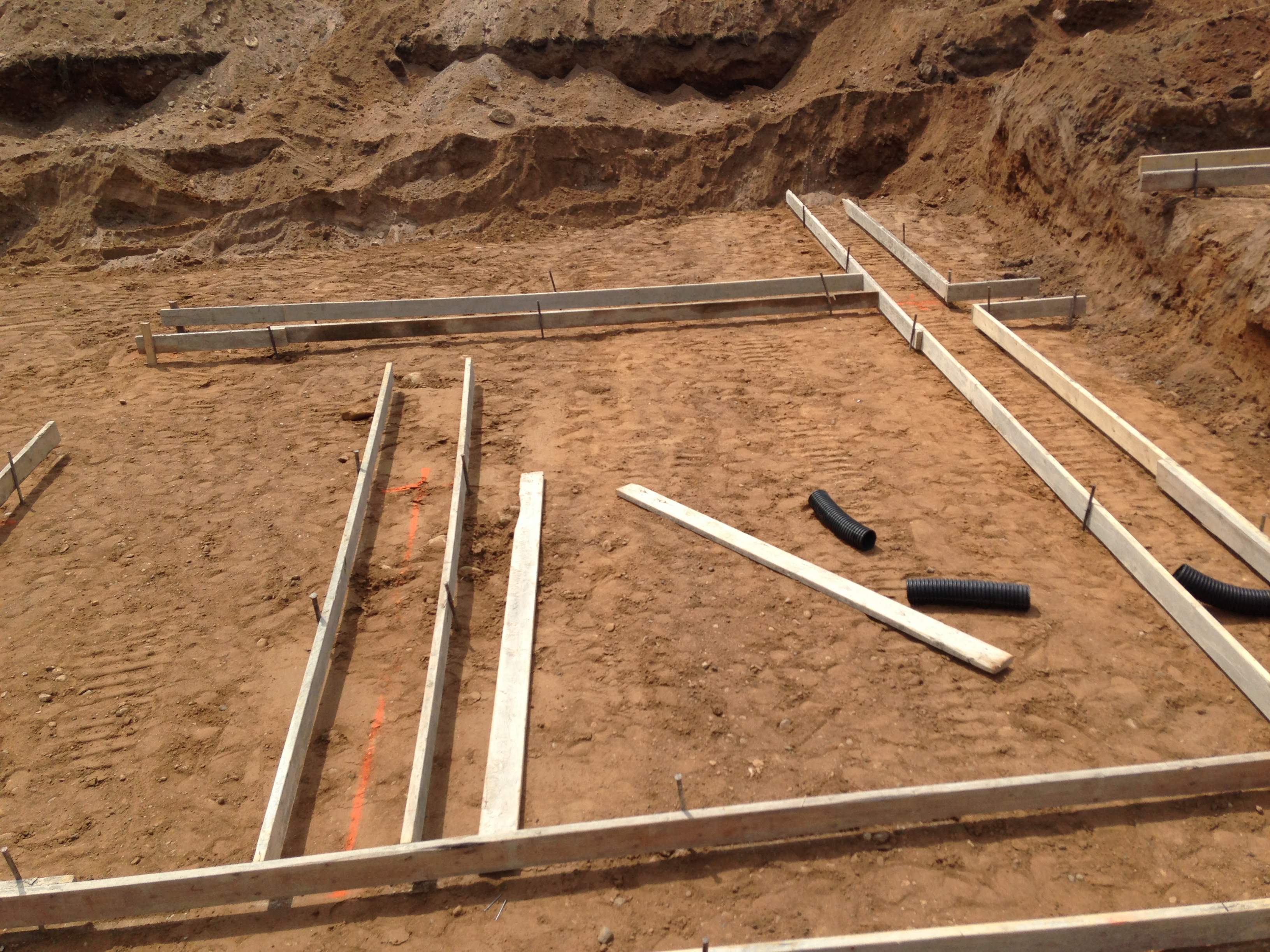

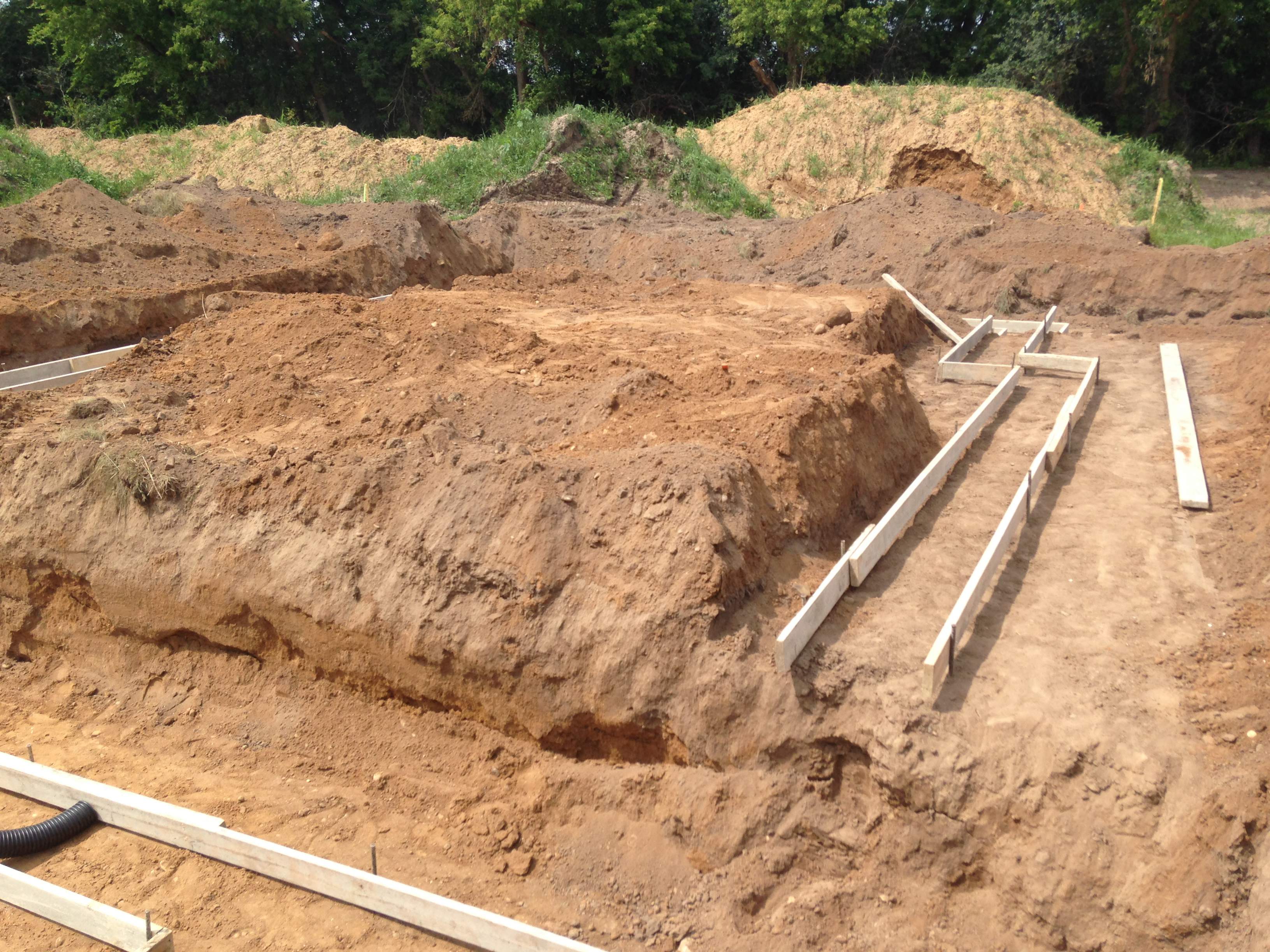

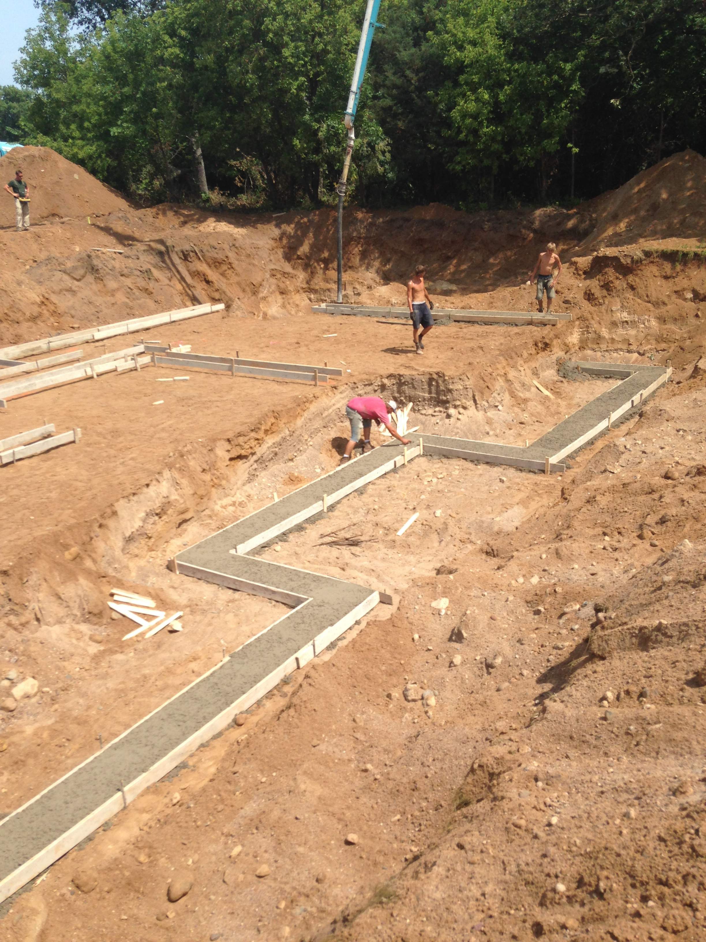

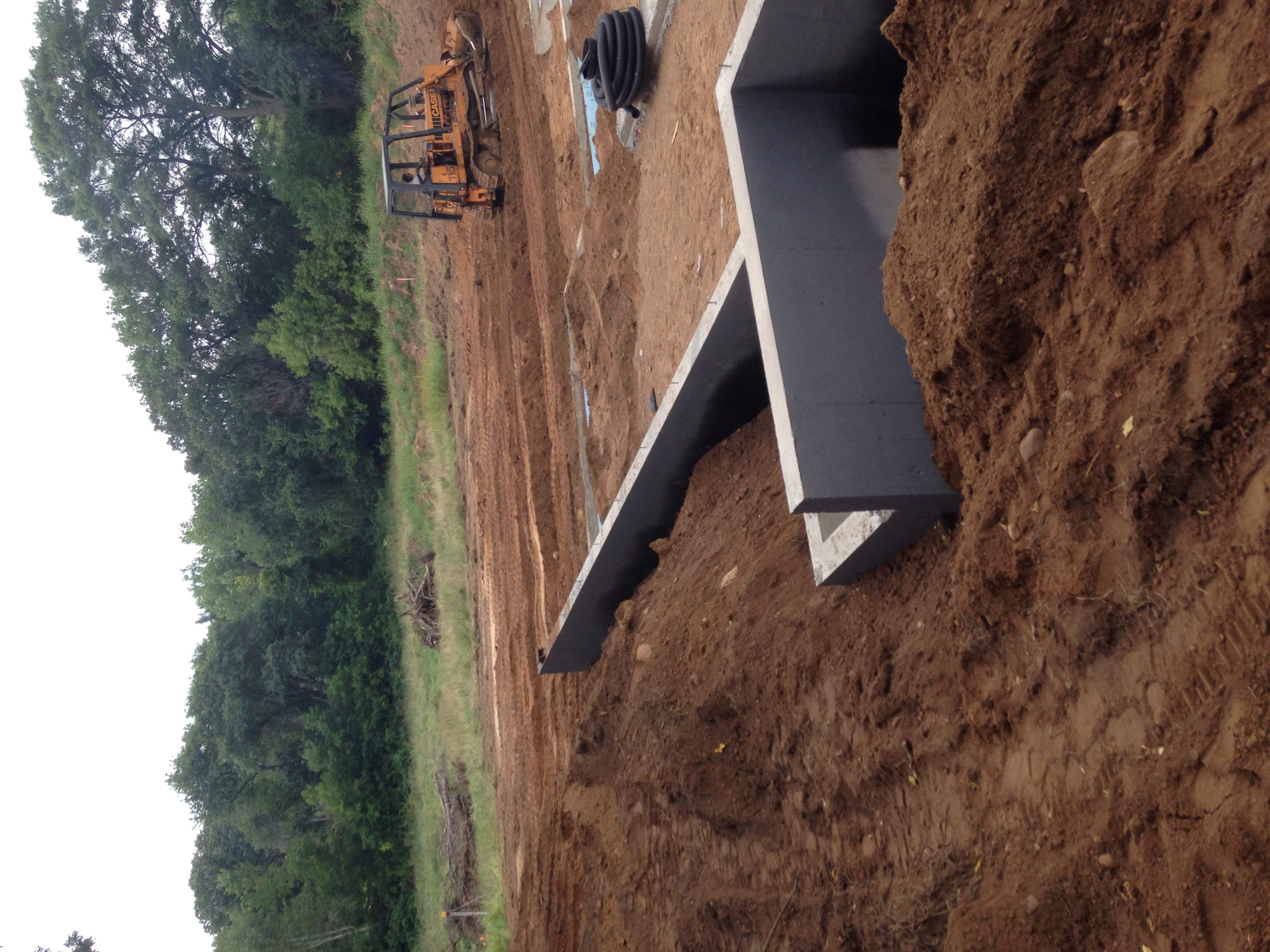

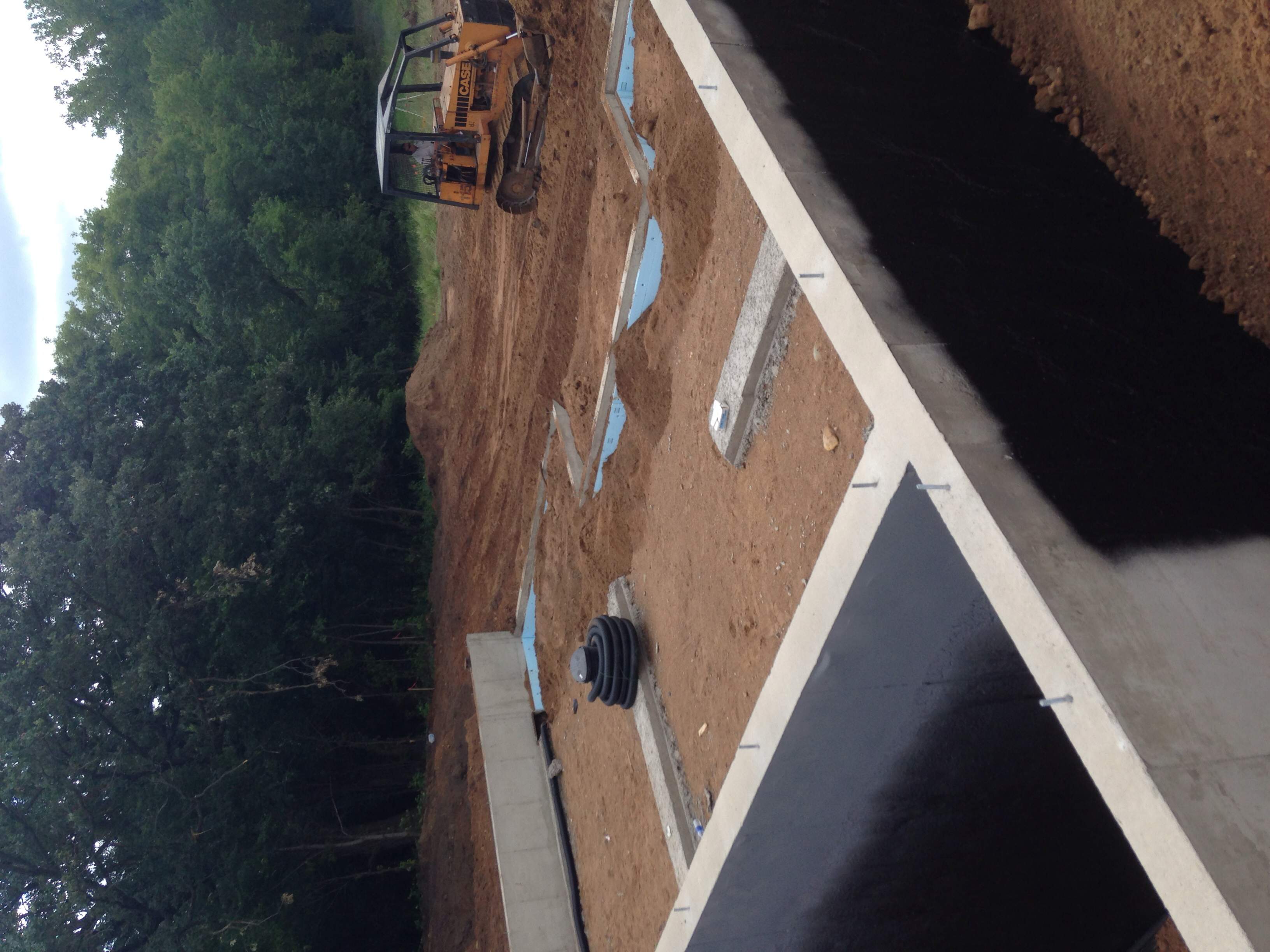

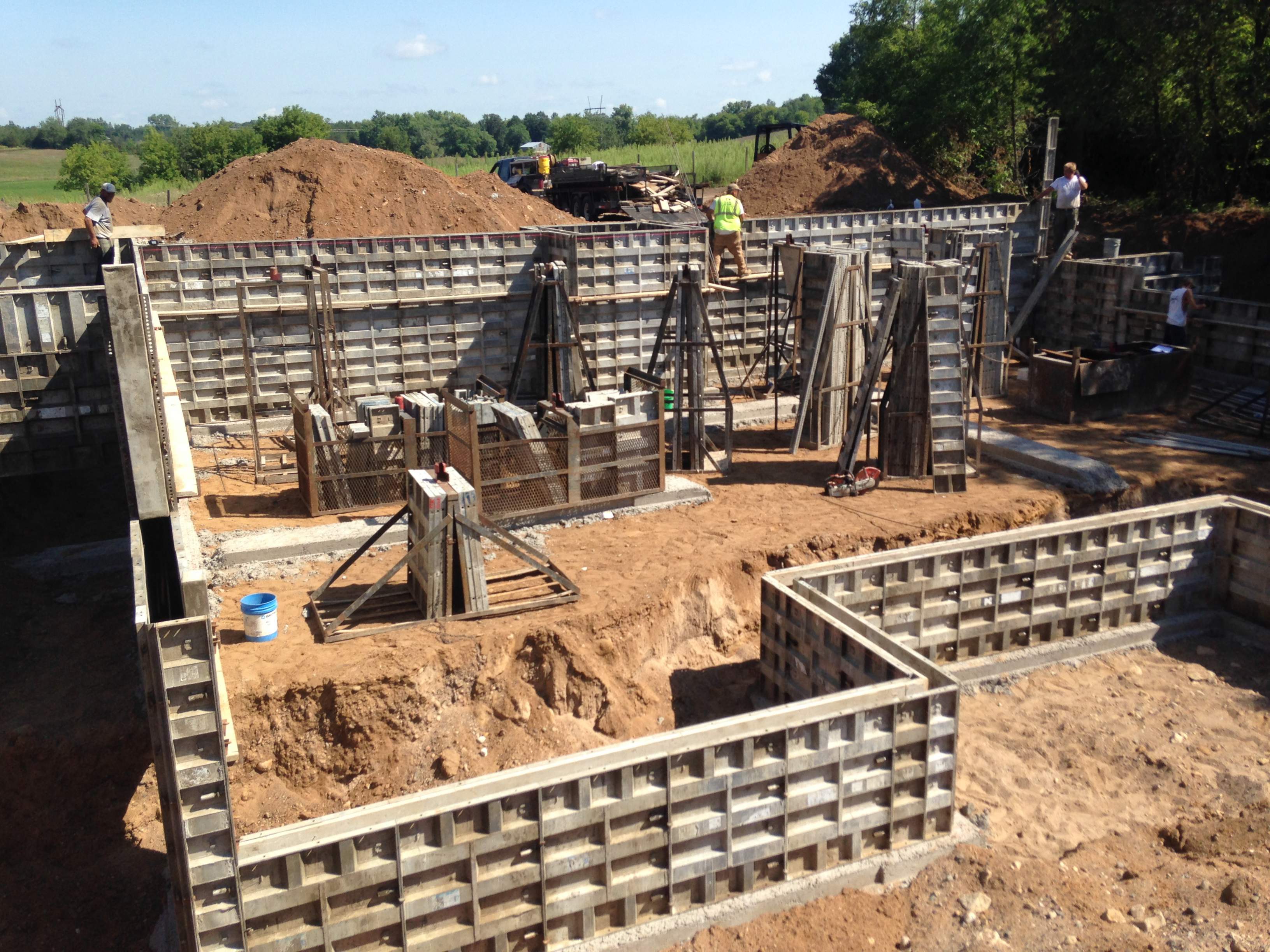

Setting up and pouring the footings. This is now up to date as this was today. Nothing scheduled until next week now.
