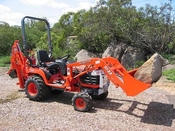

Last December we completed building a house on our new property. Around March I started thinking that I need a tractor, its then that I found TBN. Soon after that a BX-23 was delivered and I was getting "seat-time".
Having the tractor has been great. And this website/forum has been very helpful in owning/maintaining my investment.
Some of the projects I've done:
Cleared land and planted ~50 avocado trees. The backhoe has been great, I can dig a 5 gallon hole in under 2 minutes and not break a sweat.
Dug out lots of scrub oak stumps.
Dig two holes for the cable company. They were going to dig these 6' deep holes by hand! I offered to dig them for $25 each. They promptly accepted! I didn't expect the tractor to be making me so much money! /forums/images/graemlins/wink.gif
150' x 18" deep in a mater of hours. That backhoe is great!
Moving/spreading 15 yards of manure for the future front and back yard.
Moving good sized rocks, just because I can move them.
The list goes on and on...
But I have a question that I haven't seen addressed here,
Is it normal for the backhoe to slowly sink to the ground overnight? The bucket will be touching the ground in two days if I don't put the pin in. I've looked for leaks, but haven't found any. Being new to hydraulic equipment I don't know if this is normal. I think my front bucket also creeps down, but its not as noticable.

My backhoe will lower the same as you describe. Same for my 3PH and loader. I have read the explanation of why this happens, but will leave it to others to describe.
   / My New BX-23!! #4
Congrats on your new tractor and good job on the pics. I notice the front tires look like they might be a bit squished (underinflated) with that big rock in the FEL. Maximum inflation pressure is imprinted on the sidewall of the tire. Could easily be an illusion as well, but thought I'd mention it.

This is simply called leak down or gravity at work. Most equipment will do it as the preassure is slowly released by the valve. We have new equipement on our lot from 4 different mfgs that do the same thing. Congratulations on the new purchase!
   / My New BX-23!! #7
Sounds like your having fun with your new tractor. My wife is looking at getting a BX23 for herself should finances appear favorable. Myself I have a Kubota M105S and also greatly enjoy getting alot of things done with it.
As to your hydraulic problem. You really have none. It is common when the tractor is shut down with no hydraulic pressure to keep the backhoe or loader in place that they will settle to the ground. I always put my bucket down when I'm done for the day. On your backhoe you can do the same thing. If you don't want to be bothered with picking it back up just put in the large traveling pin to hold it in place.
If and when you end up with a hydraulic problem, unless it's the pump you'll end up finding a puddle of hydraulic fluid unless a hose bust on you while you're operating it.
Anyway, relax and enjoy your new tractor.

I know it's been addressed here cause that's where I found my answer to the same question.
It's Normal.
