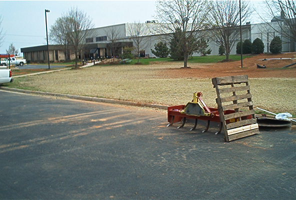

I bought a 3pt hitch 6' box blade Saturday. So far its my favorite attachment, I can use it with my 3 pt hitch adaptor.
It is so easy to drop it in float and gently tilt the box to dig or drop the dirt.
These pics are from a job site where we had to repair the grounds where heavy equip. tore it up. it was really compacted. I leveled it, tilled it , then box bladed it again to get the debris cleaned up; very little hand work was required.
At half throtle, the PT doesn't even know its there.

That is real nice to know - thanks for posting it. I bought a 3 pt adapter partially so I could use my existing 6' box blade but I was concerned as to whether the PT could handle it.

The gound was really hard here too. It was compacted where the pipe line was buried, and dump trucks had driven over this area for access. I was actually able to "harvest" topsoil from where the old grass was, drag it onto the excavated area, and retill it.
