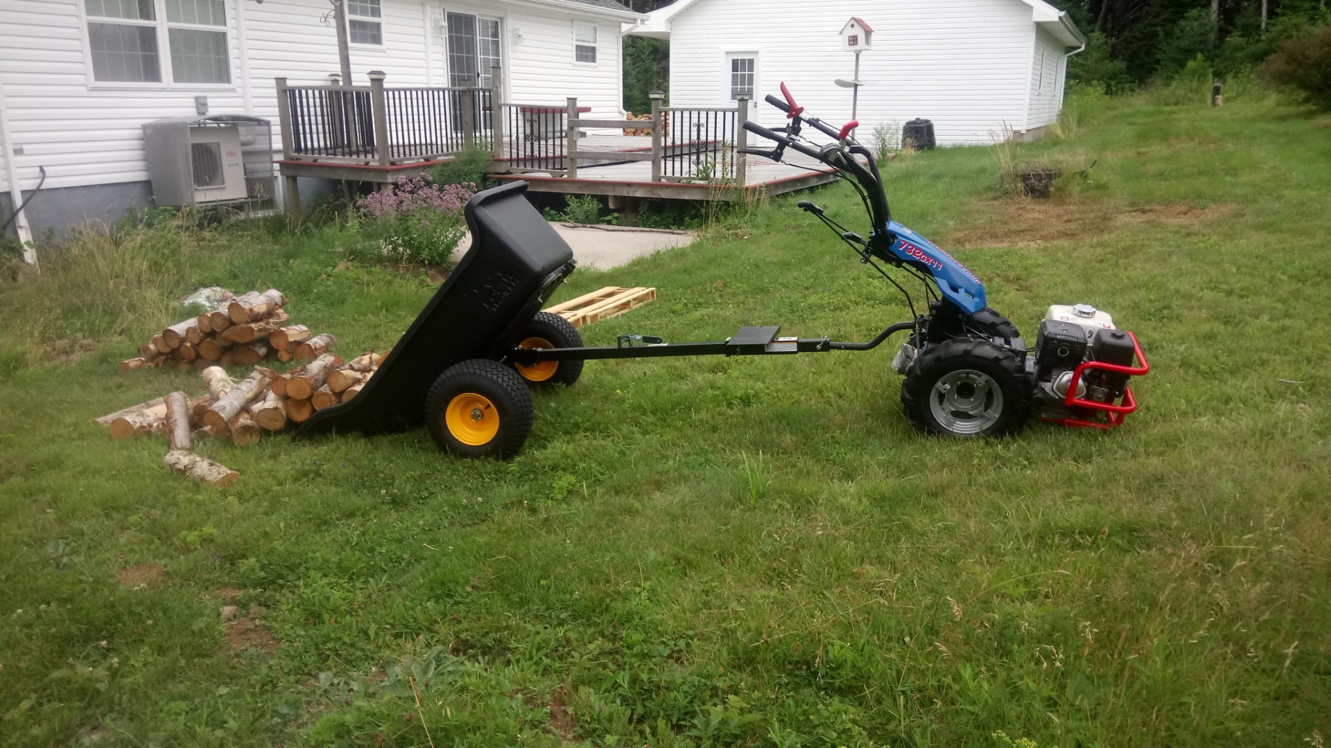

Only took a year to get it finished but I'm pretty happy with what I ended up with.
I started by trying to figure out what trailer I should buy. I wanted a dumping trailer that had its axle offset towards the back to put more weight on the BCS. Most of the trailers I saw were centered, which is terrible for traction on the BCS - especially for pulling firewood uphill. I also could not allow myself to buy a junky product from the local Home Depot's garden tractor section. The plastic on those things were thinner than the plastic my blocks of cheese come wrapped in.
The trailer I settled on is the Polar HD 1500. 22 cubic feet, 1500lb capacity. Bought it on eBay from Northern Tool and had it delivered by freight in a few days. Total cost $380. Another benefit for this thing is you can hook the thing up to your truck, they sell a 2" ball adapter, though not street legal and I'm not sure what speed it could take. It'll hook up to a quad too. They sell a "wall" kit, made out of steel, that will expand the capacity to 35 cubic feet. Useful for hauling wood I'd say, but I haven't found the need yet.
The next thing I needed was the BCS trailer adapter, which is a given, I wasn't going to try and hack something together there. Only about $70 I think it was.
One of my goals was to not drill any holes in either the BCS adapter or the trailer, so I spent a good year trying to figure out that next step. I also wanted to make sure the trailer allowed a decent amount of articulation. and I wanted to build something myself. Kind of a tough set of specs.
Then I realized - these guys sell ball hitch adapters - the thing must be made out of 2" square tube. I went out and double checked, what a beautiful thing, it's a standard size for trailer accessories. I spent some trying to figure out what kind of trailer accessories I could use to make the thing work, I figured a 2" tube extender with the trailer in the female side and the male side drilled out would do the trick. If I lined up the BCS trailer coupler's pin with the trailer hitch pin hole, the varied diameters would allow that articulation I needed. I found that Curt sells a solid steel 2" extender that's 18" long, perfect for the job. Ordered it and a bunch of new old stock drills off of eBay. Turns out that 1-9/32" is a perfect clearance hole for the BCS trailer adapter's 32mm shaft. I bought 1-9/32", 1-1/16", 7/8" drills and a 1/2" 12 inch long drill from Lowe's. Total cost of drills about $130. The adapter was $39.
I'm into this setup for about $620 total, I'm pretty happy with it. If I had to do it again, I'd just pay a machine shop to put the hole in it on a lathe. My drill press was not too happy about what I was doing to it. Even it's slowest setting ran out of torque a few times.
To drill the hole square and centered, I clamped a steel ruler to the tube and measured the distance from the drill to the tube at the top and bottom of the drill. This required constant adjustment as the setup was not nearly rigid enough for what I was trying to do. I just calculated 1-(drill diameter/2) to figure out what the reading on the caliper should be at top and bottom to make it square.
Articulation!
My dad riding it and shoveling from it. First project was filling the raised garden bed boxes.

This is really neat, I like the fabrication job! What articulates? Is that part of the trailer frame?
Edit: I've always been curious, when you're driving without an implement, do you cover the PTO shaft to keep it clean?
   / My new BCS trailer setup
The articulation comes from the round BCS adapter rotating in the round hole. The pin that holds them together is smaller than the hole in the trailer adapter, allowing it to move about 1/4" to either direction. That translates to maybe 10 degrees in each direction.
I have the quick-connect for the PTO, so there's about 2 inches of female space in there. I rolled up a rag then spiraled it so that it would be a tight fit in that hole. There's also a spring loaded pin in the quick connect that helps hold the rag in place.

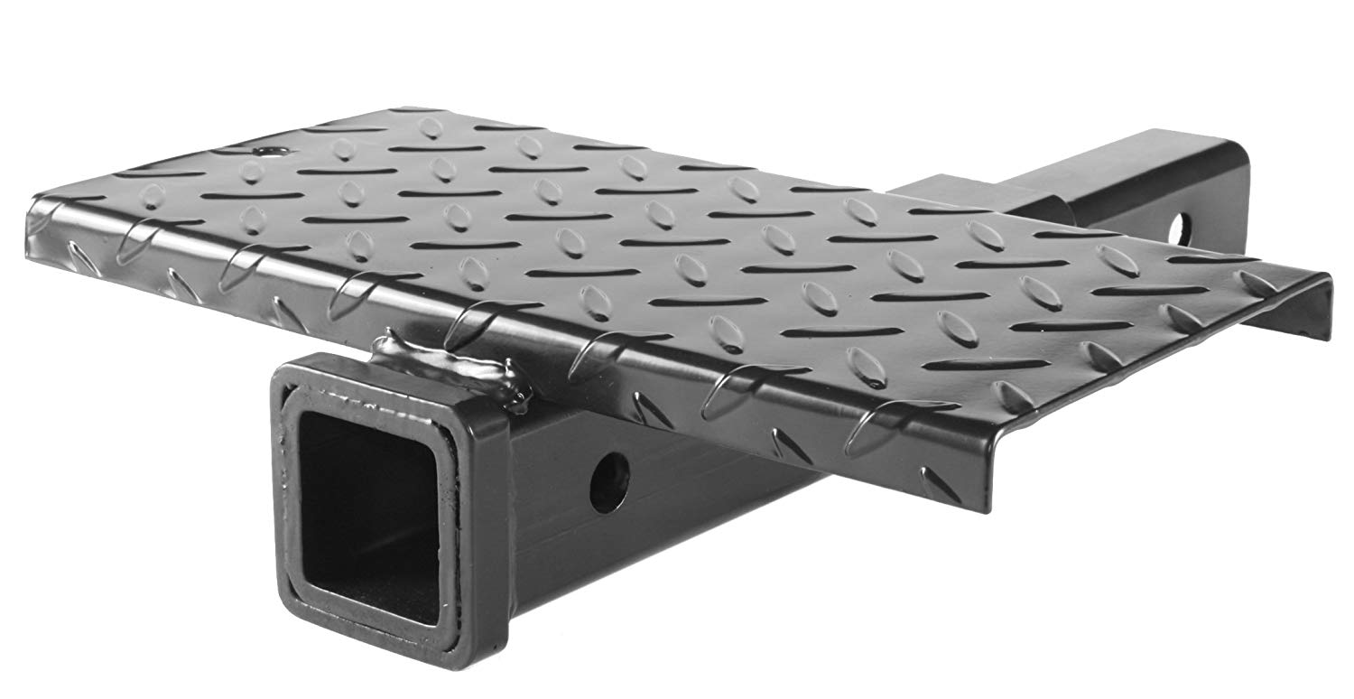

Thanks, Kavisiegel! You've inspired me for this project. Original BCS trailer is a little price drama for me, so I was looking for "something else" to hook up to my 732 GX11. I really like your choice for Polar HD 1500. Location of wheels (as a center of gravity shifted a bit back) is perfect!
I've purchased HD 1200 though as it fits better into my garage but it is pretty same thing, just a bit smaller. Next, as I live in the bushes, I had to find out an easy way to hook it up without "customized" parts. Here is what I've found:
MaxxHaul 70069 Hitch Extender With Step, 4000-lb Max Towing Weight, 400-lb Tongue Weight. CDN$45 at Amazon. No need to modify it as it is hollow on the tractor side.
It works perfectly with BCS small Curved Coupler
In five minutes I was able to have fun driving around!
Thanks again for the inspiration and I hope it will help others to make this little two wheels Italian friend to haul things around! :)
PS I was concerned about traction - not anymore! Fully loaded with fire wood trailer with me on top climbs up the hill, goes on the wet grass - no problem! Turning - yes, it needs some room, but who cares in the bushes :)

LefLef - awesome! I'm glad you were able to get some inspiration out of it. I like that yours has a step, that's the perfect place for a step too, I found myself standing on my adapter.
I noticed it looks like there's some slop between the BCS round and the square inside of the hitch adapter - I have an idea for you on that. Try to shim it out with some thin plastic cutting boards. They're normally made of HDPE which is a decent bushing material for something like this. Maybe get it warm and wrap it around the shaft a few times, it'll get pliable if you pop it in the oven at the lowest setting for a minute.

Thanks, Kavisiegel! This is good idea.
I'm also going to make some small wooden seat and mount it on the front edge of the trailer to make it more comfortable.
