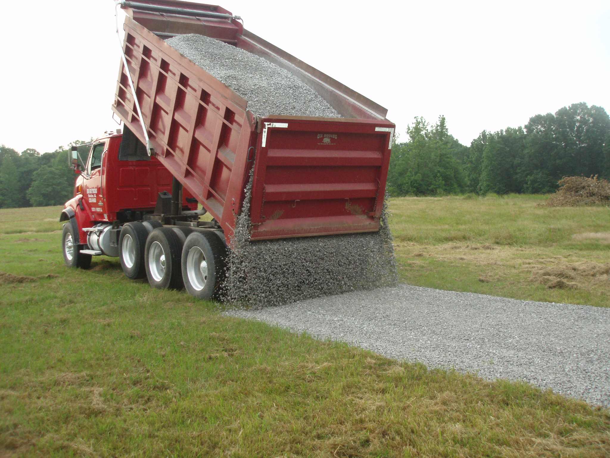

I'm building a 40' x 40' with a 14' lean-to on each side. My roll up "barrel" doors will be 12' x 12' and I'll have one 3' walk-in door. I'm planning for a 6" concrete slab thru the center where the tractor will be be parked / pulled and approximately 4" everywhere else. I plan to have electricity and water available also. I'll keep you updated to the progress via photos.

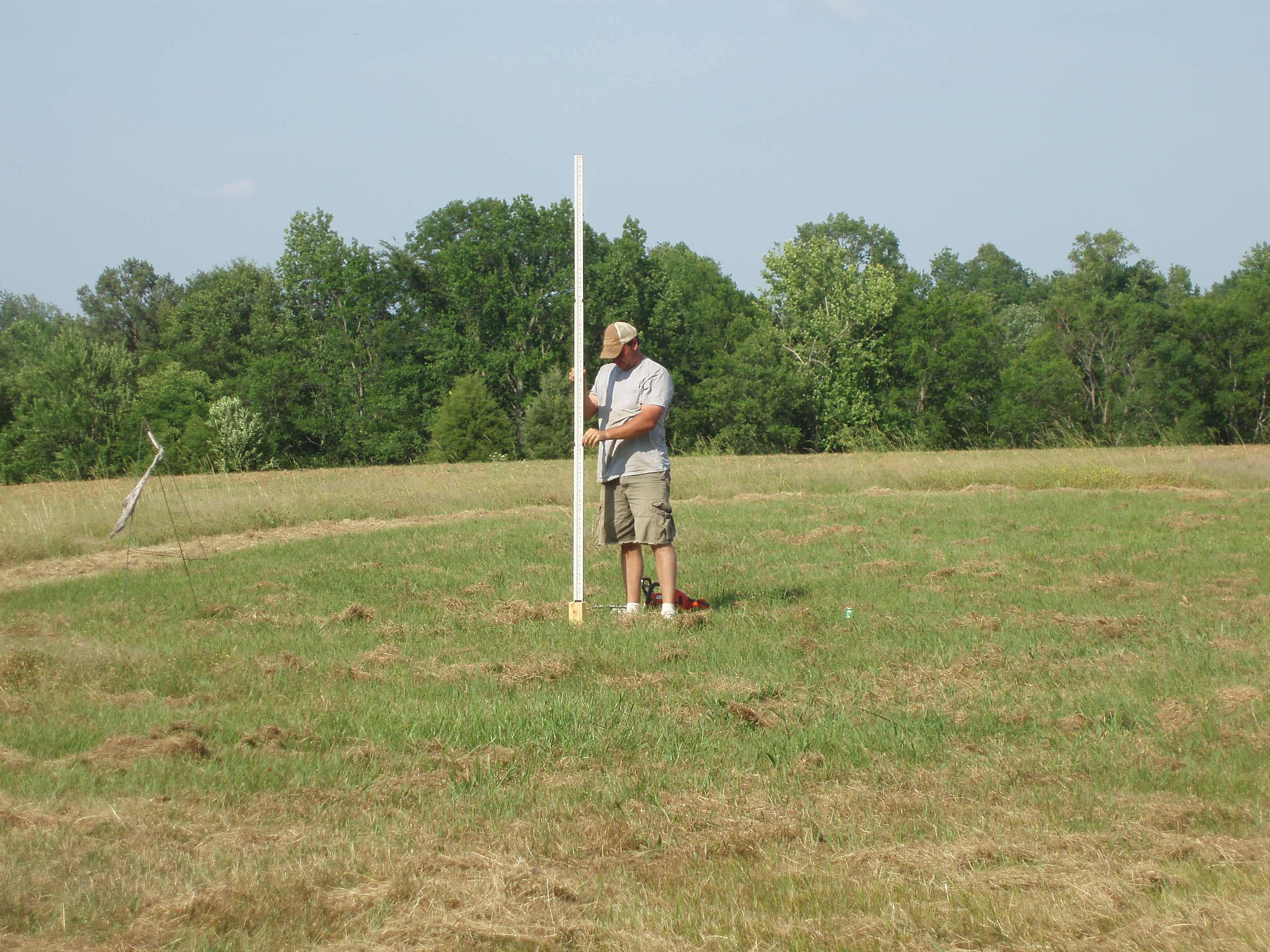

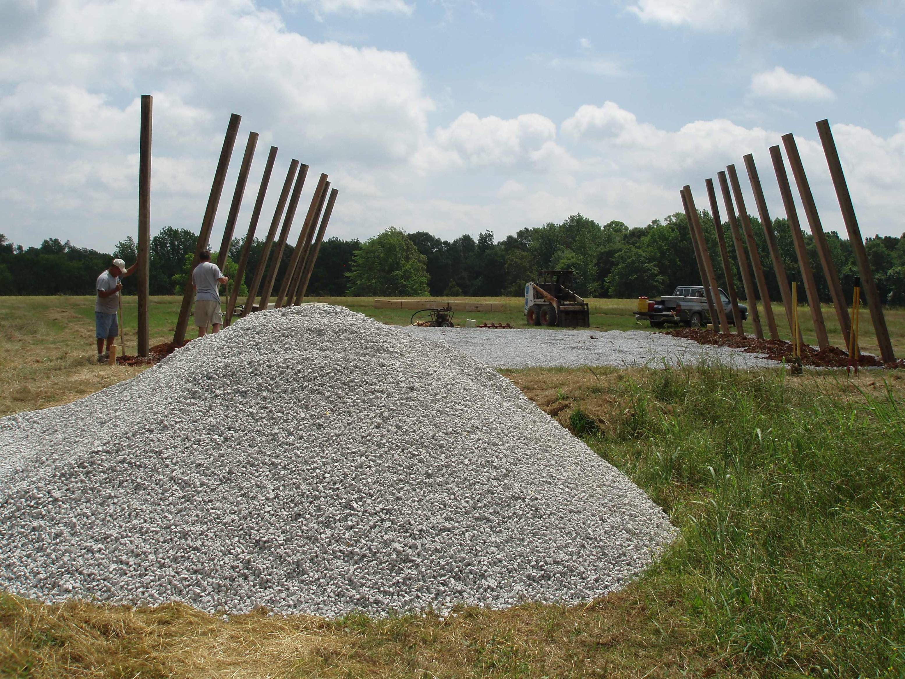

Photo 1: shooting the grade for my slab.

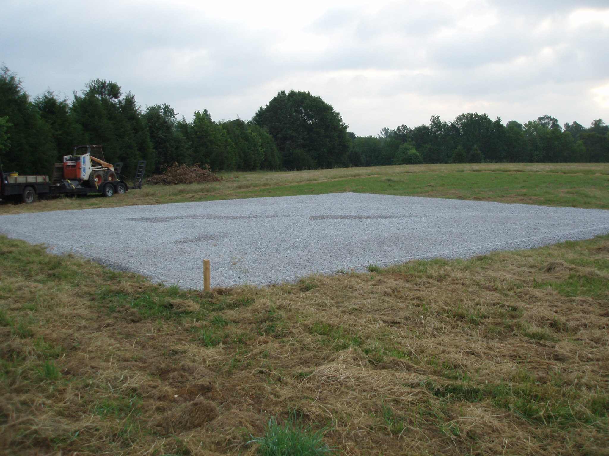

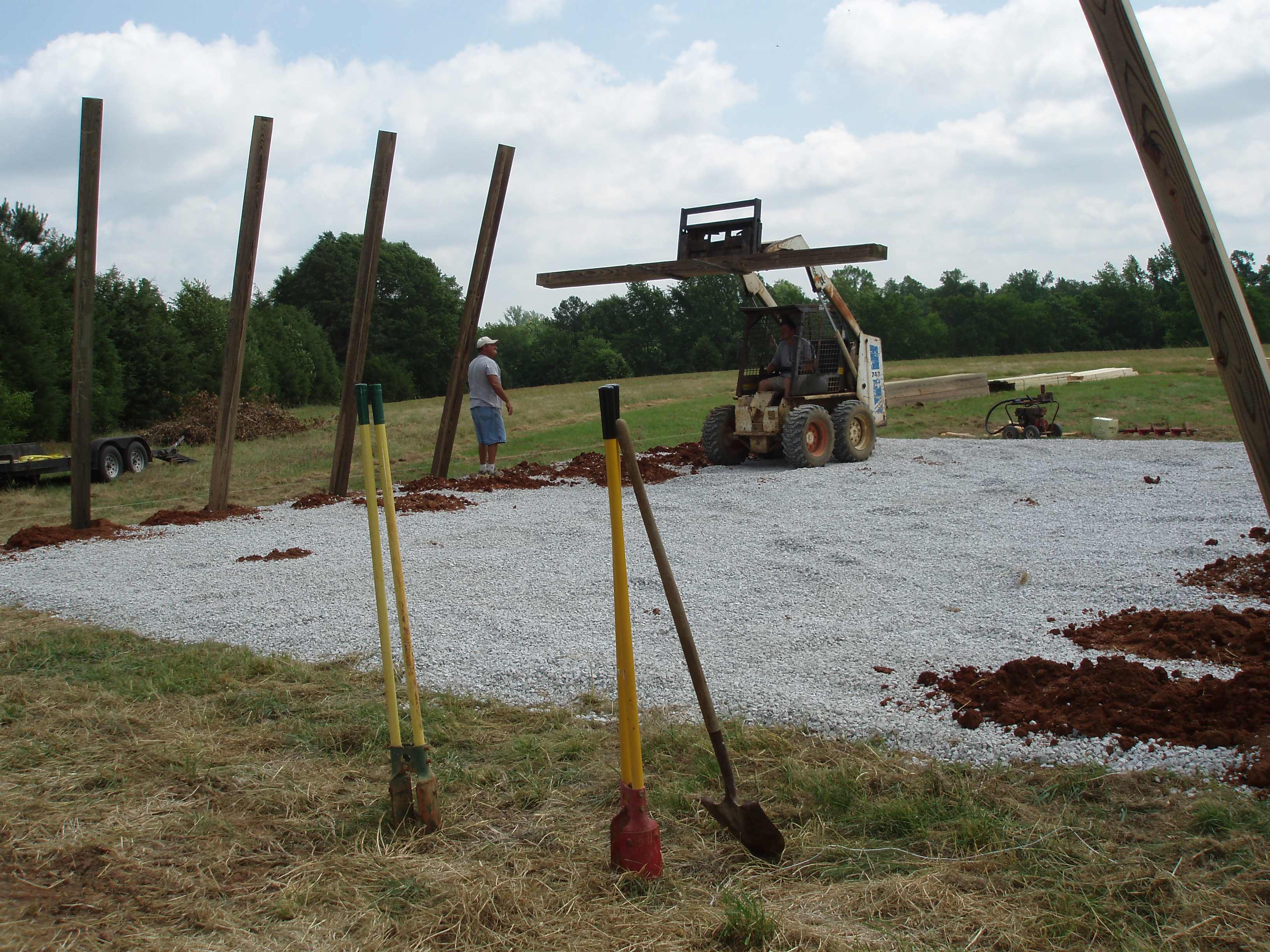

Photo 2: It took just over 24 ton of gravel for the base. I fine tuned it with my JD 4320 FEL and a 6' landscape box
Photo 3: Final gravel base leveled to the stakes driven earlier. Note the string that is approximately grade level.

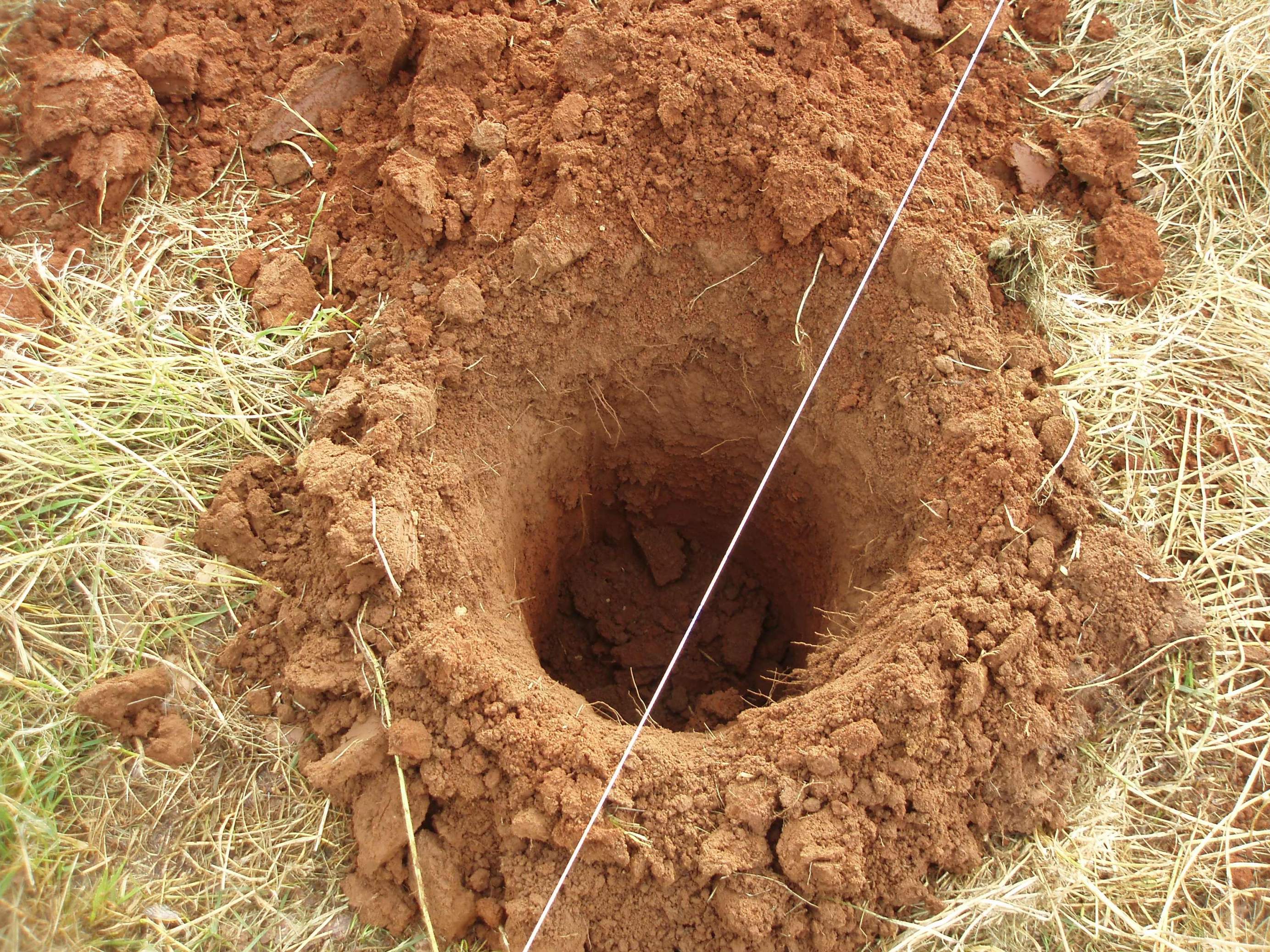

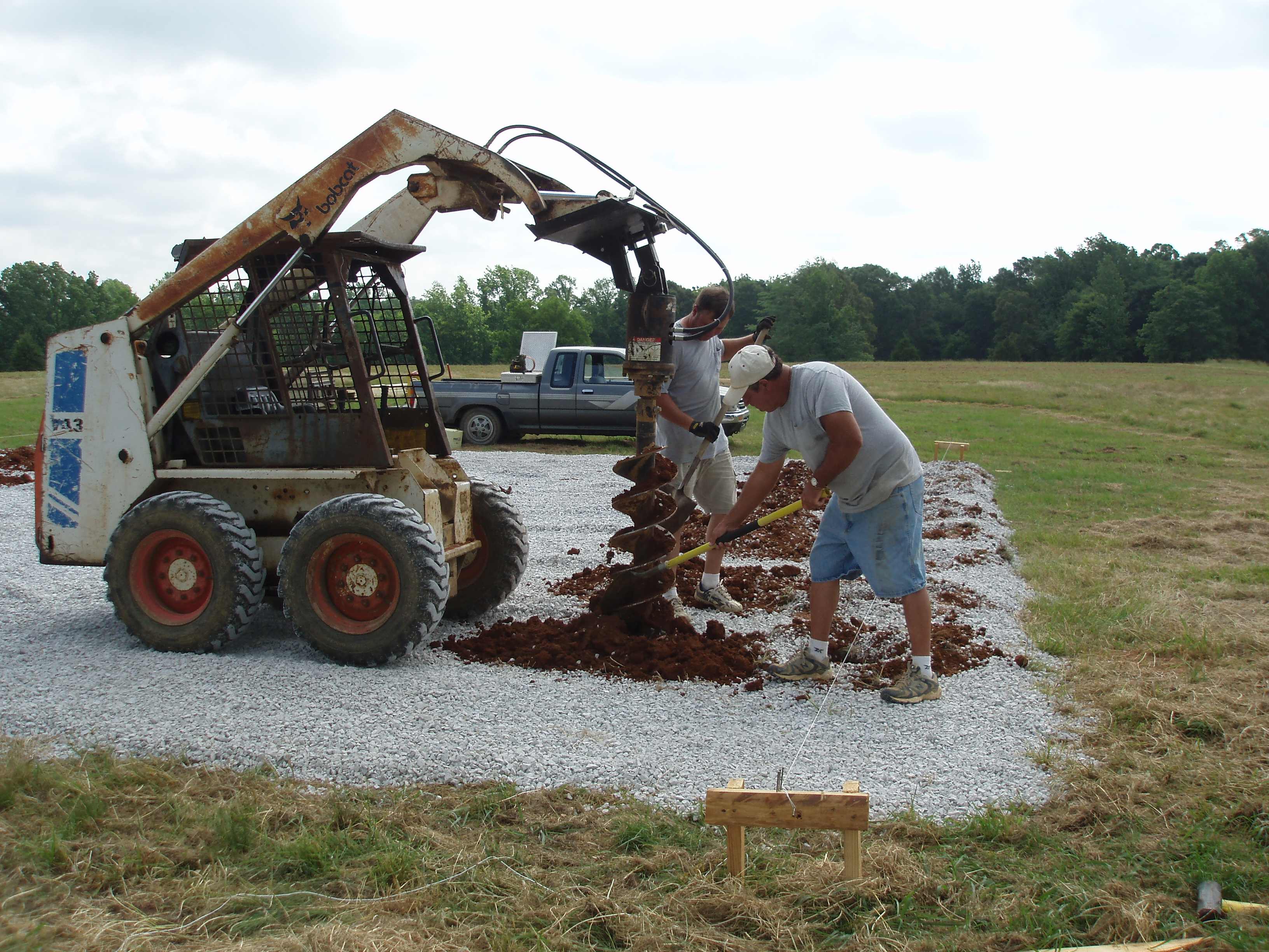

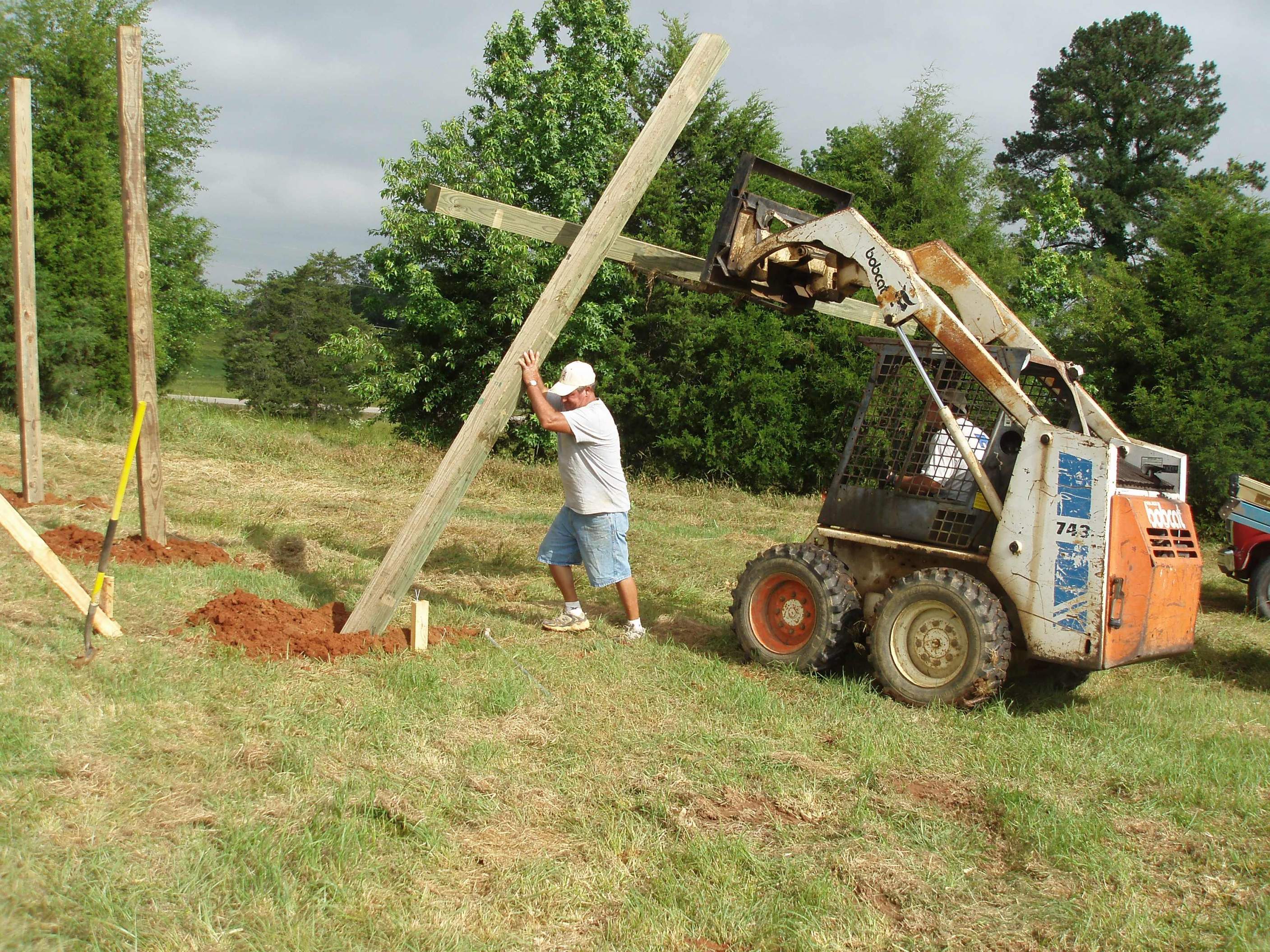

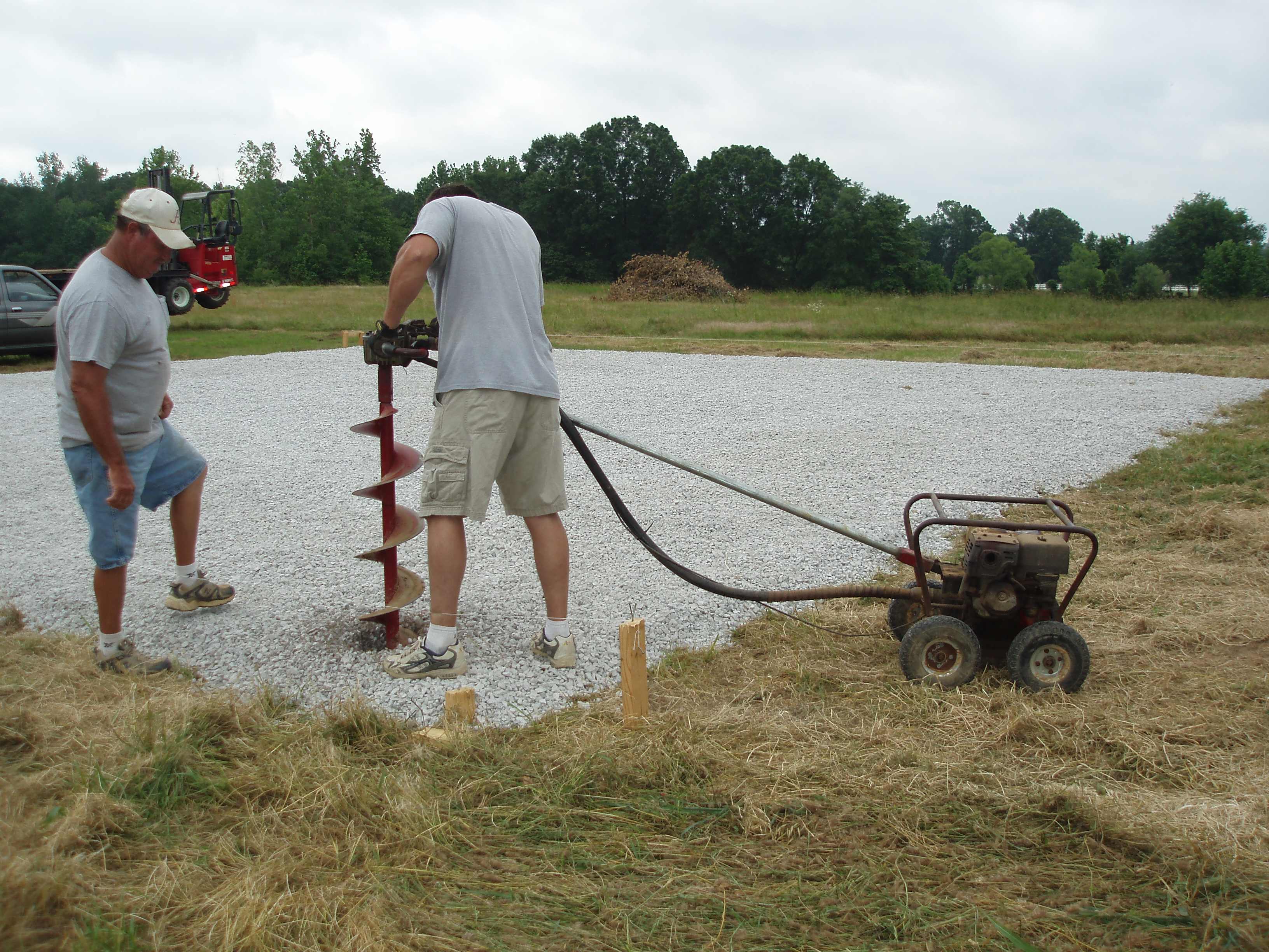

Photo 4:They tried drilling the holes with this small hole digger but my red dirt was too hard.

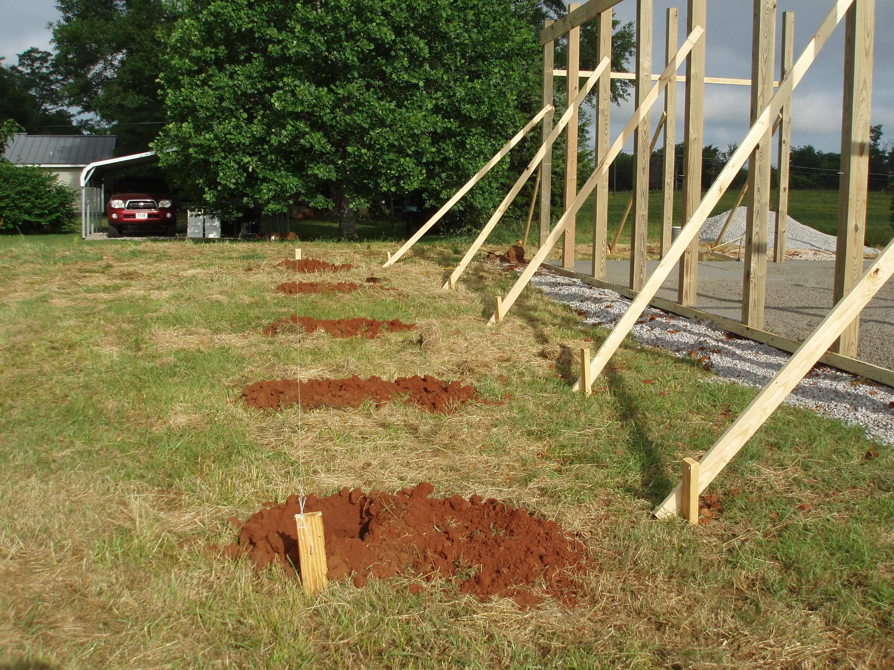

Photo 5: The bobcat attachment still had to work to drill the holes for the 6" x 6" pt posts.

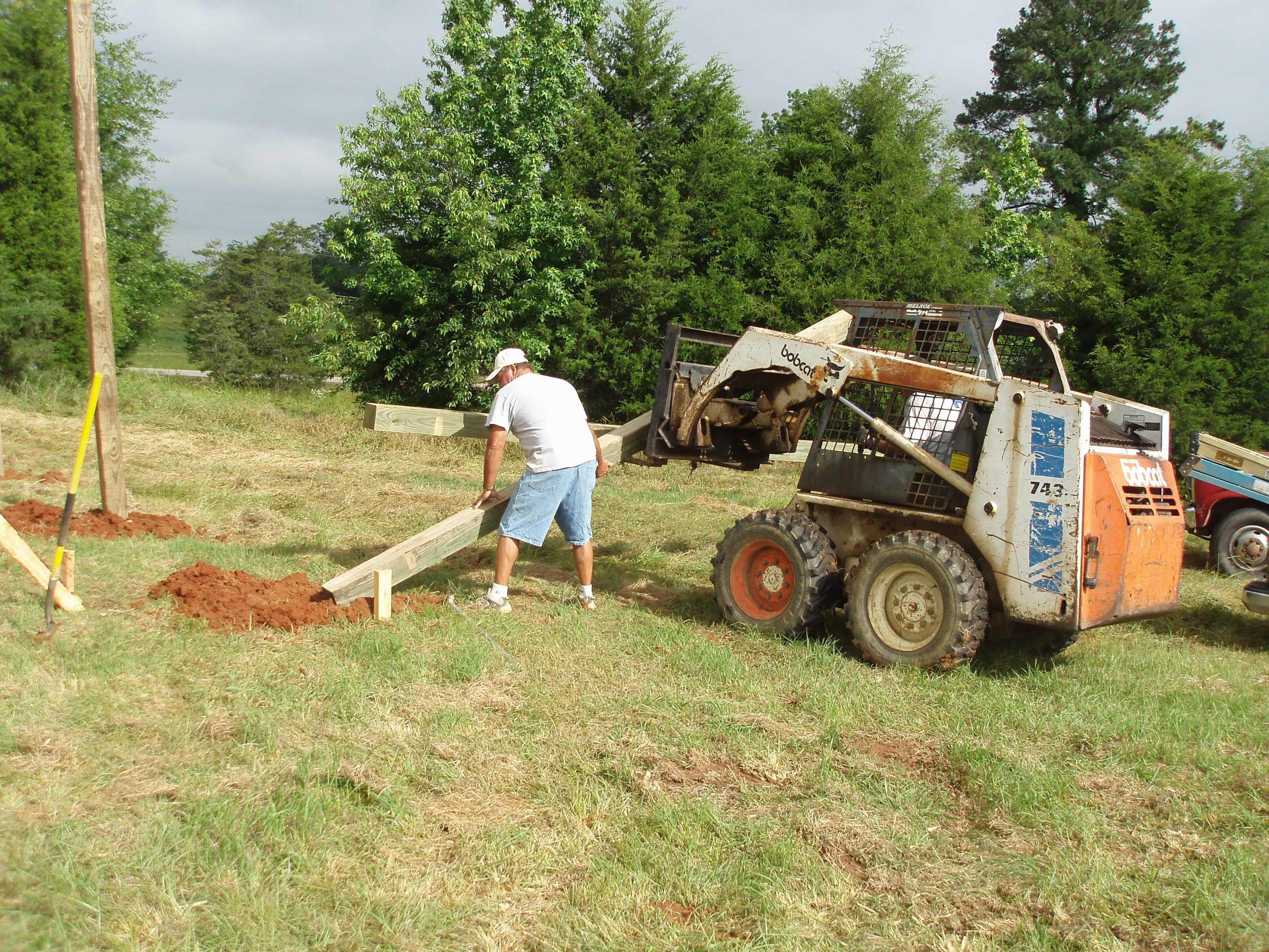

Photo 6: Placing the 6" x 6" poles in the holes.
Photo 7: A look at the the poles.

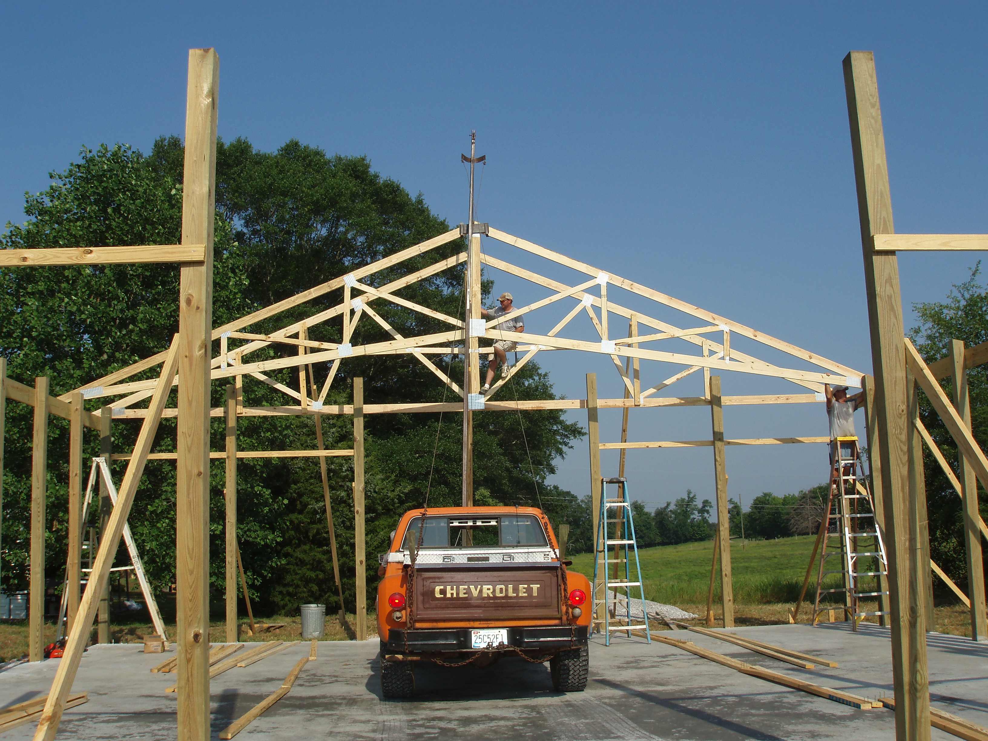

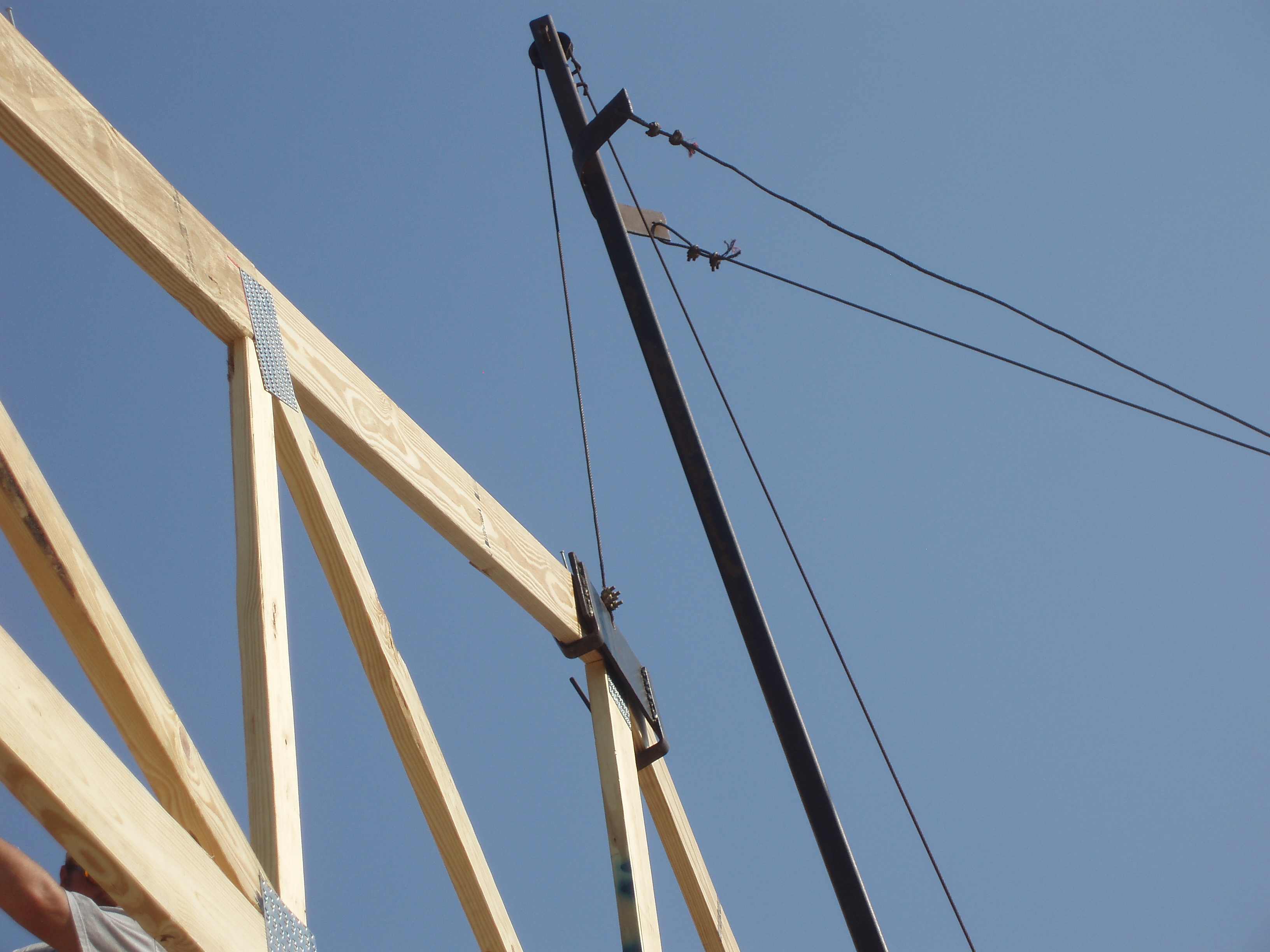

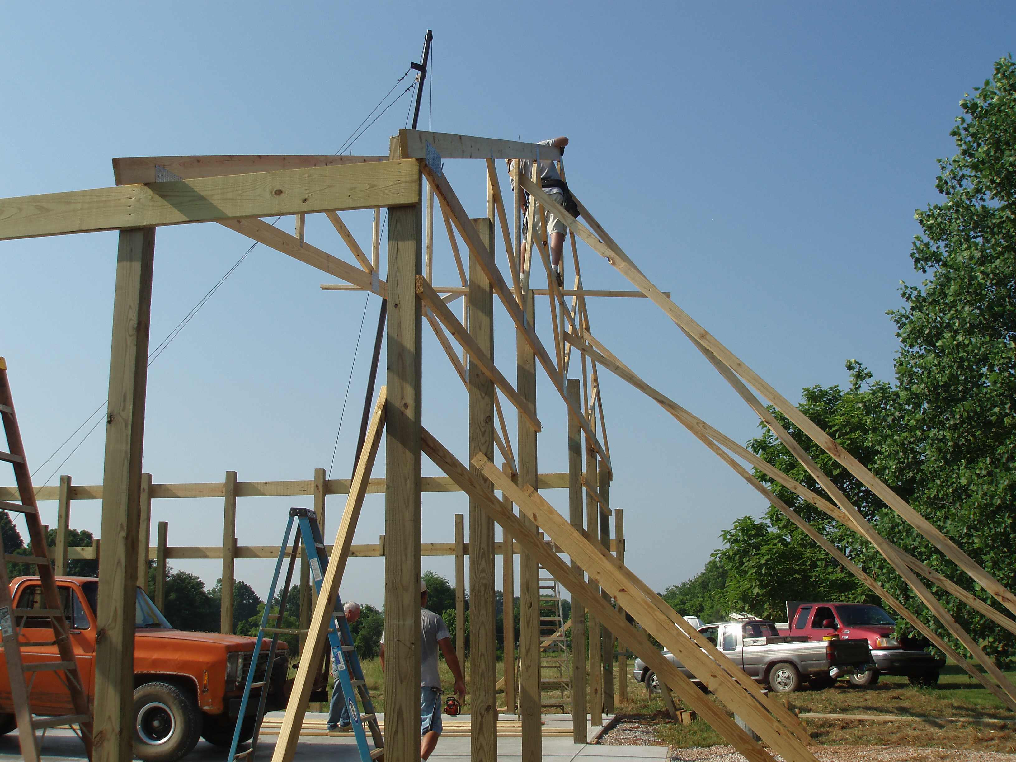

Photo 8: Framing started.

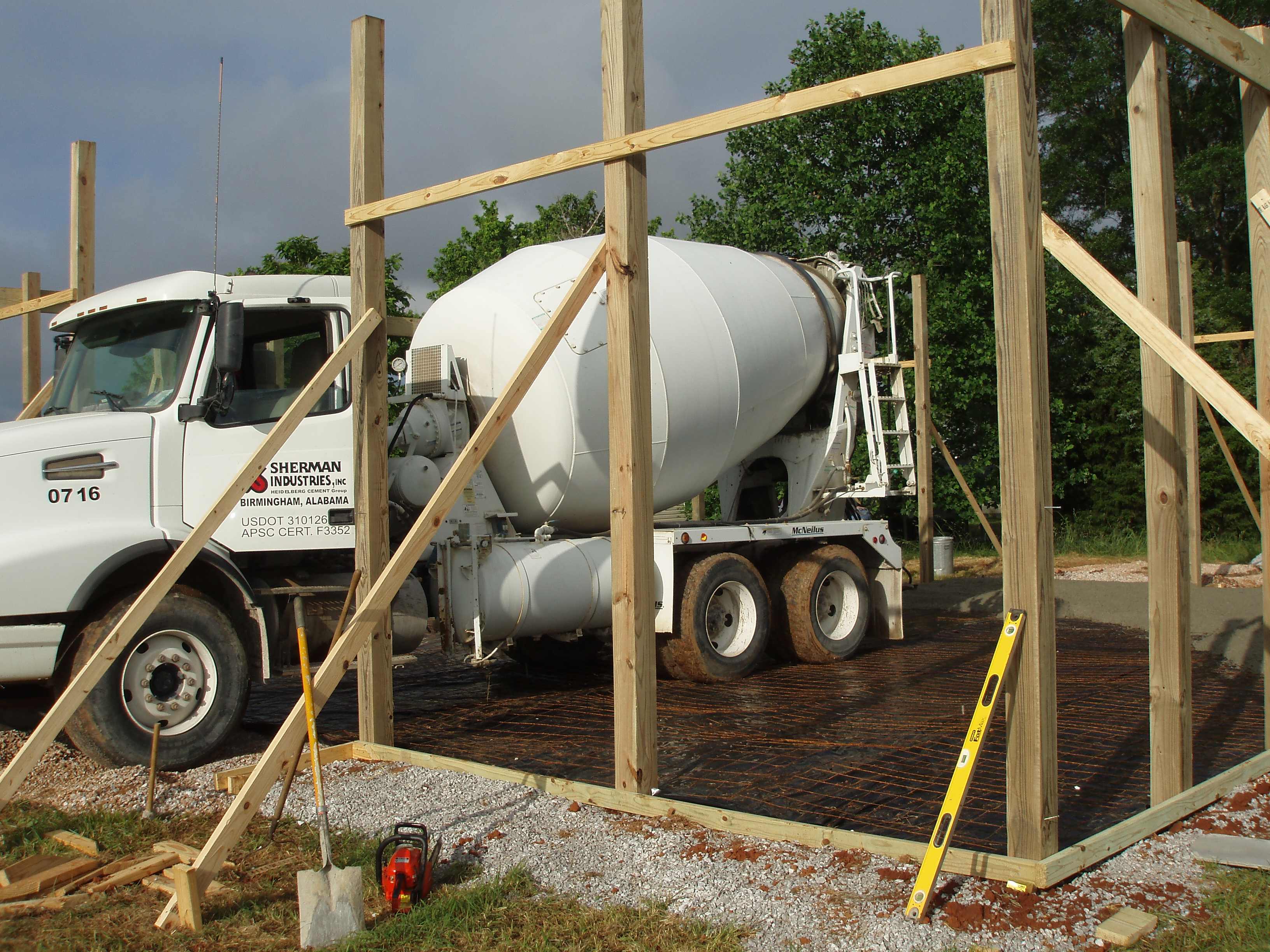

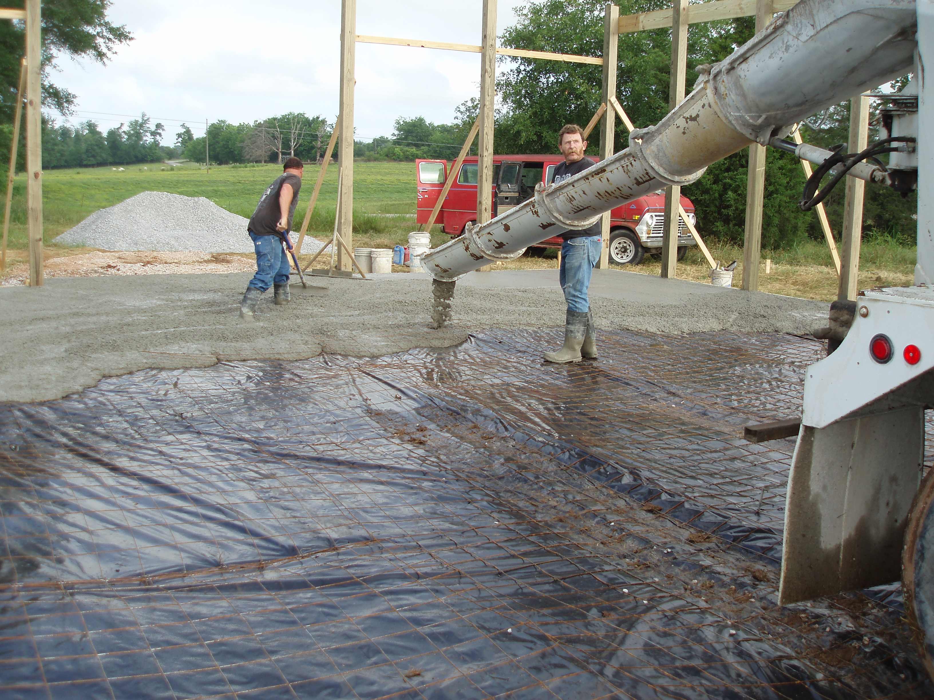

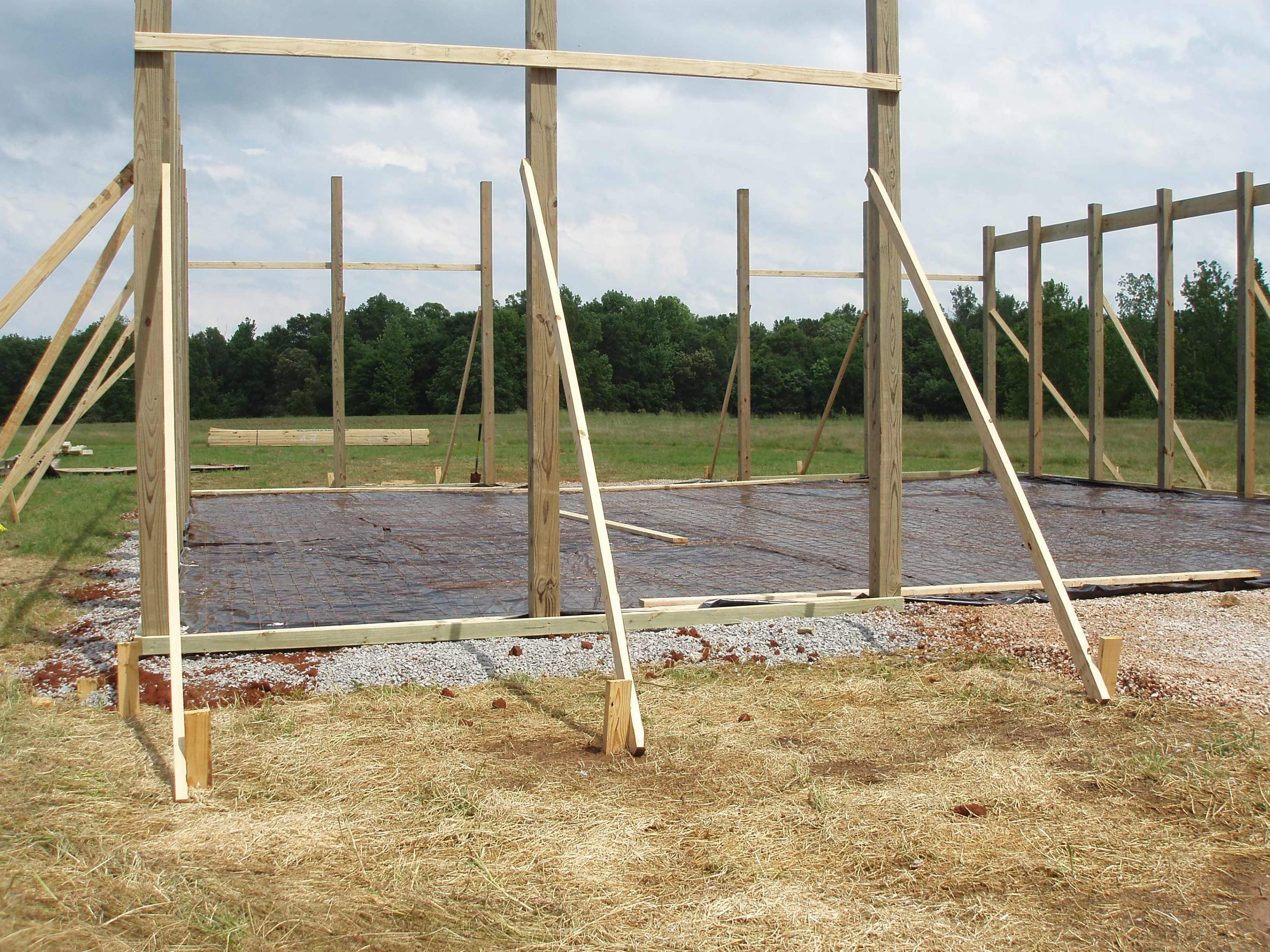

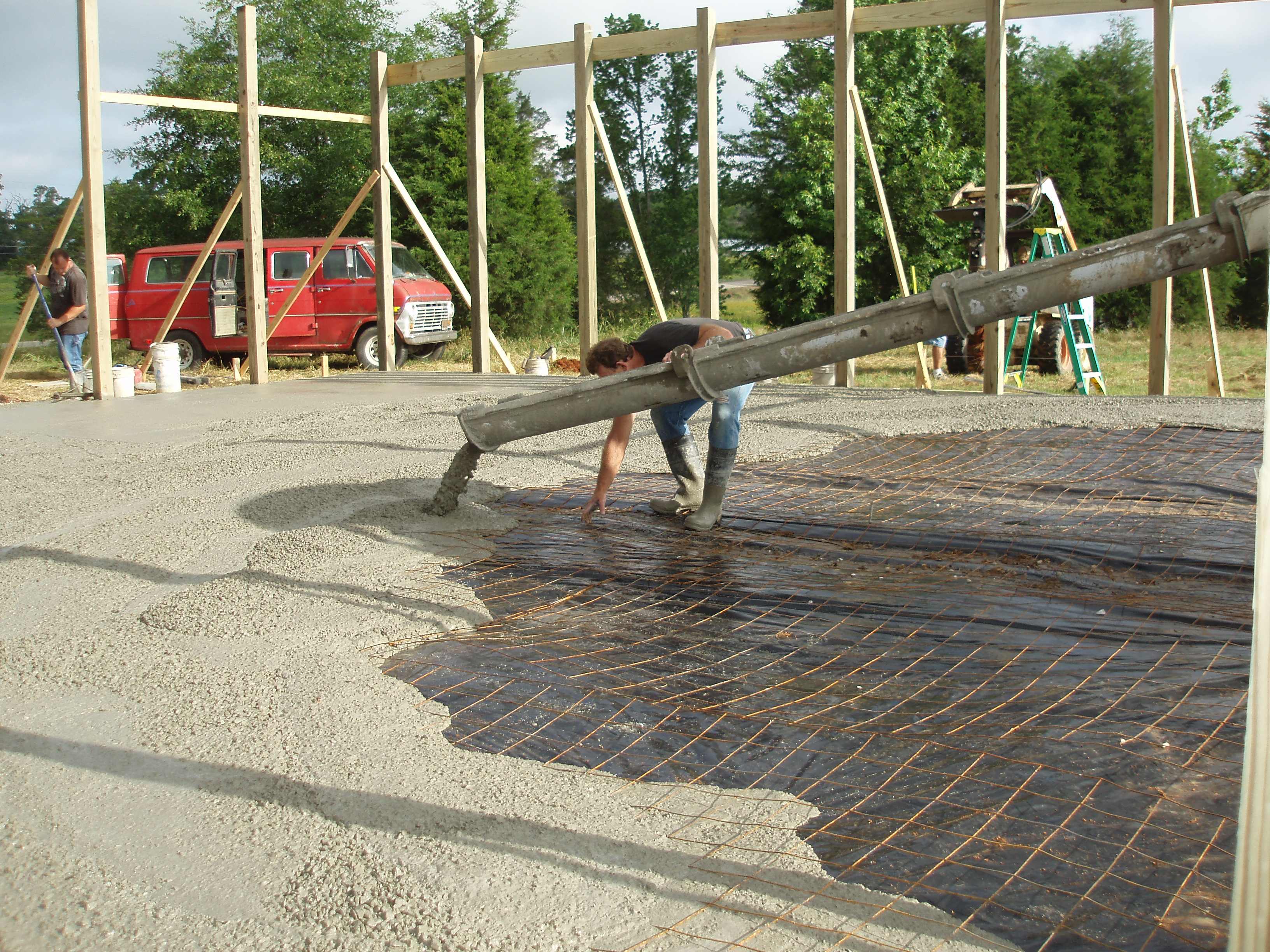

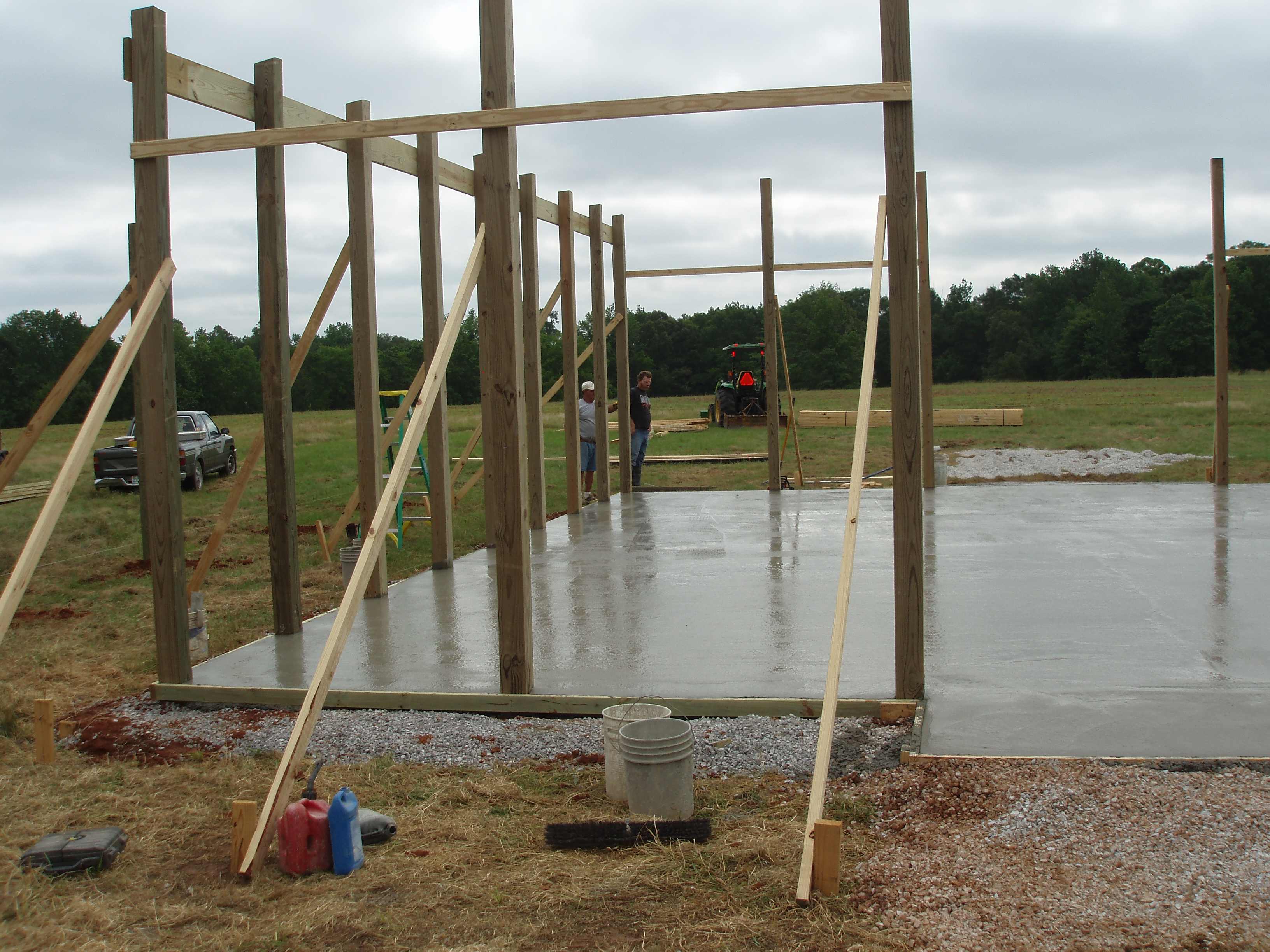

Concrete photos. We had spread the gravel to grade and put down a layer of plastic and then reinforcing wire over the plastic before pouring the concrete.
I'm very pleased with the way the slab turned out. The slab as poured took 21.25 yards of concrete which cost $1986. That includes the concrete, tax, environmental fees and fuel surcharge. I paid the finishers $440 to pour and finish the concrete and they did an excellent job.

Are those posts just set in tamped earth? or are they set in/on concrete.

I am not a builder, but have never seen concrete poured on top of grass. Was always told to remover the grass/top soil first.

JB: The post are in tamped earth, really tamped hard. I wrestled with the idea of filling the holes with concrete around the poles but didn't.

wirenut: Interesting. The builder told me it was my option but with the firmness of my ground he didn't see any need of it. He suggested I mow it as close as possible and I did.

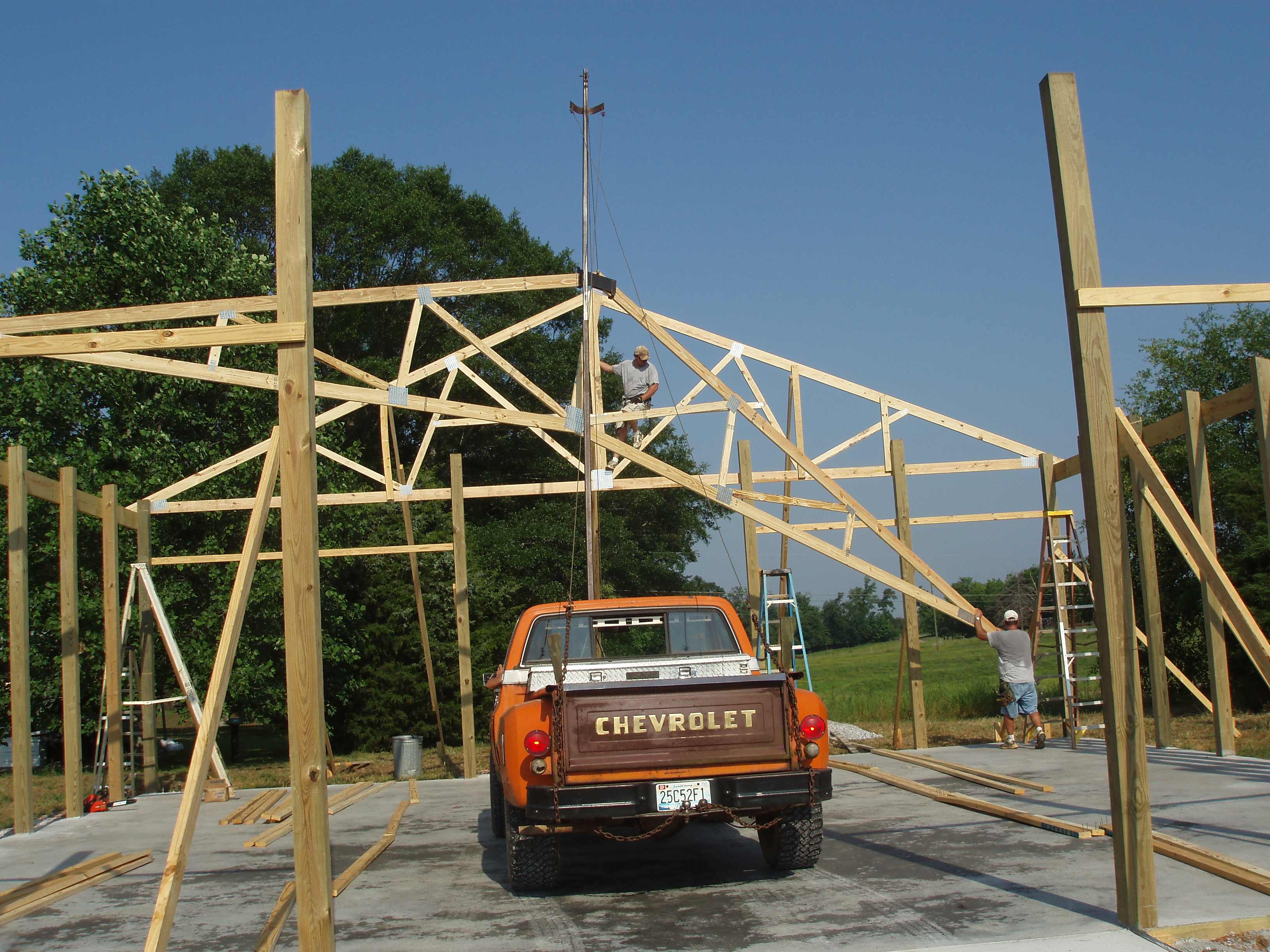

The barn is ready for the metal now although I don't have the pictures ready yet. It is terrible hot here now. The temperature today between 2 and 3 pm was 98 degrees and the heat index around 105. Some more pictures:
