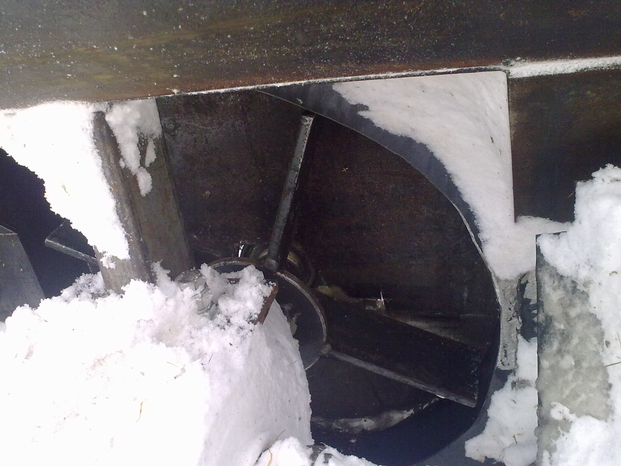

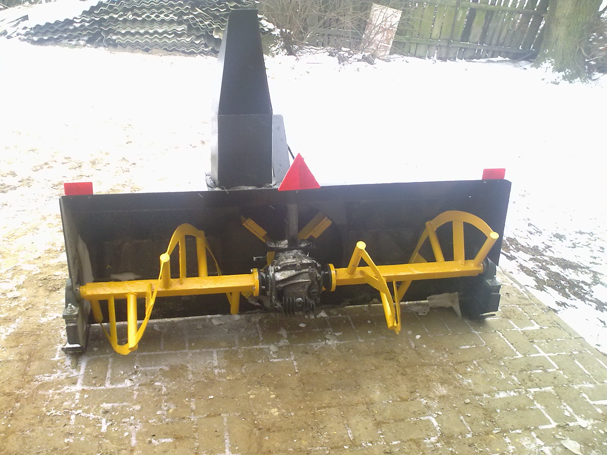

Hi my projects it presents the snow blower.
I started with the simplest, the execution of it in a few hours:
[ame=http://www.youtube.com/watch?v=02AwDWlUBaI]Yanmar YM2000 + wirnik do sniegu - YouTube[/ame]
[ame=http://www.youtube.com/watch?v=kdOLvlh_PhI]Yanmar YM2000 z wirnikiem do ?niegu pokaz zbierania przez lemiesze - YouTube[/ame]
[ame=http://www.youtube.com/watch?v=sqjoG1gItOg]Yanmar YM2000 + wirnik do ?niegu, 1 bieg wa?ka WOM - YouTube[/ame]
[ame=http://www.youtube.com/watch?v=TzM7AFAWn7g]Yanmar YM2000 + wirnik do ?niegu piotrbpm - YouTube[/ame]

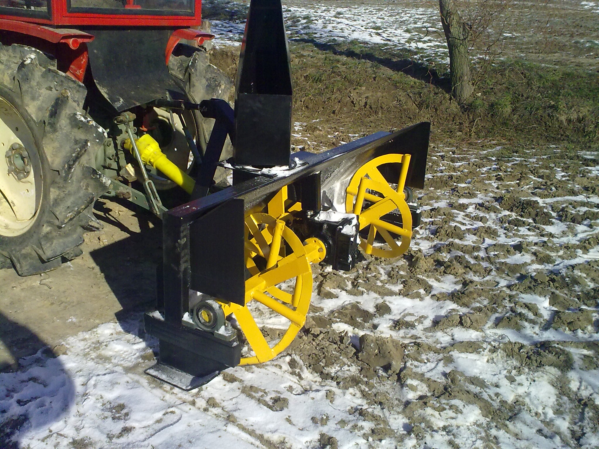

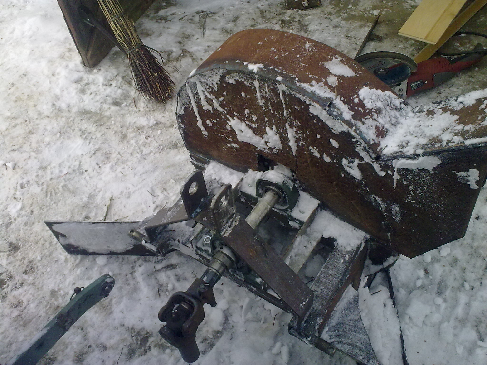

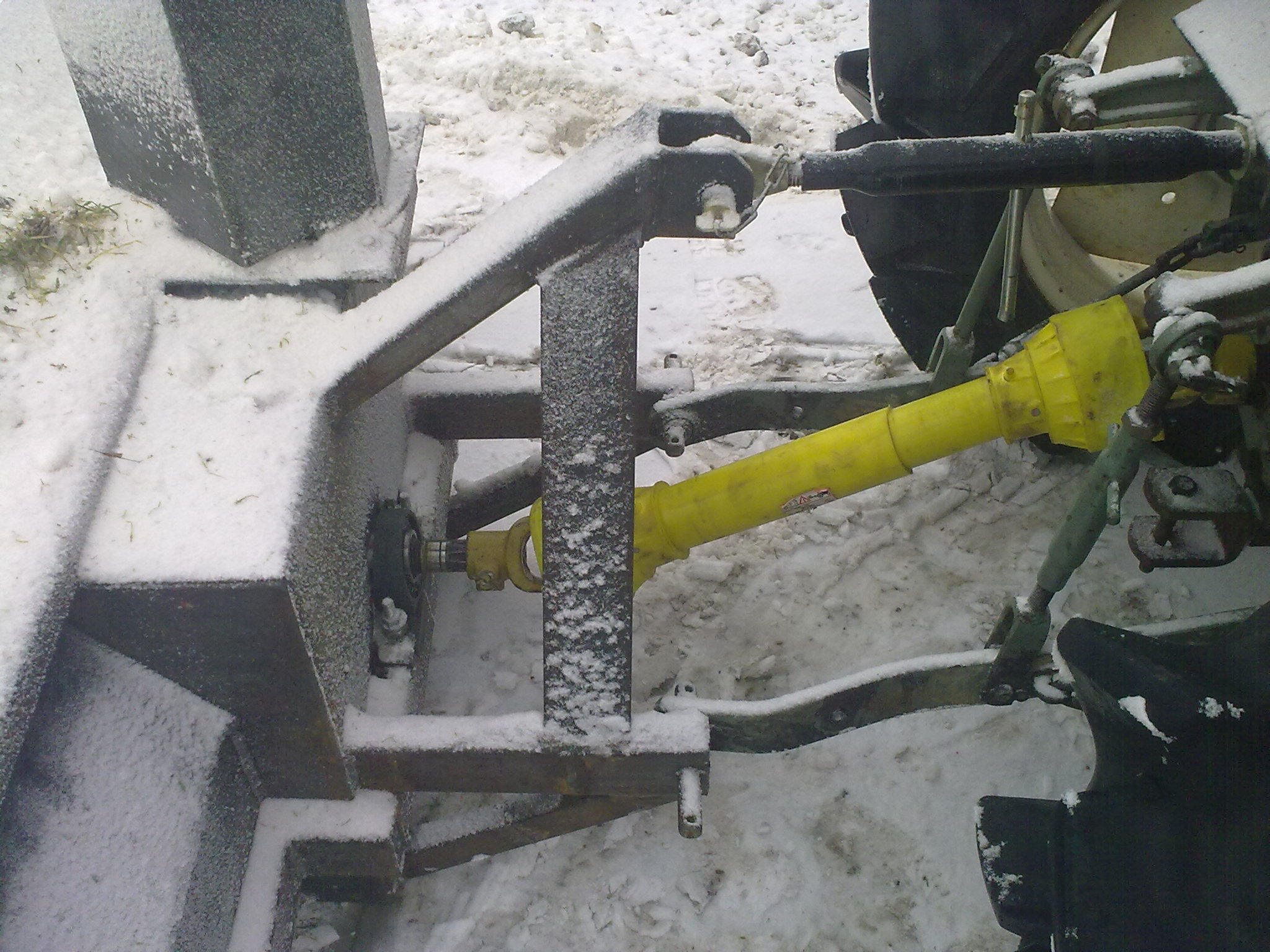

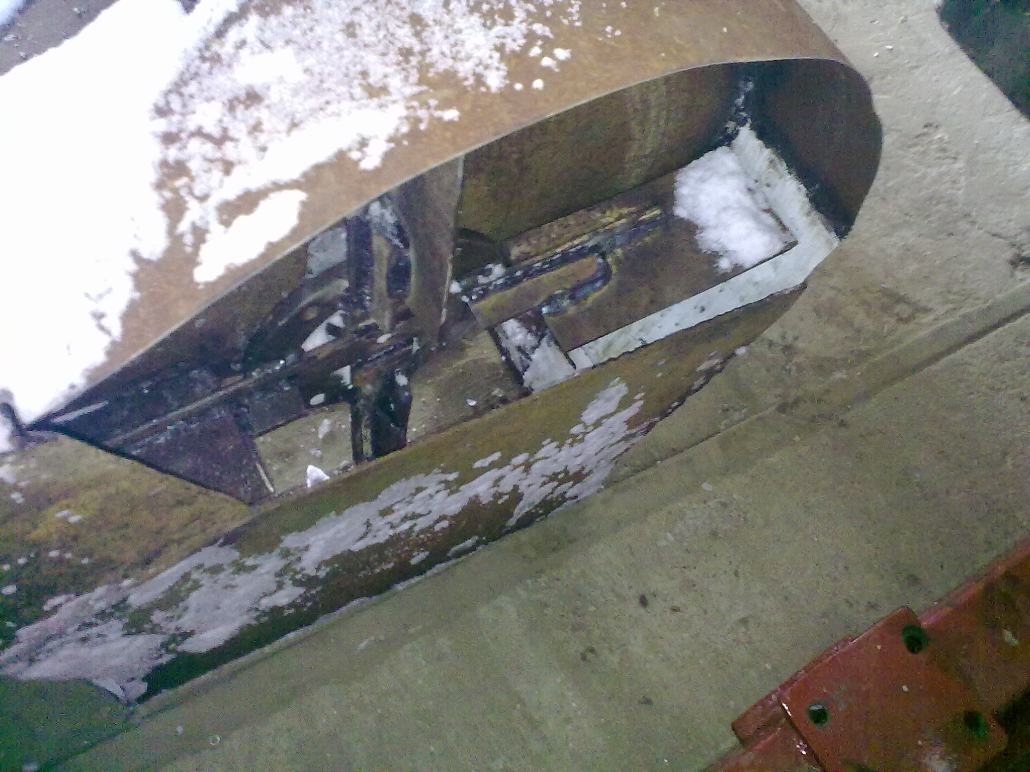

Another project has been improved, but unfortunately I do not have a movie of his work.
I only remaining pictures, because right away he was a merchant

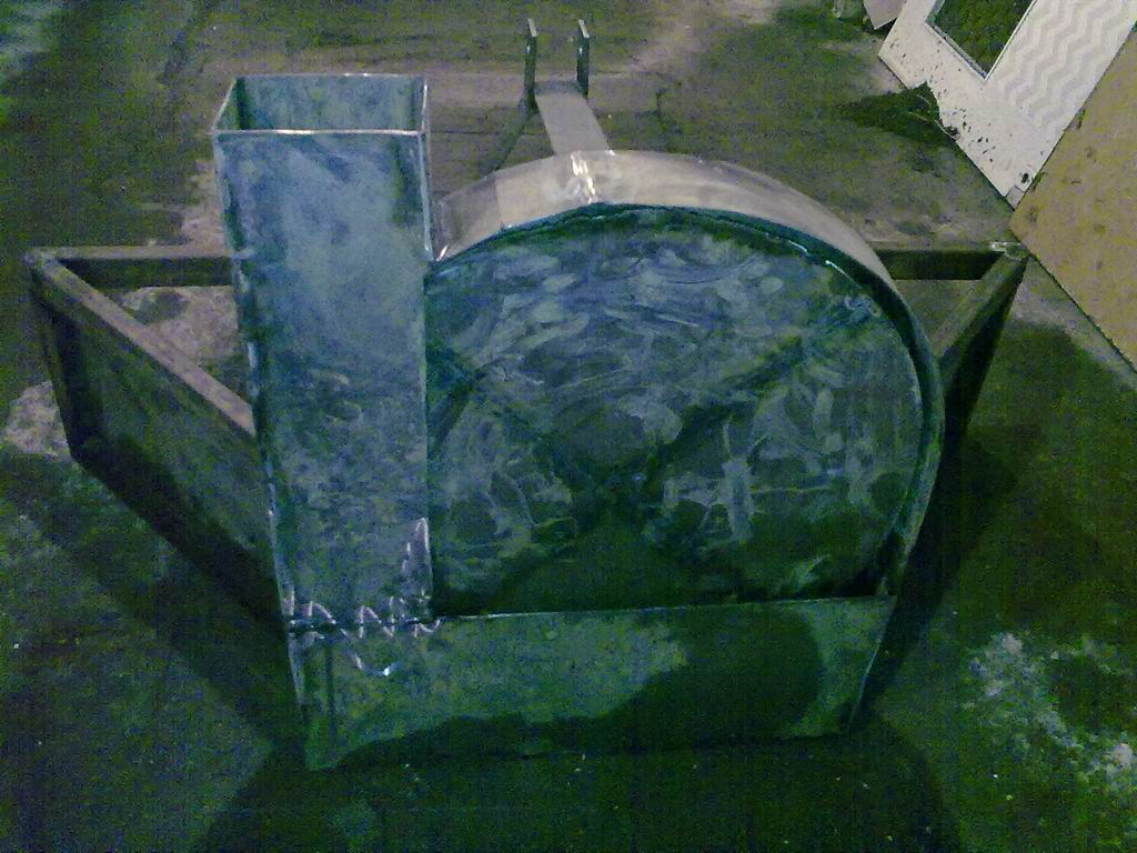

   / My new and old projects snow blowers for Japanese tractors

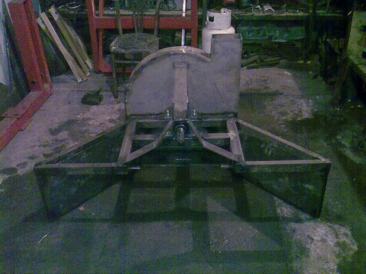

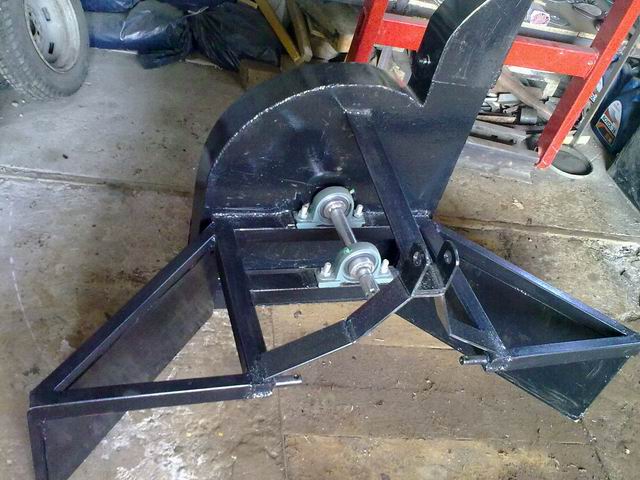

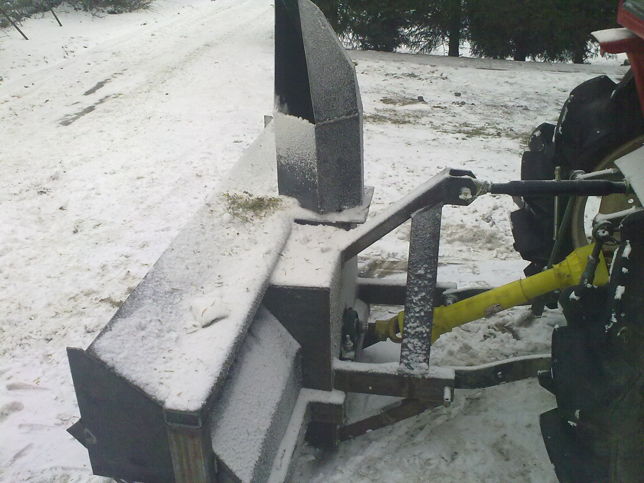

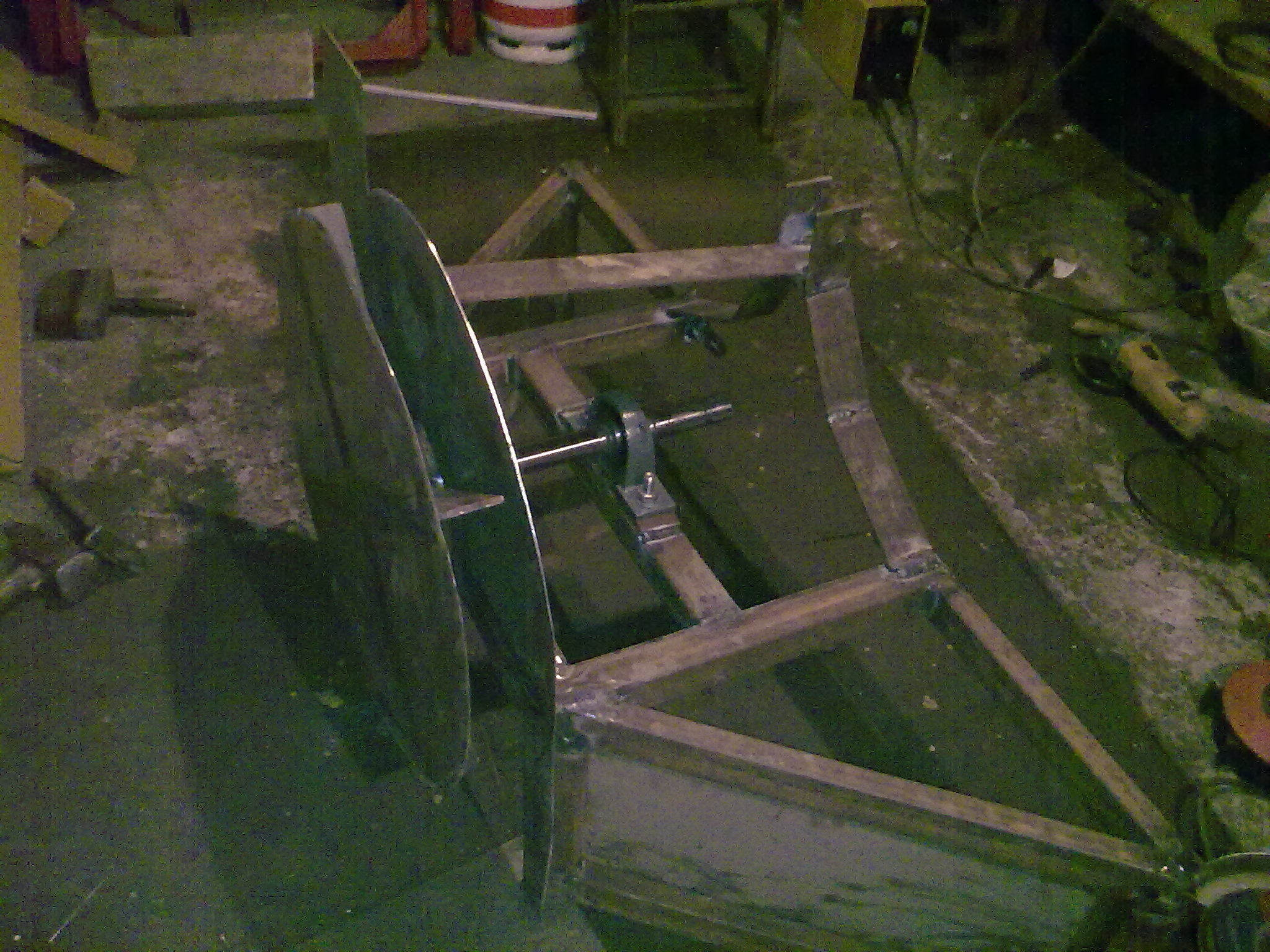

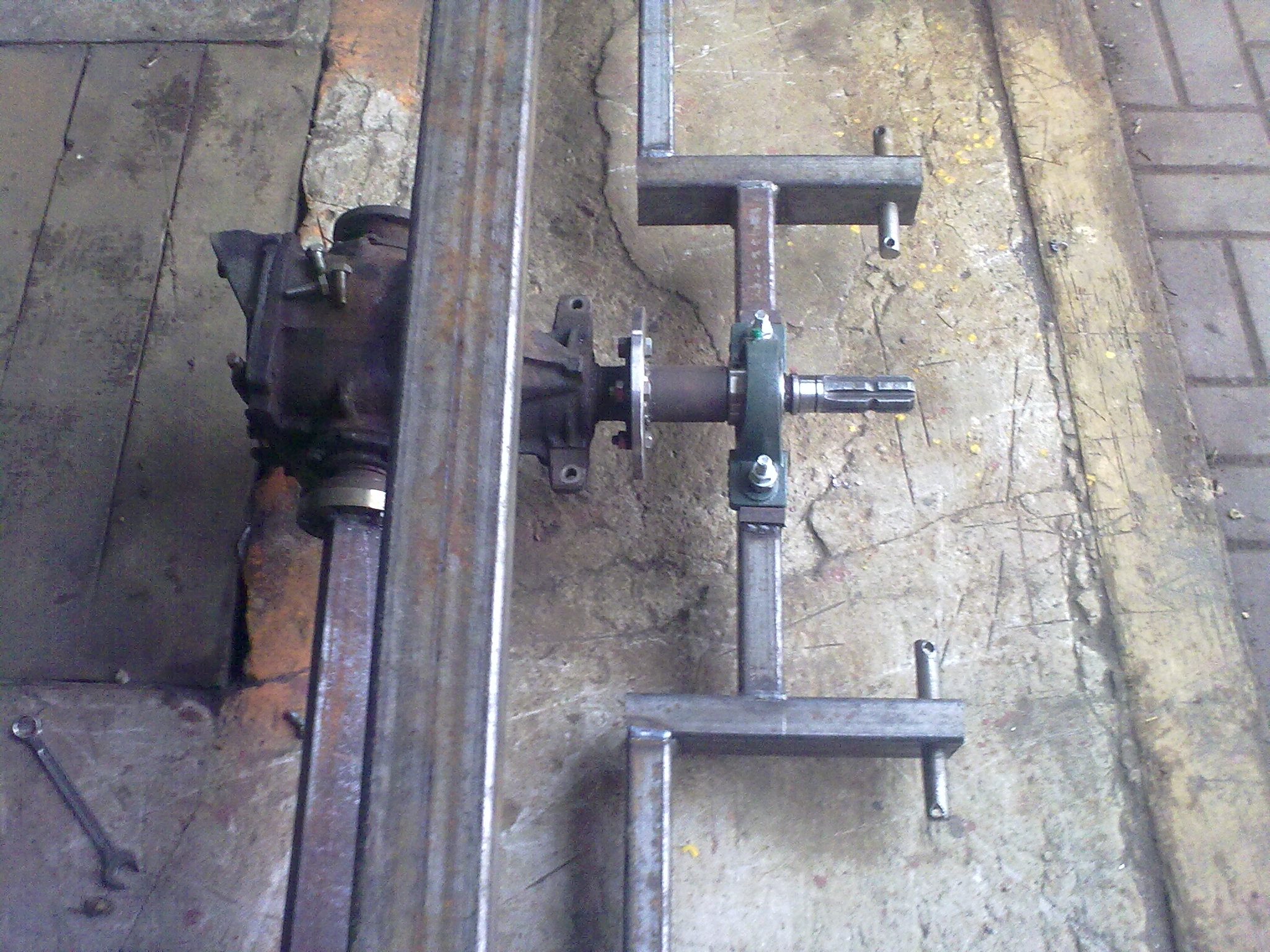

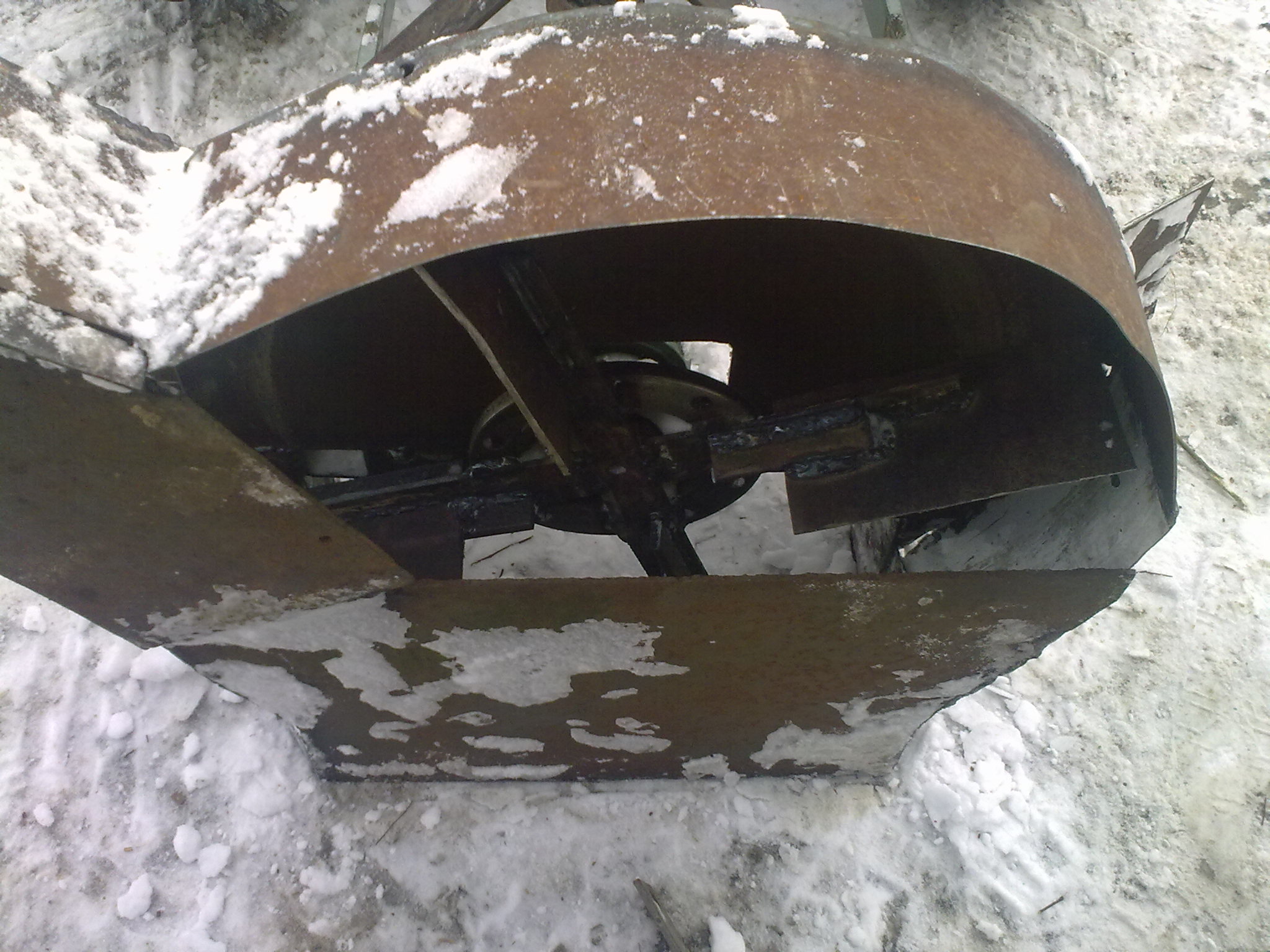

The next winter I built a different structure, more reminiscent of the original snow blower

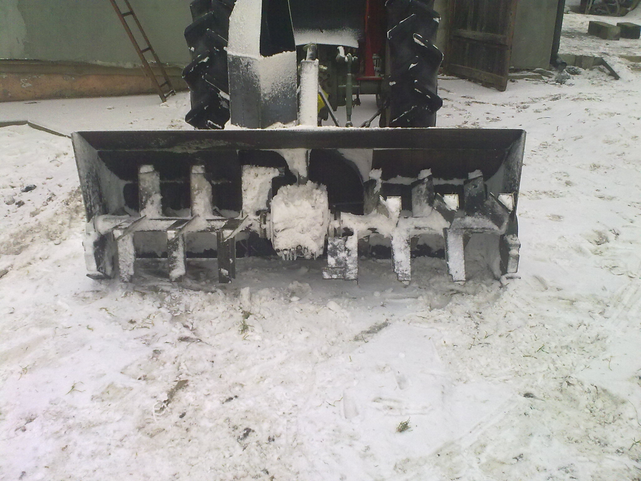

Two films I've done tests with small amounts of snow on the more could be expected that winter
[ame=http://www.youtube.com/watch?v=XcN7V8EHmkw]Yanmar YM2210 + p?ug wirnikowy w?asnej konstrukcji snowblower home made.avi - YouTube[/ame]
[ame=http://www.youtube.com/watch?v=7OvXH58q7Fs]P?ug wirnikowy w?asnej konstrukcji + Yanmar YM2210 Snowblower home made - YouTube[/ame]

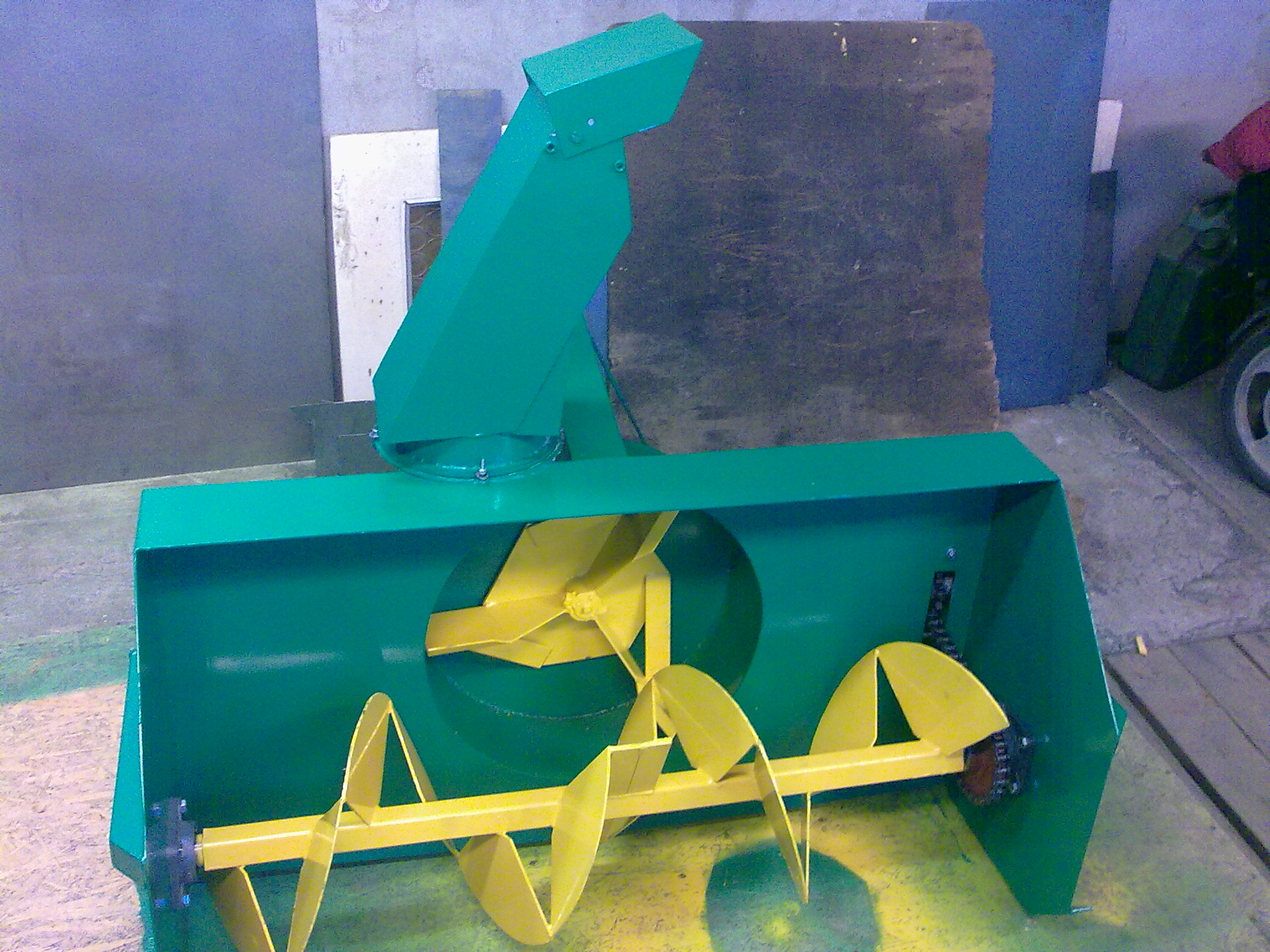

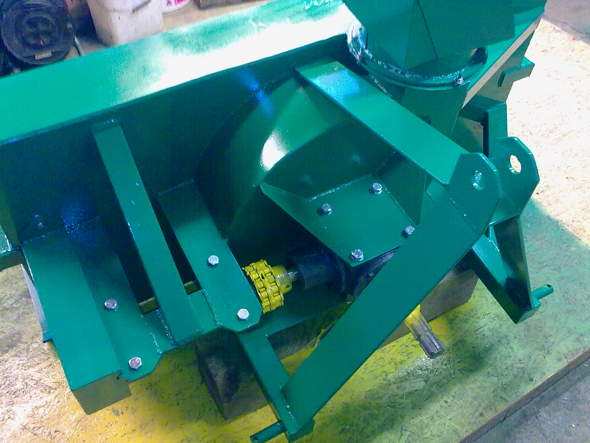

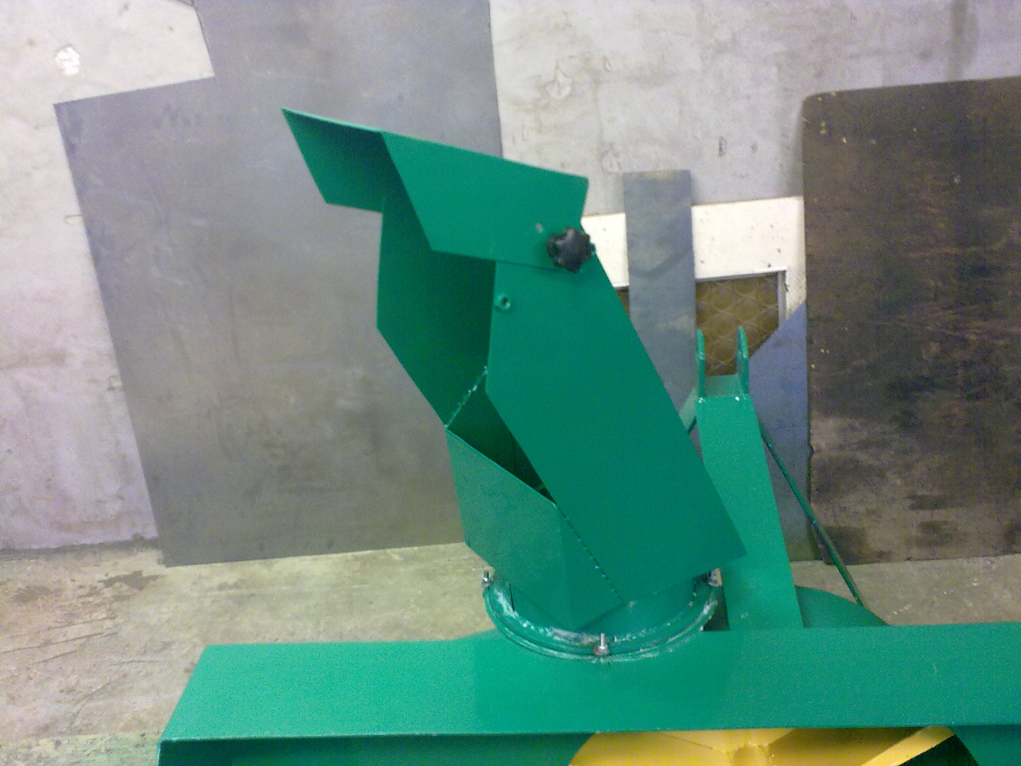

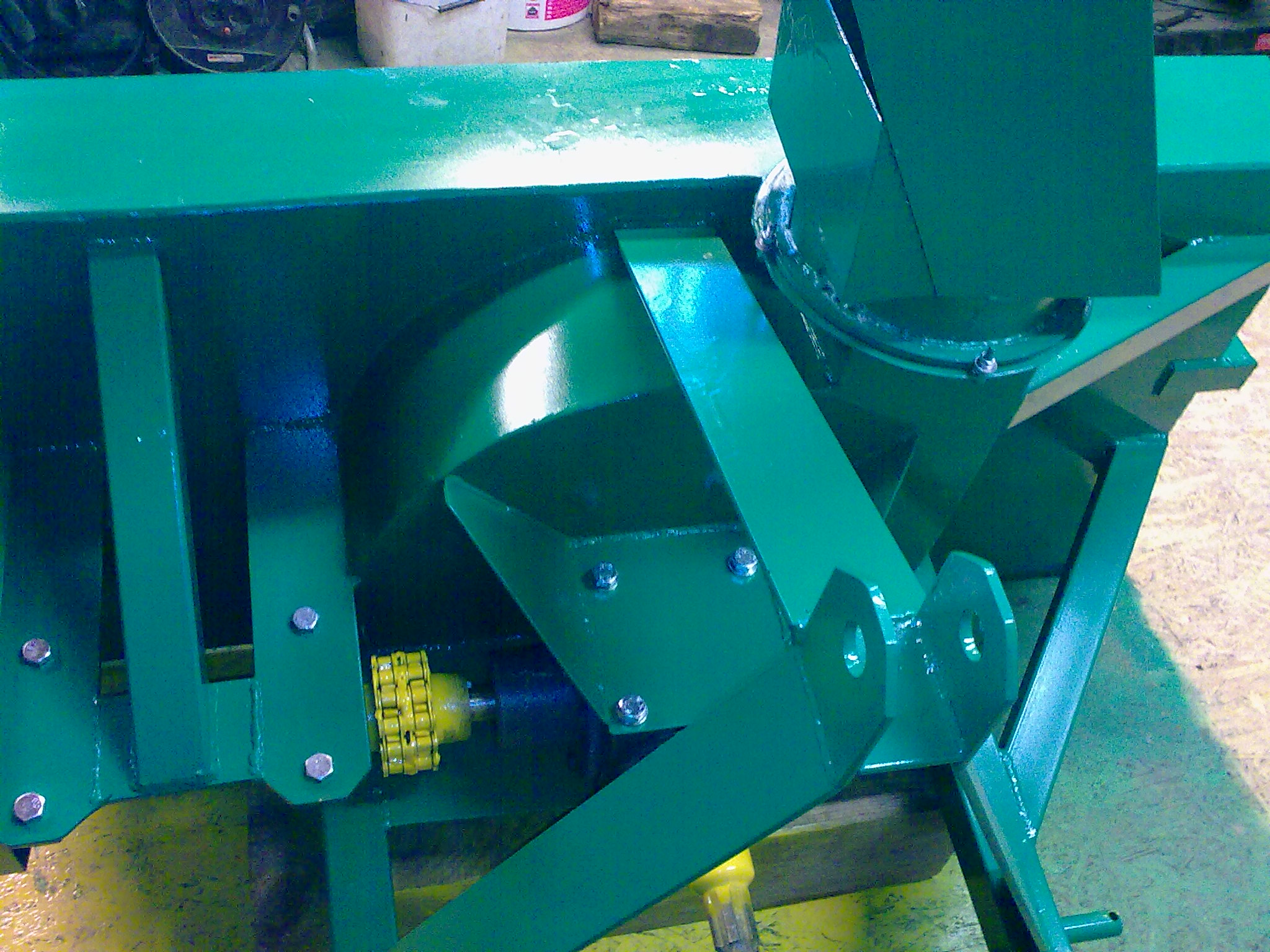

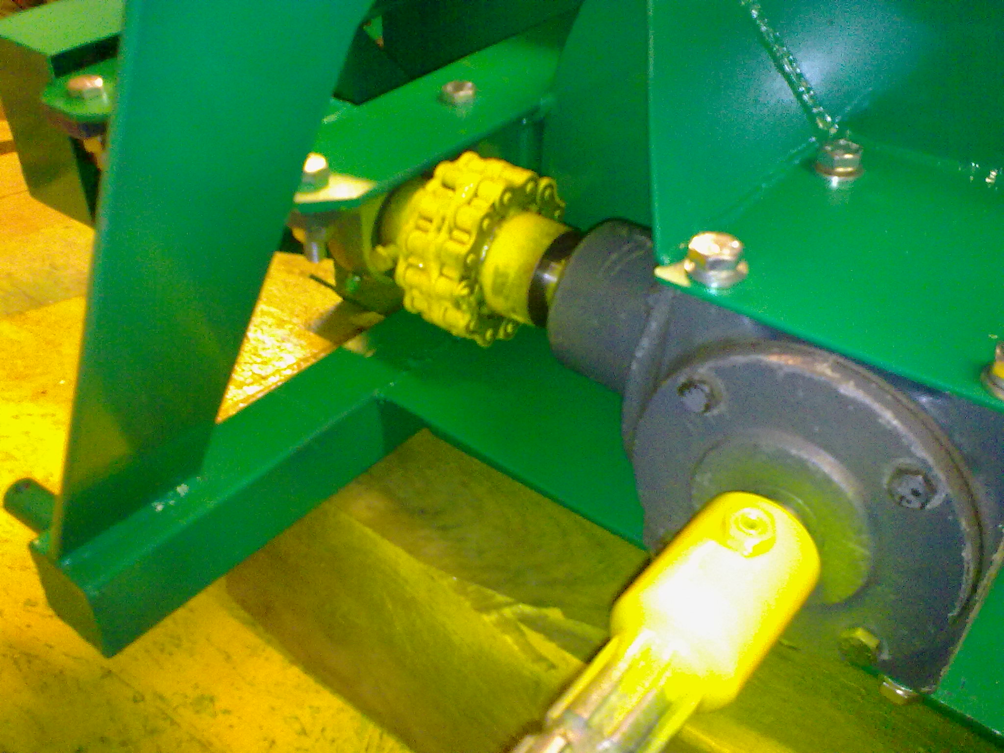

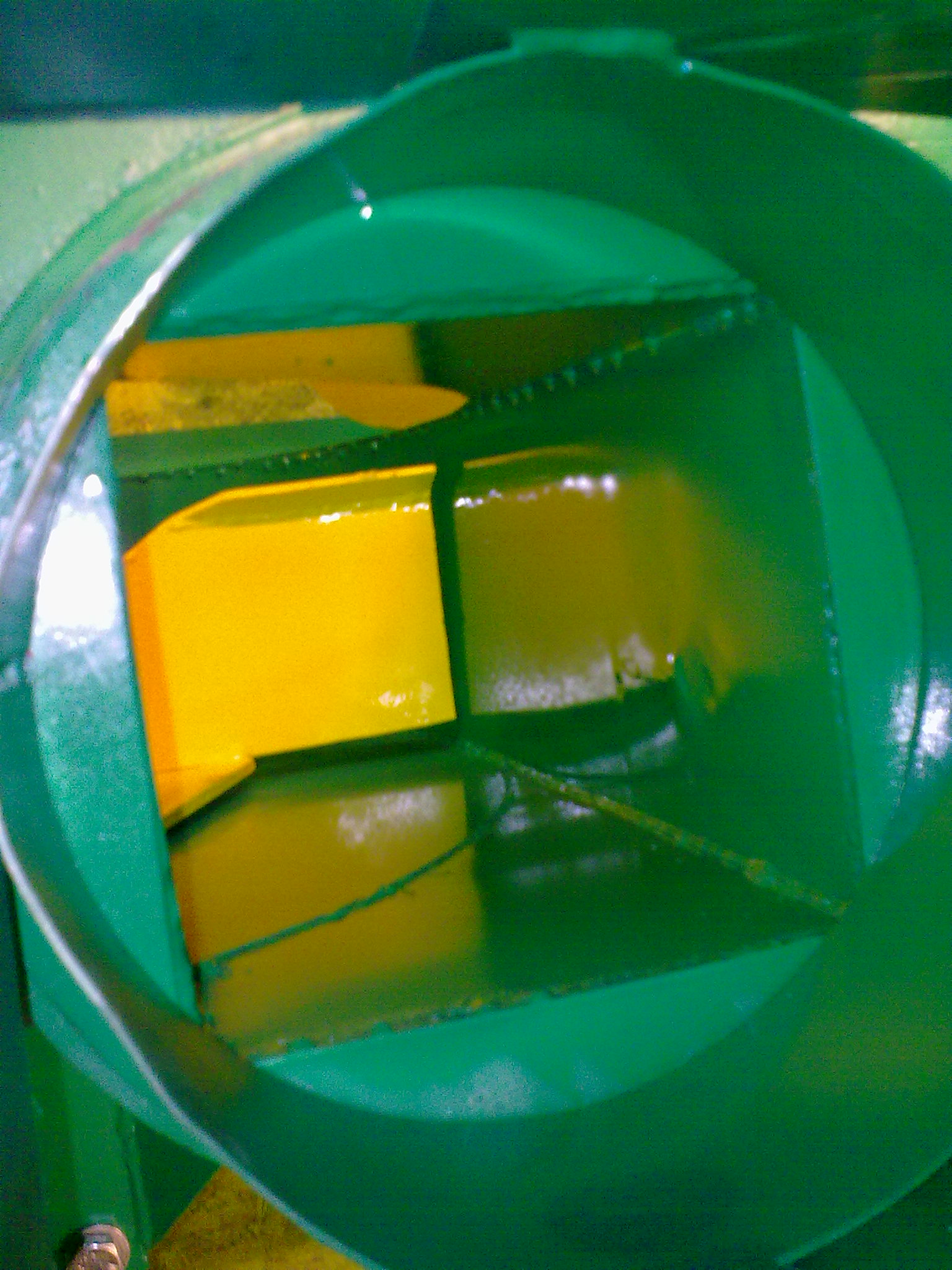

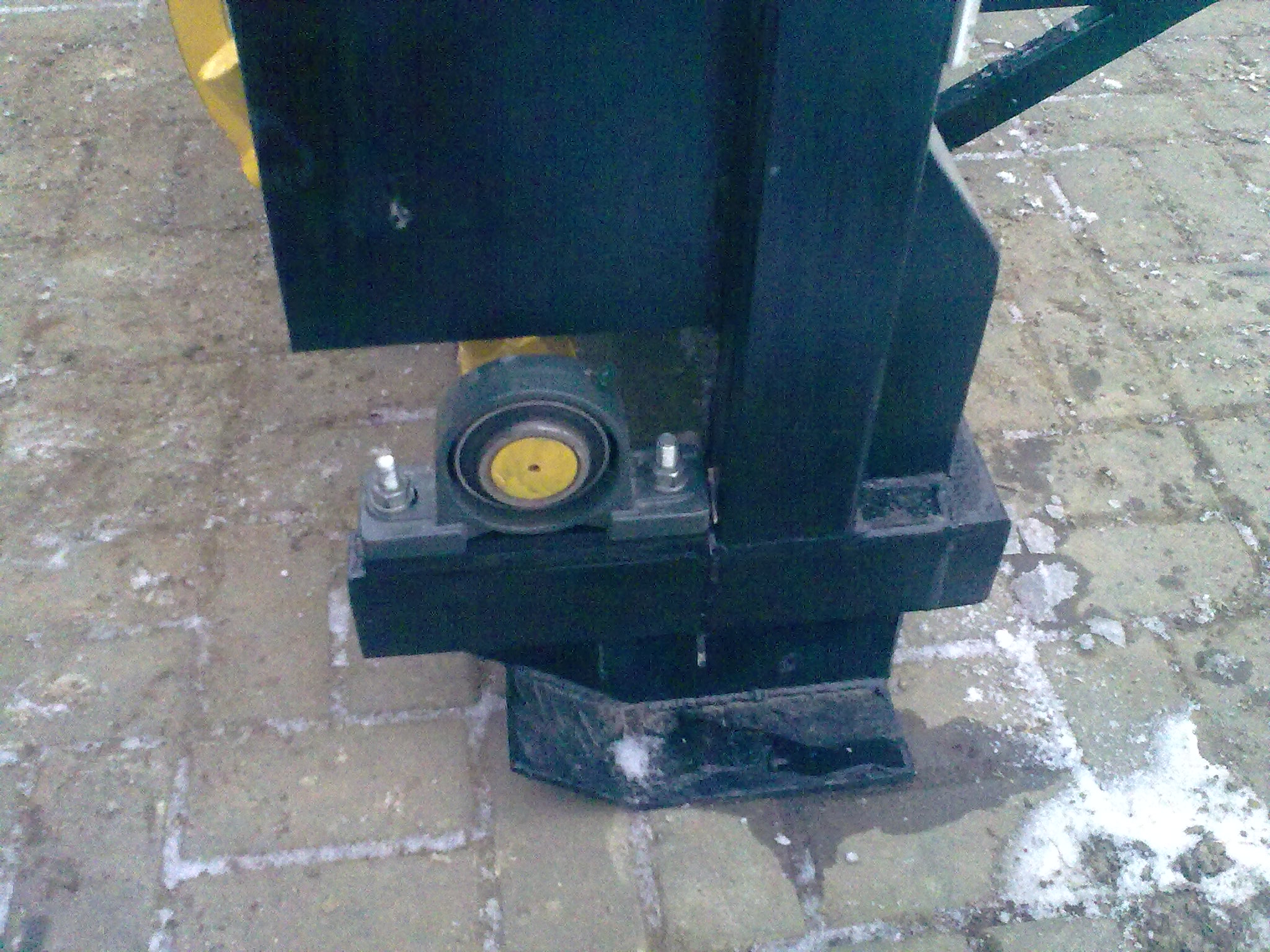

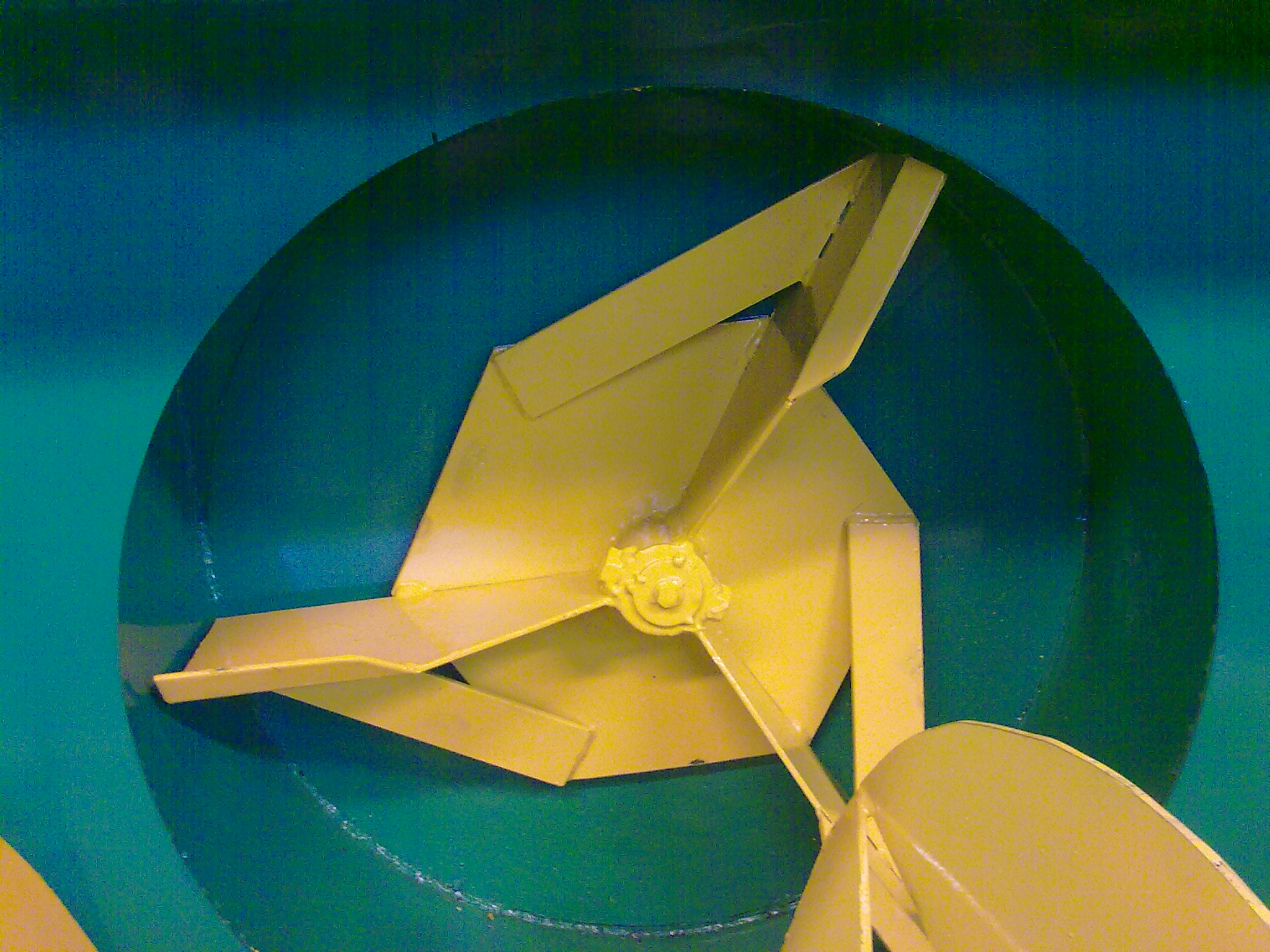

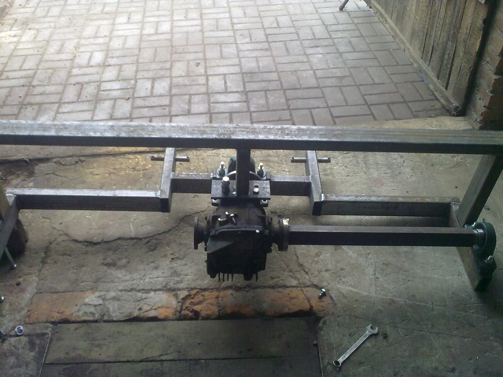

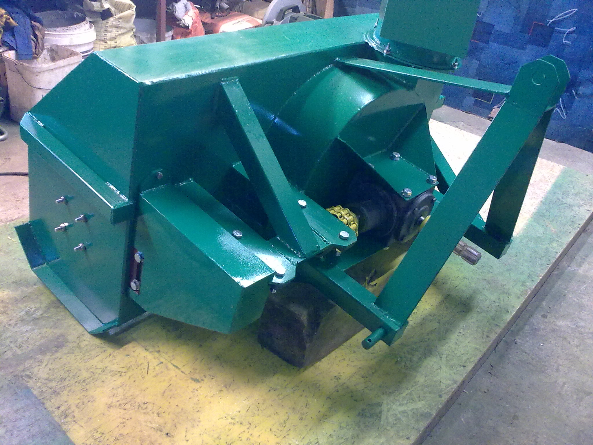

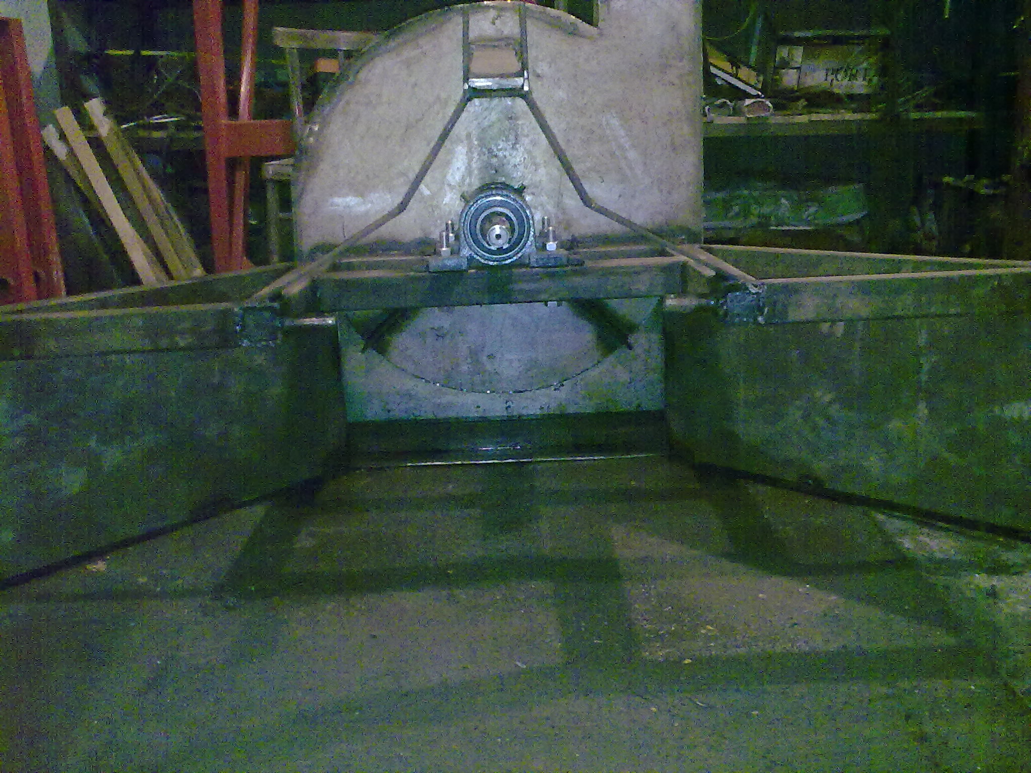

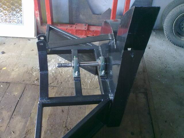

At the end of 2011 have done already quite advanced model ws5035-120
w -rotor
s -screw
50 rotor diameter
35 screw diameter
120 cm = 47" width

   / My new and old projects snow blowers for Japanese tractors #6
You do some good fabricating work there, my friend! :thumbsup:
   / My new and old projects snow blowers for Japanese tractors #7
VERY cool!!
I especially like the use of the spotter in the cab on one of the videos.;)
The first design you show looks like a very simple inexpensive concept for light snow.
I bet if you could start producing and selling them for a low reasonable price your phone would be ringing off the hook.
If you want i'm willing to field trial an 8' version of your single stage model for free.:D

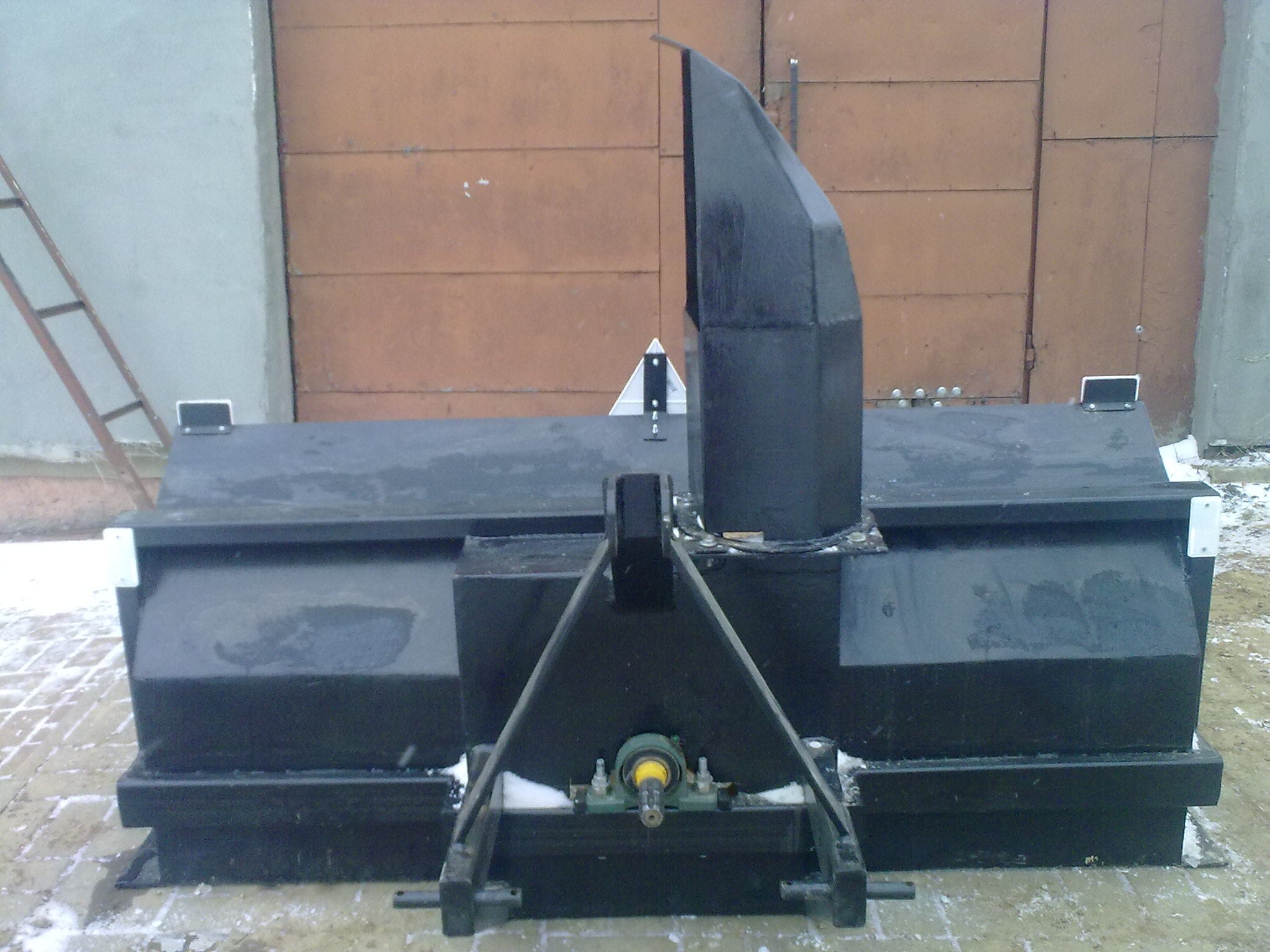

#9
Winter 2011/2012 does not spoil here in Poland in the snow, is it very little.
I have yet to complete one copy of 140cm = 55
As soon as I manage to sell the green model, welded next 55inch
The plans also have electrical control ejection of 360 "
The cost of building "ws5035-120" was $ 524.43 and sells for $ 757.51 in the currency in usa
   / My new and old projects snow blowers for Japanese tractors #10
I really like your flighting design on the last machine. Each side cut from a single, circular piece of steel. Very simple; very smart! Where in Poland do you live?
