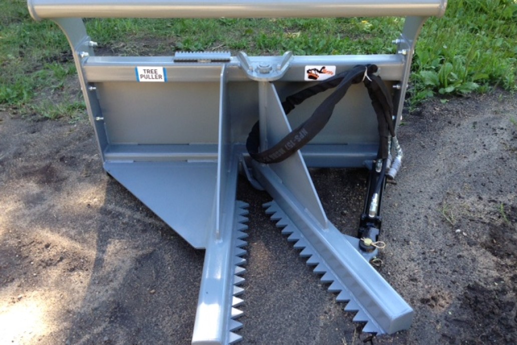

There is a large profit margin in an attachment such as a Puller. That's why there are sooooo many companies making them. In my area there are 3 different small welding shops making/selling them. Competition is good for the consumer in this case. $1250 will buy a very well built, single swinging jaw puller. I used materials I had onhand, so guesstimating, I've got $500 in materials in mine. Another $75 for construction/paint costs. After building the first one and establishing a pattern, it would take longer for the paint to dry than to build one. :)

As for building one, there's very little that is technical about cutting the pieces. The last thing I did was make the toothed jaw plates. I did that by turning the puller upside down, closing the jaws until parallel, then welded a plate of 3/4" to the bottom of my jaws spanning the gap between them. Then using a cutting torch I cut the teeth by a simple S shaped cut between the jaws.
You'll have to source some solid rod and bushing stock to make the swivels. you can buy that stuff already built or buy the pieces and make it. I had the pins and bushings onhand so that's how I did it. I used 2 short pins. If buying materials I'd suggest one long pin and bushing.
The SSQA part is very easy. Once you get started it would make sense to you.

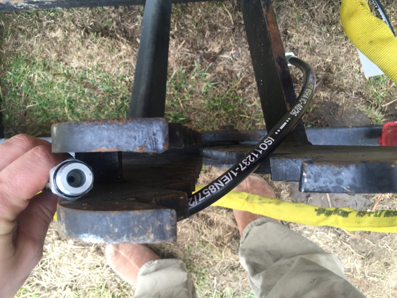

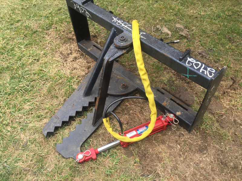

Ok, well I finally got it up and running. I yanked out a small 2" tree (bout 10' tall or so). It worked well. That's all I had time to work with it.
Not sure how well of a fit this will be on this tractor but I will give it a try. I do look forward to making this 3pt compatible though. (I made an make to make adapter for the hose). Just need to Weld up a way for pins.
Anxious to see your tree puller 3-point mount. Sounds like an awesome idea. Yank trees, drop em', pick up with front grapple.
