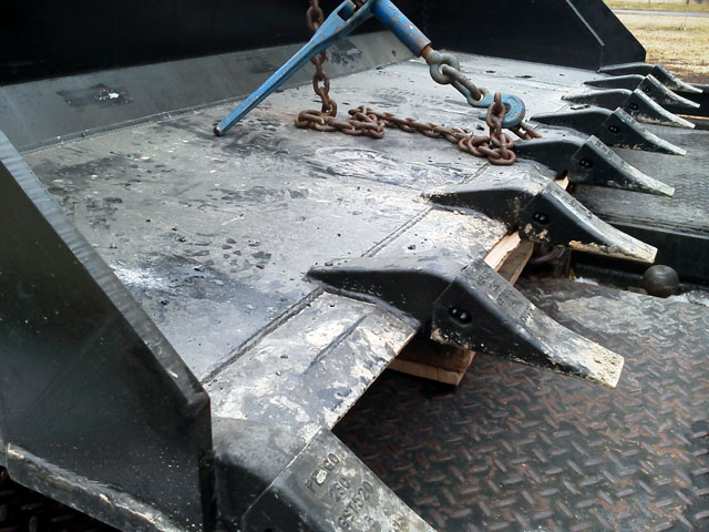

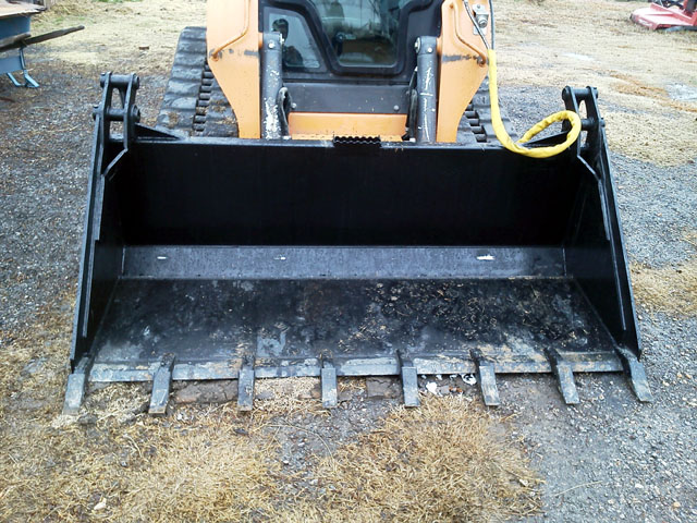

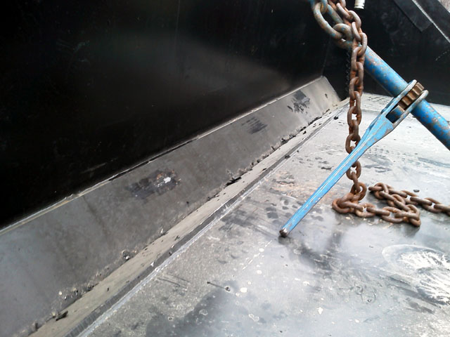

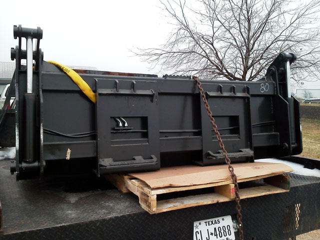

Thought I'd share some pics of the 4in1 bucket I purchased from High Rock Skid Steer Attachments - High Rock Skid Steer Attachments. It's an 80". Of course, at 1025# it's way too much for my tractor, but just right for my T320. It's much beefier than the Bradco or Bobcat versions and a whole bunch less expensive. Shipping was fast too. I'll post action shots on my photo thread soon.

Heavy duty , be hard to bend those side plates . Why the 4 in 1 instead of a grapple ? Just curious .
   / My New 4in1 Bucket Came In!
Kevin - Yep, the side plates are beefy. I like the way the clamshell jaws ride inside the side plates too. To answer your question, I'll have more grading and swale jobs than brushwork and the 4n1 will get used a lot. My employer back in the 70's had them on all of their International track loaders. Real handy. Also, there are only 68" and 72" 4n1's available for rent nearby and I need a minimum of 78". There are a host of grapples around and the width doesn't matter as much.
Here is the bucket attached to the ctl. I need to figure out a setup for the hose run to keep them out of the way of the bucket, tracks and keep them from getting pinched by the cylinders/loading arms. I've seen heavy springs and the welded rod w/circle type, but I'm open to suggestion.
