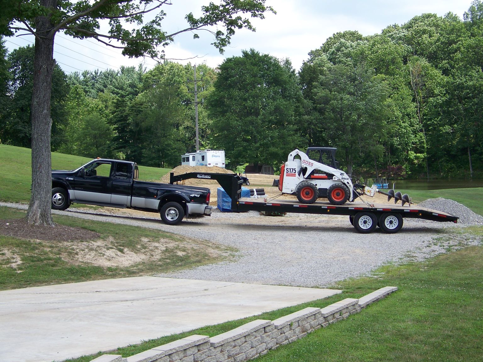

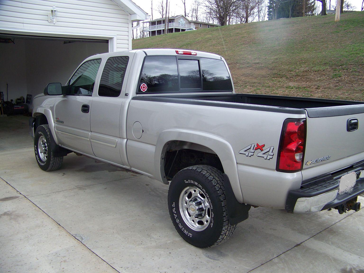

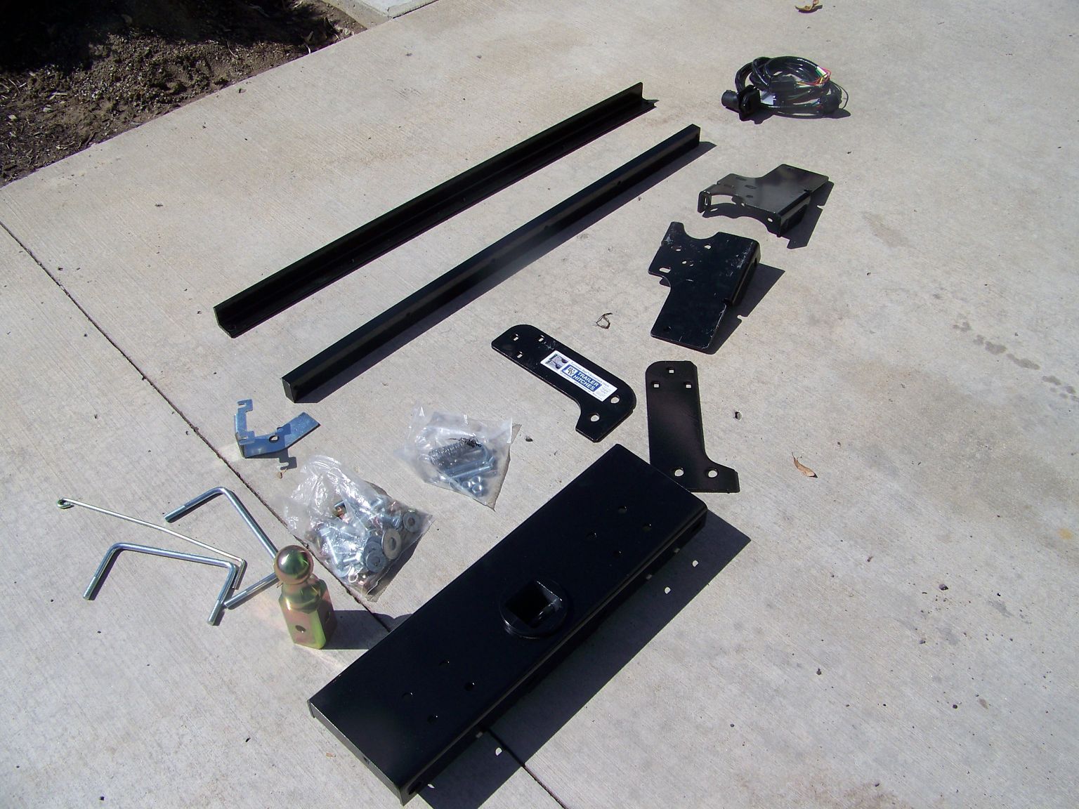

I needed to install a gooseneck hitch in the new truck and I thought I'd share it with you guys. I ended up buying a B&W turnover hitch that was just like the one I had in the Ford....seemed to be good quality and price. I also bought the harness that allowed a plug in the bed for the lights, etc.
Here is the old Ford that is gone...and the new truck.

When the hitch was delivered by FedEx it came primed in a grey color. I decided to go ahead and paint everything black before the install.

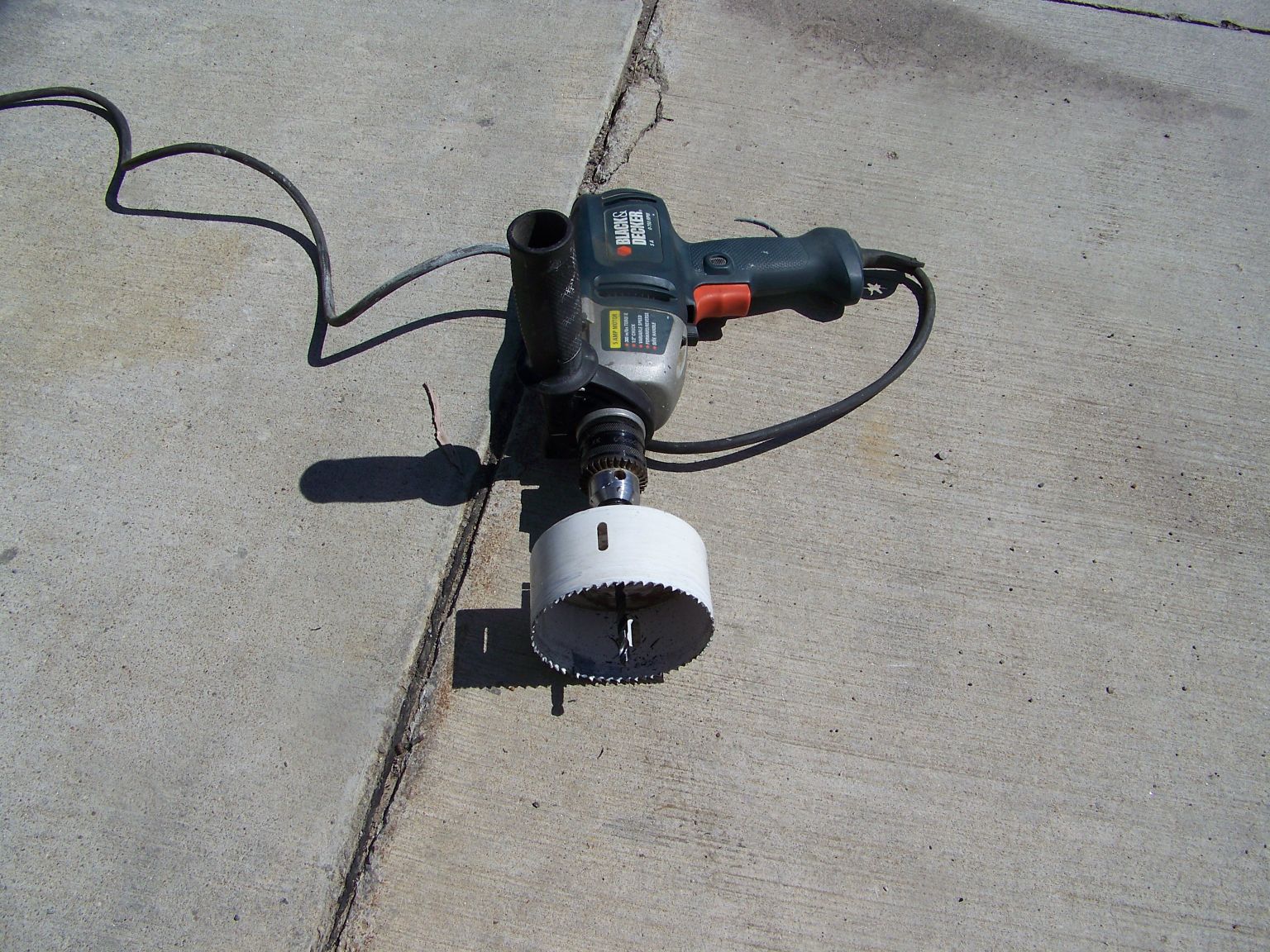

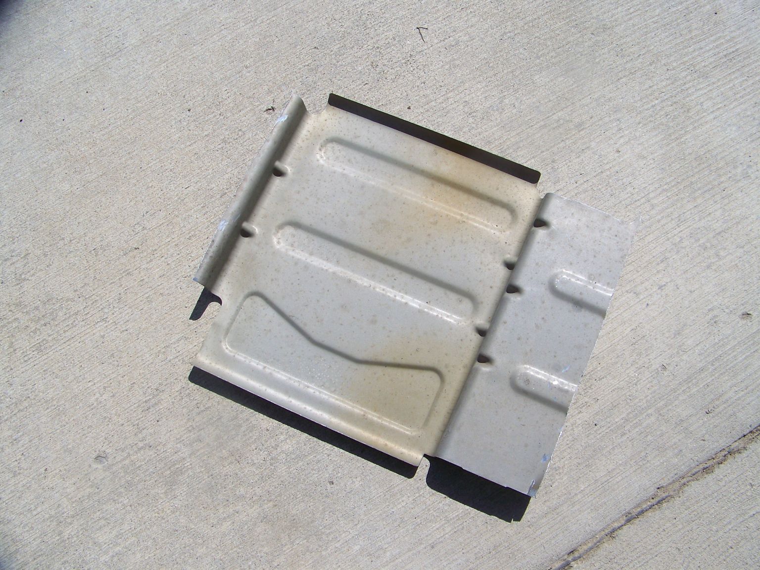

Next was to cut out a portion of the heat shield or remove the whole thing. Since GM decided to use Torx-25 bolts to hold the entire heat shield on, I decided that it would be easier to just cut out the section needed.
Then it was time to drill a 4" hole in the bed. Measure twice, cut once right? I had to allow 1/8" for the thickness of the LineX Bedliner in order to be right.
Nervous? YEP!

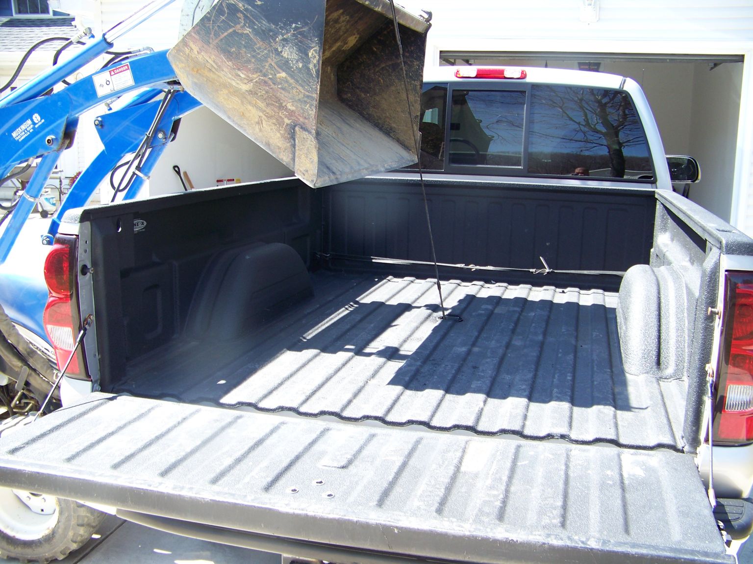

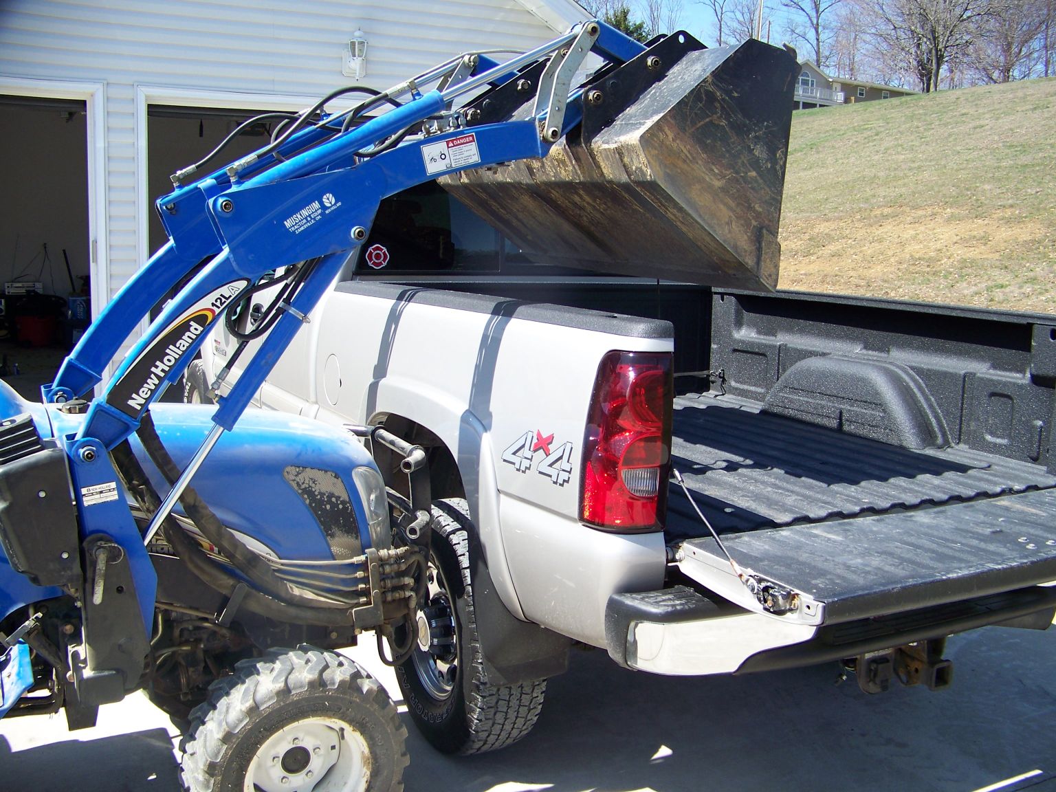

I had to use the TC24DA to hold the center section tight against the bottom of the bed as I tightened the bolts holding it to the the other crossmembers.

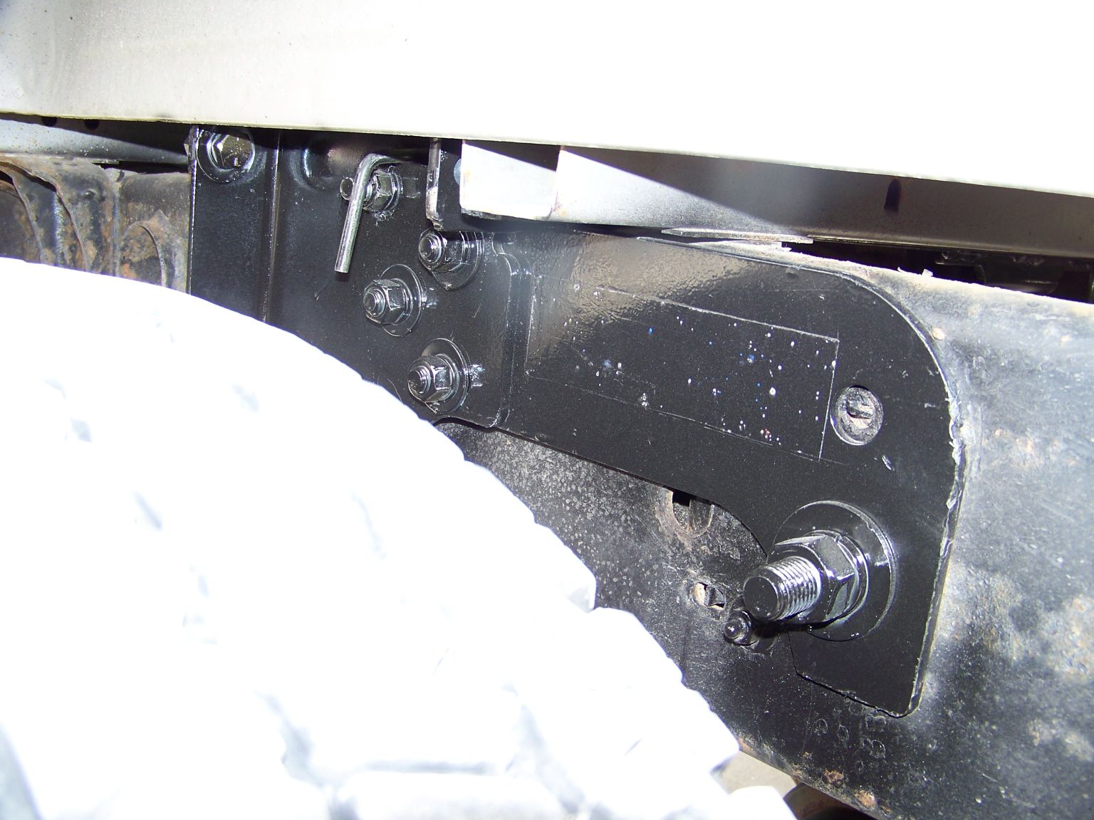

Driver's side sideplate that has the release lever.

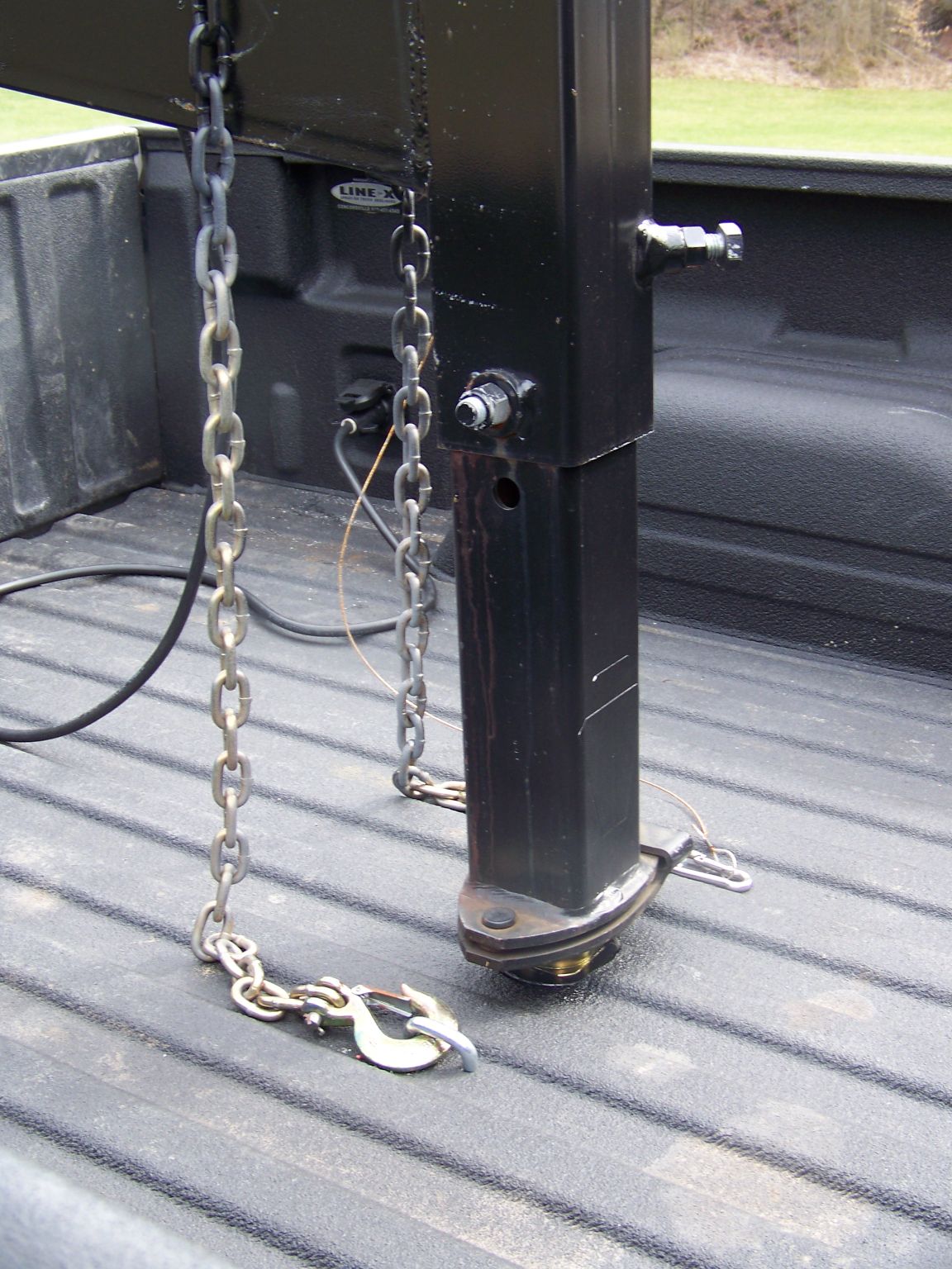

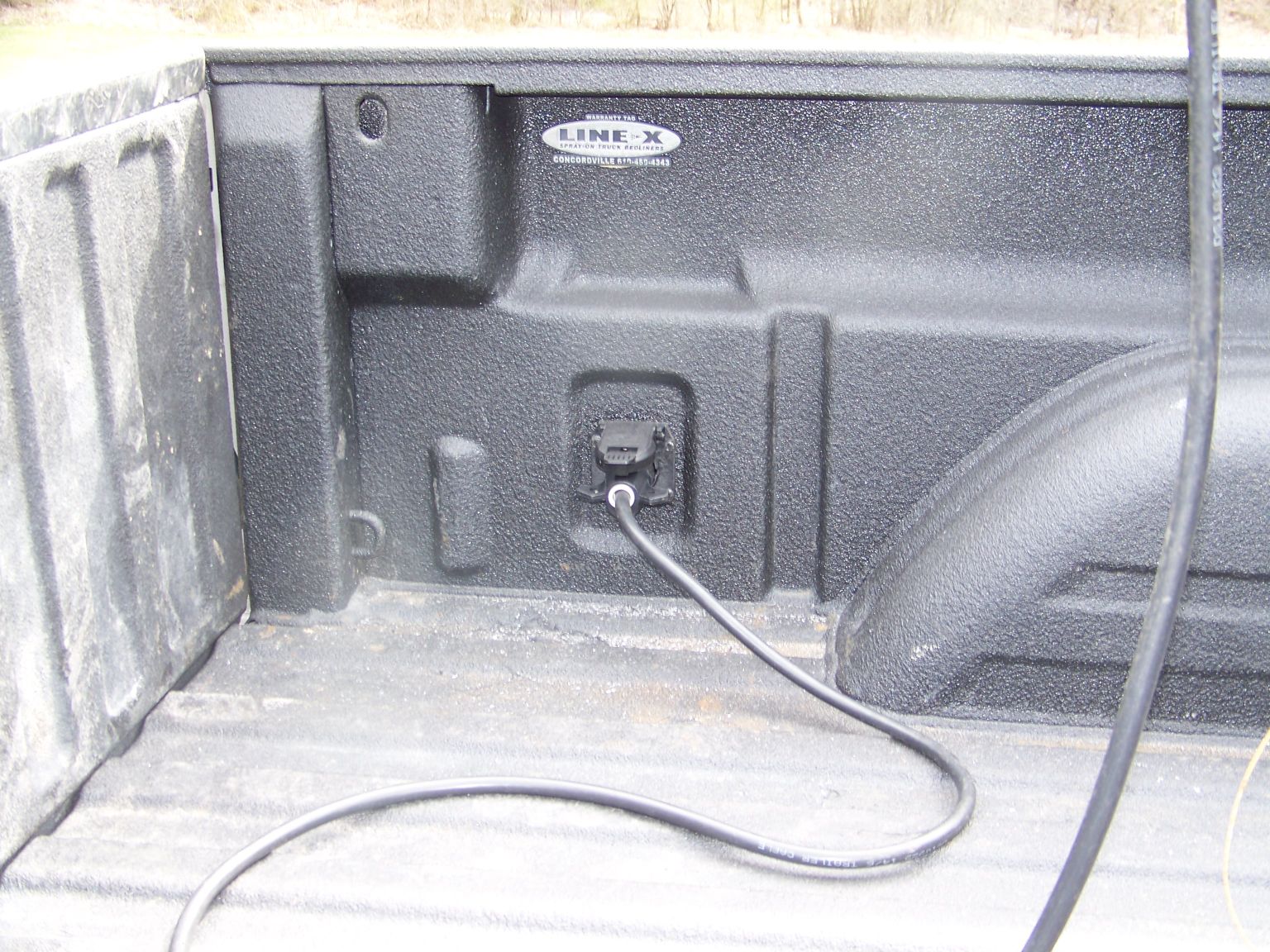

The bed plug installed.
   / My new 2500HD and goosenck hitch install.
All done outside!

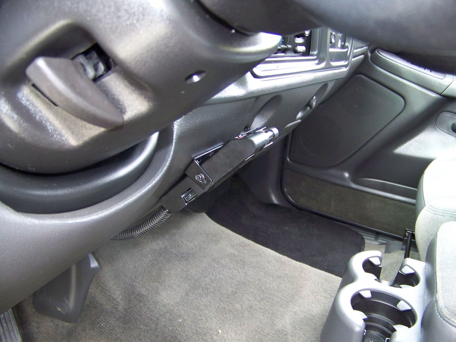

Brake controller installed.
