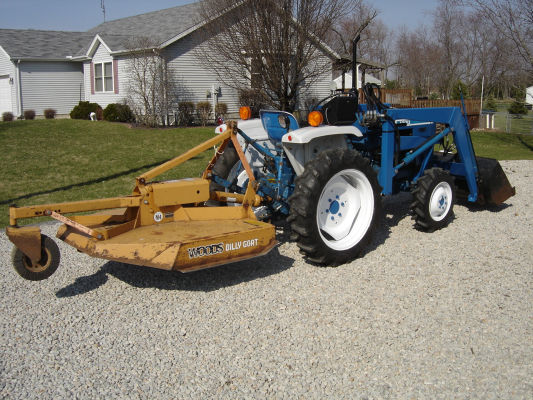

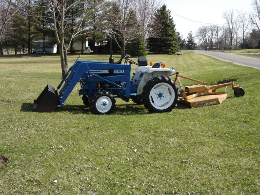

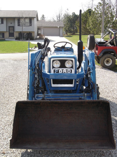

Well, since recently it seems like it is en vogue to post up purchase of more experienced Ford iron... ;-)
I just picked up a 1979 Ford 1300 FWA diesel. Tractor appears to be in very good shape, and is showing only 291 hours on it. Everything works as it should, and the little 2 cyl starts and runs like a top every time. It does seem a little noisy on startup, but from what I have found online, this appears to be a normal thing?
Anyways... It came with the factory 770 loader, a 48" Ford finish mower, and the 48" woods brush mower. I want to start building some attachments for it like a guide wheeled rear blade for light snow removal, a small grader box similar to the one in the thread Ron's Grader, and possibly adapt a quick attach to the loader arms so that I can remove the bucket to allow me to store it in my shed quickly and easily. If I get around to the QA, I want to also adapt a set of forks for unloading my pickup truck. I'm also thinking of ideas on how to add a folding ROPS to it. If anyone has some pics of a factory installation, I'd like to see how they attached the unit to the tractor.
A couple things I have noticed already:
Given the ability to find the components, how difficult is it to convert this little beast to power assist steering? any thoughts on potential sources (used/salvage I am assuming) and cost?
Secondly, the 8.3-24 and 4-12 tires are great for traction, but are going to play **** with my yard. What are the options for finding tires and wheels that will maintain my front to rear gearing for the FWA, and be wider and a little less aggressive? Anyone know off the top of their head the bolt patterns for the wheels/axles? I am also hesitant to go crazy changing, as I am concerned about potential axle stresses due to additional leverage loads on the axle assemblies.
Hopefully, my attachment projects will be a source of entertainment for you all, and I'd like to thank JC-Jetro for his informative posts on this tractor series. If it wasn't for his information (and others of you contributing to the posts), I would have probably passed on this unit due to its age. he is like Geico... He saved me a bunch of money on my tractor purchase!!!

Machline looks in great shape. Enjoy. Are you sure with a machine this small you want to go through the trouble and expense of adding power steering assist. How hard does it steer. To change to turf tires I believe you need new rims and tires in a matched set of 4. I'd scour dealers for a used set.

Wow, What a find !!! that's diamond in the rough. It really looks good with a very good compliment of features. The paint looks to be original except the wheels and loader and at 291(Is the engine overhauled?) hrs this thing must have been in hibernation most of it's life, this thing needs to be broken in even yet. I hate the tractors that are beat with all the problems but are dunk in a big vat of Ford blue before they sell it. Congrats...

Thanks Chumly for your pictures. I picked up a 1300 and it is in much rougher shape, but from your pics I could tell that my tractor is complete. It just needs to be dipped in vats of blue and white paint. cheers!
