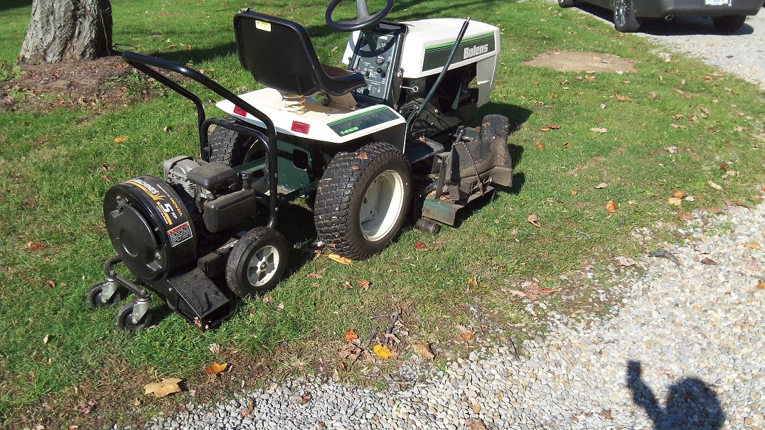

I was tired of pushing this heavy blower thru the yard, so I hooked it up to the back of the Bolens.
It was simple to make and makes life so much easier, when it comes time to get rid of the leaves.
It does swivel so it will follow the contour of the ground and when I hook up my snow blower,I use the mount to hang weights on.

you are a genius! :thumbsup:
   / My leaf blower hooked to the tractor #3
I was planning on putting mine in the FEL bucket this year for the exact same reason. :thumbsup:
   / My leaf blower hooked to the tractor #4
I definitely like your idea :thumbsup::thumbsup:.
I've got a nice 9HP billy goat blower, but I also have a hilly front yard and that thing gets heavy. I will be looking at mine tomorrow to see if I can couple mine to my lawn tractor. I do have the adjustable height blower chute so I'll have to work that out, it's spring loaded and will stay up if you don't hold it where you want it to blow.
