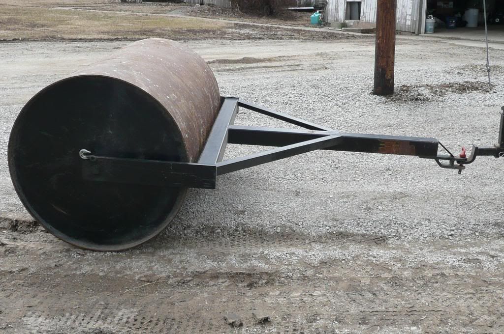

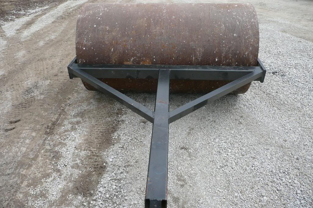

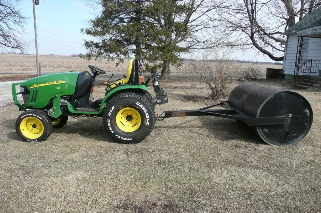

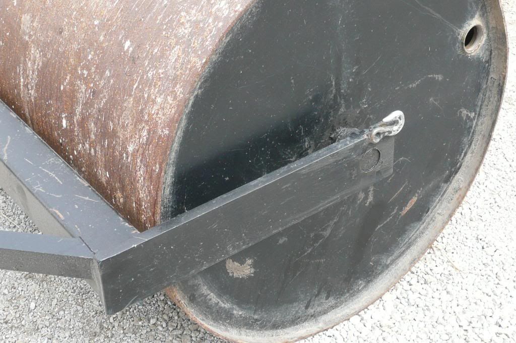

Time to post some pictures of my lawn roller. I am starting to roll yards within the next couple days. My roller started out as a 500 gal. propane tank, used and put out of commision. A local welding shop built it for me. The valves were on the ends, and the ends were cut off to make the drum 66" wide. I fill it with water and total weight is 3500 lbs. The tounge is 4" tube and is around 4' long. Cross supports are angle iron. I have $700 invested and paid for itself in 2 years of use.
Compared to a 48" Agri Fab

I mow lawns all summer and have been doing so for 12 years now. I roll most all the yards I mow and roll a few others. The reason is to smooth the yards out after the freeze/thaw of the winter/spring. Does it compact the soil, yes it does. Of all the yards I mow, only 2 have weed killers applied through out the year. I have never noticed a difference in rolled/unrolled yards as far as quality of grass. As far as weeds, there is a difference only because of being sprayed.
Does anyone need a roller this heavy, probley not, When I was using the 4' roller I drove slow to do a good job, with this bigger roller I can travel 3 times as fast and do a better job. I cover 100-120 acres of yards in the spring, and only a month to do it.
