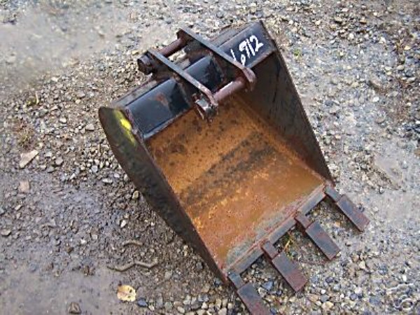

Good Day fellow tbn’ers,
Here is my latest ebay purchase. It’s an 18” Kubota backhoe bucket, which I got for $109. I don’t think it has seen any ground whatsoever, but it has seen water as seen by the photo. Whoever had this, stored it with the open side up and when it rained, it became a water bucket :mad: . After winning the auction, I knew I would have some remodeling to do. I had to cut off the existing ears and make new ones to accommodate my Woods backhoe.
Bill

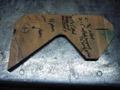

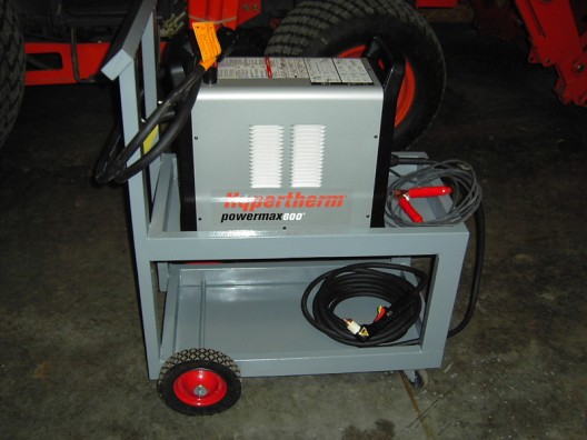

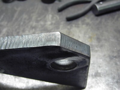

I traced a pattern from my 12” Woods Gannon bucket and made a template out of plywood. I then got some ½” steel plate and cut out 2 new bucket ears with my plasma cutter and drilled two 1” hole to accommodate the pins. Boy, what a difference a plasma cutter makes. Just look at the quality of the cut, amazing!!!
Bill

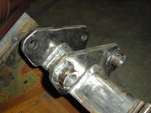

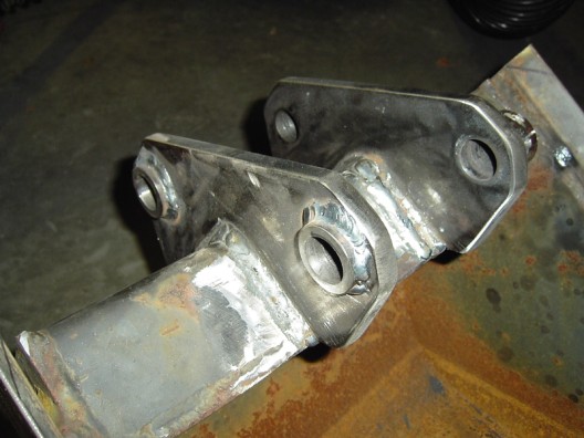

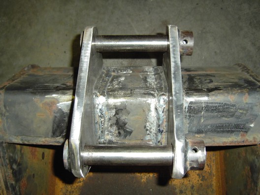

I tacked the new ears in place making sure I had the correct dimension between the ears. I inserted some 1” stock to line up the pin holes, then I cranked up the Millermatic 251 mig and securely welded the ears in place.
Bill

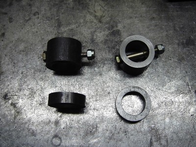

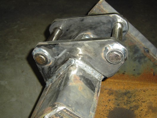

I made new collars for the pins and welded these in place. I also used a sanding disc and smoothed out the plasma cuts. Tomorrow I'll make 2 new pins and post more pics.
Bill
