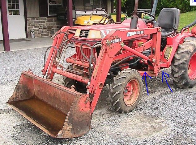

Interesting thread. Looking at the youtube I can see the machine flexing in the middle with just the weight of the FEL. Add weight to the front and ballast to the back would put some serious flex on the bell housing. This setup NEEDS a subframe from front to back so this does not happen again. IMO, most of this damage is from not having a subframe and still being used with cracks making the thing flex constantly. The flex puts huge stresses on the clutch which could be where that damage came from. My little B6100 has a 1/4" by 2" subframe linking the loader frame to the rear axle. I think there's pictures on here somewhere of it. I also attached a picture of another B1750 I found via Google, I added arrows to point to the subframe I'm talking about. Mine is setup similarly, if you want photos of mine I can get them for you. Good luck with this project.
That is a great idea, and something I will plan for this tractor. Not sure if I'll take it into the dealer, or somebody else to do that install. I went to your pics and had a hard time seeing how it connected. Thanks for the excellent advice.

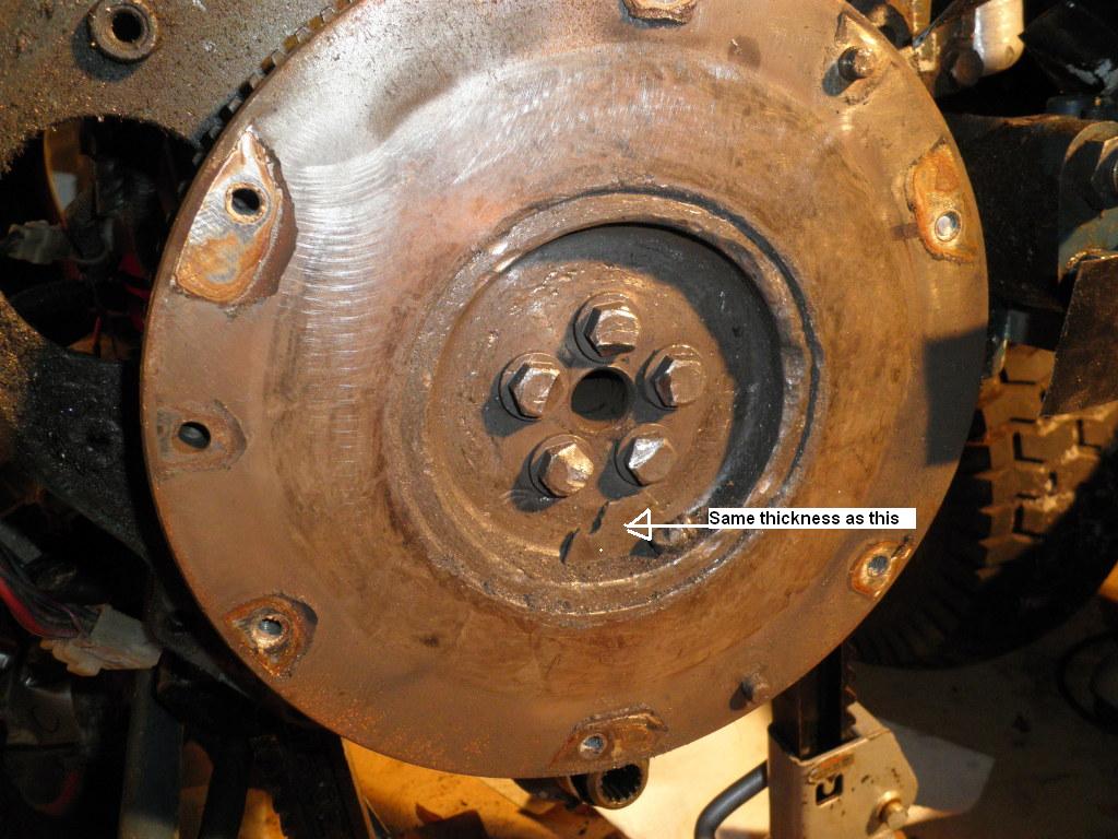

I do have another little problem also...
In my factory kubota service manual it speaks of a metal shim or gasket, in the shape of a circle, that the 5 flywheel bolts go through when bolting on the flywheel.
It had been a month or so since I had pulled the flywheel, and I didnt remember removing such a thing.
I know for a fact that this shim/gasket didnt go on the outside of the flywheel, as I had pictures from pulling it off.
so that would mean that it would have to be on the inside, between the crank and the flywheel.
So, after searching the garage and coming up empty, I went to the dealer to order it up.
The dealer couldnt find it anywhere in the schematics on the computer. I looked over his shoulder and sure enough there isnt anything there on the parts breakdown?
Does anyone have any first hand knowledge about this ?
Should I just bolt the flywheel up and call it a day?
I'll take a picture of the service manual instructions and post them up...in about an hour or two

okay, so the flex plate is on...
and then the flywheel went on without a hitch...blue loctite on the bolts
but then I checked the manual to see if I missed anything AFTER I installed everything :drunkie:
as you can see they mention some sort of flywheel washer, and it would seem to indicate it is steel.
but again, went to the dealer, and they showed nothing of the sort on their schematic's.

From the Pic of the fly wheel there has been a washer and this is commom on desiel.
From the damage to the flywheel it may be damaged previously.
From the damage to the flywheel ir mat be damaged previously.
this is what i found when I split the tractor.
there isnt a washer there?
Do you mean on the INSIDE of the flywheel? Between the flywheel and crank?
/ my kubota rebuild #20
Question Who is saying the tractor has not been apart previously?
The shim washer goes under the bolt heads and against the fly wheel.
On viewing that there may not have been one and your manual may be for a earlier or latter engine.
Leaving it out is not likely to cause any ongoing problems or you may have to look at a wrecker to get one.
From that Picture the bolts don't seam loose but the engine was run for some time after the clutch had flown apart.
