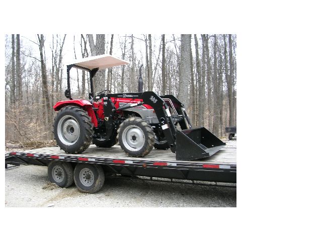

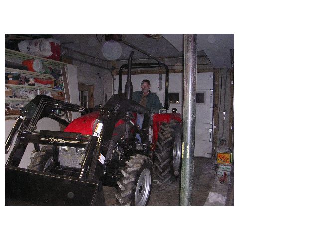

While she was still at idle, my wife was the first on!
   / My KAMA 454 has arrived!
In her heated garage

Congratulations Patrick. She's gonna treat you well!
Did you have to remove the canopy to get it to fit in your garage? Mine fits in with with less than an inch to spare (canopy on). Looks like they made some color modifications on the hood .. is the lower half silver? Two modifications I made on mine right away (might be of interest to you) The hood could not open on mine with the loader lowered. I know the day will come that I have to get under the hood to get it started and did not want to be stuck. I notched the plate that protects the hydraulic lines so that it cleared the hood. It still covers the lines (I bent one a little to get more clearance) and the hood will open with the loader down. Also I changed the exhaust to below the tractor discarging to the rear. I bought a new muffler and welded black iron pipe with a 1 1/2" circulator flange for the manifold. I did not want to canibilize the OEM mufffler. Its much quieter with the exhaust below me now. Good Luck! Scozz

Good lookin' rig Paddy, do the front fenders have to be removed to use a FEL? Good luck!!!!

Scoz,
I have an eight foot Garage door as well. When I tilted the folding Rops, the top actully made it taller. It was snowing a bit so I just removed the 4 bolts and removed it. I hope I can get her in and out with out having to a) fold or b) remove the top permatly.
This week I will see if I can drill new holes in the fiberglass top so it can be mounted at it lowest location.
Chip did say the 2005s have a silver instaead of black hood detail.
I like the exhuast up if it was not for the low trees on my property. I'd hate to break the exhuast manafold.
Good idea on the modification to get hood open. I agree the most important time to get the dang hood open is when she won't start.
I plan on a few mods myself. I will greese the electrical connections and then cover with some sort of shrink noodle. Also will get a can of pait and hit a few of those parts I see that will be the first to rust.
She started good the first time. No need for Compression release or 'flame heater'
Soon I will be mounting my Ford 758 BH. I bought it used and will need to modify it for the KAMA. The BH has framing for the top link of the 3PH and the draw bar for the lower arms of the 3PH. Then a subframe that on the Ford went back to the fender bolts on the rear axel. The KAMA/Koyker has a vertical plate where the FEL ties back to the Rear axel, at the fender bolts. So I will try to configure mounting the subframe there. I want to insure a strong attachment but at the same time I need the BH to 'Come and Go as I please'
I glad to be apart of the KAMA family, what a nice tractor.
Patrick
