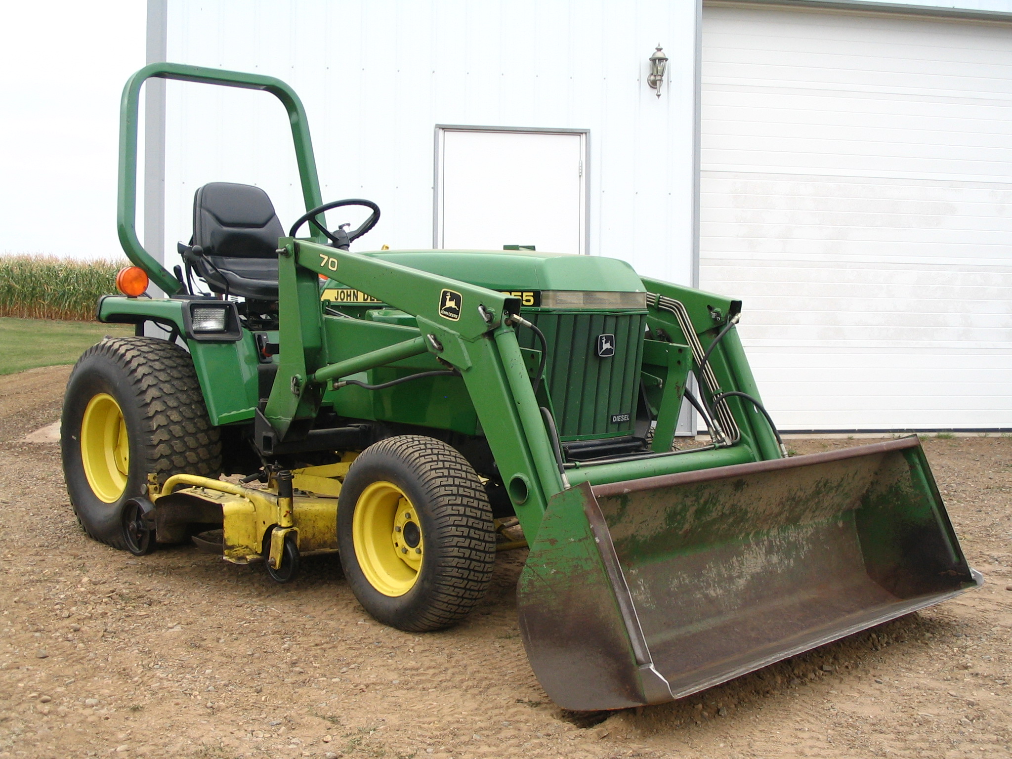

Wow that's quite a story. I recently test drove this 855 going for $9500.00 that was a 2 owner with 1300 hrs. That's a 60" bucket and it had a 60" JD back blade. At the time I thought it was too much but now after pricing other 855's, it may have been a good deal for my area.
