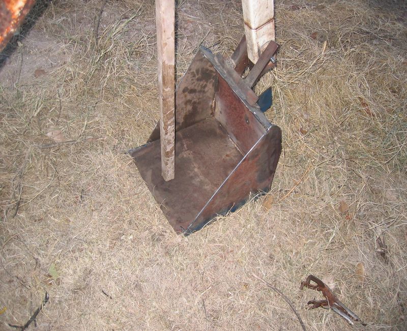

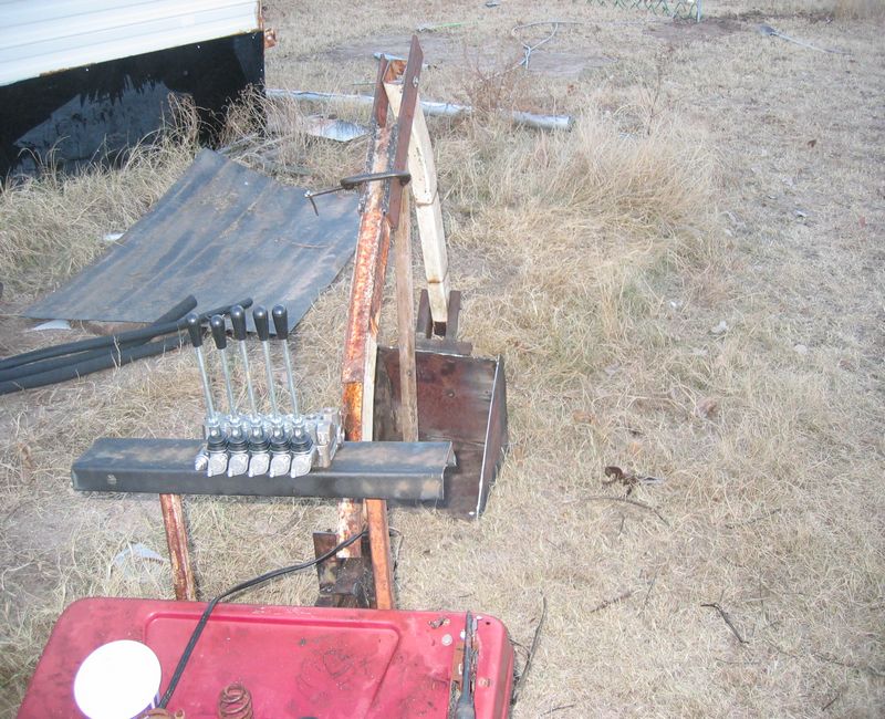

Just a short update on the backhoe. Awhile back we got a few good warm days so I did some welding on the boom bracket that the cylinder attaches to. The bracket I made came off an old exercise machine.
I drilled out the holes with the drill press and a metal hole saw. I held the brackets in place by hand and welded away. Almost caught my gloves on fire. Though I did manage to catch the dry grass on fire beneath me. I quickly put it out.
In the picture where the stick attaches to the cylinder. That pivot point is just temporary. I'm gonna have to use another piece of tube for the stick anyway since I noticed later on that it is twisted and just will not work.
I also want to make it dig deeper. Currently it will have a 2 ft dig depth and that won't be enough depth for me.
I did some thinking and figured the way I got the backhoe attached now will just bend the frame of the mower as it will just pull down on the flimsy frame. So what I'm gonna do is build a square like frame for it first and then brace it to the sides on the upper and lower parts of the mower.

A good, solid subframe is definately the way to go.

At first blush I'd be concerned about that ram bending the metal it is attached to like a pretzel, you'll be amazed at how strong they are. I had a homebuilt hoe a few years ago and I actually bent 1 inch solid pins.
