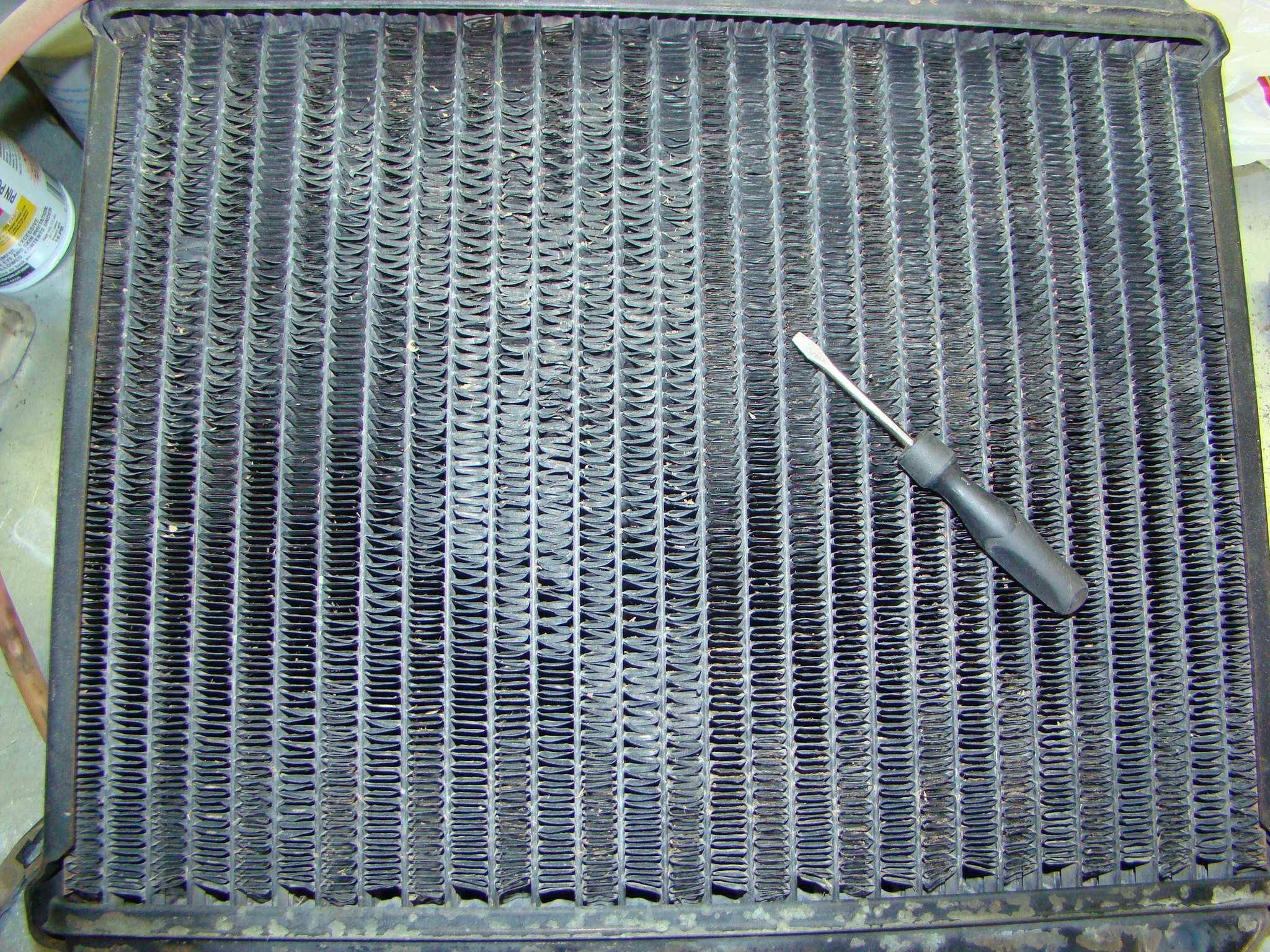

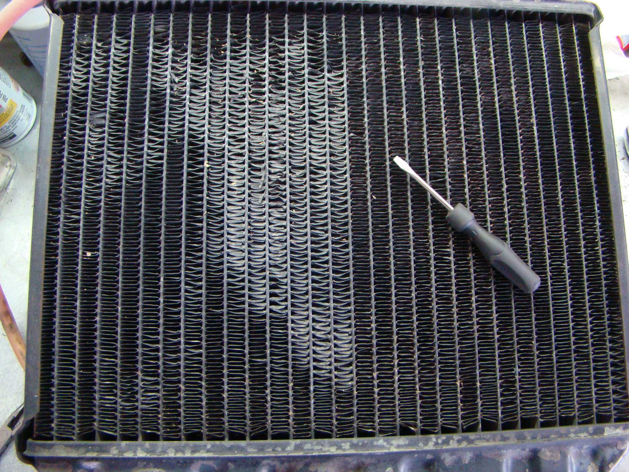

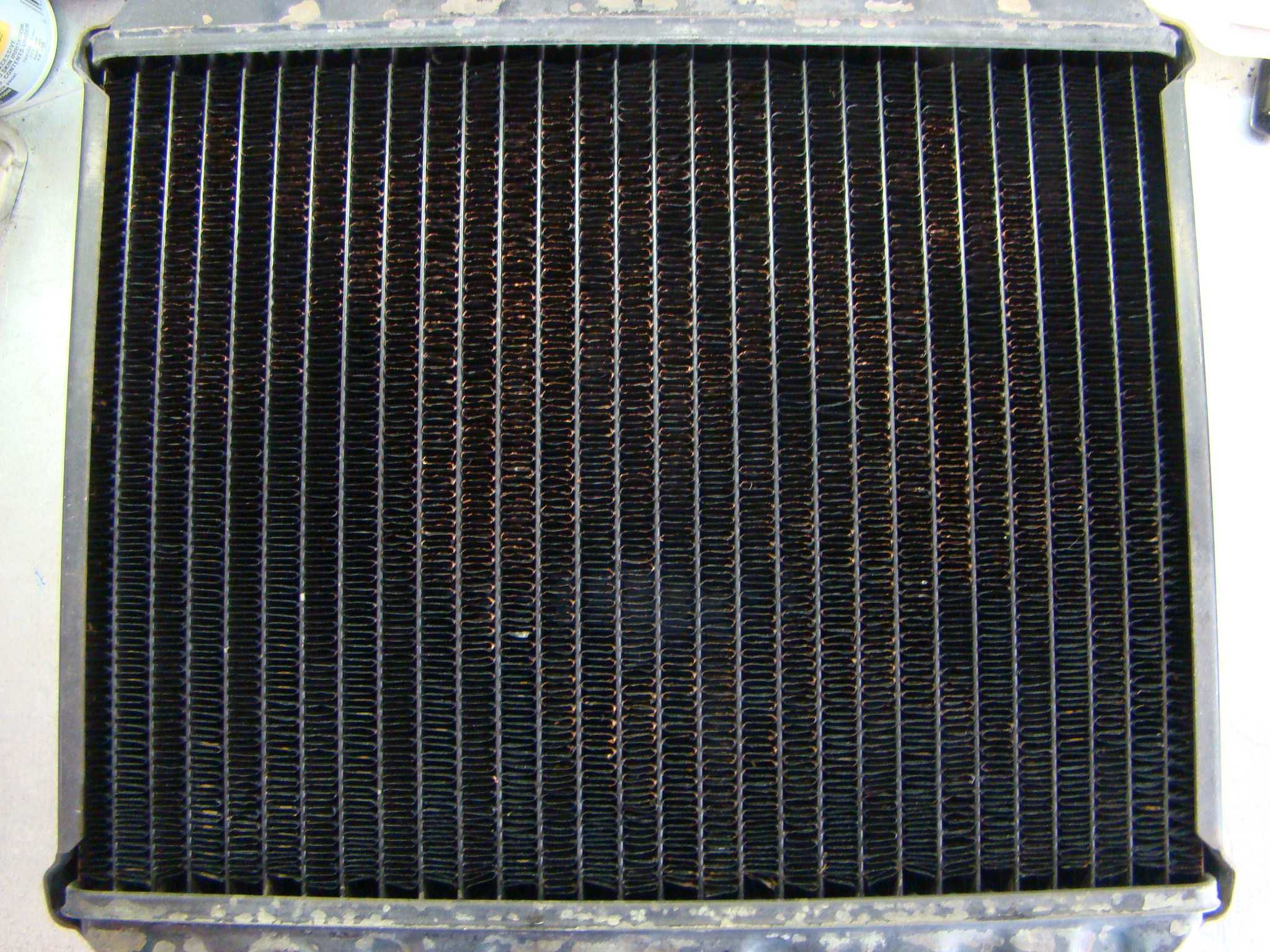

Ditto the above comments. I'd start by removing the radiator - doesn't take that long. Hold it up to a light and see if there is any pluggage. Most of the Mitsubishi engine radiators were plugged, at least partially, that I've had apart. Usually they'll clean right up with a garden hose spraying as long as you can get good access to it (hence the removal recommendation). Also make sure the fins are straight. You can straighten them with a small flat-bladed screwdriver. Takes a while but worth it in my opinion. Here's an example of bent fins and how they can be straightened if you take the time to do it.

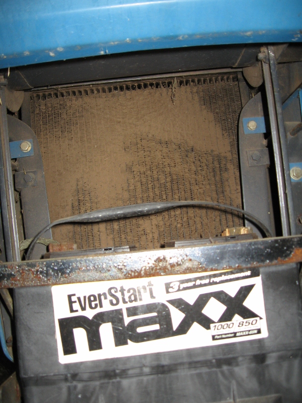

My on my TS1610 was over heating because of dirt in the screen in front of radiator and in the radiator. If there is a screen in front of the radiator don't let it get blocked like in the attached photo.
