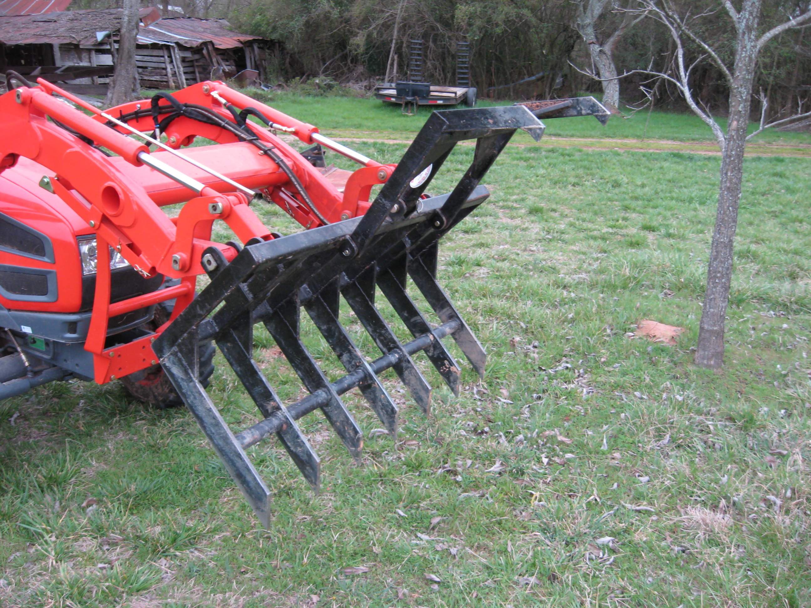

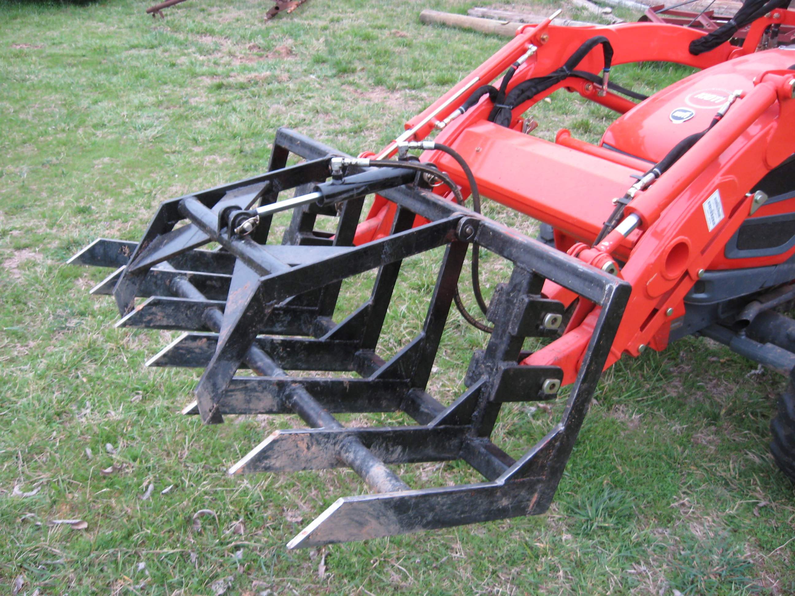

Attached are some pics of the grapple I just finished for my Kioti CK35. After purchasing the tractor in July, I began researching attachments on the web, ran across this site and got inspired. I've done a few other welding projects in the past, and that skill seems to come in handy w/ tractor work.
Thanks for all the great ideas! I hope I can add value to someone else's project.

Looks like you got it all working and dirty already, way to go. It's a pretty beefy grapple looks like to me. Nice reinforcements all around too. I like how you made your fel connections out of separate pieces. One thing I might add is a shield under the exposed cylinder rod in case you clamp on a rock or something that fits between your grapple jaws and those gussets. It could bend your rod if that happened.

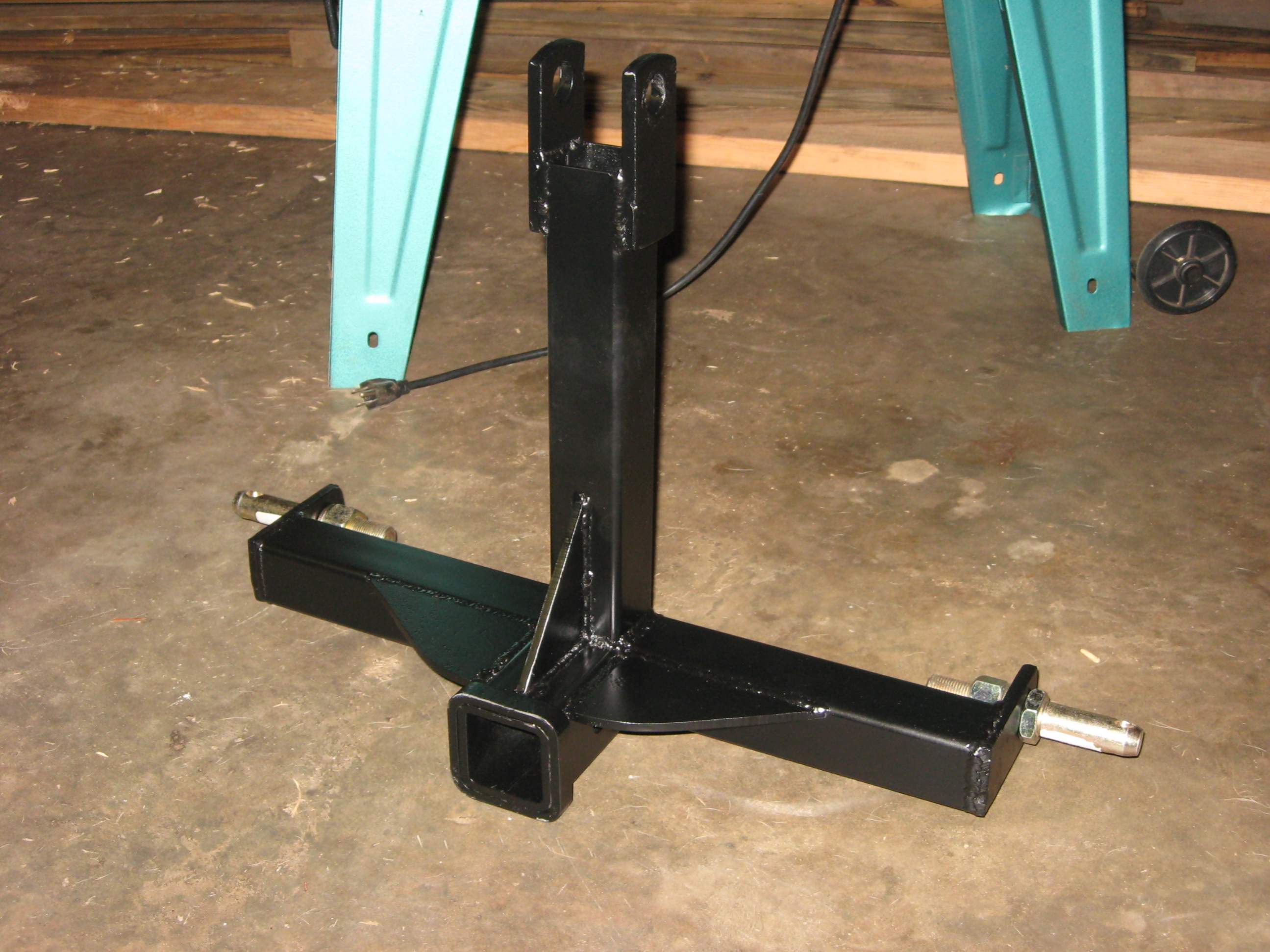

I also built a 3 pt. hitch receiver hitch from some scrap I had laying around this weekend.
This site has too many ideas! I'm spending WAY too much time in the basement now!
I just made a receiver hitch also, very close to yours; did you leave a drain hole at the base of the vertical tube? I welded a grab hook to mine.

Good thought about the shield. I'll have to add that.
I also need to beef up my factory brush guard. I already had to replace a headlight!....I found it's easy to get carried away while working w/ the grapple!
nope...didn't consider the draining 'til you mentioned it....I'll have to drill through the bottom now....thanks a lot!
