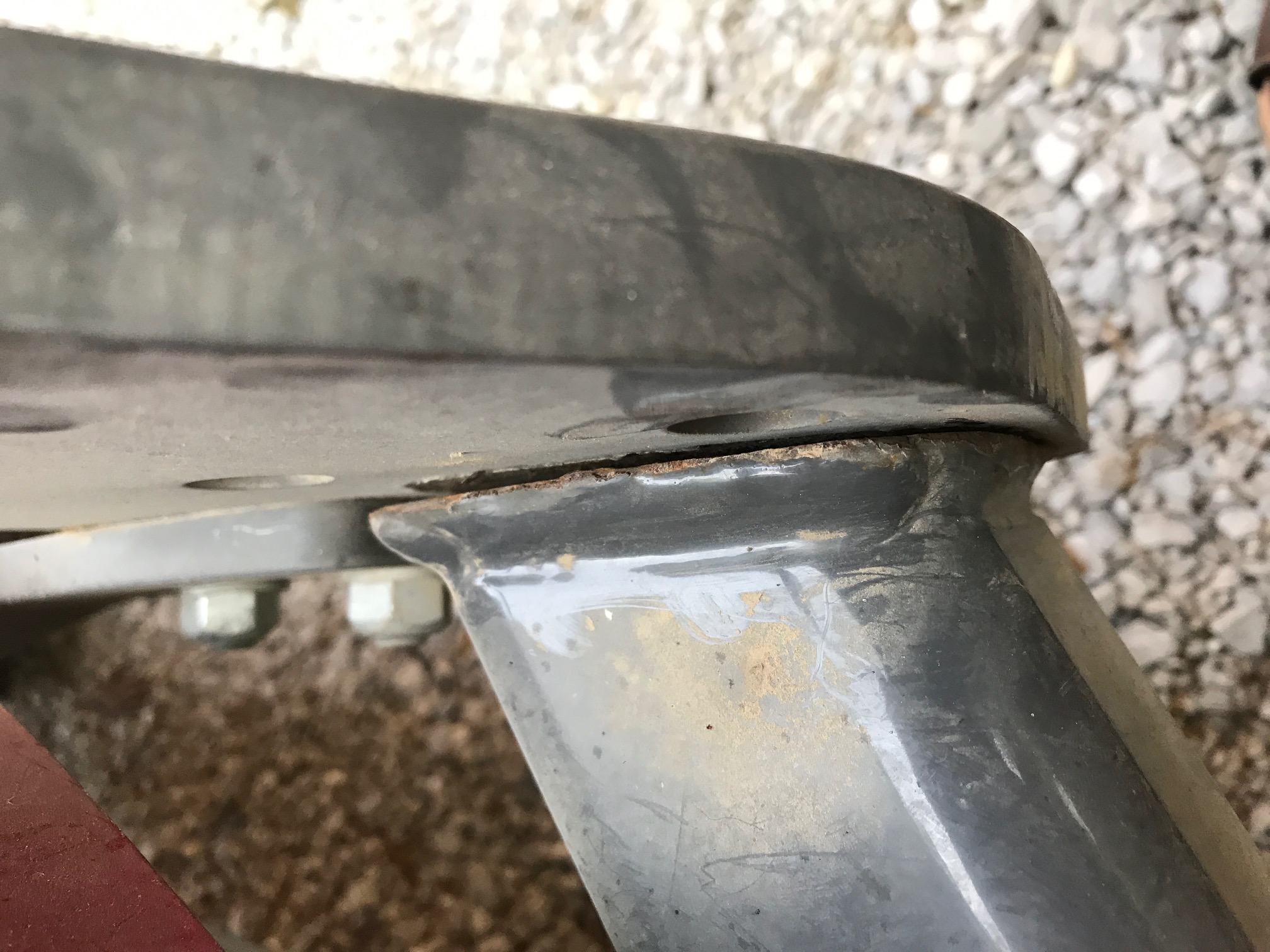

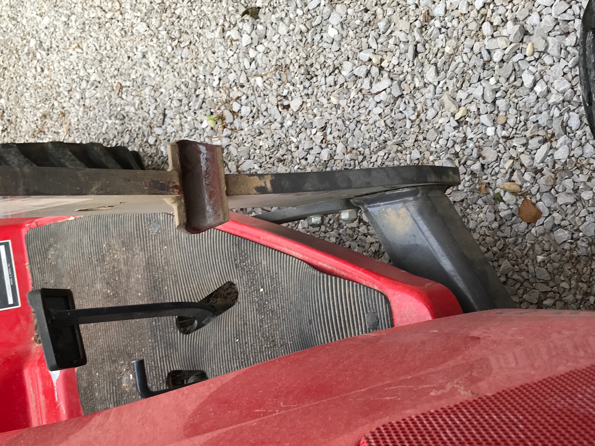

Now the latest major issue. I was using the loader to mover some dirt when I heard a loud POP and the tractor almost tipped over, I had a decent amount of weight in the bucket (but it was NOT overloaded or even close to Max weight) the weld from the LH loader support (the part that mounts to the frame of the tractor) broke and the loader tilted causing the tractor to feel unstable....I dropped the bucket ASAP when it happened and I think that's what saved me.
You can see in the picture that its a faulty Weld, it was really one welded in one small spot, 95% of the weld was never really welded.
I couldn't believe my eyes when I looked at it......WHAT a crappy job! So time to load up and make another 2.5 hours round trip to the dealer........when I got there he agreed and was like what the ****!!!!! that's horrible, said I should have it back in a week, they are also going to replace the throttle cable, order the correct bolt for the three point arm pin as well as service the machine.

3) You and your dealer both know that weld is obviously defective ! I say you deserve a new loader mounting assembly, not a repaired one. I'm betting the regional rep will quickly agree. Notice in your photo that the weld is SUPPOSED to melt equal amounts of steel on each side of the path of the weld -- it melted lots on one side and almost none on the other. A classic case of a manufacturing defect if there ever was one.

I'd demand to have this replaced. Tell them it's a lemon. PERIOD. Don't be hostile with the dealer or factory reps. Just make it a point that this will be dealt with. If you have to park it at the dealer's and hold a sign pointing it out as a lemon then do it, if that's what it takes to motivate folks.
My NX5510 came with issues. My dealer took care of them. Even had the loader replaced: factory welded it up with a skewed jig- loader arms were not straight; didn't affect performance, mostly cosmetic, but it wasn't acceptable.
As JWR states, get the ear of the rep. Unless someone gets the info to the factory there is no way they're going to improve their QA/processes.
