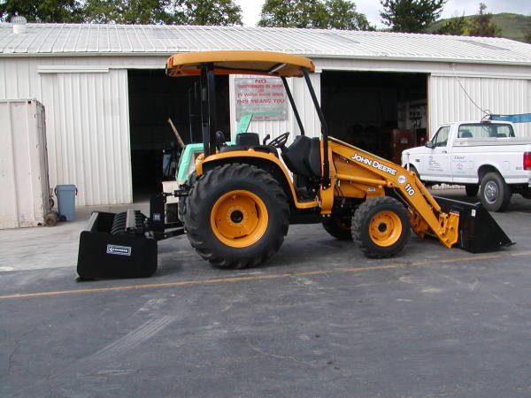

My Friend is retiring! He just bought 30 acres in the Northeast and is looking for the tractor that will meet his needs. He has need for driveway maintenance (800ft) for both winter and summer and firewood harvesting from woodlot to woodshed. This is what I suggested to him:
Given that he is in the snow belt I have guided him toward a 40 to 45hp tractor to run a beefy rear mount blower. Suggested a bucket with grapple or anbo grapple for firewood collection. If he still had cash maybe a york rake or rear blade. Said he should consider going without a cab for getting in the woods.
Do you think I have guided him in the right direction?
I mentioned JD (my bias), Kioti (our local Kioti dealer in Schroon is great dealership), or mabe Kuboto (not really familiar with modern Kuboto tractors)
Any input will be appreciated......
   / My Friends first tractor #2
:welcome: to TBN! Sounds like a good size range. What is his price budget? For the Deere, I would suggest a 110. Use the aux. hydraulics to run the grapple easily. With the SS QA system, it will be easy for him to attach and detach the bucket or grapple. rather than a hoe on the back, the hydraulic tilt will greatly help him with maintaining his driveway with a box blade or an angle blade. The open cab allows some protection from limbs and such in the woods and an aftermarket cab can be added easily. with easy to drive hydrostatic tranny, it will make life just a little bit easier, especially for loader work with the bucket and grapple. and it has the PTO hp to throw snow far. :thumbsup:

price range probably tops out at 30,000 (including attachments)
His lot is mostly wooded and he says he doesn't plan on any field work.
Thanks for info so far. Will have him look at the JD110 (sounds good)
