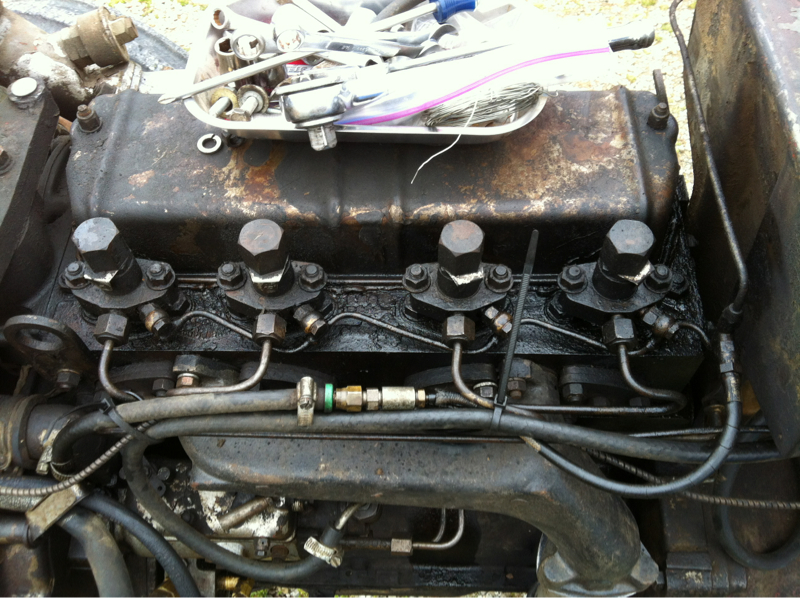

I finally got to the fuel and exhaust leaks today.
I pulled the
   / My five year quest for a (running) tractor is over!
Oops ... Hit send.
I also got the exhaust done. I had nothing beyond the manifold. I found a bent exhaust pipe with flange for a Massey-Ferguson at TSC. It had been on the top of the muffler rack since 2002, so they sold it to me for $8. When it was bolted up it pointed out away from the tractor about 30 degrees. My cousin recommended taking it to a muffler shop, having it chopped and one end flared, and that's what I did. Local Monro shop did it for $5. ;-)

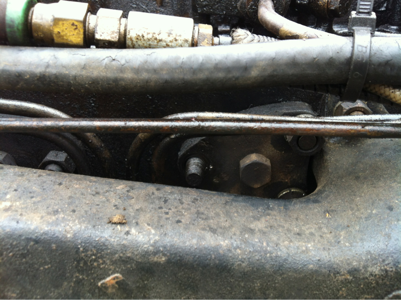

Then I dug into the leaky injector and exhaust leaks.
The injector was just loose. I tightened it and the fuel inlet fitting of the one next to it, and those were solved.
Then it was on to the exhaust. I was told that one of the combustion chamber plates needed a new gasket - the third one from the left.
After pulling the exhaust to get that plate off, I found that it was actually the main manifold gasket that was leaking. So I got the gaskets replaced and everything reassembled and .......... No leaks!!!!
She runs great, and idles smooooth. Before you could tell that at least one cylinder was not firing correctly.
Unfortunately now I can see that I am getting excessive piston blow-by. Exhaust has is blowing out the crankcase vent and dipstick tube.
But it's running well!!! Yay!
